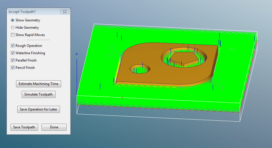

If you can save as DXF you’re fine. MeshCAM can import DXF files and extrude them to a given depth (which sounde like you want to have as .25" given your earlier post). Then it is just a matter of centering the extruded DXF on the stock, which you will make the size of your blank. We can go from there later but saving as DXF is the first step.
Here’s a workflow for DXF. I drew a simple file
It is 2.5 inches square and has random geometry.
I imported it into MeshCAM at full size. I placed a stock around it that is 4 inches square and half inch deep. I told MC to center X and Y and make a top margin of 0 (i.e. the geometry is flush with the top of the stock). I set Max Depth at .25" and set the Program Zero at the top front left corner of the stock (this is where you will zero the cutter on the Nomad)
I used a .125" flat-end cutter for this geometry since it fit all the spaces to machine. As @mitchell said, you’ll need to choose your cutter size based on the size of the details you want to machine. Also cutting brass you’ll want to be conservative on your stepovers and stepdowns and machining speed to not overtax the Nomad.
After a little calculation MeshCAM will show you the toolpaths. They are really dense here because I used a small stepover and stepdown for the roughing and finishing
And here is MeshCAM’s simulation of the result
It really is that straightforward.
