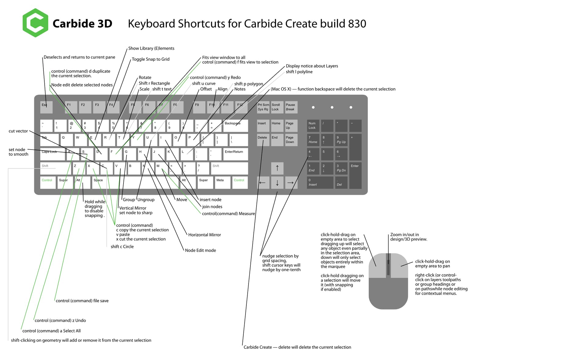

Keyboard Shortcut Cheat sheet for Carbide Create and Motion
Hope this helps!
Updated version for Carbide Motion 5 (note that keyboard shortcuts have not changed for CM6) and Carbide Create 6 (updated for 627):
Carbide3D_create_motion_keyboard_shortcuts_CM5_CC6.pdf (665.0 KB)
For folks who only use Carbide Create or Motion:
Carbide3D_create_motion_keyboard_shortcuts_CM5.pdf (661.1 KB) — as noted above, this still works for CM6
Carbide3D_create_motion_keyboard_shortcuts_CC6.pdf (573.3 KB)
and Carbide Create build 727 adds a number of keyboard shortcuts, so warrants its own chart:
Carbide3D_create_keyboard_shortcuts_CC7.pdf (560.3 KB)
For CM with a numeric keypad:
Carbide3D_create_motion_keyboard_shortcuts_CM.pdf (118.0 KB)
Note that standard keyboard shortcuts for file operations and so forth are not enumerated.
Please let us know of any corrections / additions.

I believe all the differences between CM3 and CM4 are broken out, and all the features in the current Carbide Create build are broken out — if not, let me know and we’ll update.
why did the key mapping change for motion between 3 and 4? and why are not all the keys available in 4?
why can’t we change the key mapping?

So…Carbide Motion 4 Short Cut list:
Homing Movement Control
[1] - 0.01 mm
[2] - 0.1 mm
[3] – 1.0 mm
[4] – ‘Fast’
Jog X & Y
	[Left] [Down] [Up] [Right] Arrow Keys
Jog Z
[+] and [-] Keys; or,
[<] and [>] Keys (or perhaps it’s [,] and [.]); or,
[Page Up] & [Page Down]
Open Midi Window
[M]
Open Log Window
[L]
Reset Grbl
 [Ctrl] + [1]

I think the cheat sheet needs to be updated, some shortcuts have been changed lately.
#Done — let us know if anything was missed or should be further updated.
Is it possible to make all of the descriptions on the sheet consistent - either include the key combination in the text or don’t include it?
For example, “Carbide motion - reset Grbl to factory defaults” doesn’t give the key combination and has two arrows (one to control, one to 1), but “Carbide Create - control x delete the current selection” has one arrow to X and no arrow to Control.
If you choose to keep the key combinations in the text, perhaps reduce the verbosity by adopting a notation, for example “[Control A] Carbide Create - Select everything”. At the moment, sometimes it says “X will select everything” and other times it doesn’t as in “X Undo”

Note: in the current CM5 beta (513) some keys have changed i.e. [M] is no longer used, and [+] [-] are also no longer used, cant verify if its a bug or a change but be aware…
