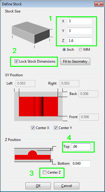

Where is this option in Meshcam?
My stock will be slightly out by maybe a 1mm, so I was thinking of milling a 8 mm part using 10 - 11 mm stock would this work?
Tim
Tim, in the Define Stock dialog do this:
  1. Define the stock size and
  2. Lock the dimensions
  3. MeshCAM’s default behavior is to center the geometry in the stock so unselect Center Z
  4. Edit the top or bottom margin. The other one will update automatically because both the stock thickness and geometry thickness are fixed. (If you do not lock the stock dimension MeshCAM will monkey with the stock dimensions as you edit the margins).
Randy
Hi Randy,
Bit confused, on Z Position what is 0.6 and 0.040 for?
Tim
Tim, on my example the geometry is 1.500" tall (I see I didn’t actually say that, sorry). I used samplerhino.stl. I defined the stock to be 1.600" tall just so there was some wiggle room. So the sum of the top and bottom stock margins is (1.600-1.500) = 0.100". For my example I specified a top margin of 0.060", so with the stock size locked the bottom margin works out to 0.040". What you are really doing is positioning a fixed stock around your fixed geometry.
The other way to go would be to load your geometry, leave the stock size unlocked, enter your desired margins, and MeshCAM would tell you how big the stock must be to give those margins. Then you’d cut a piece of stock to that size.
But in my experience it’s always much easier to square up the stock and measure it, than to try to square it up and size to a predetermined dimension at the same time.
Randy
