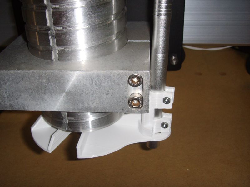

I made a similar microscope mount for the Dewalt 611 using a Supereyes 'scope which was much cheaper than the Adafruit one linked in the above article, $28 versus $150.
I found it much easier to 3D print the mount and I can confirm that the Supereyes really needs an upper and lower clamp as it is not a cylinder. If you clamp it in one place, it will wobble. The differences in the diameter can be seen in the attached picture and on the Amazon page.
Do you have any issues with losing registration due to the focus knob being bumped? I certainly like the idea of a much cheaper camera! I don’t have a 3d printer but I’m confident I can make something work with just the Nomad.

Here is the STL file for the bracket in the pictures. The screw in the design is a 1/4-20 cap screw 1/2" in length. I have no way of tapping this with accuracy so I just drilled a hole and used a regular screw and nut.
