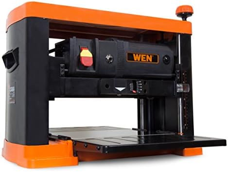

I actually own several tools from Wen. For the price they cannot be beat, easily the top end of lower end tools at the lowest price. I’ve seen several of the same tools rebranded and sold for twice the price. After owning the Porter Cable though I wanted to get the best I could afford. The next step up beyond the Dewalt is just slightly out of my price point. The Dewalt will be here in two days and I’ll give it a shot. If it’s not “that much” better I’ll send it back and start saving my money.
