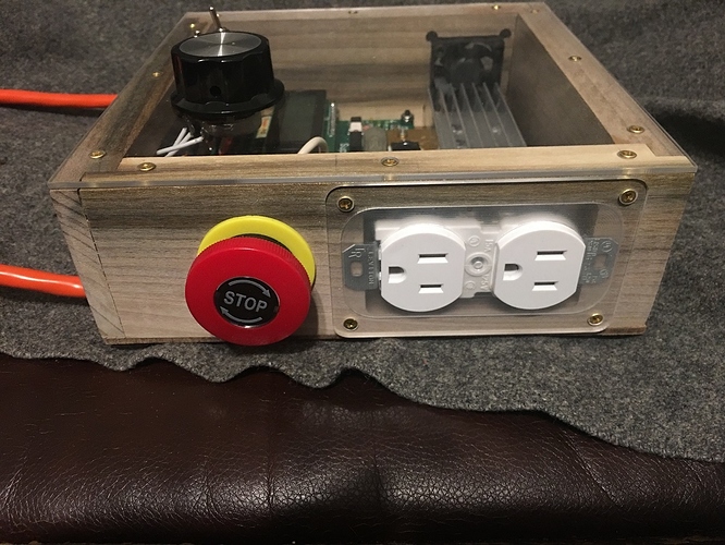

And here’s the completed enclosure. I opted to use knob control rather than PC control, maybe I’m a control freak, haha!!!:
I integrated a kill switch that I’ll use to cut power to my SO3 (bottom outlet), as well as cut mains power to the SuperPID itself (5V power to the SuperPID IC itself is not cut, but it isn’t going anywhere without mains power):

Page 19 shows how I wired it up. The only thing I did was add a kill button inline. The electrical outlet I used I broke the metal tabs between the two outlets so they operate as two distinct outlets. So power cord in from wall power, through kill switch and into lower single outlet. I took power from this outlet to feed mains power on the SuperPID. Mains out from SuperPID feeds the second outlet which is where the Dewalt plugs in. If you hit the kill switch it kills the lower outlet killing the SO3, which feeds SuperPID mains and the router stops.
Disclaimer: I am currently in the process of buying a new home, so other than some initial testing I honestly haven’t had time to really run this for much more than a few minutes, but I see no real reason why it shouldn’t work long term other than possibly EMF “noise” with the SO3 plugged inline with the router. There’s also a couple things I may have done different, mainly I would have put the optical sensor port on the same side as the router cord for easier cable management. I may have also made the box a very tiny bit larger, like maybe an extra 1/2" all around for easier assembly.
