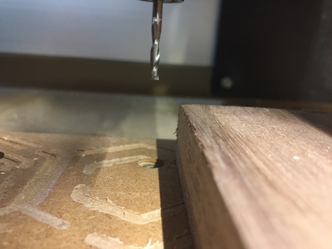

You could always use mdi to move x and y in the distance of the radius of the tool and then zero. That should center your cutter on the corner.
Assuming it’s positioning the bit at the edge that way. I believe someone suggested it was close to that point but not right on it.
It sounds like the probe code is centering the bit at the corner of the probe instead of the corner of the stock. Somewhere there should be a setting for the offset on the x and y axis like there is for the thickness of the probe for the z axis. Those x and y settings would specify the thickness of the over hanging part of the probe along the x and y axis. (Those may not be the same.) Given manufacturing tolerances it would be nice if those were configurable in CM.

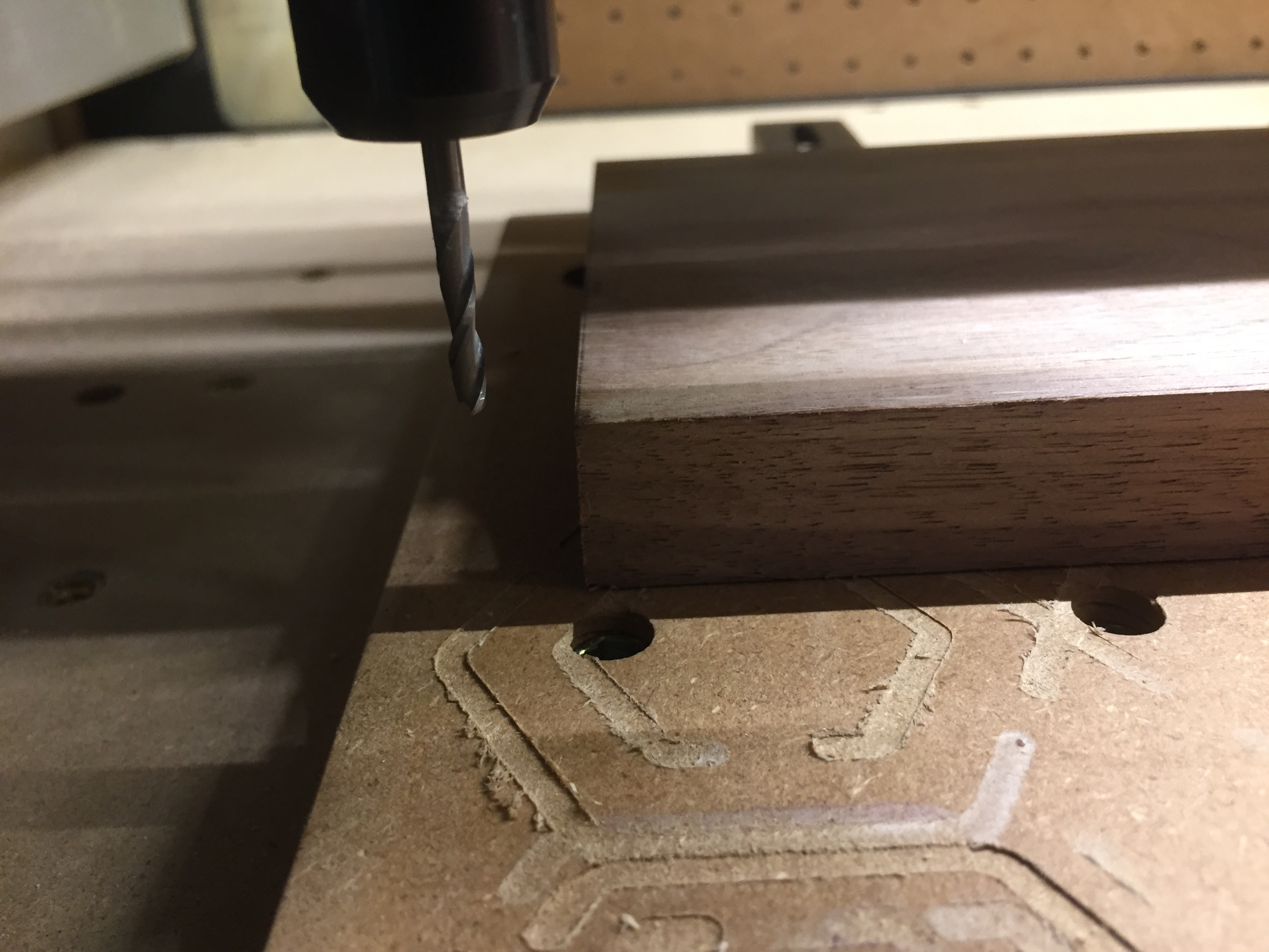

I don’t think anyone has issues with how it works, just an open question as to why the center of the bit is not located ABOVE the corner of the stock just as it would be if we were to perform this manually. Instead it’s off to the side for an unexplained reason.
In my eyes, it would be perfect if CM was modified to put the bit above the corner. Right now I think most people are then jogging the x and y which really defeats the entire purpose of setting it automatically.

This is where it put my bit, looks like the edge of the probe instead of the stock.
If you grab the latest version of CM, 4.10, you fill find this corrected.
