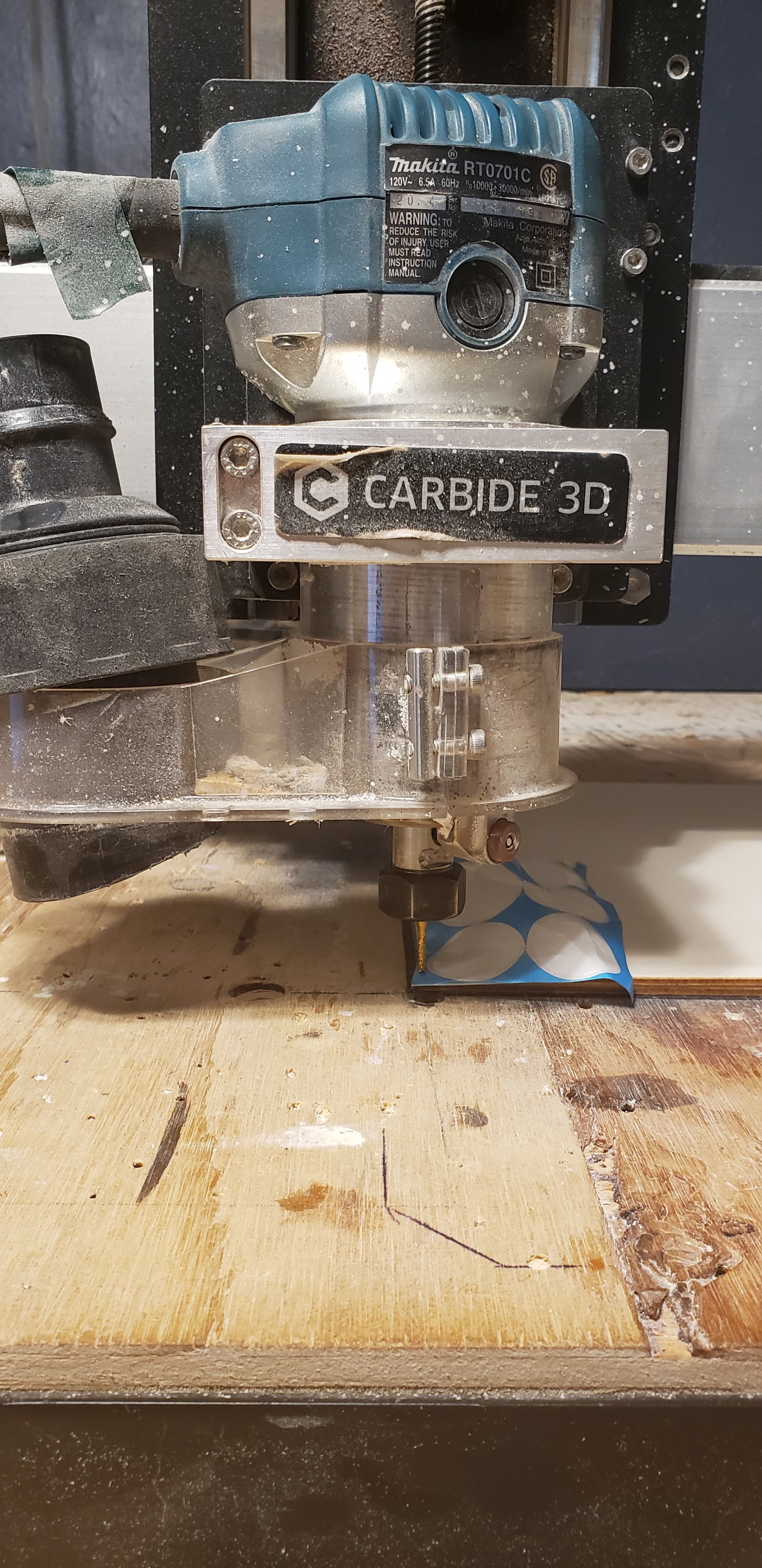

1/16" bit doesn't touch the wood to cut

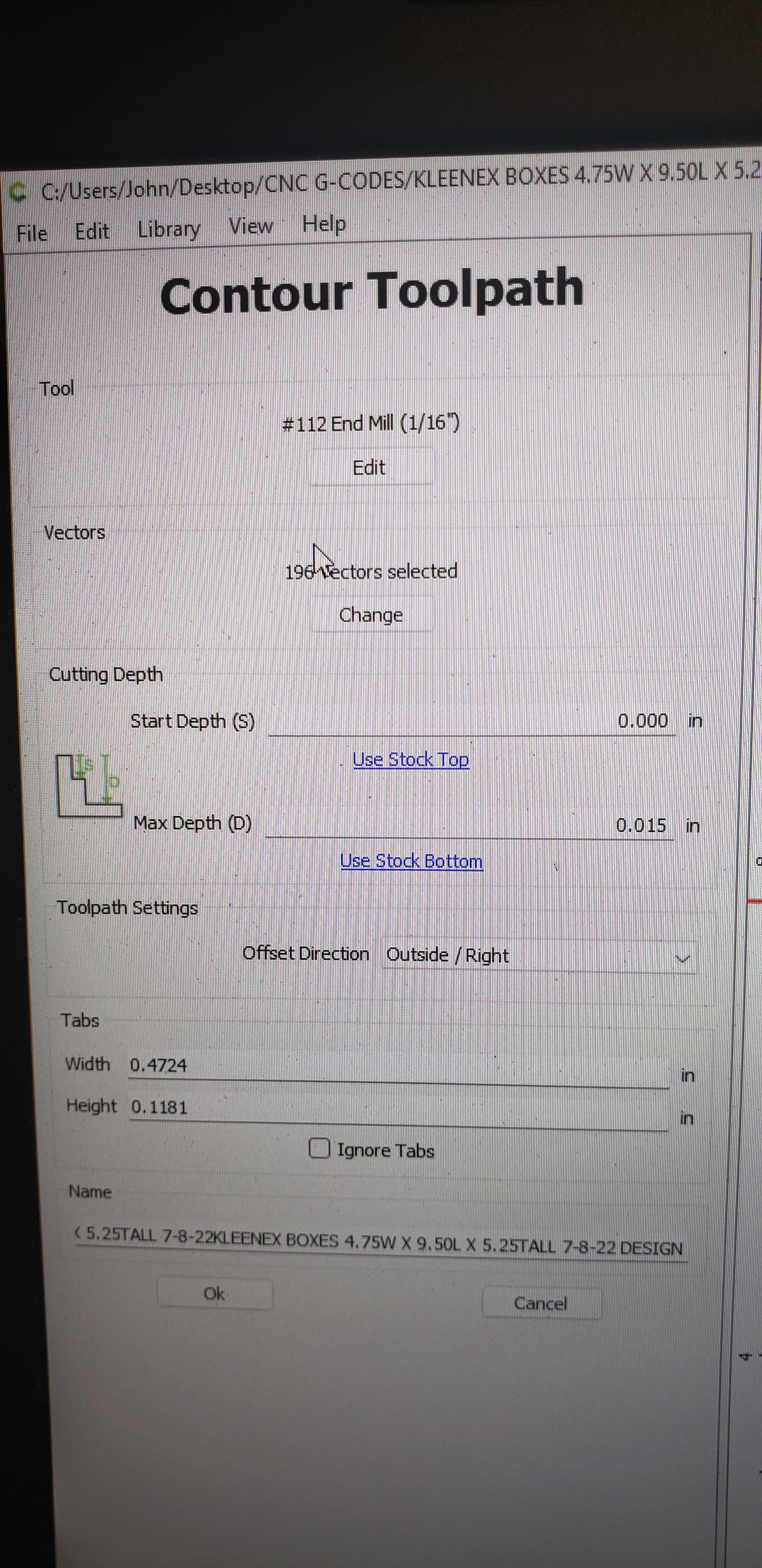

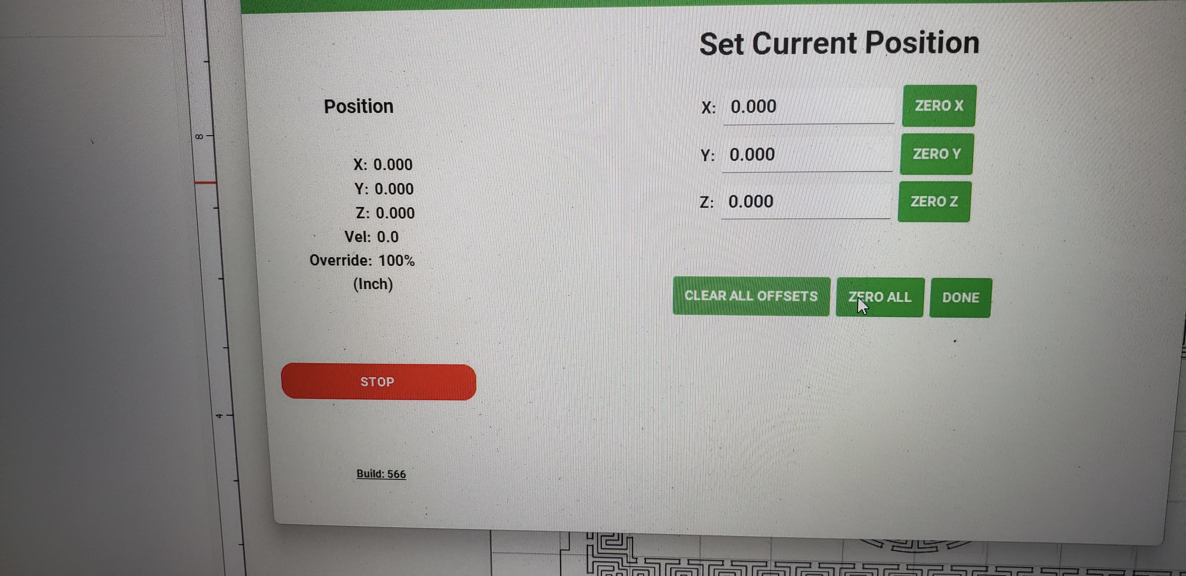

I’ve programed Carbide create to cut pattern into 1/8" piece of wood. Start depth 0 cut depth 0.015". When I start Carbide Motion to cut the bit never touches the wood. It stays about 3/16" above the top of the wood. I have set 0 3 different times to no avail.
How are you setting zero? Are you using a BitZero?
Are you setting zero w/ a Probing pin or a different tool?
I just use the corner of the wood where I set 0 on all 3 axis. The probe I purchased quit working a long time ago.

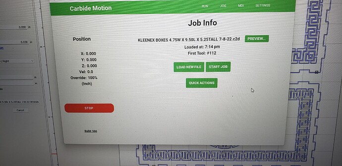

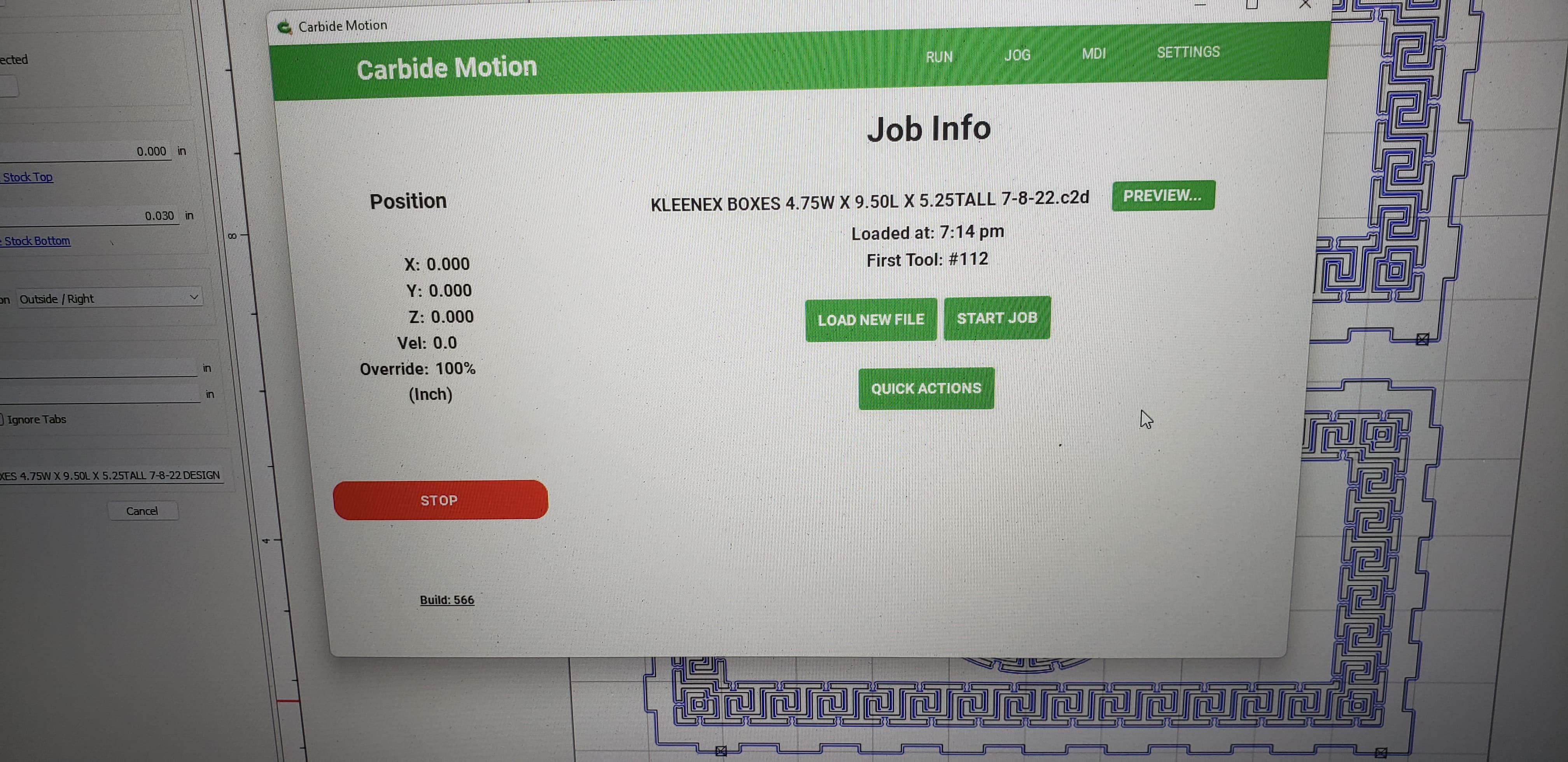

To confirm:
  • you are jogging the endmill down to the surface/corner and setting zero there?
Does the machine then have sufficient travel to move as far down along Z as it needs to?

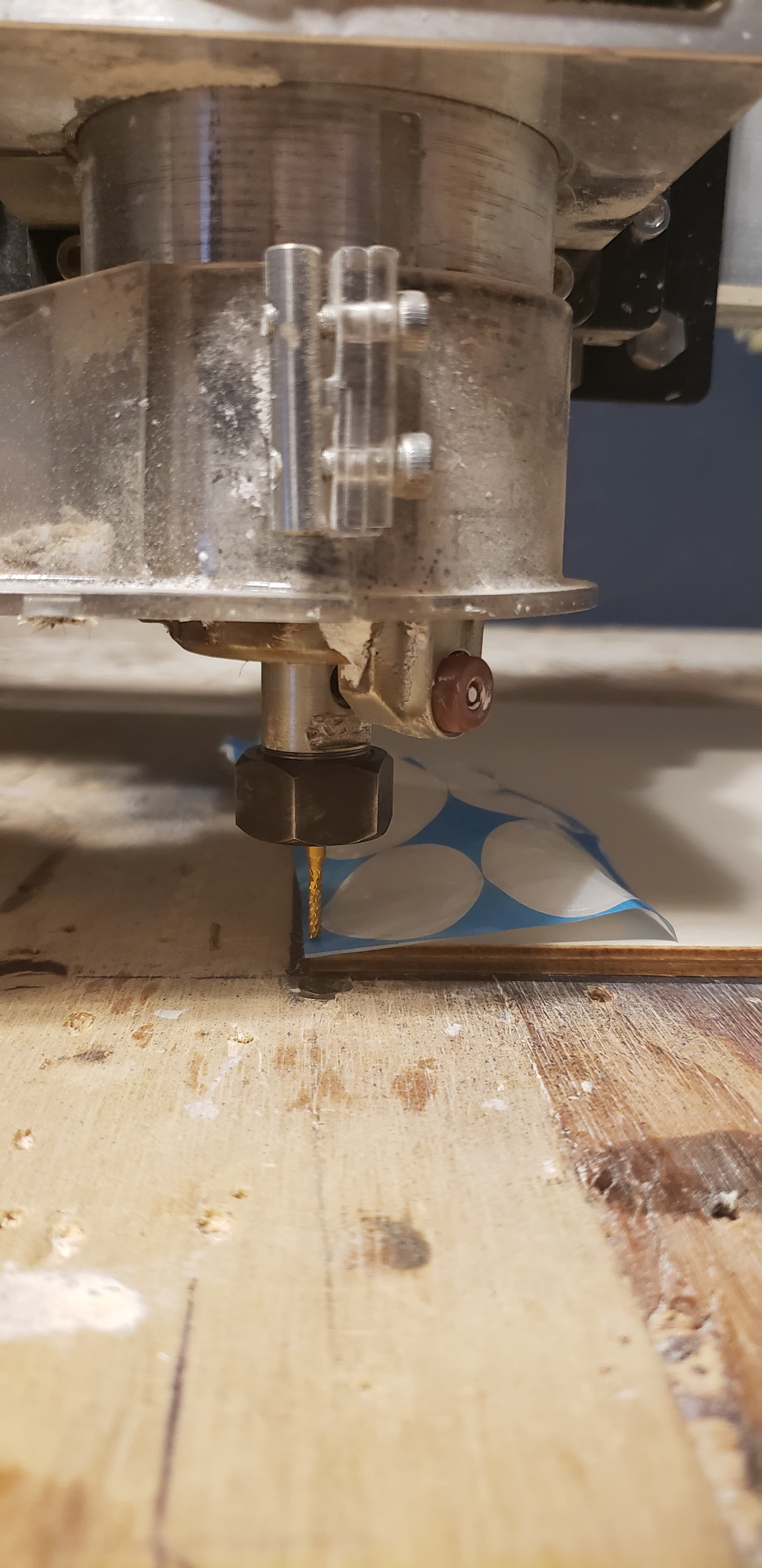

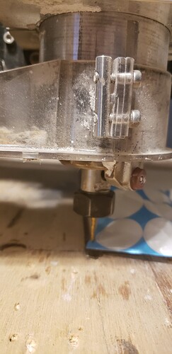

Could you post a .c2d file, generated G-code, step-by-step notes on how you are securing your stock and setting zero relative to it and managing all tool changes and a photo showing an attempt at cutting still in place and w/ the endmill positioned where the origin was set?
I’ve never had this problem before and we have cut many samples and many different thicknesses of wood. As I mentioned, the probe I purchased with the Shapeoko 3xxl quit working a long time ago and we have been using the bit and paper technique on the bottom left corner of the wood and zero a 3 axis.
The router is all the way down as far as is possible. I can jog the z-axis down below the wood I’m cutting. I don’t know what the problem is. I’ve never seen this before.

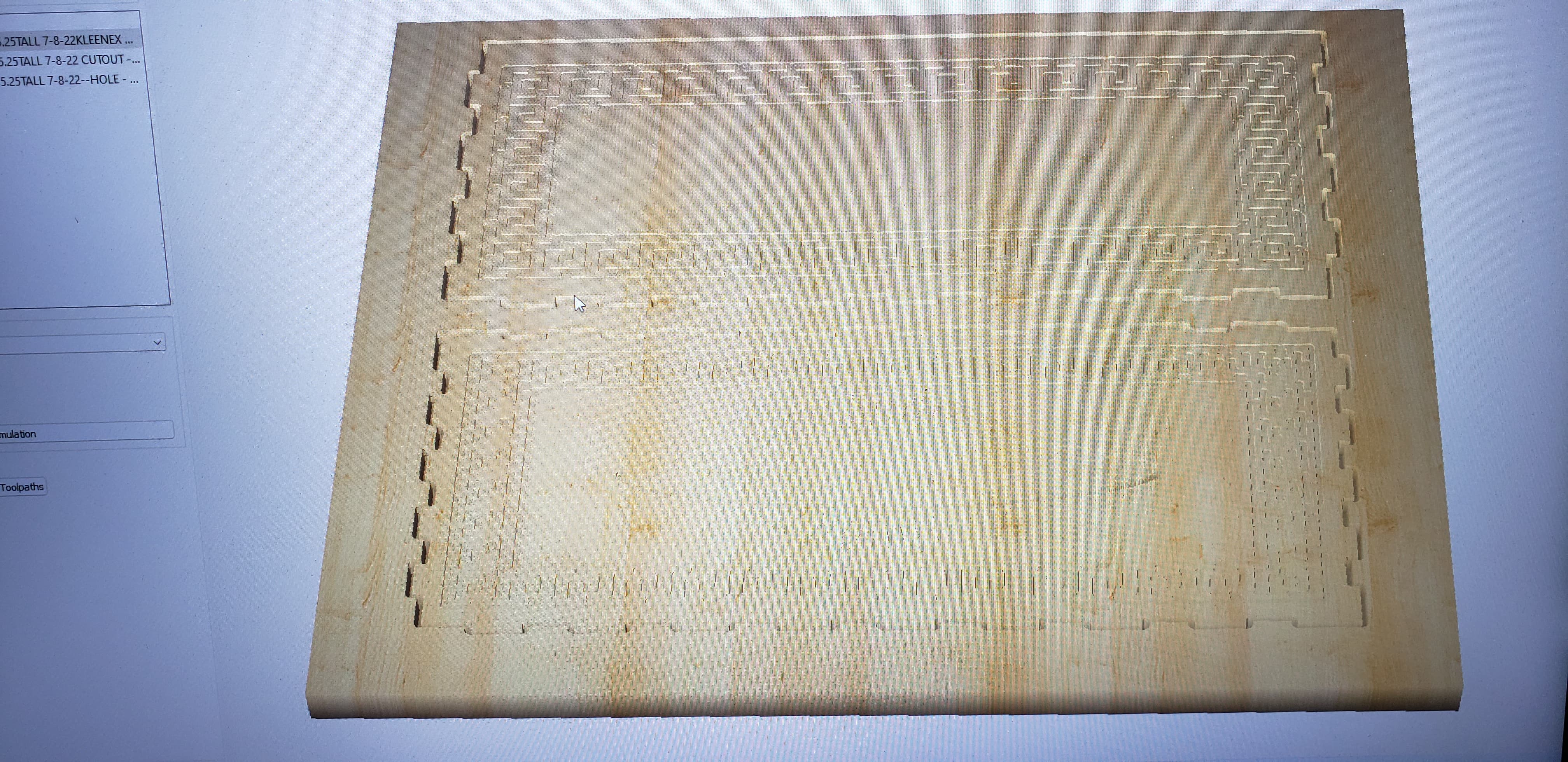

It runs the program but doesn’t cut into the wood at the settings I set.
Is anything mechanically blocking the movement down?
Post the .c2d file?
No. I can jog the bit down below the wood I’m cutting.
John,
Post the file so we can look at it.
KLEENEX BOXES 4.75W X 9.50L X 5.25TALL 7-8-22–PART 2.c2d (352 KB)
KLEENEX BOXES 4.75W X 9.50L X 5.25TALL 7-8-22.c2d (336 KB)
KLEENEX BOXES 4.75W X 9.50L X 5.25TALL 7-8-22-part 2.c2d (352 KB)
KLEENEX BOXES 4.75W X 9.50L X 5.25TALL 7-8-22-1.c2d (480 KB)
The first file has the origin set to Bottom:
Change that to Top
