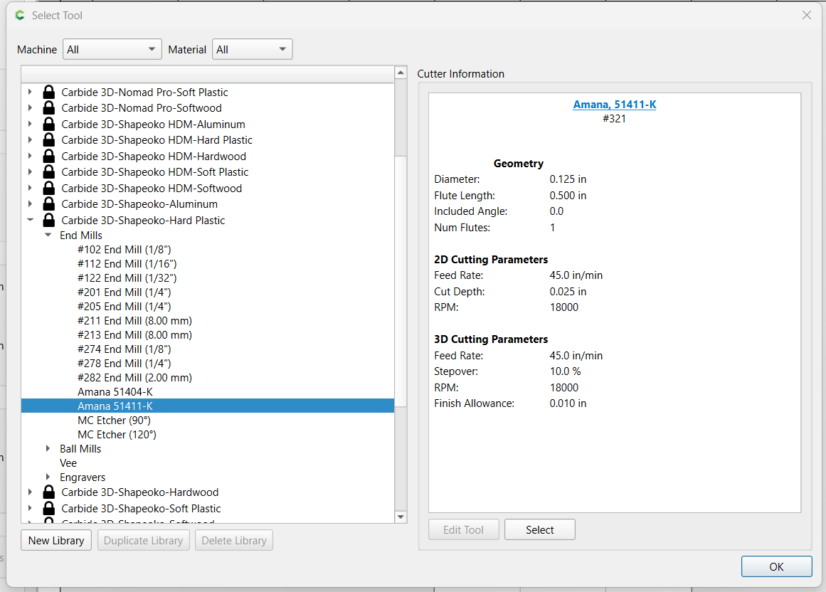

I have a Frued 1/8" O flute I use. When I cut plexiglass it is usually less than 1/8" thick. I use the 1/8" Amana bit that is in the standard bits from C3D for the tool path. I dont have a 1/4" one so never used one of those. I agree the 1/8" bit cuts a nice clean tool path. Minor cleanup. I use the recommended F&S from the C3D Amana bit and it works well. I picked the hard plastic tool set for the Amana 51441-k.
