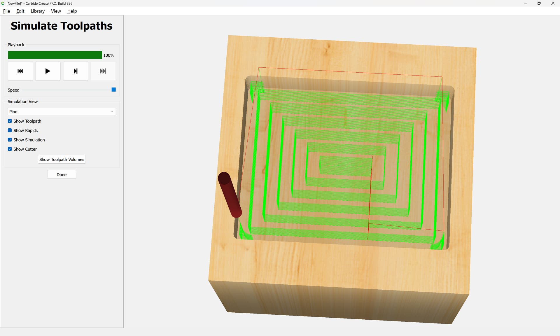

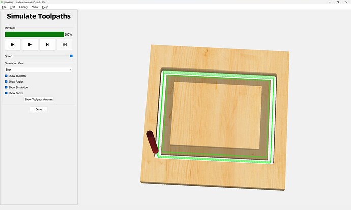

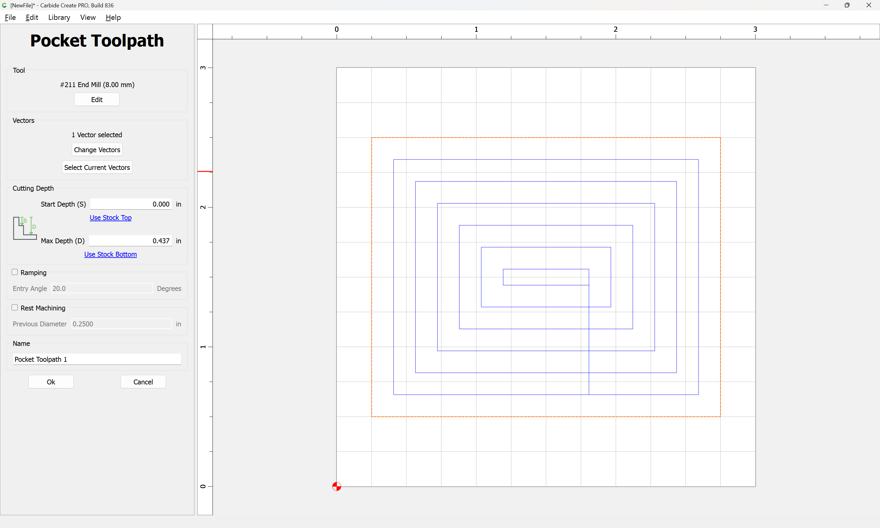

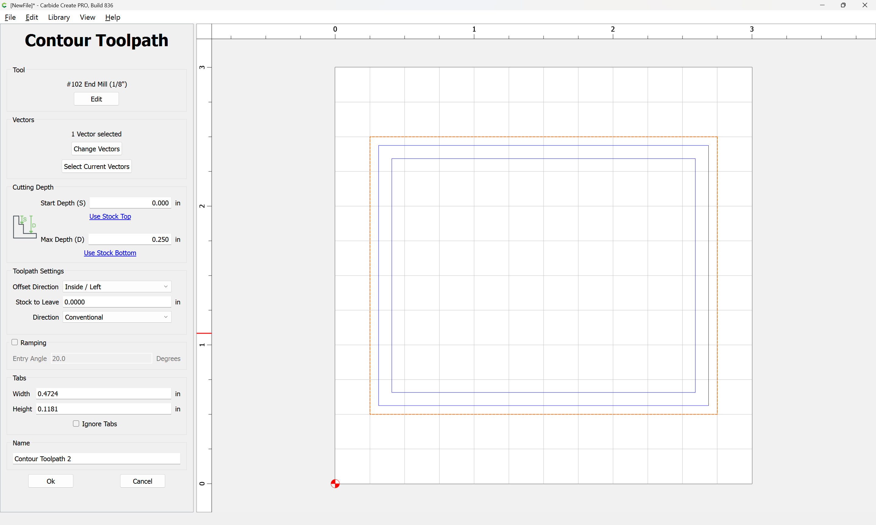

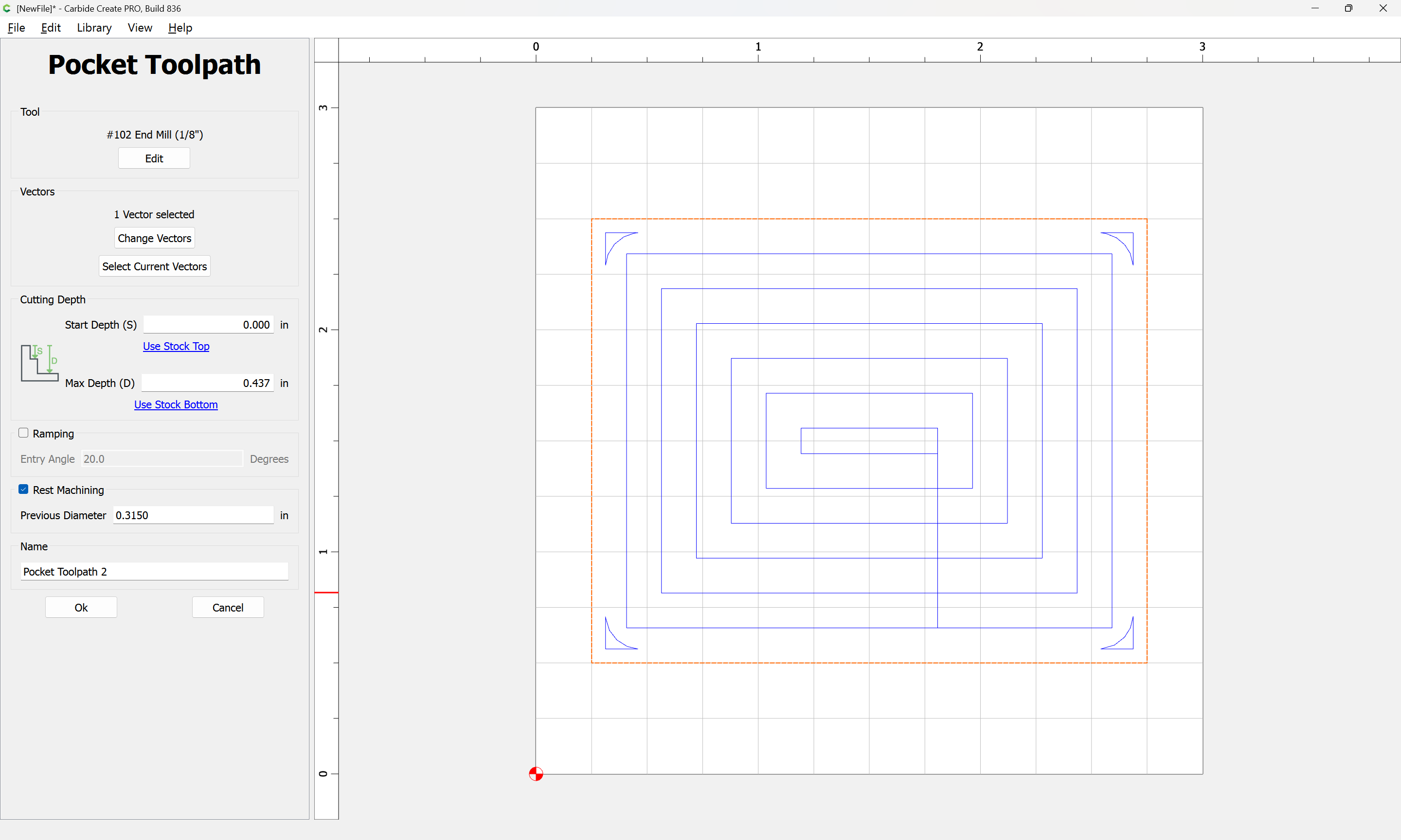

There are two ways to do this:
  • Carbide Create Pro has REST machining for pockets
  • Carbide Create allows assigning two tools to a Contour toolpath:
