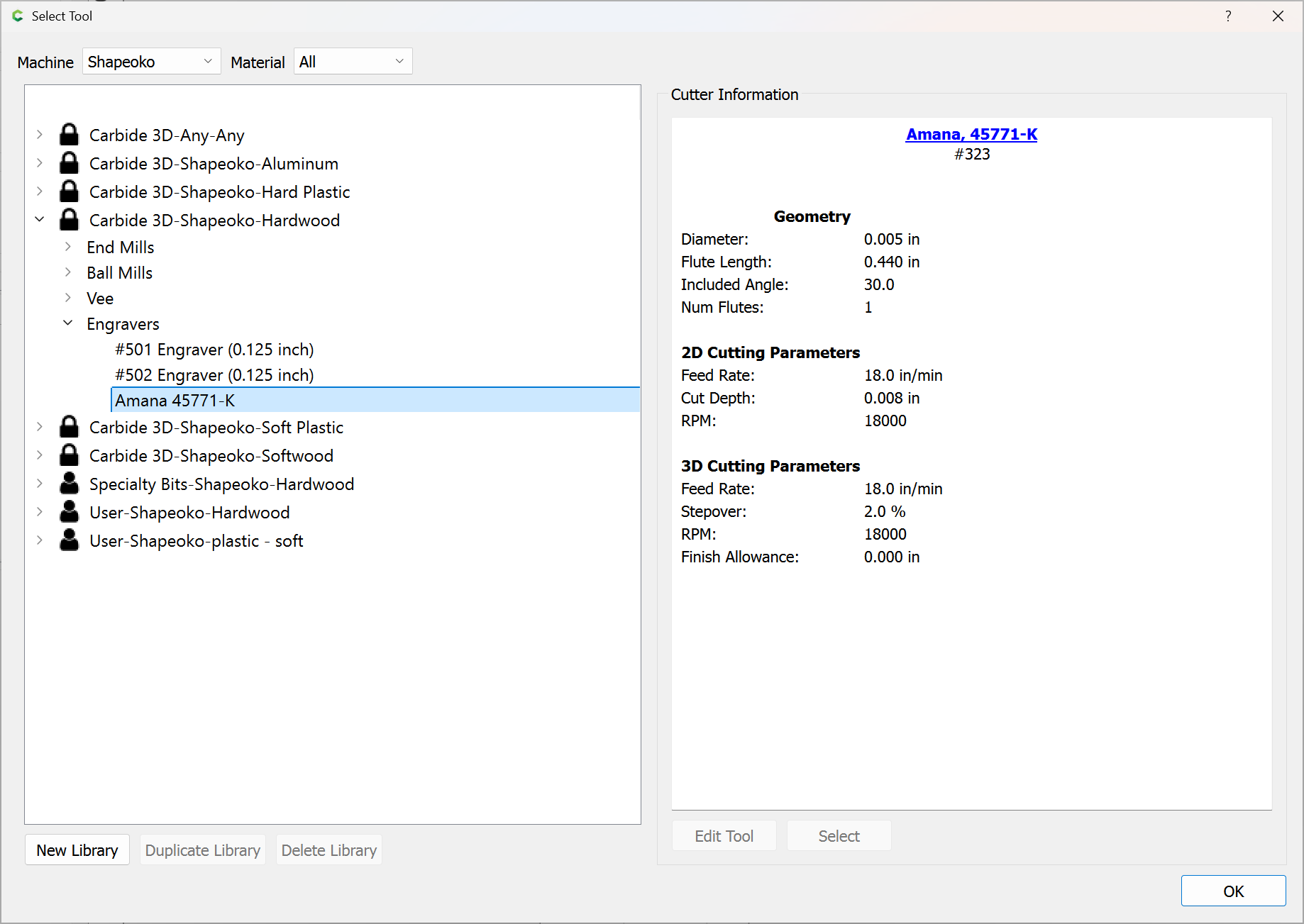

Actually, there is a 30 degree tool in the library — it’s just listed as an Engraver, not a V tool:

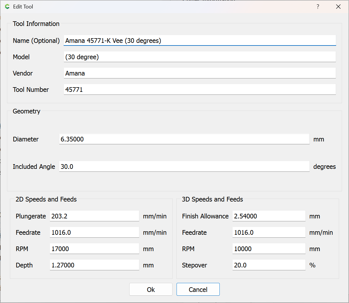

That said, I did enter it as a V tool:
but please check and test the feeds and speeds and so forth as described at:
