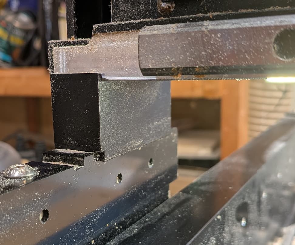

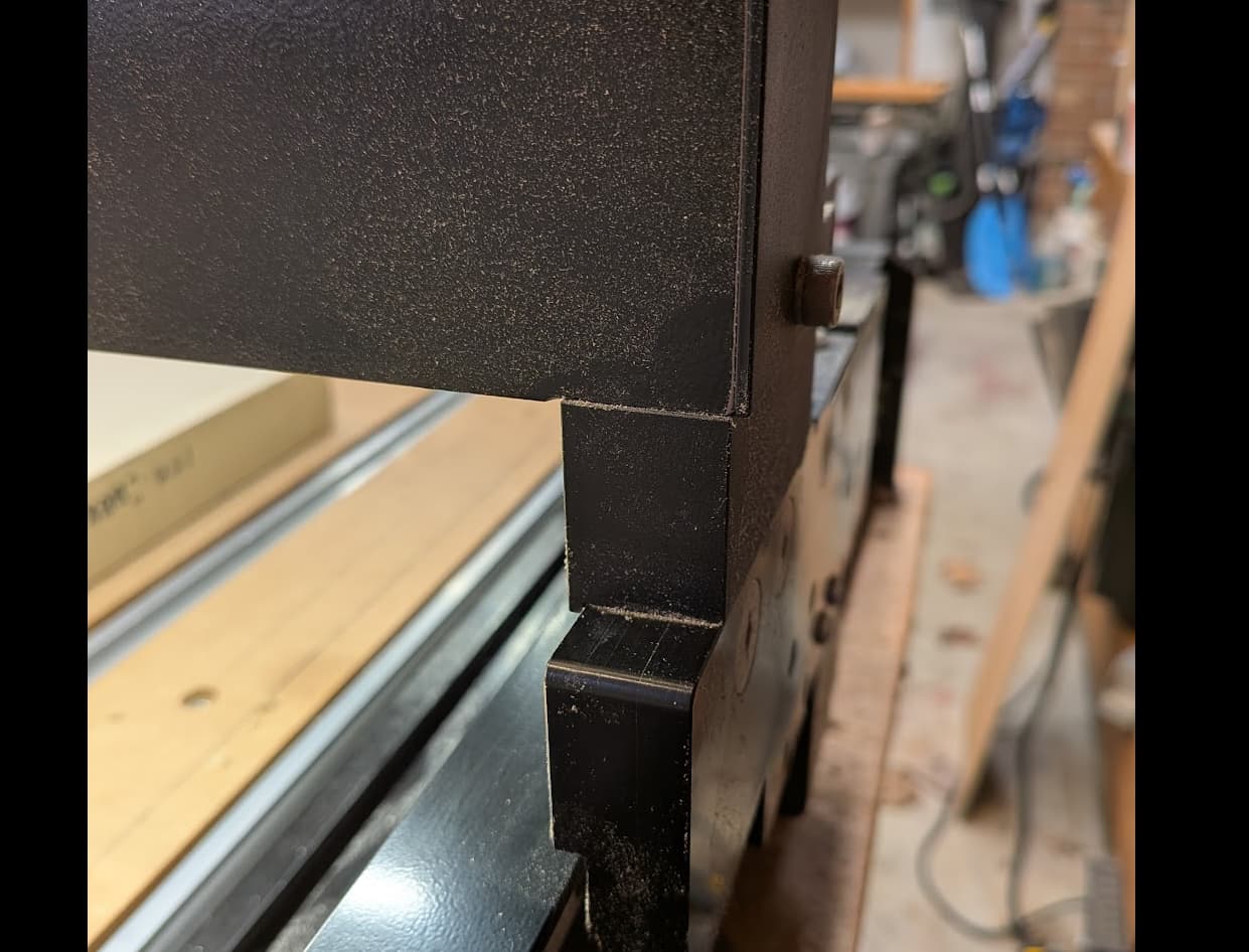

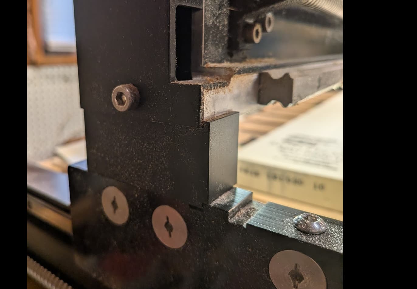

They are a no brainer. You will need another set of hands to install, remove the spindle to lessen the rotation on the transom.
You can ALMOST assemble the rises is the wrong orientations.
You will find out if you are wrong when the bolts do not want to pass through.
It’s a snug fit, but not that snug.
Here are a couple of pictures to clarify.
Note the ridge on the inside of the Y axis mount.
Note the ridge on the front of the X transom.

Honestly, I would wait until you have a good set of extra hands. The X axis wants to rotate, it would be easy to screw up.
