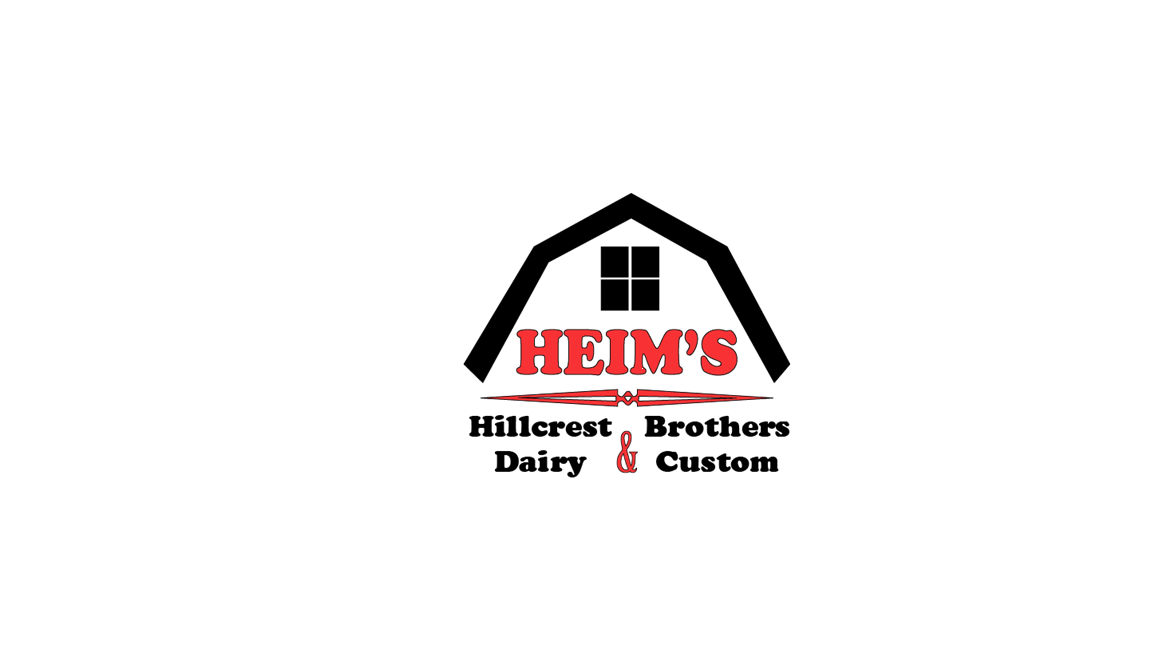

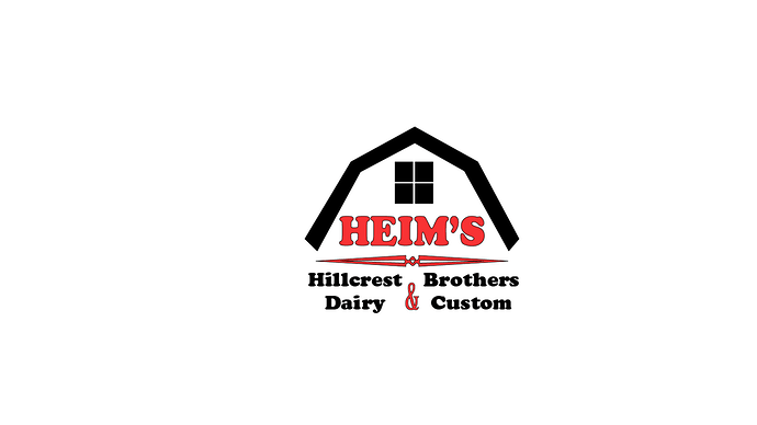

I’m trying to 3D this logo but I seem to have issues getting the logo 3D raised.
Do you wish to use Carbide Create Pro?
Or, Carbide Create Core?

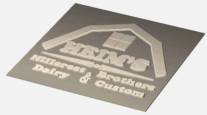

In either case you would draw some geometry around it defining the stock, then for Core, include that in the selection for the Toolpath and cut as a pocket, leaving the “islands” inside uncut.
I’m using Carbide create pro to get this engraved
I’m looking for the design to be raised and I keep getting the design resets
For Pro see:
and
if you’re still stuck, upload your .c2d file and screen grabs showing the difficulty you are having.
If you’re V-carving, add an outside boundary to cut outside the letters & logo
