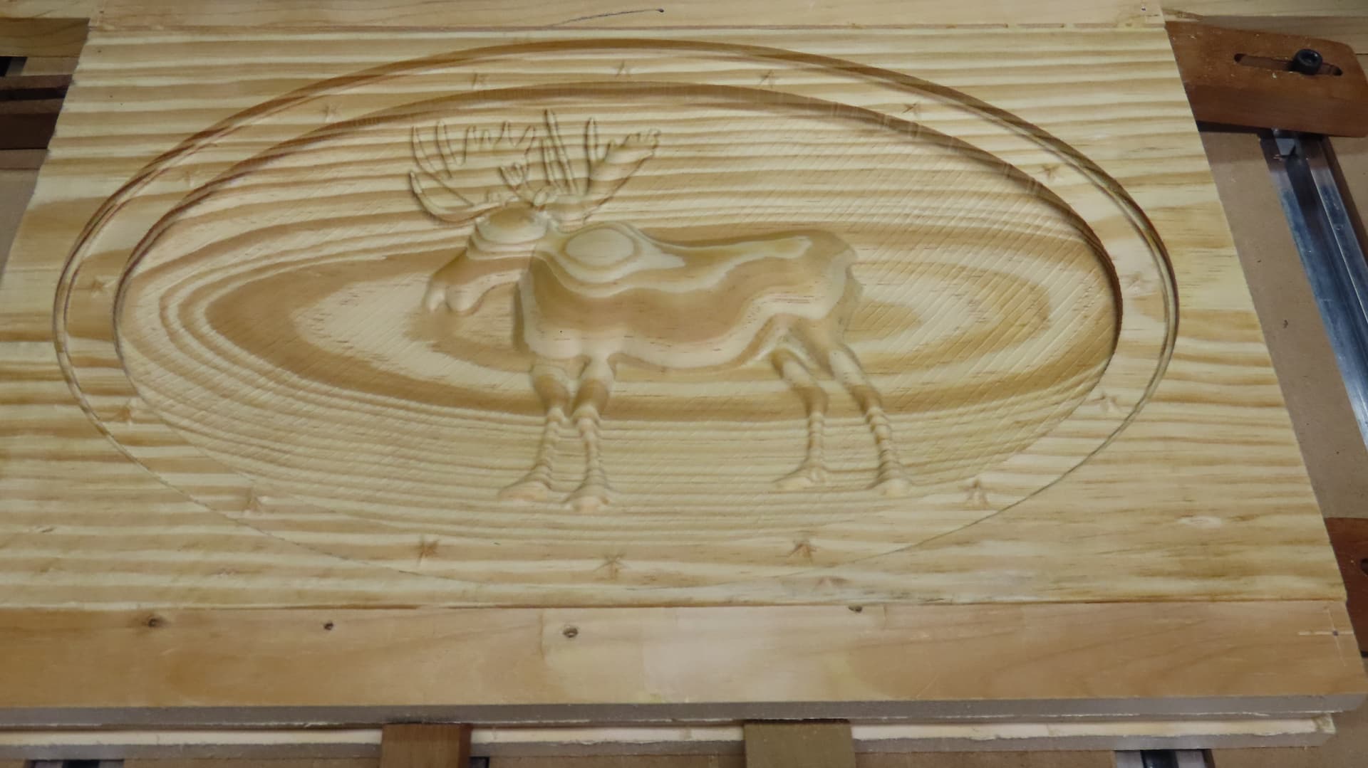

Making good headway trying to create a moose in CC Pro. Good at least for CNC novice, I hope.
For testing / learning I picked up a piece of 2x10 Southern pine to play with. Way cheaper than cherry or maple.

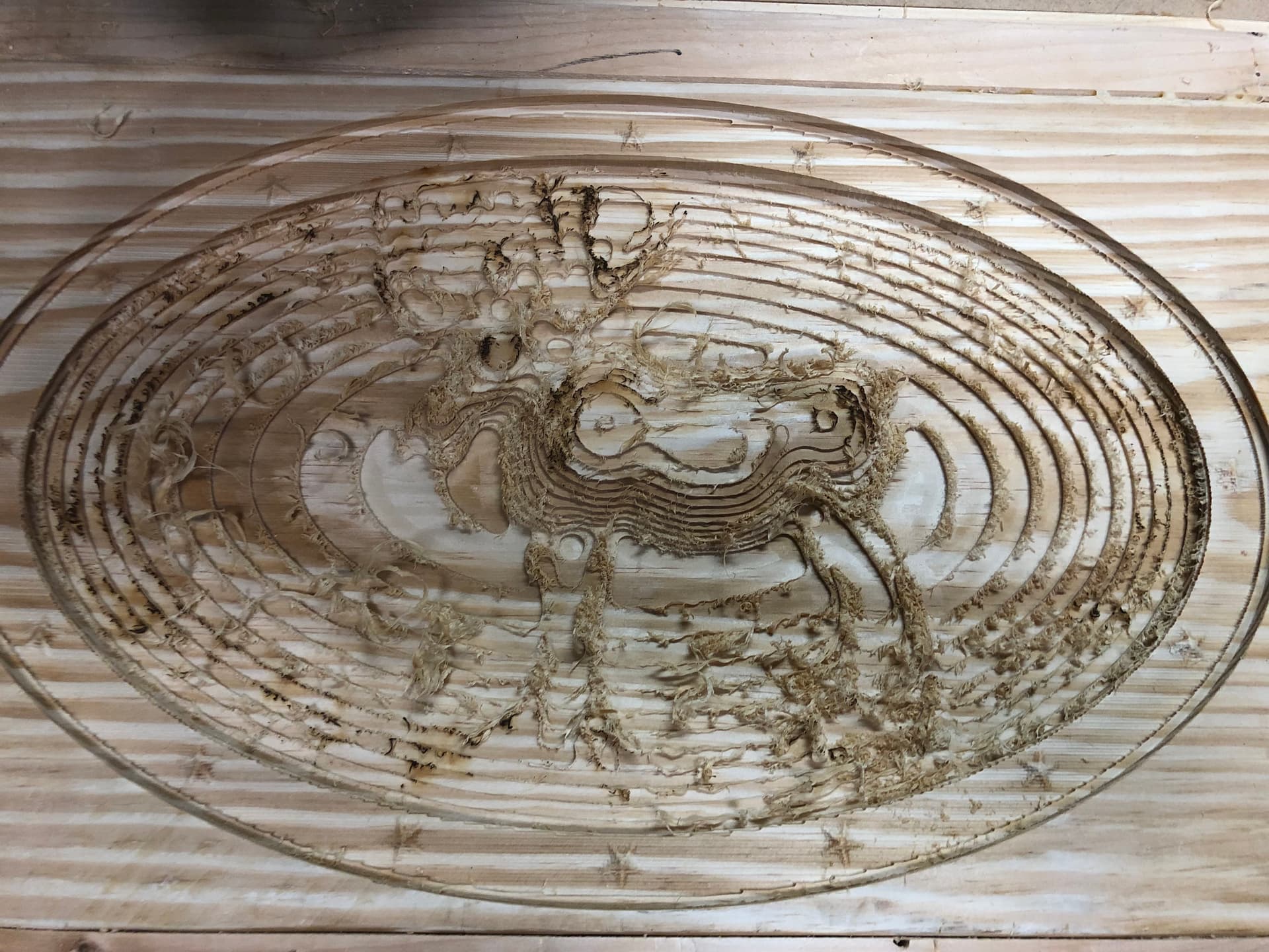

A couple hours rough cutting yielded the following:
Lots of fuzz and a lot less wood on the table.
FYI, the “carving area is 13.5” wide. The center “bowl” is 1/2" deep and the moose is .5" thick. All more or less.
I also tried using a 1/16" Tapered Bit to finish the rim with the stars. Bad choice given the surface area. Ran complete 3D Finish using 1/8" round nose and either .03 or .013 Stepover at a 135° angle. Not certain which. I Couldn’t stand watching the entire 4 hour run, but it was certainly interesting to watch for Periodically. When it finished, this is what I had. It even gave me time to fix the switch on my Shop Vac!

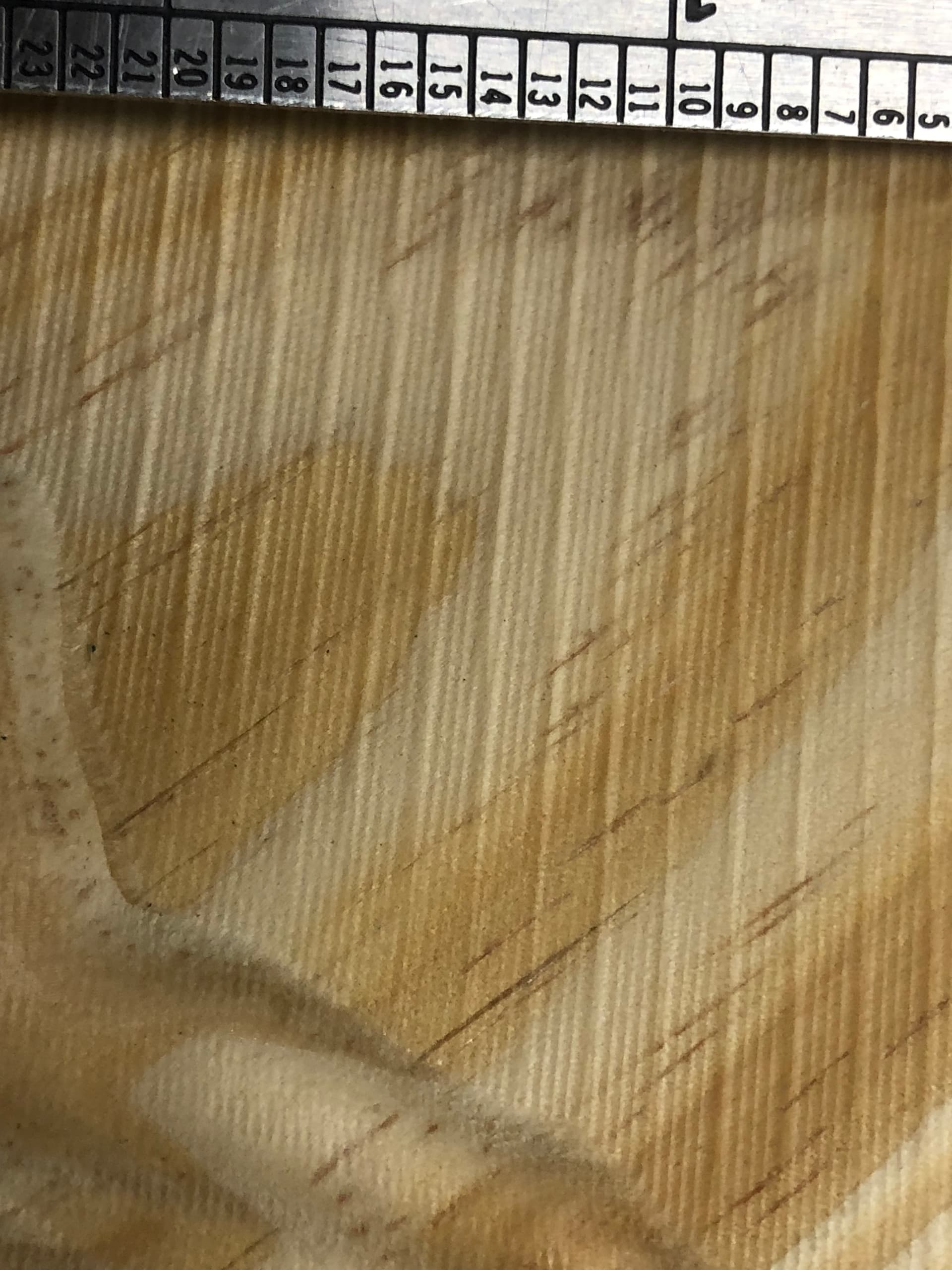

Very happy initially. Figured a little light sanding or a second pass at 90° to the first would finish it. Haven’t done that yet, because looking closer, this is what I saw:

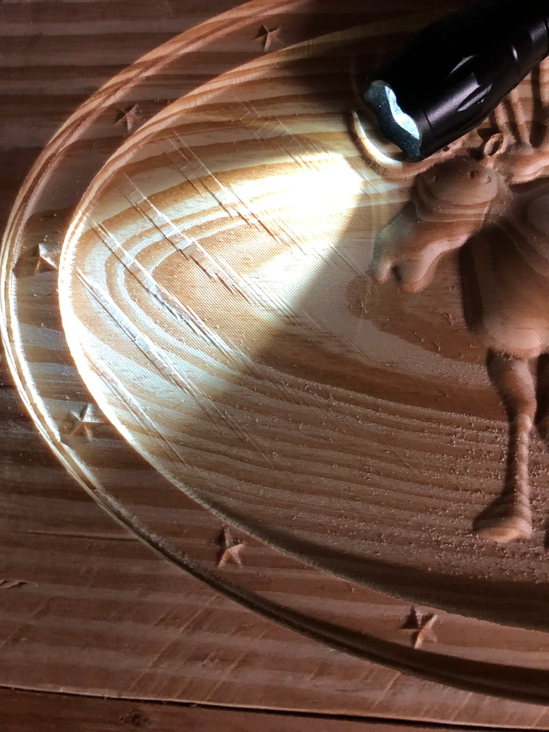

Small ridges about 0.11" apart (steel rule is in tenths) separated by three much smaller ridges. When the job was running, all I could tell was that that bit moved over a tiny amount on each path. Repeatedly!! What caused this?

Interesting. No idea what caused it. The ridges look to be closer to 1/8" apart. They also are not parallel to the direction of cut, and appear to be a few degrees off. But the spots where each pass is off does seem to be parallel with the XY axes of the machine. ???
It could be a slight discrepancy in the 3D model when it’s interpreted for the 3D toolpath. Can you share the .nc file? We could simulate it in a 3rd party simulation like Camotics, NCViewer, et.al. to see if the anomaly is in the toolpath.

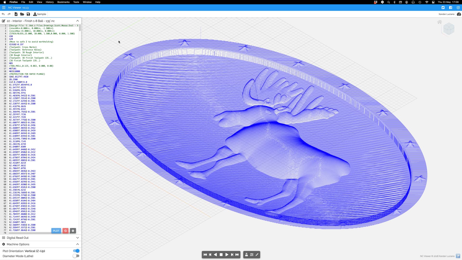

It looks like the striations are present in the G-code:
Could you try re-making the 3D Finishing toolpath at a different angle? If the striations are still present and show at that different angle it would seem to be a problem in the G-code generation/calculation — if they are still present at the original angle that would point to a problem in the 3D model/pixel image.
The only time I saw a similar pattern was when I used 0.25mm ball-ended cutter on a raster finishing toolpath. The fine furrows look like they are a product of the stepover of the ball-ended finishing cutter. The angle of that finish is a bit mystifying and looks as if it does not belong there.
My solution to these kind of finish markings was to stop using a raster finishing toolpath and use a circular toolpath. That means the cutter is not replicating a linear pathway and just moving in one direction according to the set stepover. The circular finish from inside to outside places the cutter tip in a new spot in X & Y directions for each pass.
If you had some scrap, you could try adjusting the stepover. The furrow pattern suggests that the stepover was set to 100%. Has the c2d file (toolpaths) become misaligned in some way before you saved it?

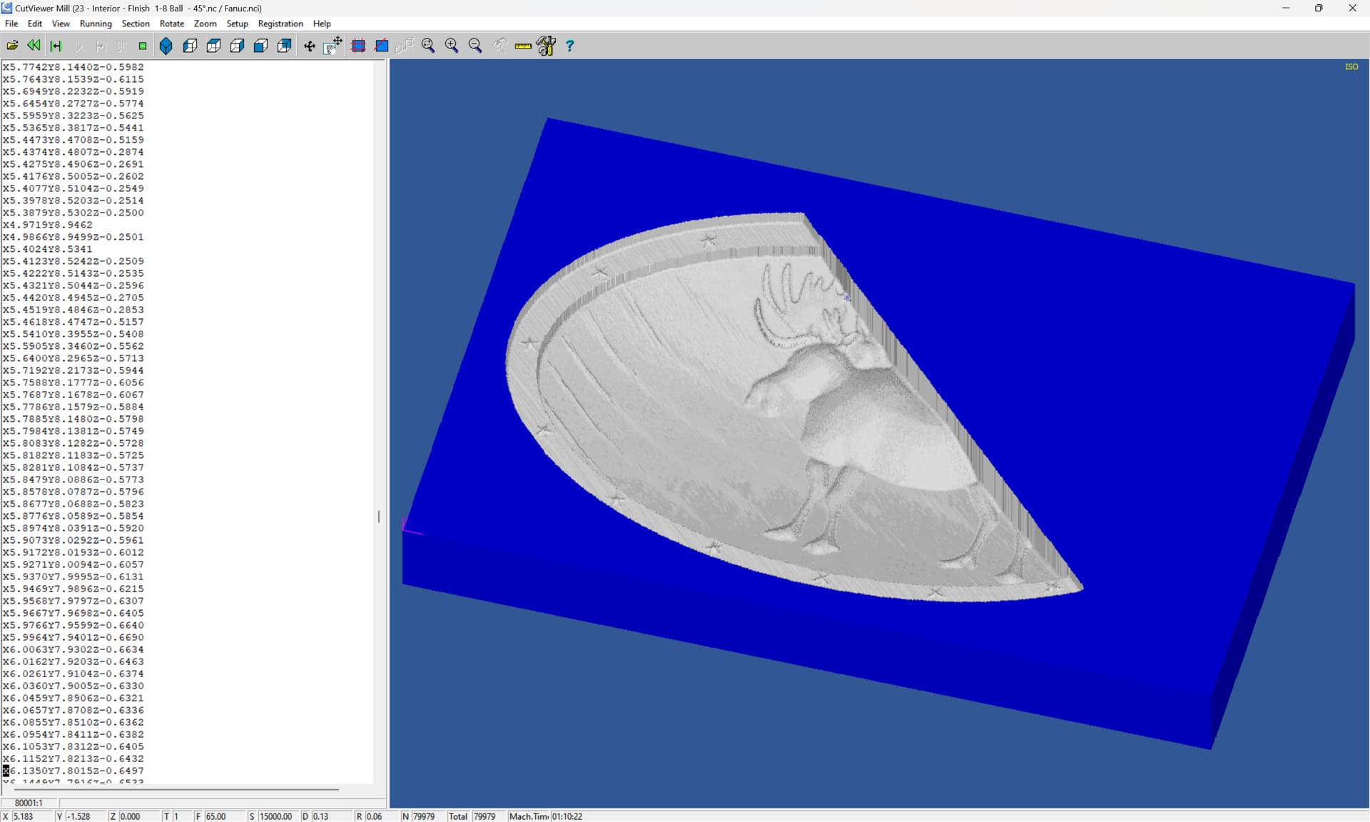

I used NC Viewer to look at your file. It shows the file as it was cut. The attached image displays the file with the curious ridges at the angle to which you set them.
The question is, if the 3D Finishing toolpath was regenerated would the ridges still show? If so, would they show at the original angle or a different one?

Looking at the moose with my son, we noticed that while all the bowl surfaces consistently have the higher ridges, the rounded moose body and the rack only has nice neat fine lines. Go figger.
My suggestion is to check the stepover setting of your finish cut is what you intended it to be. Please explain to me the purpose of the 135 degree setting for the finish cut and what you had hoped the outcome would be. I don’t understand why there was a need to specify this setting.

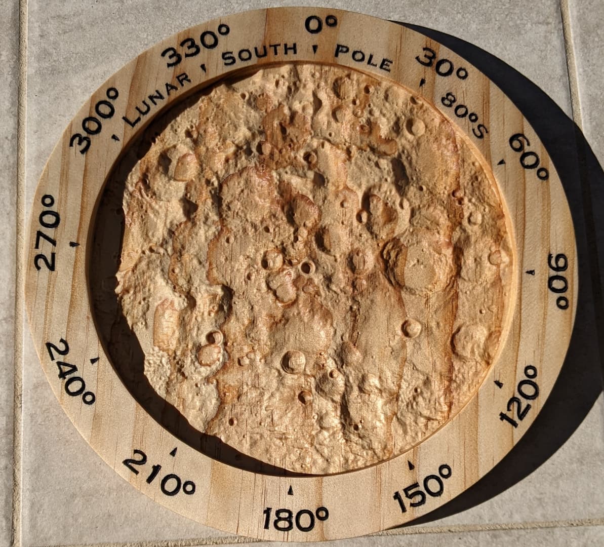

What I have found in doing relief carvings, is that you need 2 finishing passes: The first across the grain and the second along the grain, so that any tooling marks aren’t as visible. Both finishing passes should be about 10% step over.
This is an example I’m just finishing.
That would make for an interesting clock face.

Not impressed by results. Bowl had strange cutting. Set to 45°. Ran for about two and a half hours.
Cuts over moose appeared reasonable, but not so for the cuts on the bowl in front of him. See picture
Notice the wider ridges this time. Could it be that it doesn’t like doing concave surfaces but convex or flat is OK? The passes over the moose look fine. Ditto for the rim where the stars are.

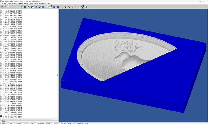

The G-code matches the cut, so no mechanical issue:
CC Preview doesn’t show the weird path at all. Tried using both .06, .03 and .013 stepovers and nothing looks at all strange.
Finished running East West Finish with .06 stepover and it came out clean. Running 90° at the moment, with .013 stepover. Thirty minutes in and it looks good. Apparently the gCode generator doesn’t like the diagonals. Will be tomorrow before that gets tested.
