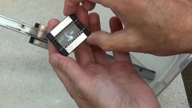

First step this morning was cleaning collets and shaft. Shame on me! Way more dust trapped in collet than I’d have imagined. Ditto for the inside off the shaft. Used a pipe stem cleaner and flexible straw to get shaft clean. About 15 minutes to do a really good job. Then started to run dome model as Bozo suggested. Gantry got close to work and jumped. Hit Pause immediately. Turned off CNC and the right side jumped, like the right stepper had just been released.

Machine is off. Left motor frozen in place.
Turn machine on. Everything frozen (normal). Click Initialize. Gantry jumps and left Y motor doesn’t move. Shut off fast.
Bits of belt on left pulleys.
For a machine w/ linear rails/blocks do they need to be lubricated?
Undo the left belt and verify if the motor is frozen, or the linear bearings are.
Just did and it’s not the motor! Separated the Left Gantry Endplate from its Carrier Plate. Moved Gantry all the way to the back. Left Carrier Plate will barely move - about 1/8"! Detached Left and Right Belts at front.
Remove Left Front Endplate. Carefully pulled Carrier plate off rail. Only lost one bearing. Cleaned raid with brass brush. Only thing I saw was belt dust. Don’t see any damage to rail. Cleaned blocks; not much there. Attempted to reinstall Carrier and lost several bearings. Am I supposed to inject oil into the tiny holes between the tiny screws at the front and back of the thing that houses the bearings? If so, HOW? And how do I reintall the Carrier on it’s Rail withought loosing its bearings - or mine?
However, when I had that issue, I flooded them with wd-40 to flush them out, then followed it up with some vactra 2 oil. I was not going to disassemble my rails.
