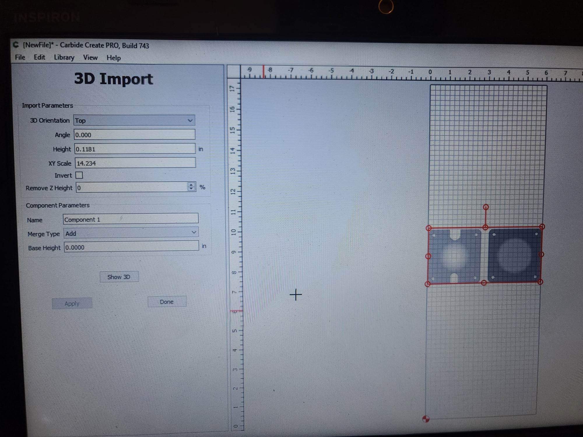

Is there a way to get CC to import the model at the sizing it was created at? The model is created to spec to fit together with other pieces with aligning bolt holes. When I import it imports in at an arbitrary size and the only way to size it I have found is dragging the corners. This makes it very difficult to get them to an exact size. For instance these are designed at 5" squares and this is how they import.
If I understand what your asking on the design page you can make a square and set your measurements and when you upload the grayscale image into that box it’ll fit into that space
The model will scale to the size of the workpiece, or any object that is selected when you import.
It will do a “Fit” to the object or workpiece.
Your model looks like it’s 5" tall, by 10" + the space between the 2 square objects.
So make you workpiece 15" x 5", then import. It will scale to 5" tall. Or if you know the exact width of the model, use that.
You need to set the Scale value to 1.0 and then the Height to match the physical size of the model.
Interestingly, mine come in at a scale of 25.4 (stl was saved in Inch.)
So it looks like CC imports in metric only. Even if my units are set to Inch.

The STL file is unitless. But if it was output from an inch model, a 12’ long solid will output as 12.0
But if output from a metric model, it will output as 304.8 (actually 3.048e+2)
