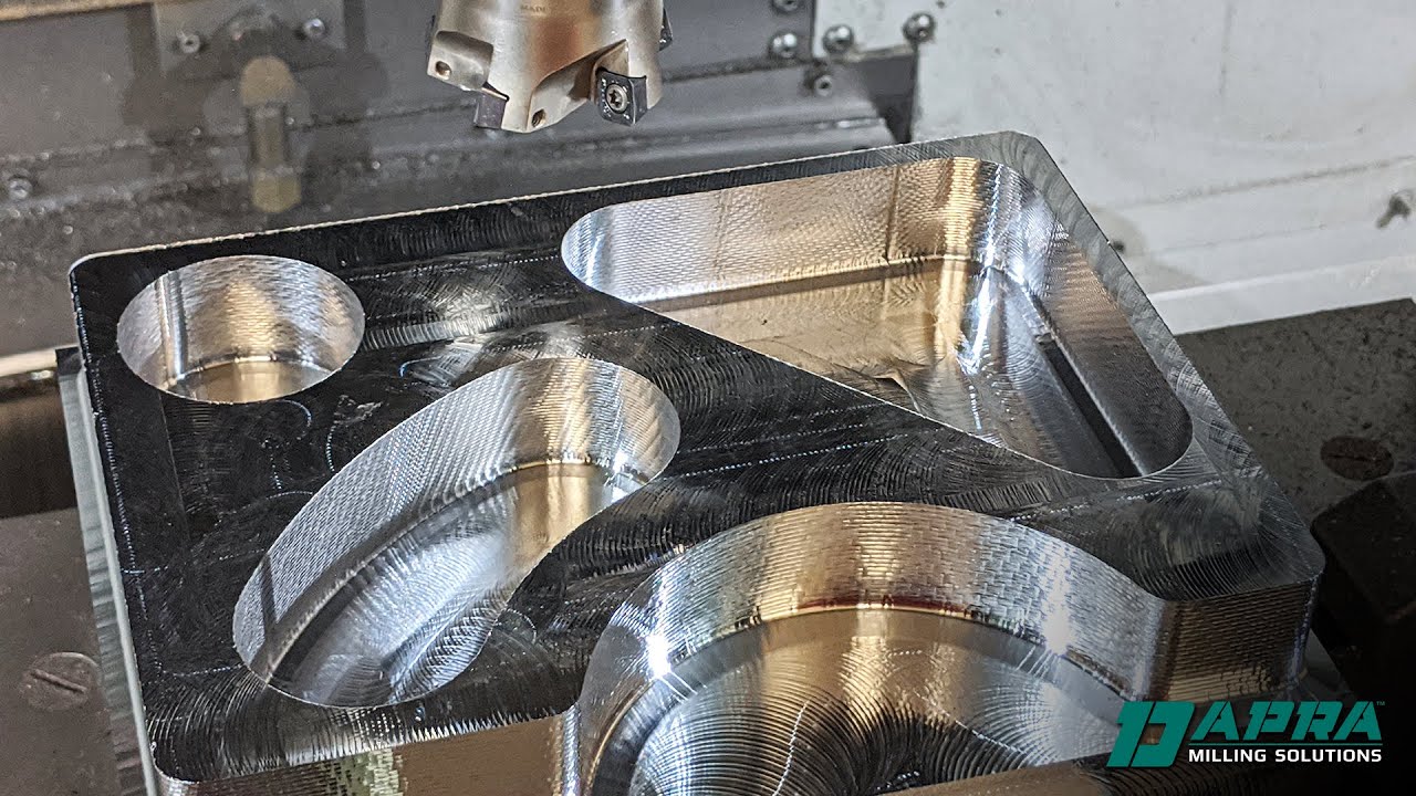

I’m going to link a YouTube video, I know absolutely nothing about programming but this looked very interesting.
I do this for holes. Use a tool a bit smaller than the hole & “Hole Mill” it, rather than drilling.
Here’s the sample part from the video, scaled down to use a 1/4" tool…
Some things to note. You have to adjust the ramp angle based on the size of the feature being cut.
Larger features require a smaller ramp angle to get roughly the same depth per cut.
CC likes to conventional mill. Notice in the video he’s climb milling. (<— Another shameless plug for climb cutting :wink: )
Ramping in CC starts right on the part surface. If you want a little bit of lead in, make the toolpaths a little bit deeper, and offset your Z zero on the machine by that same amount. i.e. Your pockets are 0.500 deep, so I program them to 0.520, and when I set my zero I touch off to the top of part & enter -0.020 in the Z register.
I set my depth of cut in the file to 0.490. This forces a rough/finish strategy. The tool will ramp down to 0.490, make a flat cut at that depth, then ramp down to 0.500 & make another finish pass.
high_feed_ramping.c2d (224 KB)
I take a similar approach. I generally cut phenolics, so assume I want a pocket .20” deep. I will turn on ramping and put my start depth at .19”. I don’t think this would work with aluminum but it works fairly well with phenolics and hard woods. I also crank up the plunge rate so it’s a fairly quick operation.
