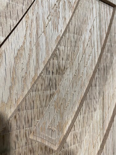

Hello I just installed the z plus with the inducts. Since then after homing my zeros all all off. Also my z is not the same. I set 8 mm pocket 1/4 end. Then 1/8 inside left for cleanup at 8mm and they cut at different depths. This is after I reset the z after installing the new bit.

Today I told it 4mm inside left and 4mm pocket. And still left a ridge. To get rid of the ridge I moved the bit to the low spot and ran it again and that’s what happened it just lifted in the middle of the pocket and continued the pocket

@yeti To be honest the marks you are seeing look more to me like mechanical ‘slack’ in your system rather than lost or gained steps. Slack can result in too deep cuts in one direction and too shallow when the same axis reverses direction, good cuts until some stress on the machine happens etc.
I would be inclined to make an assessment of belts, pulley set-screws, vee-wheels, general fixing tightness etc., and a look at tramming. With this all done, if the problem is still there then maybe lost steps is what is happening - to my mind the causes of this are: high cutting force (blunt tool, excessive feed rate, very hard wood), high speed direction changes, too high setting for acceleration in the Grbl $ entries
