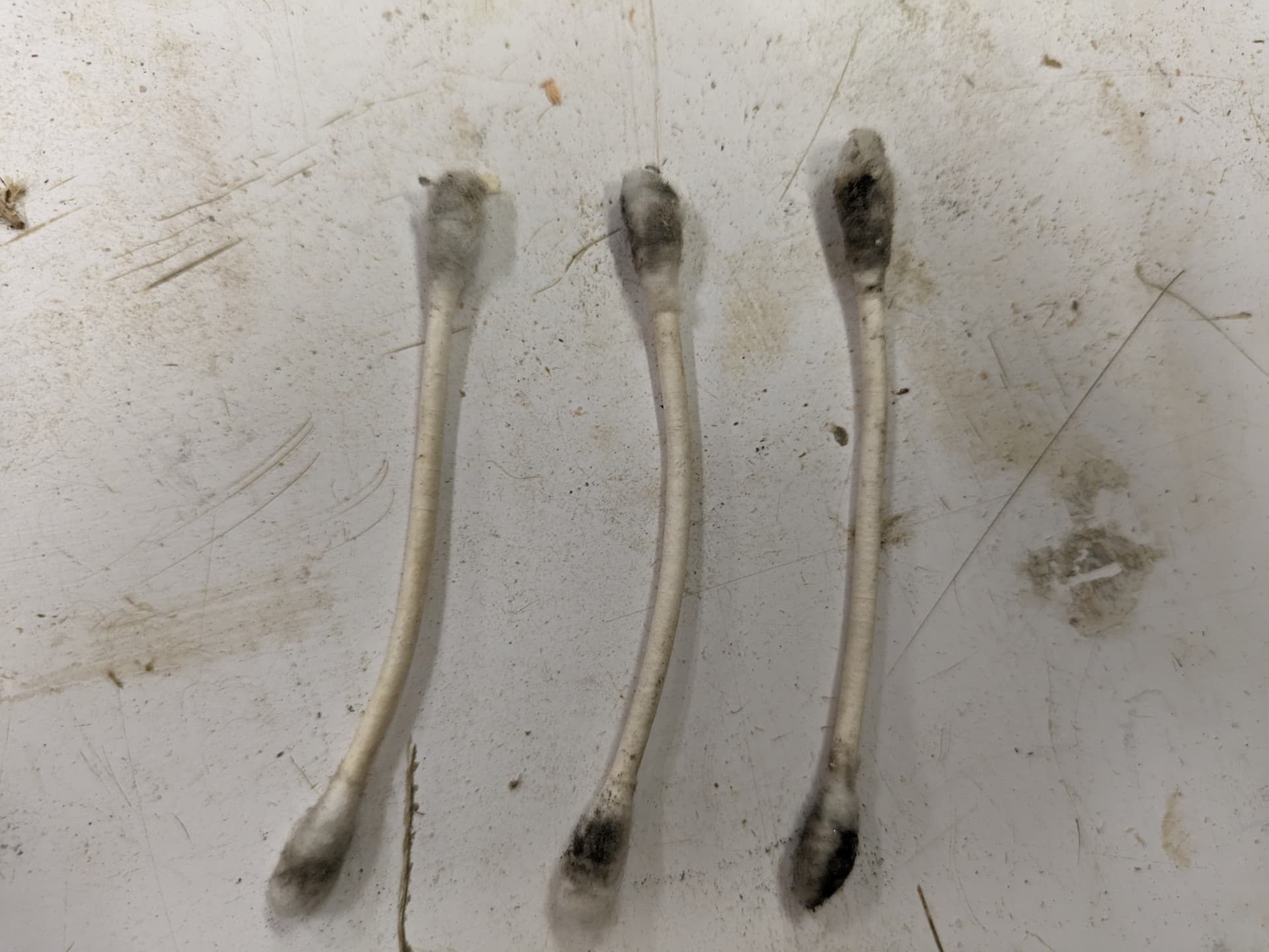

I have a long 4" OAL 1/4" bit I use for its 1.5" cutting length. I have always had that bit come somewhat loose likely due to the increased vibration of its long length. However I was cutting out a robot for an automaton I am working on for a 2x4 contest. I was a little ways in cutting the figure out and noticed that the bit was taking about a 1/4" bite. I stopped the Shapeoko 3 and the collet on my Dewalt router was loose. I just stopped the job and took the bit out and cleaned the collet and router inner shaft. I was surprised at how much black dust was inside the router shaft. I have never cut anything black and still do not know where the black dust came from. I cleaned the collet with brake cleaner and sprayed the brake cleaner on some q-tips. I had to use 3 on both sides to get the inner router shaft clean. After the cleaning the collet nut did not come loose for the rest of the job. I have had issues with that particular bit loosening slightly so I occassionally pause and check the tightness of the collet. I am sure that is due to the increased vibration of that long bit.

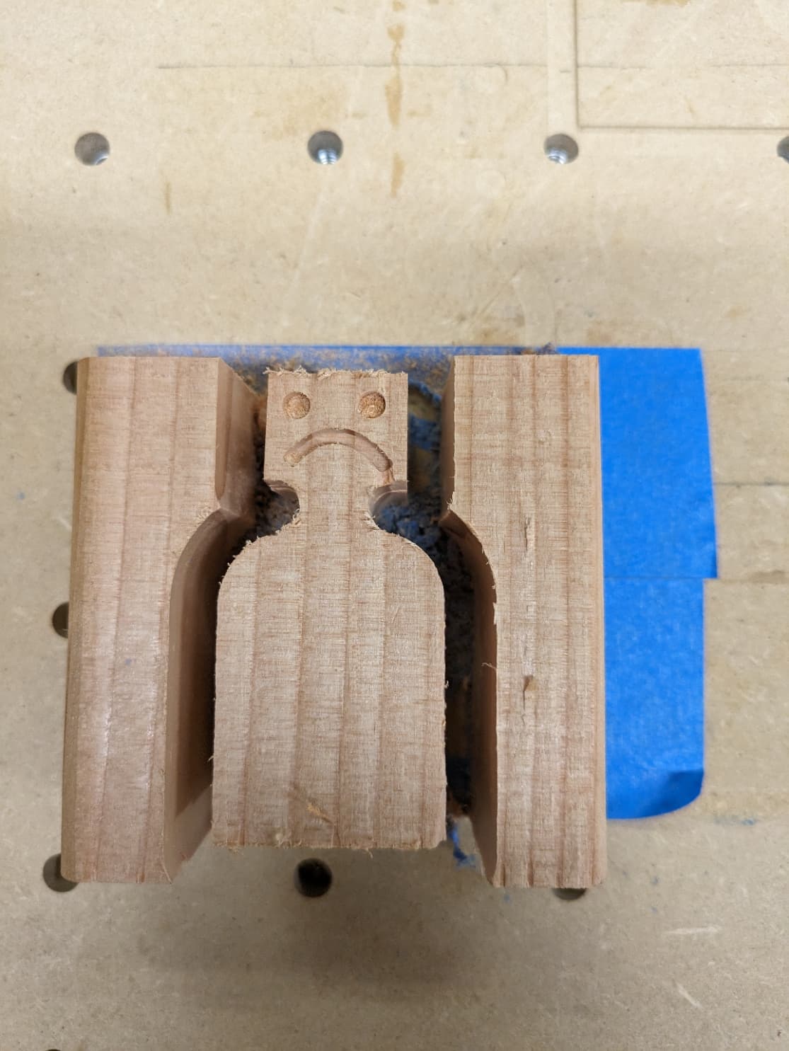

In this picture you can see the line where the bit came loose. Luckily I did not have to replace the material and it cut the rest of the way fine. I sanded the line off and it turned out well.
I wanted a face on the robot body and decided a frown was appropriate for the overworked robot.

If it was dust (and not just dirty oil), it could be carbon from the motor brushes. On these routers, usually air is drawn through the body of the router from the top down.
Anything is possible but the router blows the air down and the dust collector sucks it away. Perhaps it is metal dust from a slipping bit but it was a lot and I looked at my bits and they all look fine with no marks or gauling on them. It may remain a mystery.
The point is about cleaning your collet. If you dont have the spray brake cleaner you could use aclohol if you have that. When finished make sure everything is dry and lubricant free. A periodic cleaning is in order. For me I had just cleaned the collet about 2 weeks ago.
