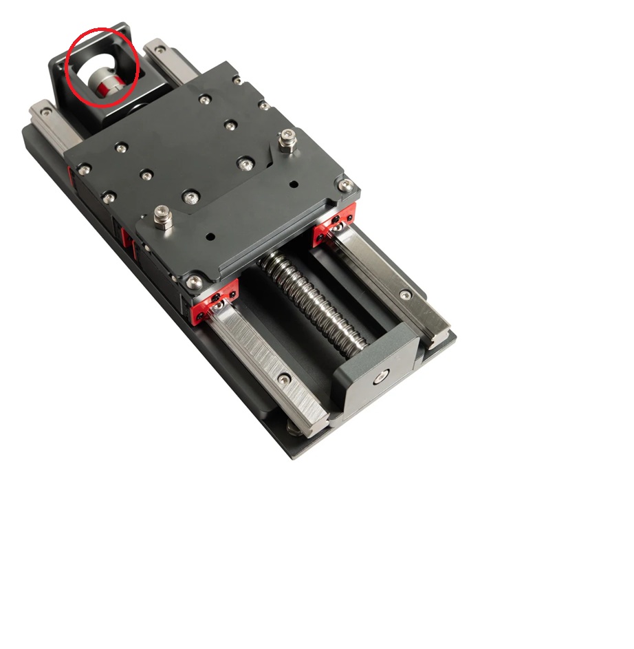

Usually when people lose steps on Z it is because of aggressive depths and excessive speeds. If you feel that is not going on maybe check the coupling at the top of the Z. There is a coupling just below the Z stepper motor that joins the motor and the ball screw. Some people have had the set screws come loose and cause depth issues.
Additionally have you oiled your linear bearings? You can just wipe down the rails but to do it properly you have to remove the z to get to the screws on the bottom set of bearings.

All the large screws I can find around the coupling area were super tight. Its been lubricated but maybe not enough or using enough oil. It wasn’t used much for a stretch.
The statement about removing the Z makes me question if I’ve done it wrong. I can’t just remove the bottom screws and add oil from underneath? It appears viscous enough to not drip right back out before the screw is reattached.
Possible issue when I just checked. One of those bottom screws was missing. I do always run a shop vac and Sweepy but debris could have been getting in there. I relocated a screw from the top and taped over the hole on the top until I get a spare.

You can wipe off the rails and oil them and then oil the upper bearings. Eventually it will drip down. You could just oil the upper ones on consecutive days to speed up the drip down. The recommended C3D procedure has you remove the Z and turn it upside down and oil the lower bearings. The main thing is that the bearings and rails get lubricated.
If you do add oil then wipe off the rails at the bottom before running a job and place a paper towel under the Z when it is parked overnight. Oil will drip down and could ruin a project or drip oil on your spoilboard.

My information came from experience. I have had an HDZ for over 5 years. The lower bearings have a screw over the oiling port. That screw is on the bottom of the bearing. The top bearings the oil port cover screw is on the top. So the only way to get oil on the lower bearings is to take the Z off and oil the bearings. The alternative is to put enough oil in the top for it to drip down to the bottom bearings. The Mobil Vactra #2 is not super thin but it will drip down because gravity is pulling it down. That is why if you oil your bearings and rails it will drip down an get on your spoilboard and/or your project. Generally after a few days the oil will stop dripping down. I just watch the bottom of the Z rails and if I see an excess of oil at the bottom I wipe off just the bottom of the rails.
It is your machine so you can follow any procedure you want. C3D does make good machines and has good support and a great forum of experienced users but like you I think their documentation has always been lacking.
The Z does need regular maintenance on any CNC that uses linear bearings and ball screws. There is a lot of friction with the Z traveling up and down over and over at high speeds. The Z is in a very dusty environment even with dust collection. Regular cleaning and oiling is needed to keep your machine in good shape.

Not blaming Carbide but honestly, when I received the machine the rails were quite dry. I saw the maintenance instructions said add a few drops periodically. I’m not a super mechanically inclined person but I will read the manual and do what it says. This did not make me think lubrication needed a lot of attention. I do understand your explanation why it does. A couple times yesterday I thought I saw and heard the Z axis bind a little on the down cut.
I lightly oiled last night. After watching video, went back this morning and re-did it, except for the Z removal. I was able to remove the bottom screw and inject oil from underneath to the bottom bearing without making a huge mess leaking out. Ran the machine around half dozen times to distribute.
Then ran a few test jobs again similar to yesterday. No problem with results today. Ran a surfacing program then drilled about fifty 1/4" x 1/4" holes across a large area. Last one was the same depth as the first.
For now all is good I will feel better after I run a batch of larger jobs again the next few days. I’ll also plan to check and re-oil more frequently.
