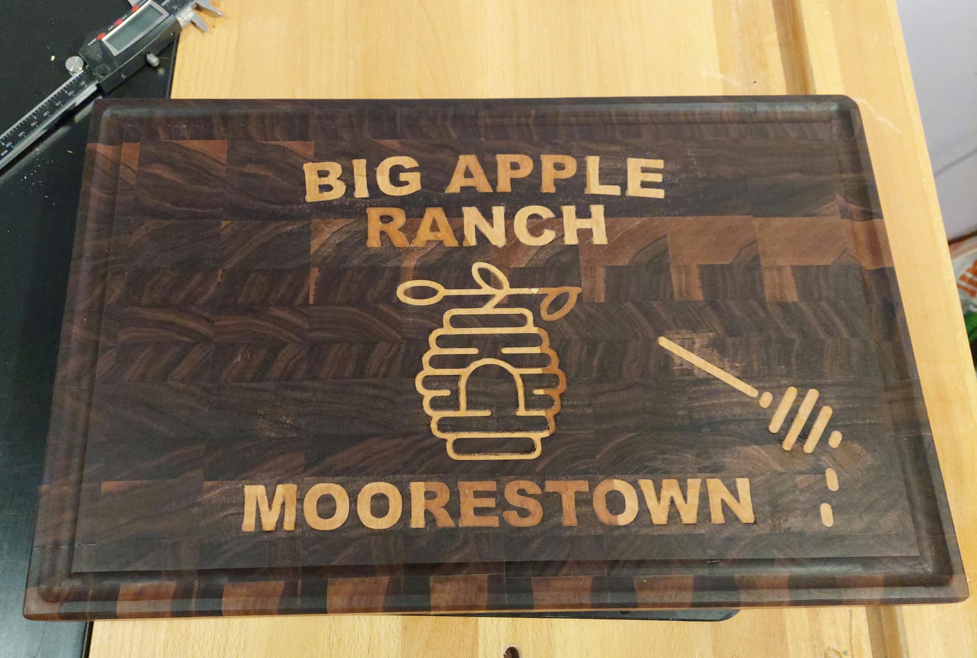

@NYC_Woodworker_17 How deep do you set your inlays on end grain boards?
Costs three hugs! JK. I make lots of gifts for friends and family. Maybe down the road I might do it for clients, but not yet. I think a company like The Boardsmith would charge $400 for a custom inlay walnut cutting board (at least, that’s what they quoted me 3-years ago). Might be more today.
I came to CNC from a carpentry background, so I’m used to workflow with planer and jointer, but you can do same surfacing tasks with router, or 65mm spindle. Use an endmill like the C3D McFly.
Go the full Monty and get the Spindle such a better tool. Also check into the PWN Cnc Spindle system, saves a few bucks and go for the air cooled.
I make the inlay plugs ~.45" inches on a 2" thick cutting board. Probably thicker than I need to, but it offers flexibility for surfacing the board to final thickness (1.75").
I appreciate the reply. I’ve been wanting to try an inlay cutting board for a while now but wasn’t sure how they would hold up. A thicker / deeper inlay makes a lot of sense.
