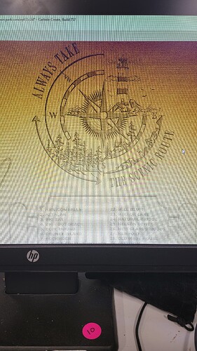

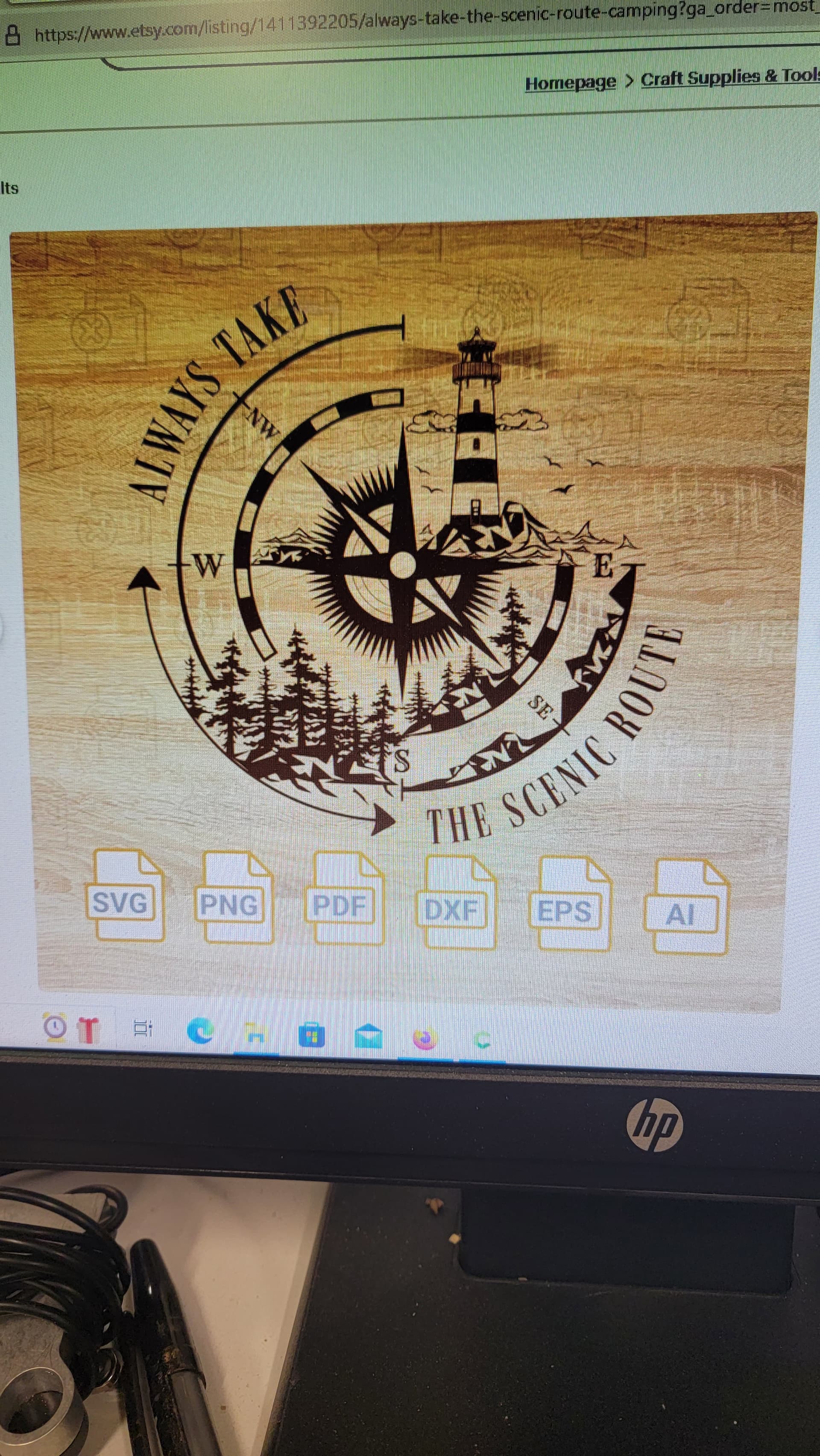

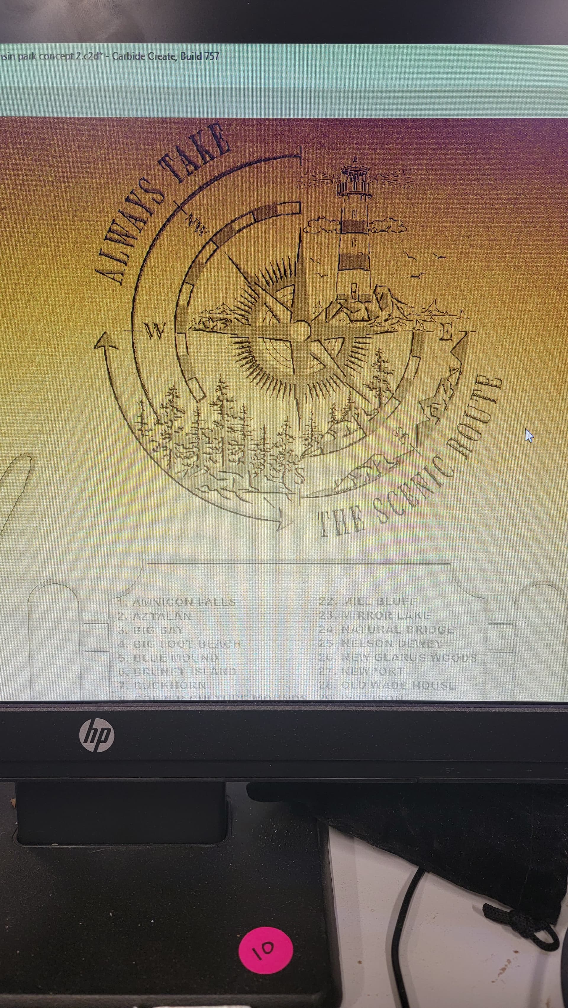

I am wondering if there is some way that I can share a project from carbide create with someone with more experience then me. I’m learning feeds and speeds, but I am still very confused by the concept. It could even be me picking the wrong tool path, but I am making a project with multiple designs and when I pick the tool path to cut out 2 designs with an advanced V carve tool path it is estimating over 700 minutes. I even doubled the max cut per pass.
I would be grateful if someone could look at the project and tell me if that’s just what it will take, or am I making some kind of mistake.

I dont have the tool path off hand, but I can say that im using an advance V carve with a 30° v bit and a 1/16 end mill. For both bits I have used the feeds and speeds that came with them. Everything bellow will be in inches
Both bits had the max depth per cut set at .025
Step over for both i dont know exactly but it was very conservative. If it helps, i am using IDC woodcraft bits
1/16 end mill
Plunge-10
Feed rate-20
Rpm-22000
30° v bit
Plunge-20
Feed rate-35
Rpm-22000
For size reference, the numbered words bellow the image are a little shy of 1/4 inch tall
For size reference, the numbered words bellow the image are a little less than a 1/4 inch
