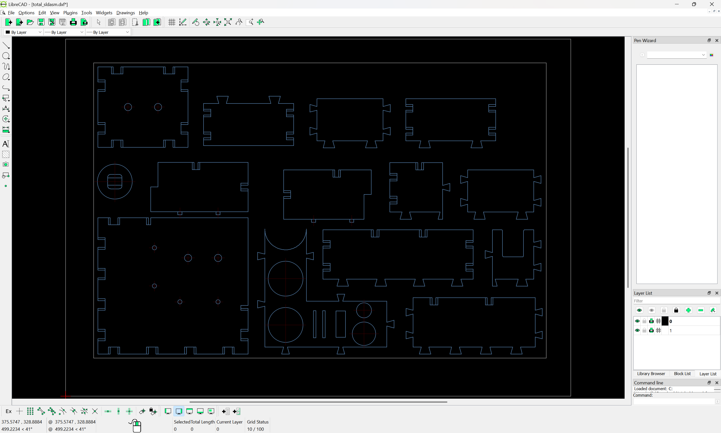

Just to give you an idea of what you are in for, here is a screengrab showing how things are laid out in the DXF:

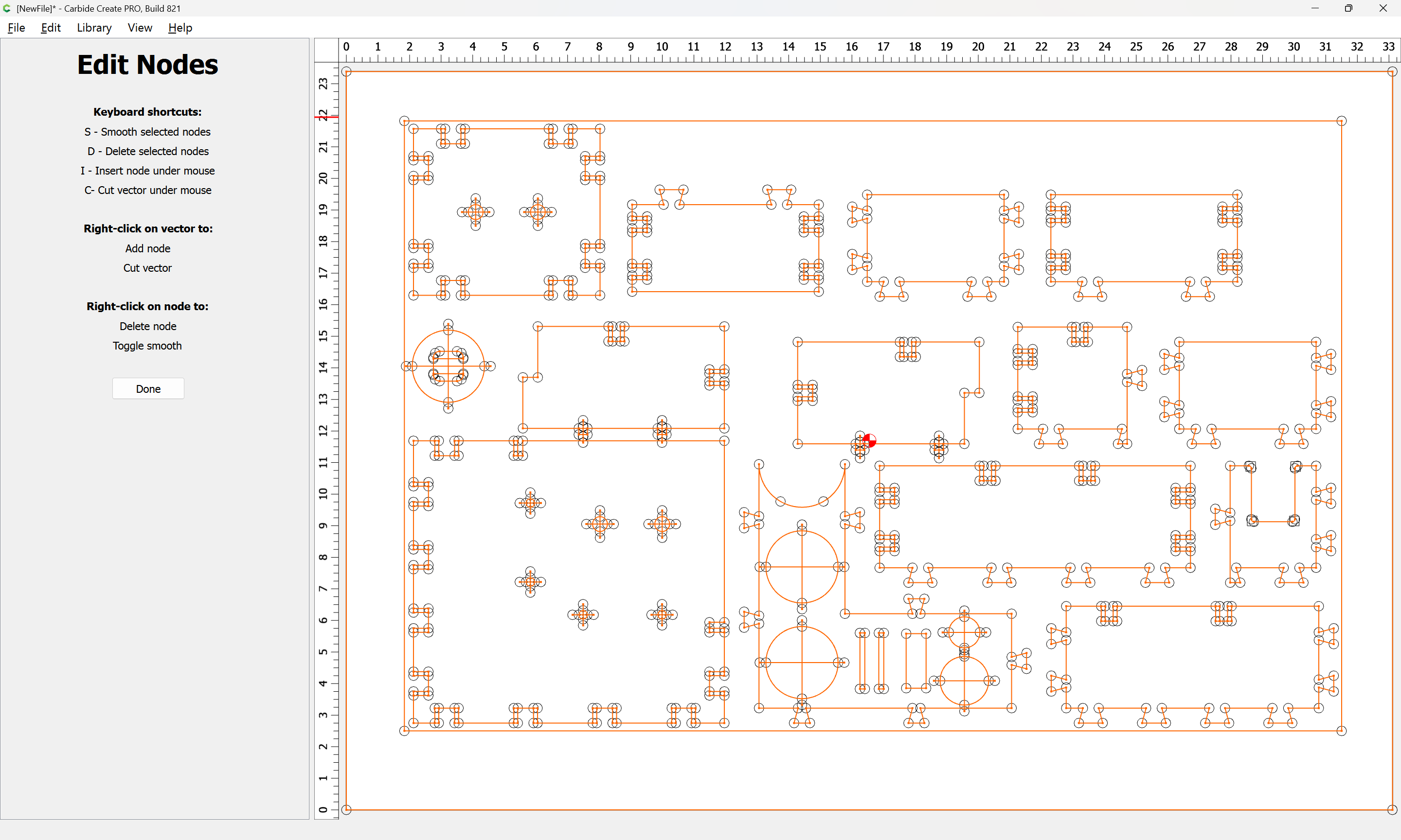

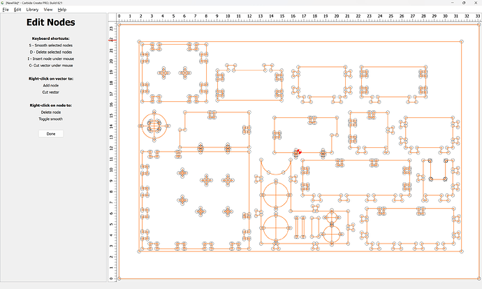

Note that the joinery is drawn in, and expected to be cut in 3 dimensions, which will be rather difficult to achieve in Carbide Create, also, importing the DXF directly will result in polylines, rather than curves. Exporting as an SVG from LibreCAD and then importing into Carbide Create will yield a better result:
