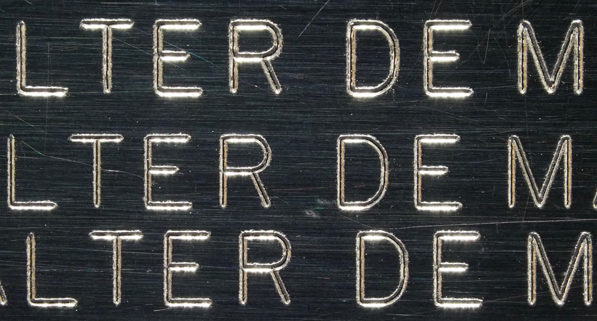

Here is detail pic of the test bar.
Top row engraving was made by a commercial engraver using settings recommended by the manufacturer of the machine. The font is exactly right because this company (Gravotech) is what remains of the company that made the pantograph engraver used back in 1966 (New Hermes). The defects are artifacts of the rotating spindle, which was suggested to use when the machine could only make faint lines otherwise.
The second engraved line is made with a Shaper Origin. I was pushing it to or a little beyond it’s limits here. You can see some lines are wavy but the line thickness is good. There are too many chances to screw up (36 characters in all) with this handheld machine.
The middle line is made with the Nomad 3. Good straight lines with consistent thickness but a little light. Well worth refining.
Fourth row I made with an old pantograph engraver. More than enough line thickness but it is inconsistent because of my lack of skill. No reason to develop the skill other than for this project so it’s really impractical. You can also see where the tracing stylus skipped out of the groove in the Master Copy and scratched outside of the line.
Bottom row was made by another commercial engraver. They couldn’t get heavy enough lines either so turned to and outline font and fill.
My original task was just to find a commercial engraver to fulfill the contract. Ended up being my problem but I’m getting close thanks to the help I’m getting here.
The letters are only .077" tall and it’s an art project so pickiness rules.

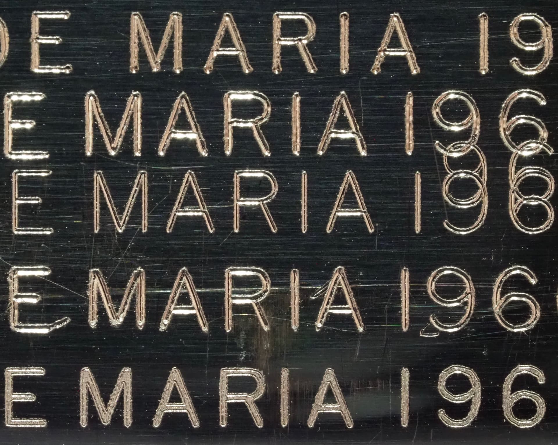

I think I found the recipe. Maybe need another thou of Z.
Took the tool out and compressed the thing completely with a small Quick Grip. Found out there were a few more thousands of contraction than I thought so added a couple to the beginning and end with three .0001” passes between.
Top row upper image is the new result.

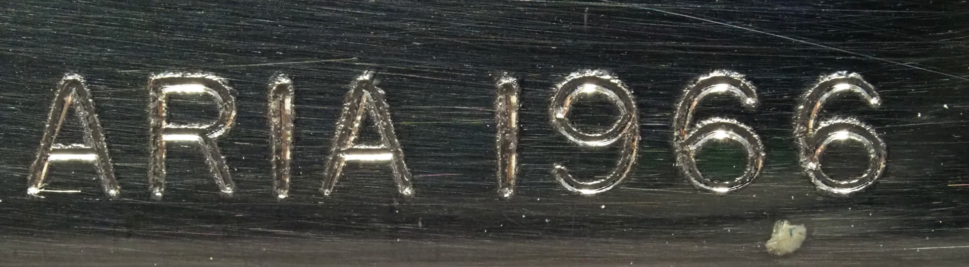

Lower image is the original engraving we need to match.
Don’t have to match original handmade idiosyncrasies like the tapered number 1.

The rotary spindle on NH engravers had an adjustable nose (nicely polished with rounded edges) that literally rode the surface of the stock being engraved. I suspect the guy who engraved the object I’m duplicating used that spindle with the motor turned off (maybe with Scotch tape on the bar to protect it) and the nose piece prevented the diamond from reaching the surface near the edge of the bar were polishing made it less thick. Hence the tapered vertical elements, thinner closer to the over-polished edge.
