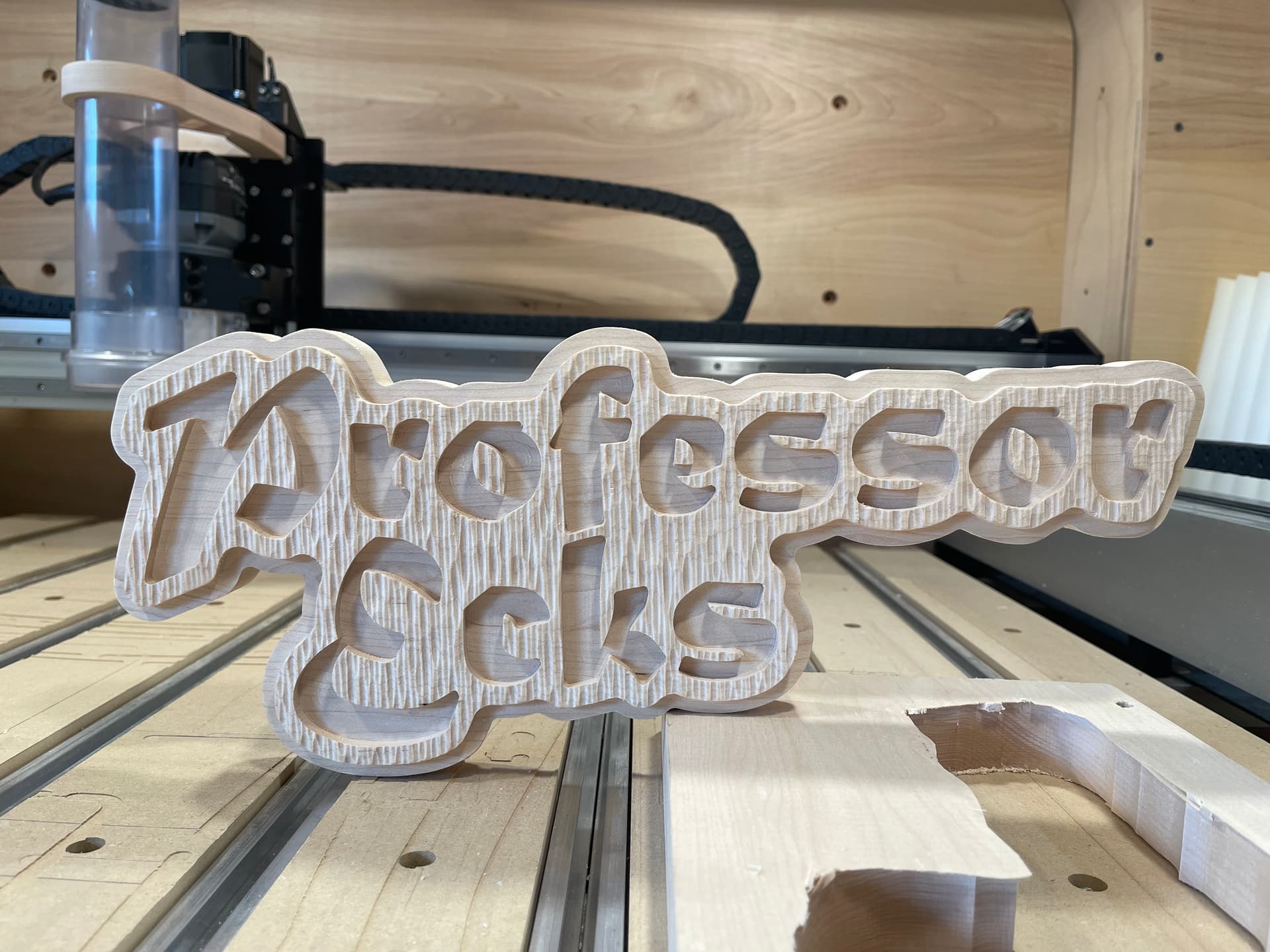

I’ve been thinking about some designs using a texture, but hadn’t worked with textures at all yet, so decided to do a test, and it came out nice enough that I’d figured I’d share how I did it.
I used an 1/8’ ball endmill for the texture, an 1/8” straight double flute for the letters, and a 1/4” upcut for the border and cutout. Soft maple.

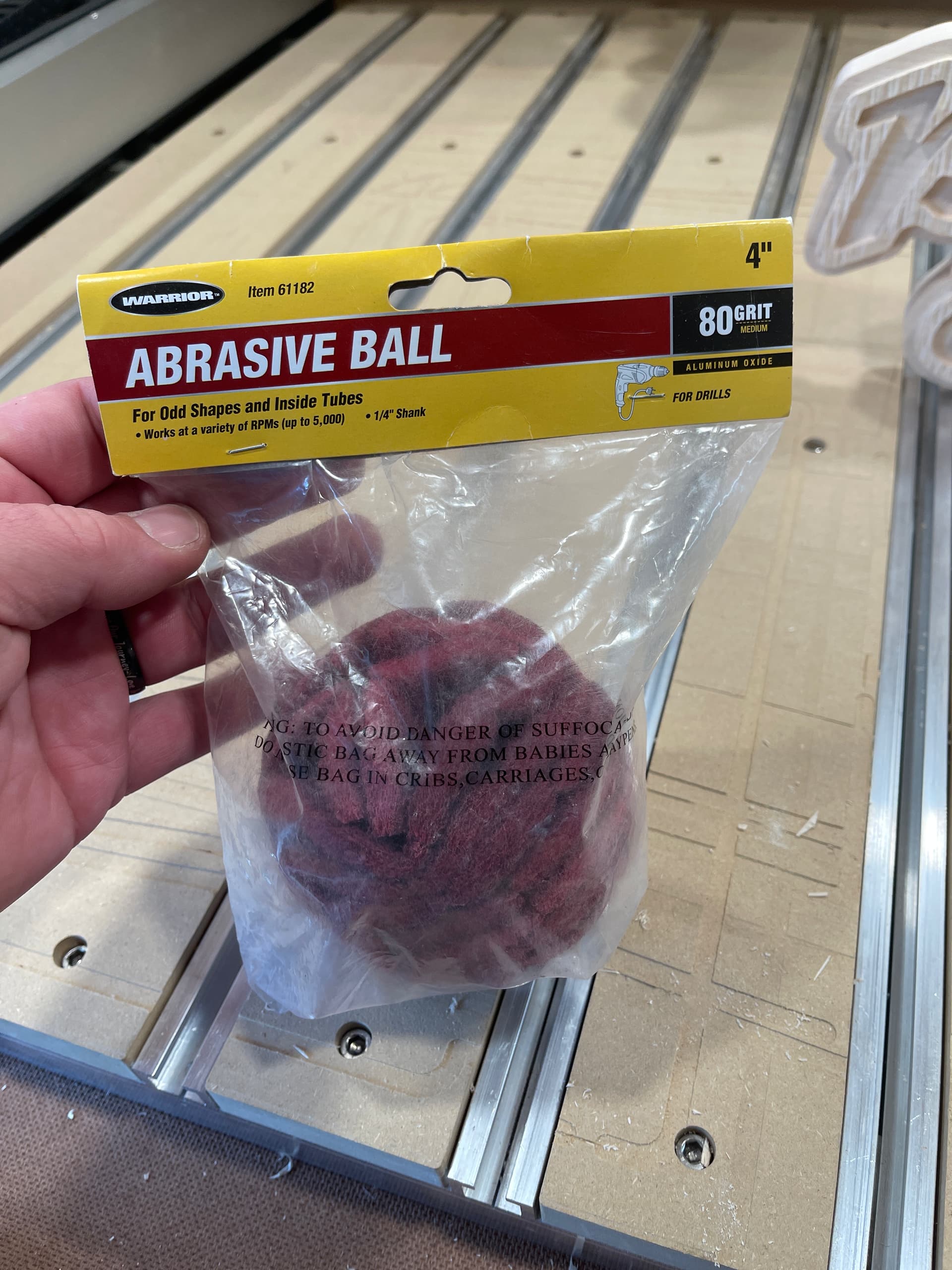

The texture needed some sanding and I used one of these abrasive balls from Harbor Freight in the drill press. First time using it, and it’s AWESOME.
Nice job. Looks great
Very nice! I need to get a better variety of mills.
Nice job! Thanks for the tip on using an abrasive ball; I’ve tried one texture on a sign and wasn’t pleased with the resulting hairy look, lol.
how did you tool path or create the texture in cad?
I used the texture feature in carbide create. Experimented with the settings until I got something I was happy with.

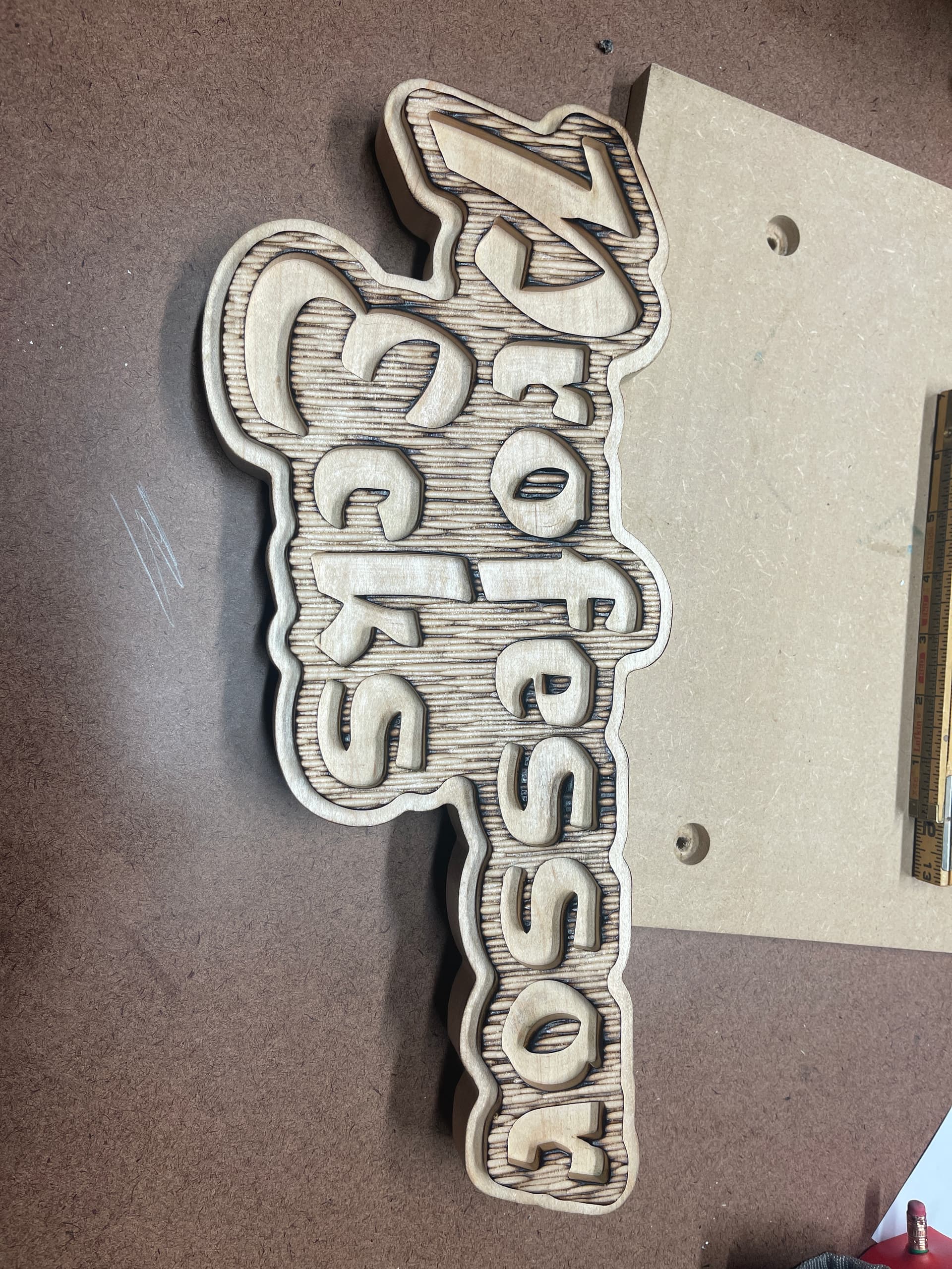

Btw, update - playing around a bit, I decided to burn the surface a little with a torch and I really like how it came out. Makes the texture pop
