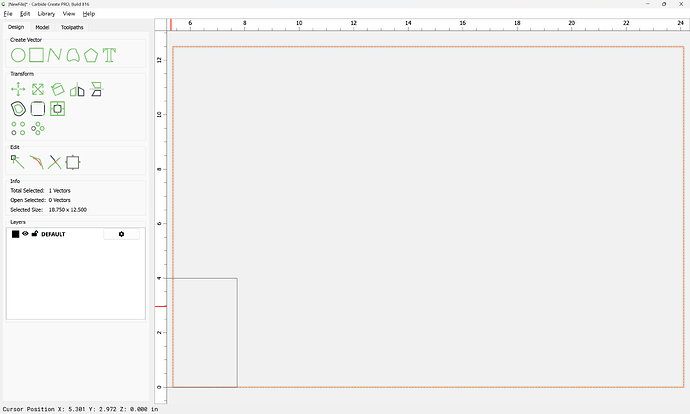

I have some aluminium dog tags that I want to engrave using my diamond drag engraving bits. The dog tags are anodised aluminium and are about 1.5mm in thickness. The most effective method I have found previously for engraving dog tags is to hold them in a shallow jig so that they cannot move laterally while being engraved. I use CT90 as my workpiece surface lubricant. This works well with a diamond tip traversal speed of 500mm/minute and leaves a good finish, provided the depth of engraving is set to 0.25mm or less. A well-chosen single-line font completes the task.
I scanned a dog tag and turned the scan into a .png image file and then traced it with Super Vectoriser Pro. The resulting .svg file was the perfect shape. Other than its size, which I would fix in Affinity Designer for my jig carve. I exported the file and brought it into CC and created the design on the substrate at the appropriate size and then set the toolpaths for the carve. I set the machine on its carve and was dismayed to see the beautifully formed jig was sized too small, in every dimension, to accept the dog tags. Grrrr… I swore rather loudly and shouted a stream of invective that many Brits will recognise.
I had forgotten that Carbide Create expects all .svg files, created in other vector illustration packages, to be saved at 96dpi. I was annoyed with myself for missing this vital step but it is getting rather old and I would like to request a change in the code. All vector files are considered to be resolution independent and Carbide Create requires all vector files to be a set resolution of 96dpi, which could usefully be addressed. Please! Pretty Please! With a cherry on the top… can vector file resolution be independent, just as it is in every application that can utilise a vector file format? My idiocy has resulted in much wasted time, work energy, material, and extreme frustration. Cheers! :beer:

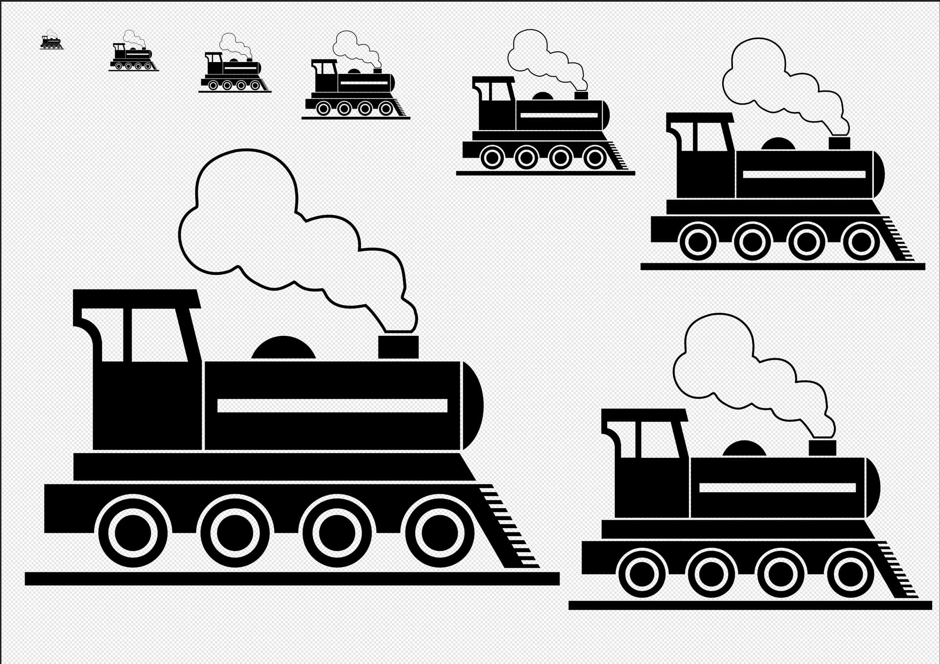

The screenshot below demonstrates the principle with a series of different-sized trains, which are all taken from the exact same file. The detail has not been changed in any of the images shown.
This is the resolution independence that all vector images are inherently capable of. People who use vector files expect to be able to resize them at will because this is a native property of the file format. Unfortunately, CC imposes and insists on an artificial file resolution of 96ppi if one wants to maintain the created size at an accurate 1:1 ratio. No other vector graphics software demands this precondition from a mathematical construct that is nominally free of every resolution constraint.

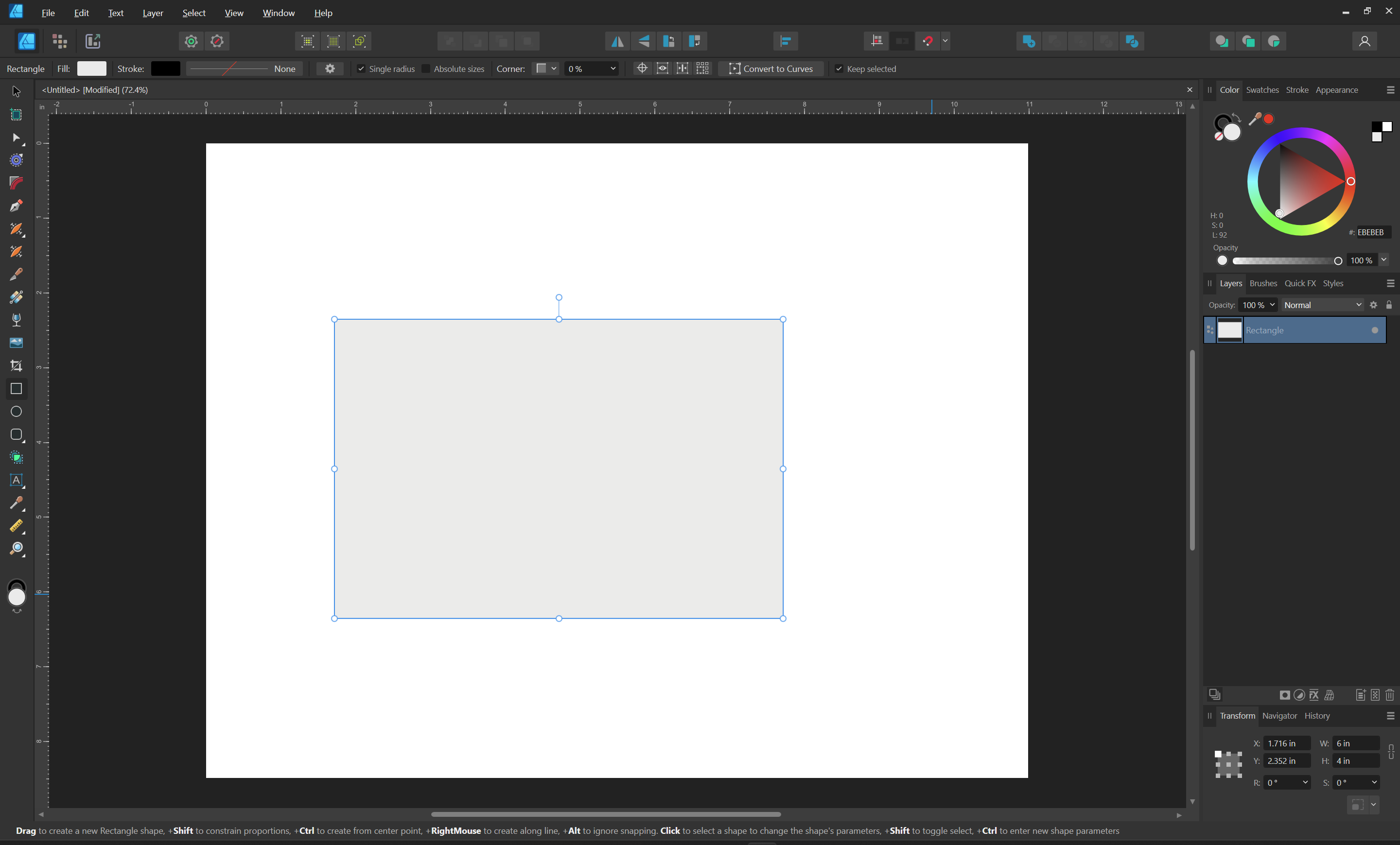

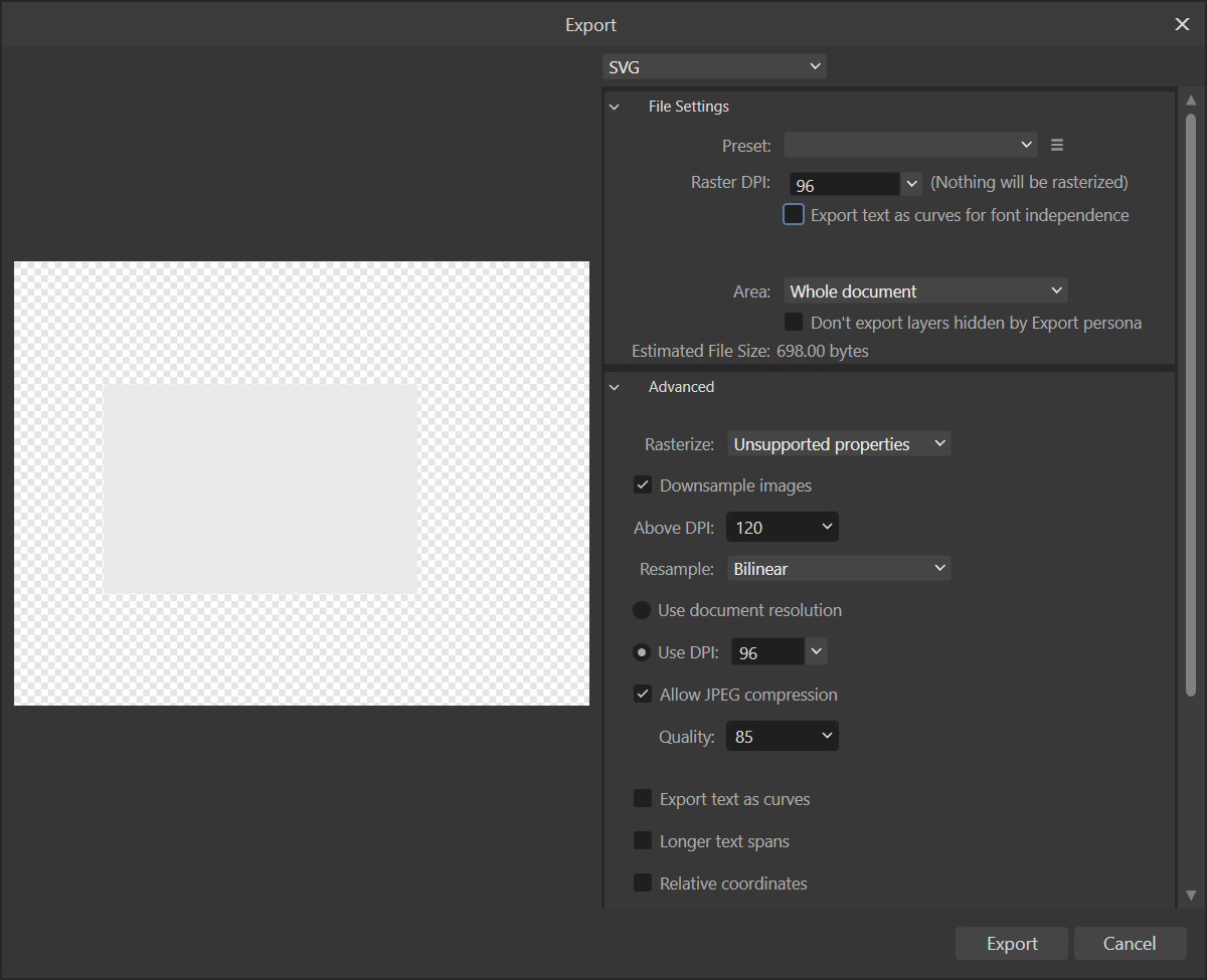

Note that SVG export from Affinity Designer:
has an option for setting PPI:
which results in a correctly sized import:

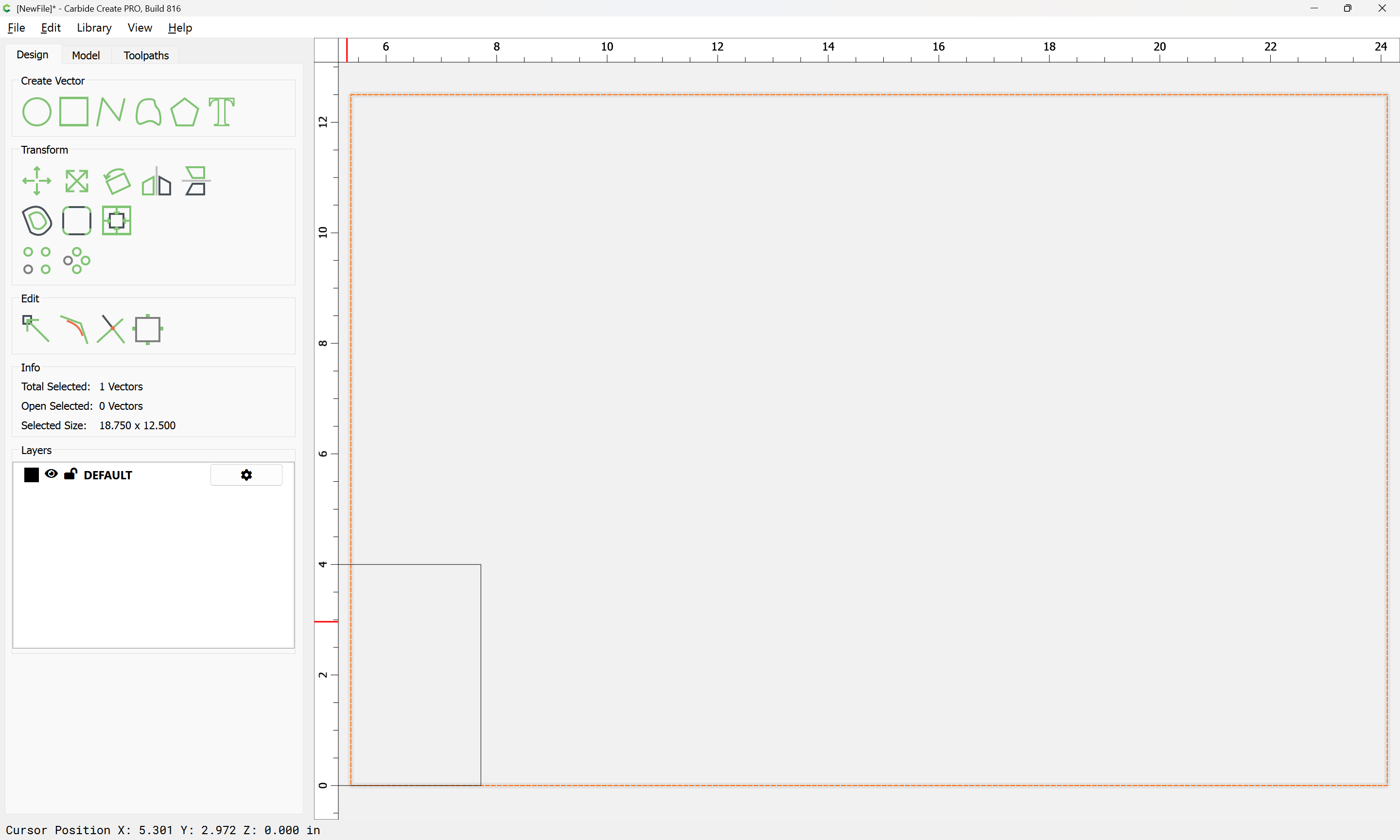

Yes, if you don’t set it, then the vectors will be exported at the default 300 ppi and come in at the wrong size:
You have to specify/determine/use a PPI in order to get something to appear in a working area at a particular size.

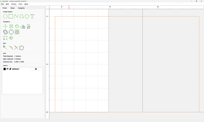

Contrast:
4x6rect
<?xml version="1.0" encoding="UTF-8" standalone="no"?>
<!DOCTYPE svg PUBLIC "-//W3C//DTD SVG 1.1//EN" "http://www.w3.org/Graphics/SVG/1.1/DTD/svg11.dtd">
<svg width="100%" height="100%" viewBox="0 0 3300 2550" version="1.1" xmlns="http://www.w3.org/2000/svg" xmlns:xlink="http://www.w3.org/1999/xlink" xml:space="preserve" xmlns:serif="http://www.serif.com/" style="fill-rule:evenodd;clip-rule:evenodd;stroke-linejoin:round;stroke-miterlimit:2;">
<g transform="matrix(0.949891,0,0,1.15919,25.8001,-112.345)">
    <rect x="514.88" y="705.734" width="1894.95" height="1035.21" style="fill:rgb(235,235,235);"/>
</g>
</svg>
(exported at the default 300ppi)

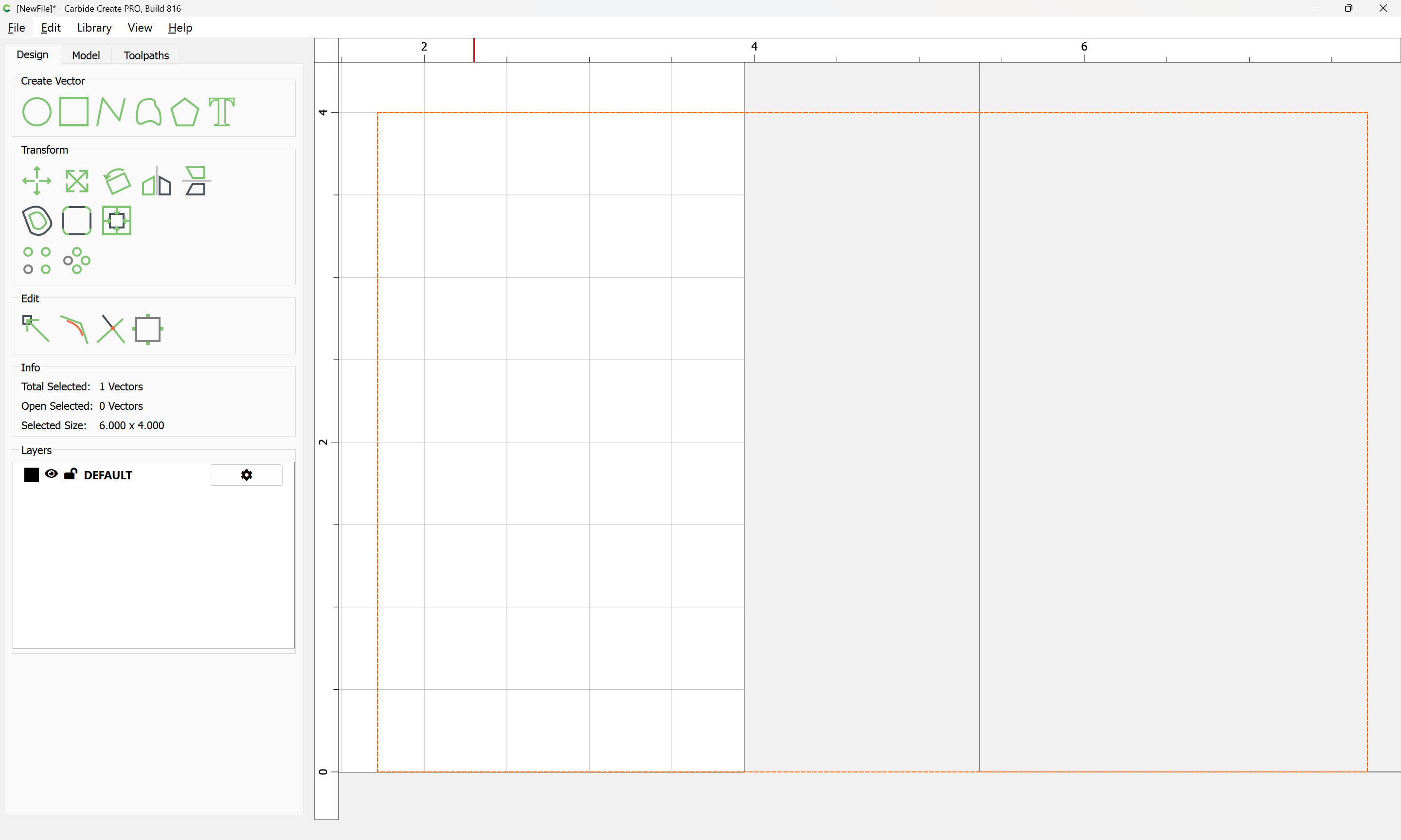

with
4x6rect_96ppi
<svg width="100%" height="100%" viewBox="0 0 1056 816" version="1.1" xmlns="http://www.w3.org/2000/svg" xmlns:xlink="http://www.w3.org/1999/xlink" xml:space="preserve" xmlns:serif="http://www.serif.com/" style="fill-rule:evenodd;clip-rule:evenodd;stroke-linejoin:round;stroke-miterlimit:2;">
    <g transform="matrix(0.32,0,0,0.32,0,0)">
        </g>
    </g>
</svg>
(obviously exported at the specified 96 ppi)
It will be, if the PPI is set to 96 ppi for import into Carbide Create.

OK, this explains it, I think… I exported a 1" square in a 2x2 workpiece.
<svg  version="1.1" xmlns="http://www.w3.org/2000/svg" width="144px" height="144px">
<path d="M144 0 L144 96 L48 96 L48 0 L144 0 Z " stroke="black" stroke-width="1" fill="none" />
</svg>
It’s storing the data in pixels rather than mm or some other dimensional unit. (inches, fathoms, furlongs, parsecs…). So it needs a dpi to convert pixels to inches or millimeters.
Whereas a similar file saved from inkscape outputs in millimeters…

Neither have dpi in the file that I can see ??
The Inkscape svg imports at the same size it was created.
There has to be a unit or a conversion or a scaling factor, either implicit or implied or assumed — for Inkscape see:
https://alpha.inkscape.org/vectors/www.inkscapeforum.com/viewtopic2577.html?t=20338
For Carbide Create, 96 ppi is assumed. Folks who are using software which does not support that should include a rectangle of a known dimension around their work and then select everything and scale to that size on import.
