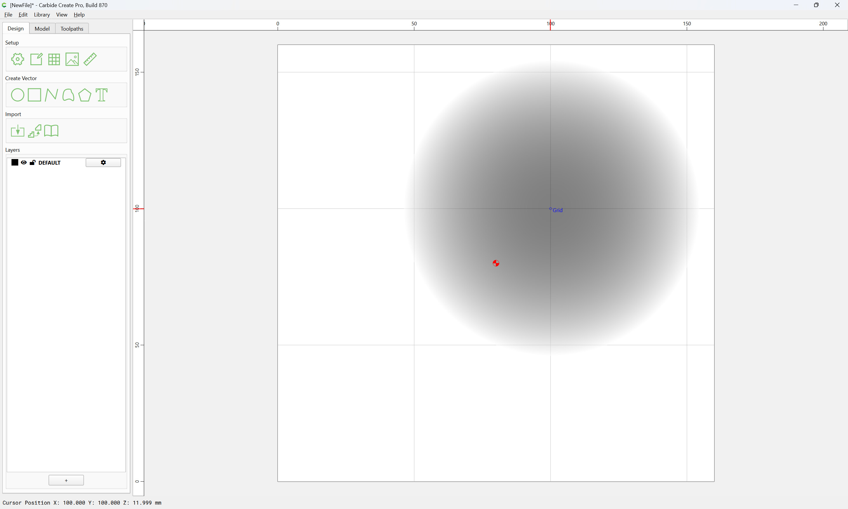

Note that the Status Bar in the 2D view does provide the depth of the 3D model at the cursor position:
(note the Grid and depth of 1.833mm specified in the Status Bar)

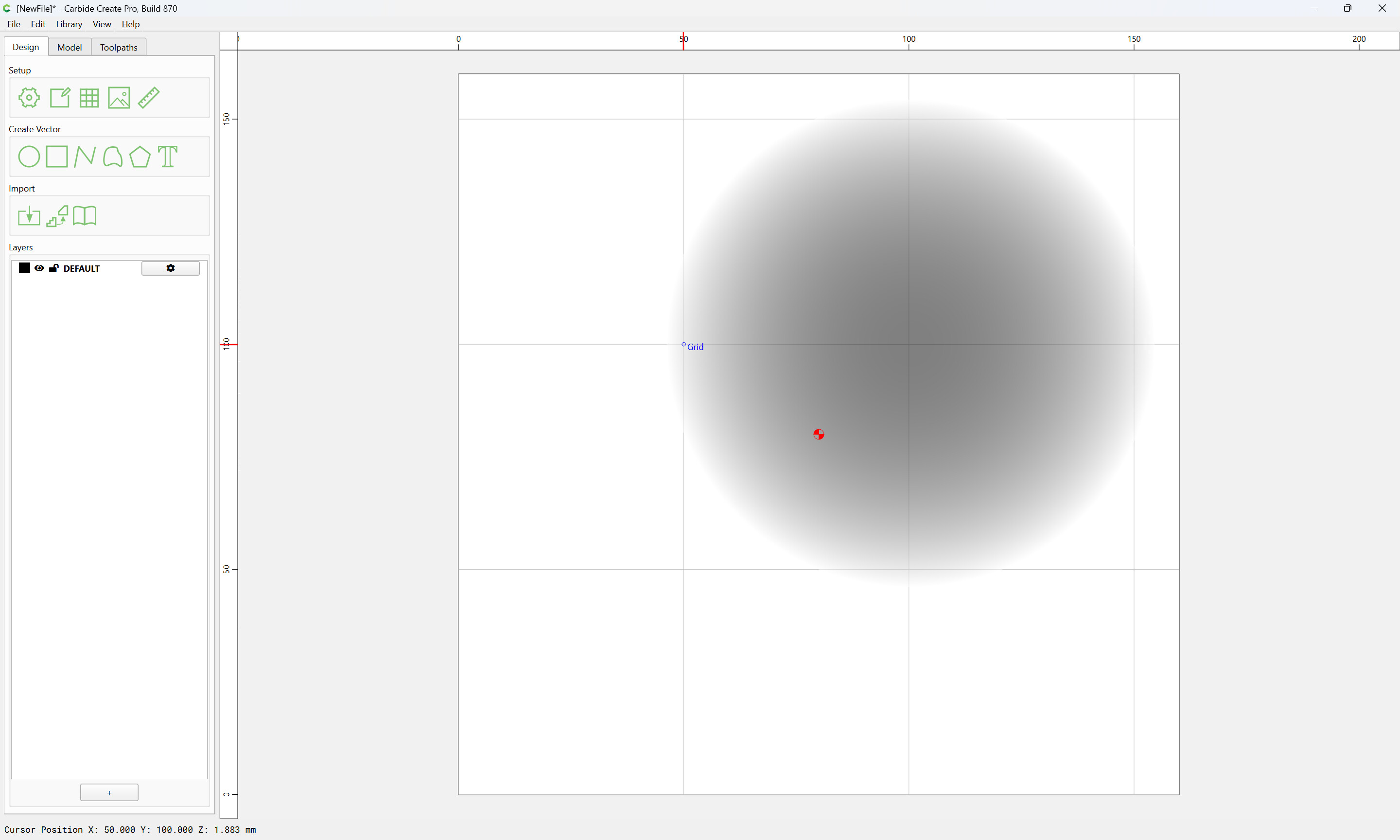

If the cursor is moved to a different grid position:
then the Z-axis height value changes to 11.999mm.
