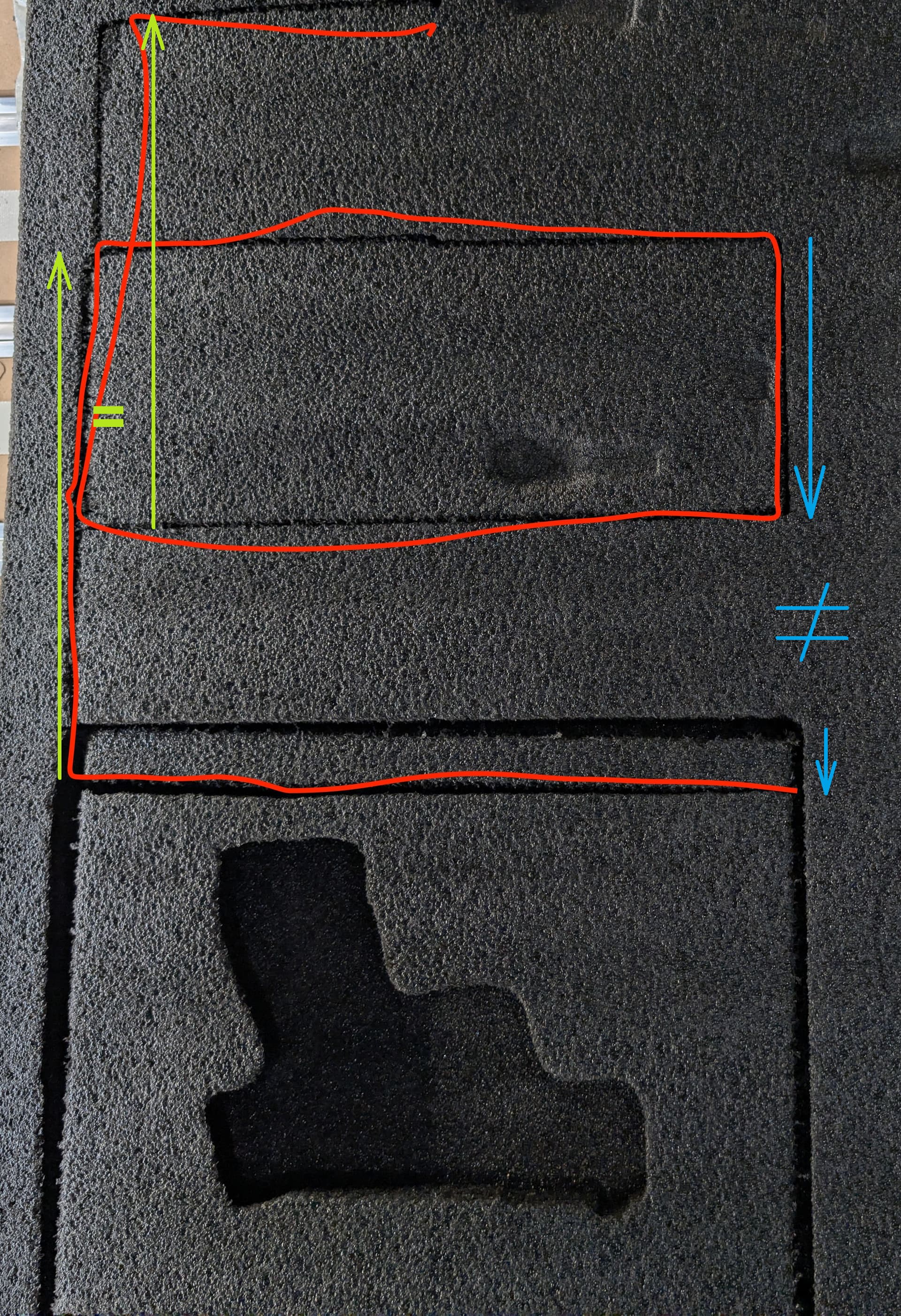

Abnormal behavior during job
I’m still learning this machine, so not sure what is the source of this behavior.

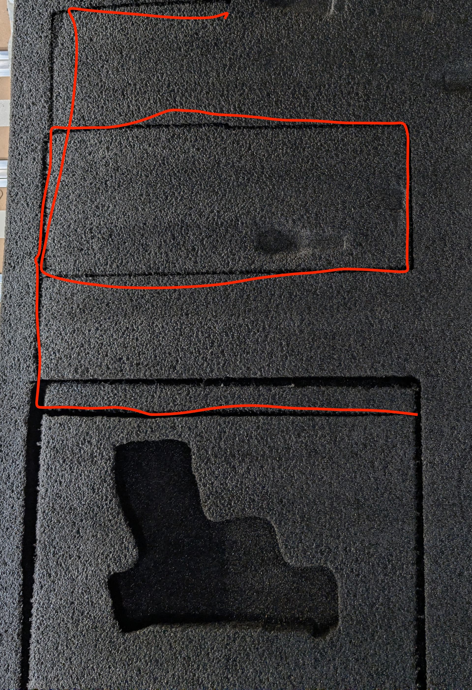

I have a pretty simple design, using foam. I have a relief (centered) with the intent to then do a cutout.
The relief went well, and the cutout was running fine, then ‘out of the blue’ it offset, did a cut, offset did a cut, until I hit the kill as I wasn’t sure where it would end up.
red lines in photo are the “unintended” cuts…

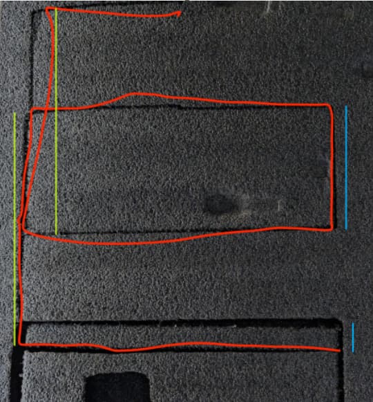

BTW the “up picture” moves (green here) look consistent, the “down picture” moves (blue) seem to be where the problem is…
You’re says that this suggests the the “down” (X right) is what’s being interfered with or failing, correct?
Yes, exactly. Here is a little better picture about what I mean (I don’t have CC so I can’t open your workfile to get which axis is which)

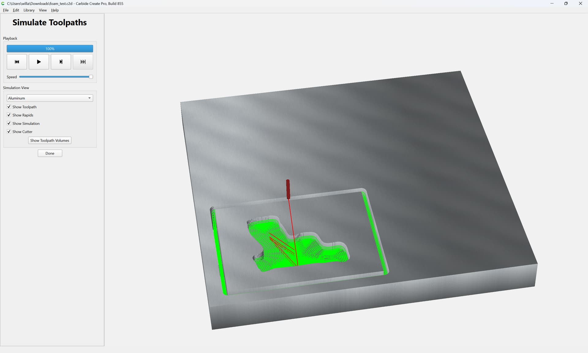

The C2D file has toolpath specified for the pocket, how did you define the perimeter cutout?
I wonder if the cutting bit was pulled away from its initial height position (after binding with material)
There is a significant difference in material removed left vs right, particularly where the lowest red horizontal line is
I used the ‘cutout’ tool path (vs a contour (CCPro 853))
