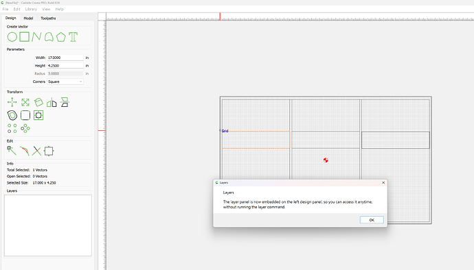

Just downloaded Create V8 and I cannot seem to figure out how to move vectors to different layers. When I click “L” for the old shortcut I receive the following message:
But when I look on the left side panel there is no way for me to change layers.
What am I missing?

Interesting, the layer panel should look like…
Was this an imported part from a previous version?

If you right-click at the top of the layer panel where that “DEFAULT” line should be…?
Did you create the part from scratch, or did you import it or open a part that was saved in a previous version of CC?
Try saving the part & re-opening it.

I have only used basic rectangles from inside carbide create, no imports. I have tried right clicking in the layers area, pressing L to have the layers pop up, right clicking individual vectors and right clicking multiple. Also have closed and saved the file, then reopened.

There have been a couple of instances of this reported, but no one has yet reported a step-by-step on how to cause this state.
Please send any such files to us at support@carbide3d.com
Please try opening this file:
blank_v8.c2d (44 KB)
Then if need be, import any problematic files and re-save them using new filenames to a local drive.

Thank you for the help. So I shutdown my computer, restarted it, copied the vectors and opened a new file… and what do you know it all works now.
