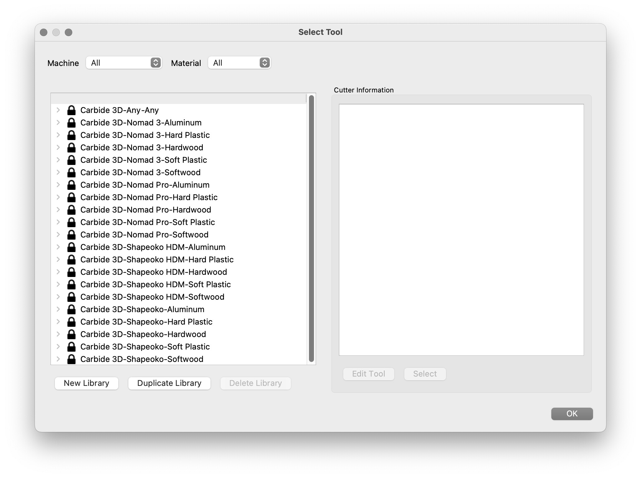

Then create a new user library using the “New Library” button:

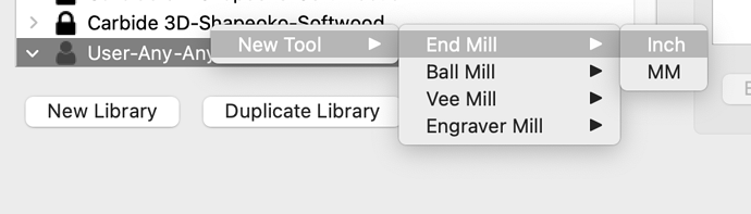

Then right-click and choose the initial specifics:

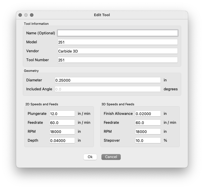

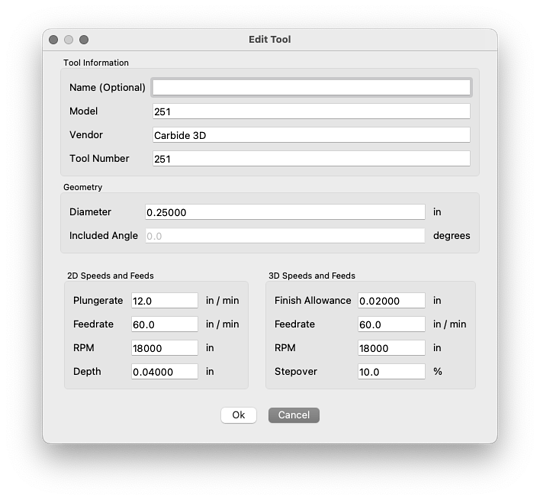

then fill in the appropriate values:
Ok
OK
OK
