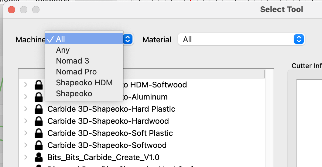

To expand a little on what @WillAdams and @Tod1d mentioned, pasting the Bits_Bits_Carbide_Create_V1.0.csv file in the Tools folder will make the file available when All is selected from the Machine options in the Select Tool menu.

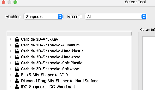

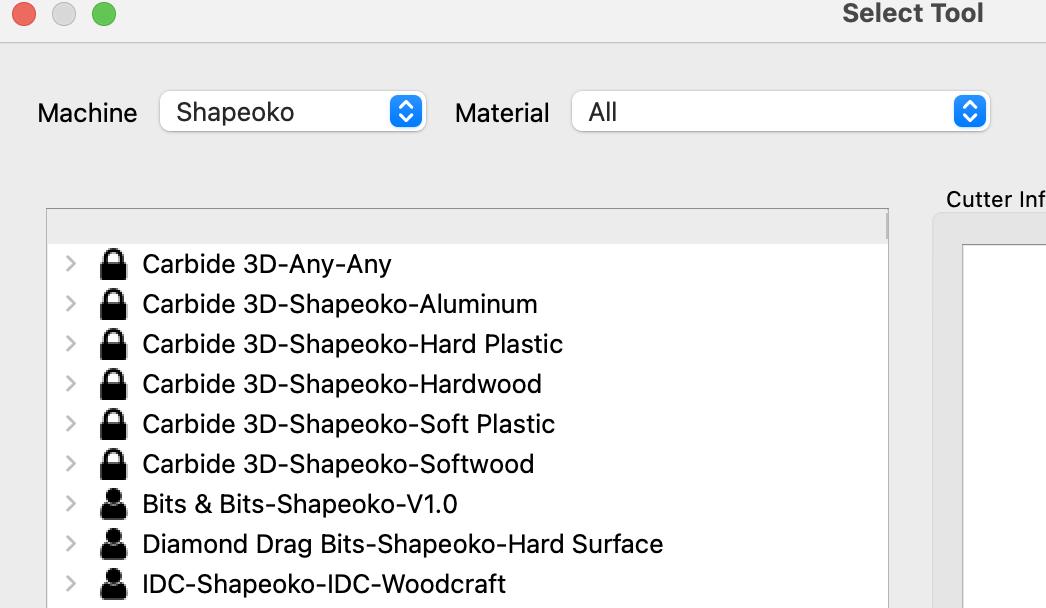

I normally leave Shapeoko selected under Machine options. To move those bits to only that machine option you’ll need to chance the file name to reflect the machine name. I renamed the.csv to
“Bits & Bits+Shapeoko+V1.0.csv”. Note the leading and trailing"+" sign before and after the machine name.
