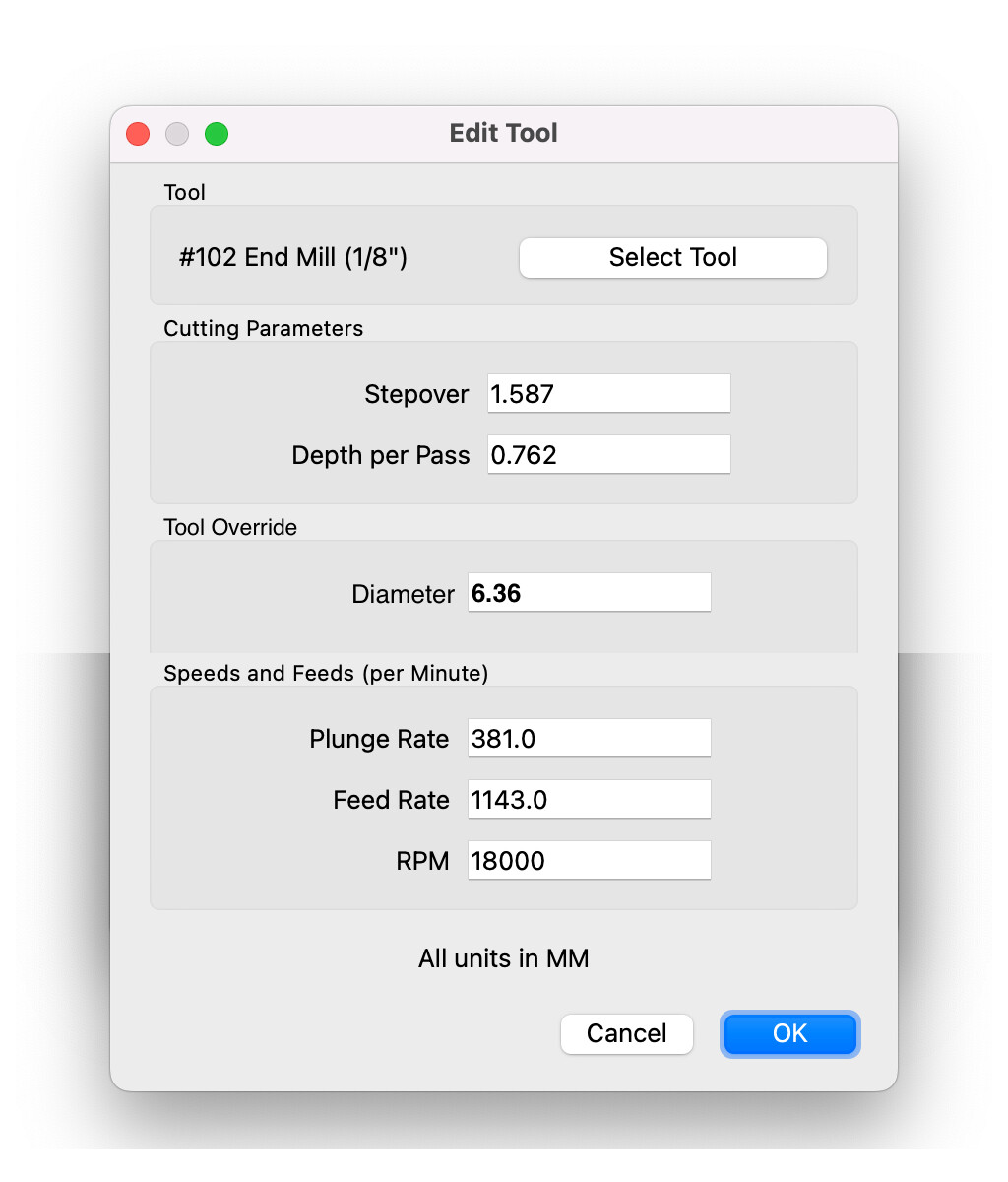

What I would love to see is some way to tell the toolpath directly: really, this is a larger or smaller cutter diameter than I told you it was. The way that the tool library is set up, though, I would have to duplicate an existing cutter, redefine its settings, rename it, and remember which one did the adjustment larger or smaller. The existing contour toolpath has a “stock to leave” feature, which can make a small object larger, but I don’t think it allows negative values. Further, this only applies to contour, not pocketing operations, and when cutting pins, the stock is held vertically, and while a contour operation could cut their outsides, it would never finish the cheeks of the pin tenons.

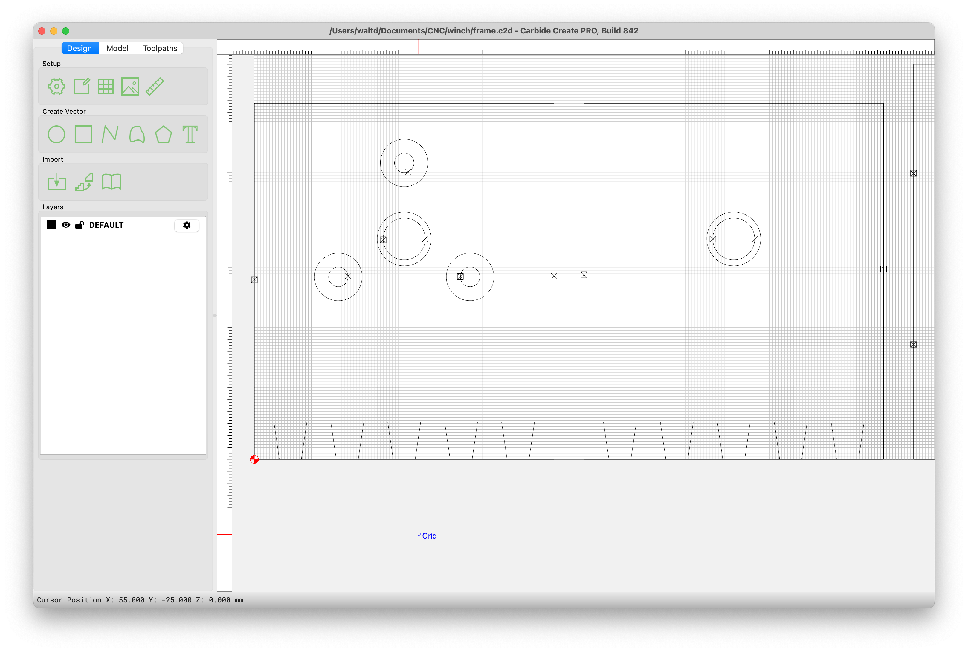

Thanks for the speedy reply! My technique starts by drawing the profile of one tail, so a simple keystone shape. I draw a rectangle, move into the node editing mode, and then shift two corners inward by the same number of grid intersections.
By step-and-repeating that shape I get a collection of tails. I can make them asymmetrical, add space for a box lid to be sawn away, etc. I group them, then do a boolean operation on a board-profile-shaped rectangle, and I have a matching set of pins, which I cut vertically with a pocketing operation.

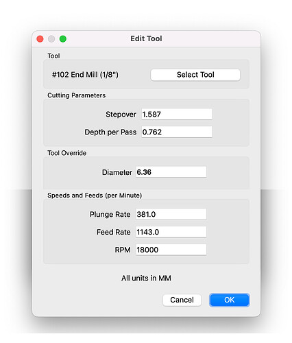

I still think that the custom tool (lying to the program about the actual cutter dimensions) is probably the route I will need to take, but it would be excellent if there was a field in the Edit Tool dialog to override the tool library’s global cutter diameter parameter. That adjustment would stay local to that particular toolpath, so that I could use the same literal tool in another toolpath without those amendments, and I also would not have to wait through a “tool change” that did not involve any sort of actual cutter replacement…

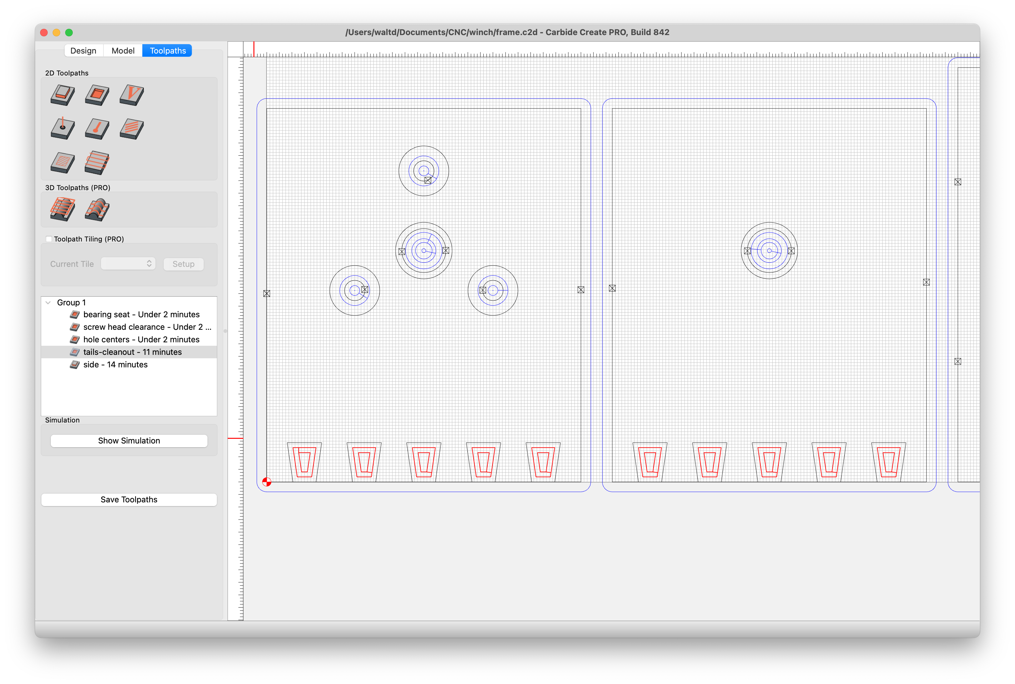

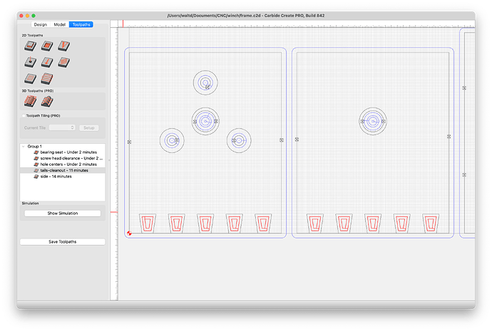

This is the tails. I use an 1/8 cutter, and a safety-sided triangular file to clean out the corners. These are cut with a pocketing operation, because tabs in here would be a mess.
Then the pins are made by taking a set of tails, drawing a rectangle around them, and a boolean operation makes the inverse set of outlines:
And those get cut in a vertically-oriented setup in another pocketing operation.

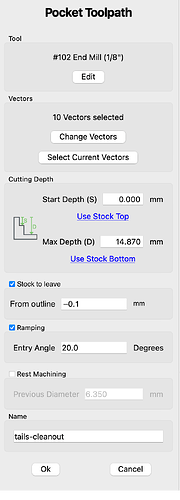

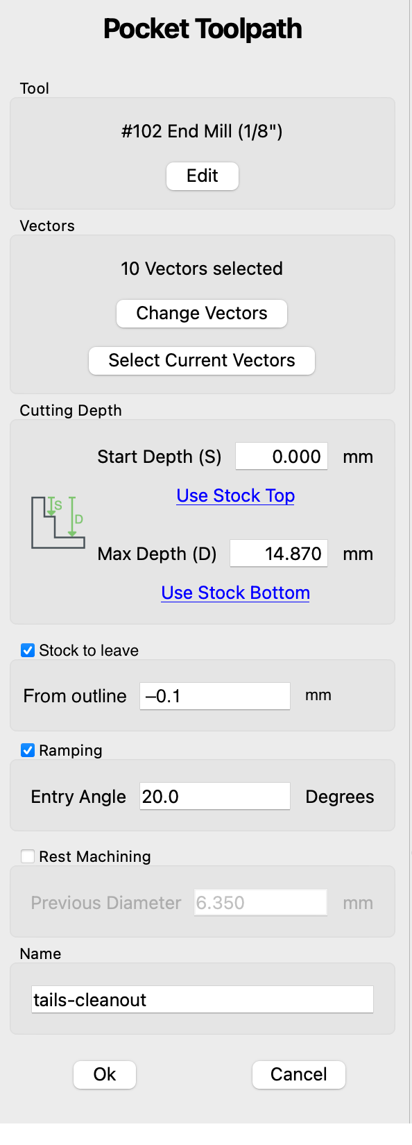

So both the tails and the pins are based on pockets, and because of the way I use them, I can’t use the one adjustment provided there: stock to leave.

In the first, a local override of the tool diameter would allow you to cut larger or smaller than the path by telling CC the wrong diameter.
In the second, you could shift the outline in (like regular stock to leave in an outline cut) or with a negative number, out.

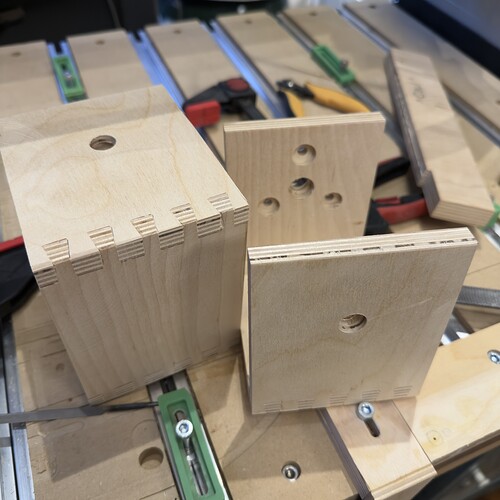

If I could figure out a way to do that, I am sure I would like it as well. But this time, I changed too many things at once (bad science, I know) and it all worked out perfectly.
Actual BB grade baltic birch, and most importantly, a much more fanatical job of setting the xyx at the corner of my upright panel jig.
I think what happened the first time (in addition to the funky wood) was that my zero point was too far toward me. Cutting a wedge shape like this makes that also adjust the width of the pins, and the joint is quite sensitive to those changes.
Glue is drying now, everything fit together perfectly.

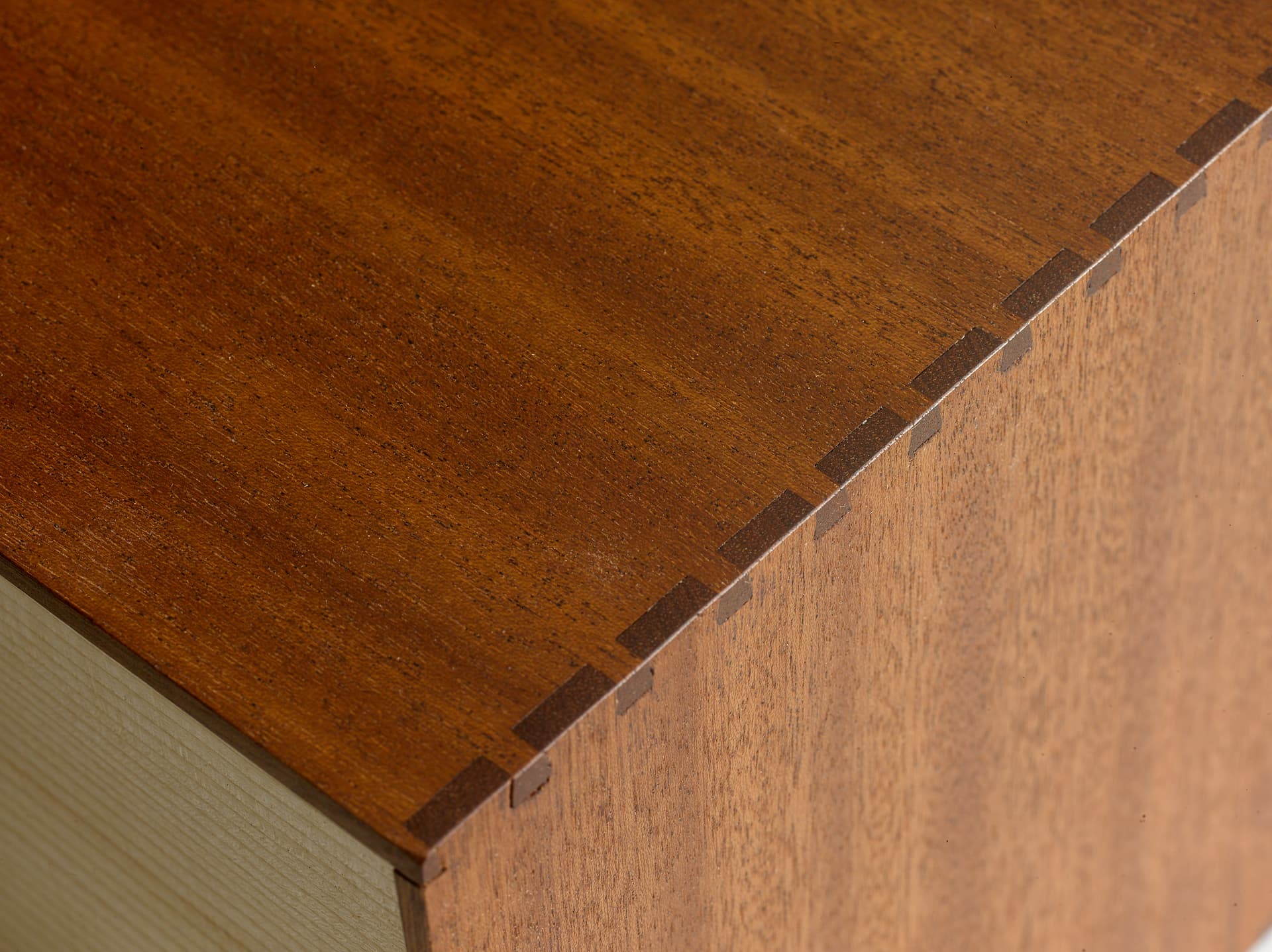

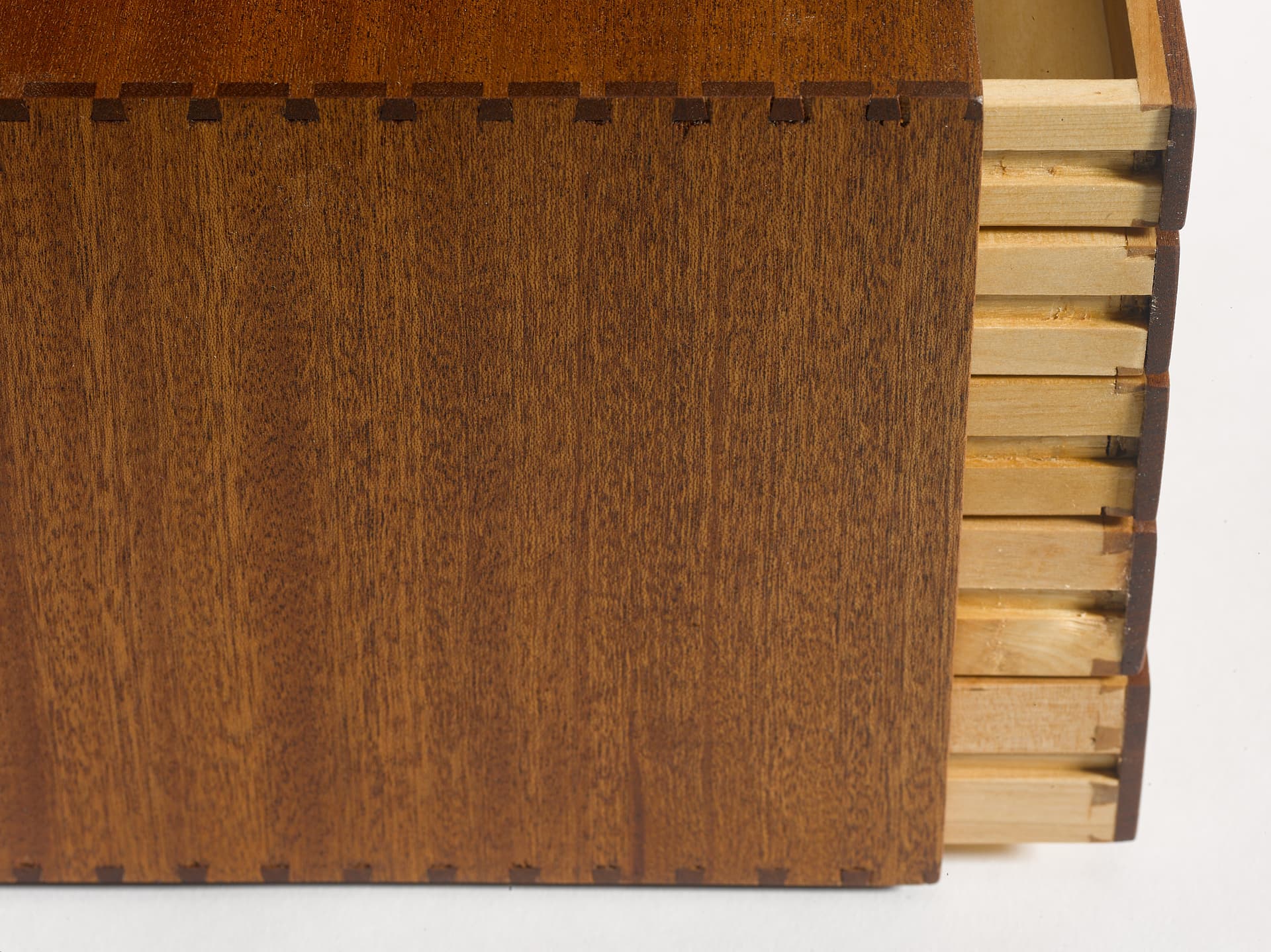

Here’s some shots of an earlier project using this technique:
That’s 6mm Sapele (rescued from the dumpsters at Martin Guitars by my best friend’s husband). Those were cut with a very very tiny spiral end mill. I forget, maybe 1mm or smaller. I had to double-stick tape the wood to a flattened MDF platen – there was no room for errors!

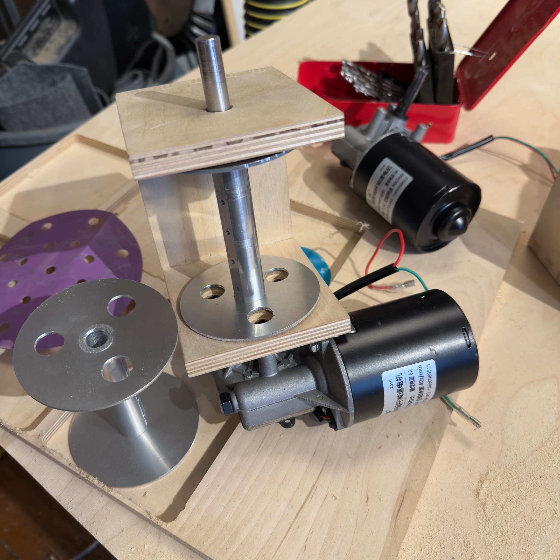

These are a pair of winches that will be wound with 100mm nylon webbing, to lift a lighting rig. 12-volt worm-drive motors power it up and down. The central hub is a 20mm OD / 12mm ID tubing, and 2mm plates as end flanges. Those were cut as an interference fit and hammered on. The holes in the flange are just to provide access for the motor mount screws, although I love the vintage reel-to-reel aesthetic!
This was my second time cutting aluminum on the S4, first time with an O-profile bit. I can see why those are preferred!

I think you are talking about a tool offset capability.
I found that GRBL does not support it.
I have had to remake tool paths to accomplish that task.
