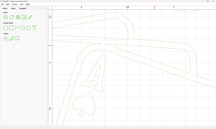

I have created a sign in Carbide Create. I am having trouble with one part of it where the Advanced V-Carve path jumps into a vector where it should not carve. Here is the sign:
Here is a close up of the Advanced V-Carve toolpath. I have circled in red where it jumps into a vector when it should remain outside of the vector and carve around it.
I have used this card image in a different file and the advance v-carve toolpath worked just fine. I have deleted the image and reimported several times and the Advanced V-carve toolpath does this every time.
How do I fix this?
Any help is appreciated.

There are two vectors at that position:
If you delete one:
The toolpath is as expected (in v8 at least — should also work in v7):
