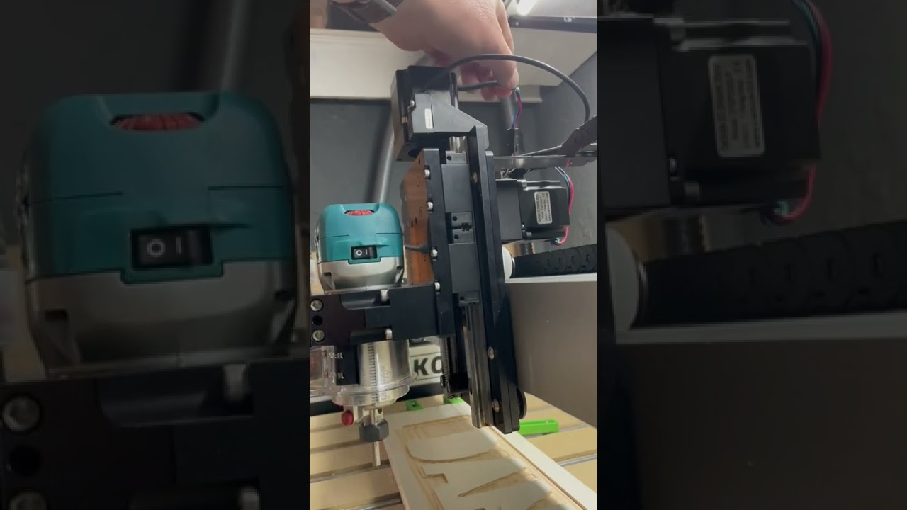

It becomes a bit annoying now. Again, half way in the job the machine plunges in the wood again, the bit is firmly set in the spindle so it can’t be that. The spindle goes up and down and I’m getting an error message now. Not happy (to put it mildly)
https://youtu.be/BG0WHiEjdBs ← VIDEO
test3.c2d (45.2 KB)
Please check the Z-axis motor wiring and connectors — if you don’t find anything obvious to address, let us know at support@carbide3d.com (send us photos of the wiring connectors in question).
I checked all wiring but it all looks ok, no wrong connections. When I would have a wrong connection it should fail all the time. Right now it is totally at random. I don’t know where else to look. I will make some more pictures and send it to support. I don’t want to go back to Easel because I want to use CC/CM but with Easel I never had these problems so I personally don’t think this is hardware-related (but again, I’m no expert). It’s all very disappointing. I’ll send support an email right away.
Honestly, looking at that video it does seem like a likely cause though, sometimes it all looks ok visually but somewhere inside the cable there is a poor connection or half-break somewhere, which makes it random by nature (the connection makes and breaks at each tiny movement of the wire)
If you jog the machine up and down in the air and wiggle the cables while you do it, do the jittery movement come and go randomly ? If so, that would definitely point to a wiring quality problem.
There is no way that G-code alone (CC/CM) can produce random/jittery movements. If you send that specific video to support, I think a cable swap will be the logical next step to fix this for you
It looks like you are right Julien, when I wiggle the wires it does have an effect of the Z axes sometimes. I will write support and ask them to send me some new wires… Thanks!
