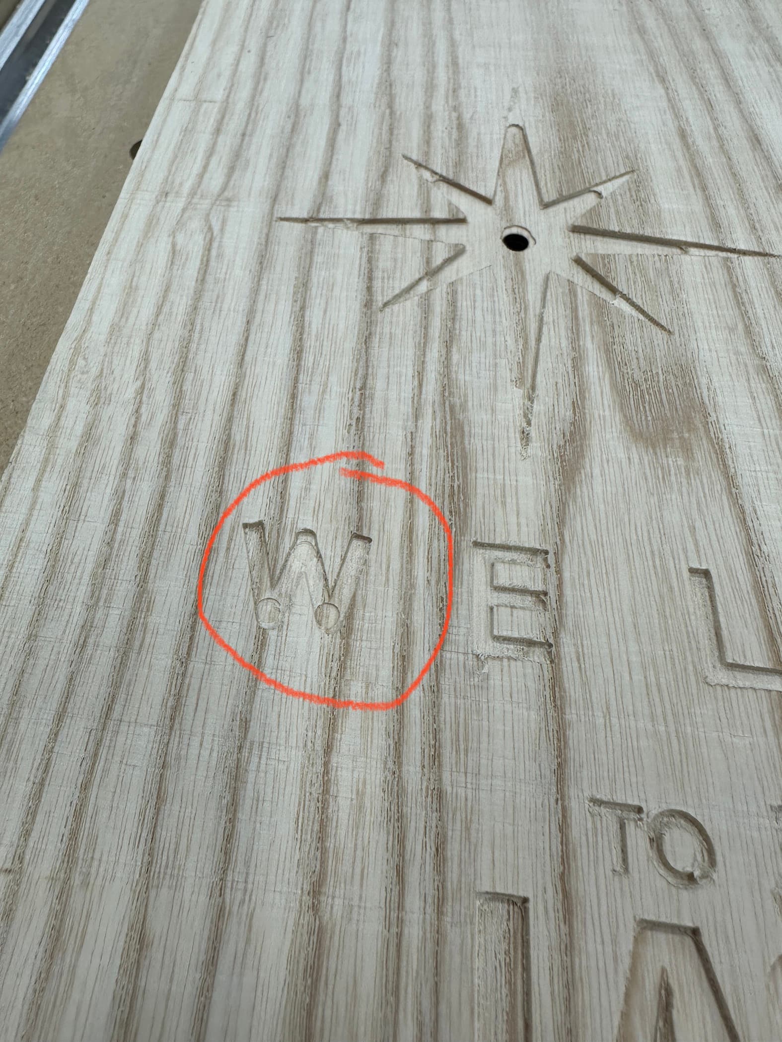

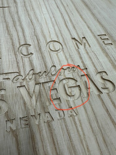

Here’s some photos so it might make more sense. I’ve been using it for awhile now, but I like your function testing. I’ll give that a try after dinner. I measure the difference which came out to be .01. This isn’t a crazy difference, but it’s obviously enough to pick up visually. I just circled the most obvious spots.

Wow, thanks for the pics. That is not what I was envisioning. I was thinking the flat was flat but at a different depth consistently. I’d have a look at the machine Z axis as suggested above. I was trying to see if it looked like a speed/feed issue but it doesn’t look like it to me. Stupid question but any chance the bit is dull? Again, no pattern as far as grain and mill pattern goes that I can detect but something odd for sure.

Part of your problem is the diameter of your bit and the actual width of you letters.Look at the W and you will see the cleared circles in the larger areas that is the area that the 1/8 bit can cut and this cut deeper or the deepest as in your pictures. If you change to a smaller bit 1/16 and view the simulation again you will see more area removed. This is also in several other letters and the design above.
look at the test file I made the bit change in the first tool path only and see the change in the cuts and simulation.

I added a 1/8 inch box near the W and this represents the size of the 1/8 bit and when you place this over your letters you can see it is larger than some areas of theletters and the bit will not cut anything smaller that the box.
So I understand that the larger bit can only cut so much of the smaller letters, but changing the bit to a smaller size only allow more clearing… not depth changes right? We’re just talking about being more efficient with a smaller EM for clearing the flat areas, but that wouldn’t have any impact on the V30 going deeper, unless I’m not seeing something? In theory, if nothing else changed… I’d just being seeing a “bigger” circle since the 1/16th bit can cover more ground.
Wish I had more time today as I am thinking exactly Anthony is. However, I would think the advanced vcarve would be smart enough to use the v-bit to clear the sections the endmill can’t get into. Having said that I have very little CC advanced vcarve to compare. I’ve been using vcarve pro and it does clear anything the end mill doesn’t using the v-bit (or a smaller endmill if you prefer/need).

The smaller bit will clear more of the lettering and should let the V bit do its job of clearing the walls of the letter.
Chris M
For both Chris C&M
That’s exactly what Advance V carve does with the proper tooling and bits. If you clear out all the bottoms with the correct diameter tools and have the vbit set up correctly it will leave a smooth bottom and sharp corners on the side walls.
In this case you were using the Vbit to clear out all the bottom with a step over of .008.
Chris C see if you can get a really good close up picture of the letter W and show the bottom and the walls clearly and post it.
I think once you change the tool to the 1/16 bit and do a test cut you should see a very good cut then.
