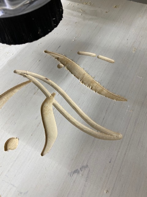

Recently setup my new pro xl. I’m new to cnc but have some preivous experience working with cad/cam etc…
I setup an advance vcarve to do a detailed letter “T” on a piece of wood. Everything seems to go ok but when I perform a tool change the router is doing a plunge cut in a straight line at the beginning of each toolpath near the top of the work piece. This line doesnt show up in the image and I can’t seem to figure out why its doing it.
Here is the code, im thinking maybe it is related to this “M03S18000” command which appears to be a prepositioning command? This also appears after the tool change from end mill to v-bit.
Any help would be appreciated.

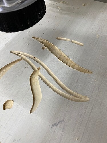

I tried remaking the file and the previous issue seems to have been resolved. However now after a tool change the vcarve tool paths are in the wrong place relative to the pocketing operations. workpiece is a piece of 3/4" plywood and its fixed securely at each corner in the t-tracks, it is laying flat. I set my x/y zero to the bottom right corner of piece and set z zero at top of ply in the center. Also I’ve noticed that after the tool change the machine tends to crash/slam in to the end of the +Y axis.

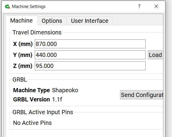

this sort of feels like the machine dimensions are not set up correctly in the carbide motion settings screen… I’d suggest taking a screenshot of that screen and posting it here, so that someone else with a pro XL can compare the values.
I used the loaded defaults for pro XL,

Just following the motion prompts, when it says change the tool i change it. Then it goes to the bit setter and back to the work piece. Im clearing with 1/8 endmill and then vcarve with 90deg bit. But the issue seems to be the y-axis is off after the change.
this is sounding like where the skips happen…
yes, but why would it happen?
Only 2 things I can think of
  1. the homing is somehow further forward than expected
    or
  2. CM thinks the machine is larger in the Y than it is (as measured from the place it homes).
    I don’t have a Pro (just regular) so cannot check the Y dimension that is set… but hopefully @WillAdams or someone else has the correct value to compare with.
    (You can also, just in case, re-select this in the settings and see if it changes somehow)
