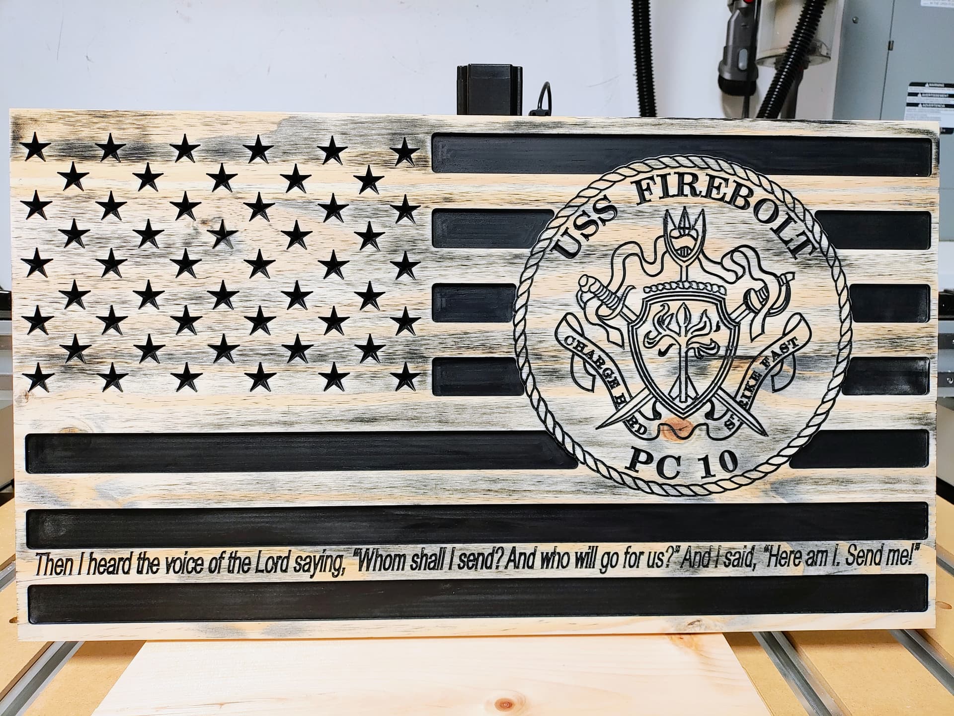

I made my first flag integrating one of the ship’s crest that I used to be on. I used advanced Vcarve and it’s bypassing the pocket cut before going to the vee bit. Any suggestions?

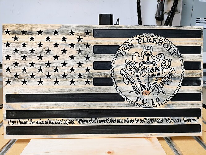

Thanks, looks like I’ll be adding some bits to my collection. And for a little more history on the USS FIREBOLT, on April 24, 2004 three crewmembers died when we were conducting exclusion ops off the coast of Iraq. I attached a picture of the final outcome after doing some sanding and more staining, I’m happy with it. Thanks for all of your advice.
