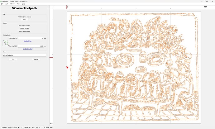

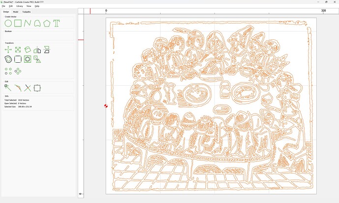

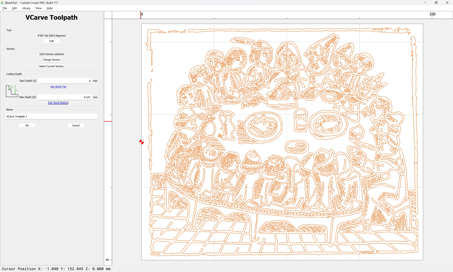

I am attempting to use Adv. V Carve to reproduce a mediaeval woodcut. Picture below.
I have converted it into a clean SVG file but Carbide Create appears unable to produce the requisite G Code. Again, please see below. I’m using a 1/16" end mill and a 60 degree V cutter. Am I simply exceeding the capabilities of my software or is there some way I can remove the parts of the image I don’t wish to print? Adv. V Code usually works perfectly for me.
Any suggestions? Or am I trying to achieve the impossible?
Thanks, Mervyn

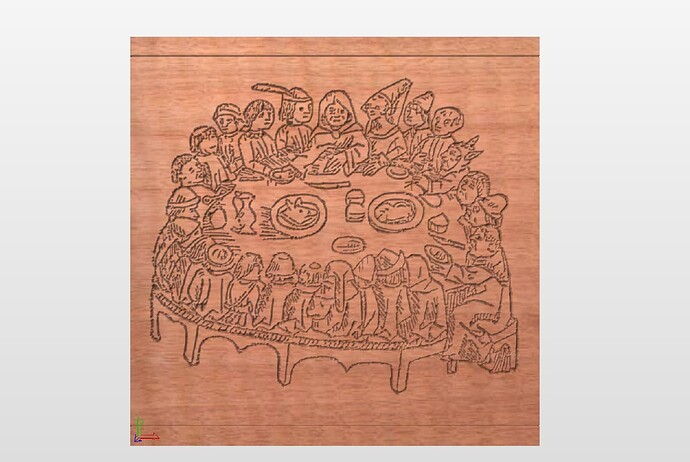

Here’s what Vectric’s Sketch Carve rendered with no editing of your original file.

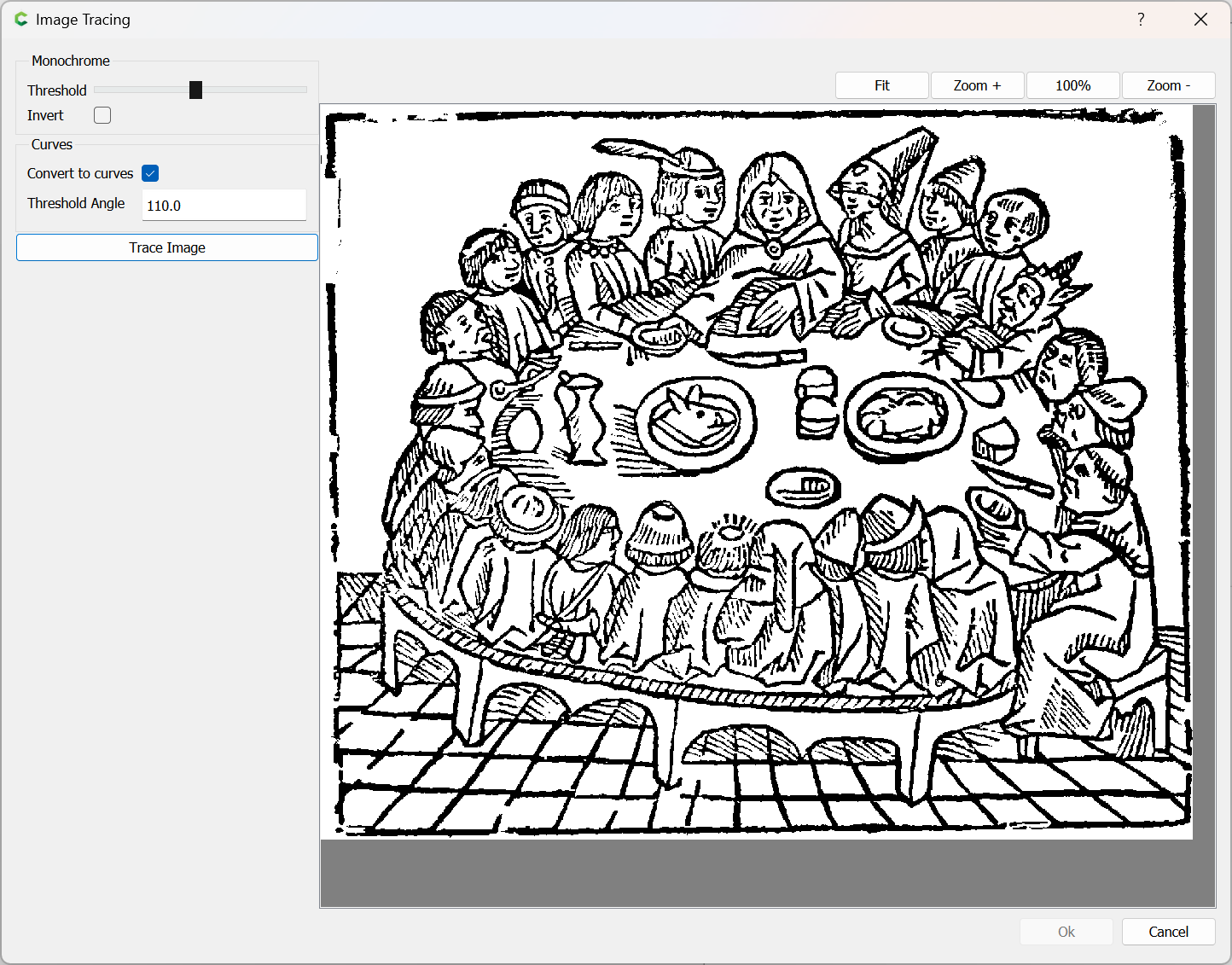

Loading that into a photo app and rotating it:
We get an image which can be imported as a tracing:
and the Threshold adjusted:

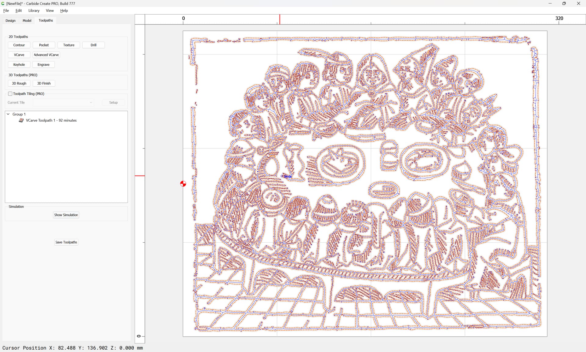

so that one may “Trace Image”
Ok
and then centered in the working area:

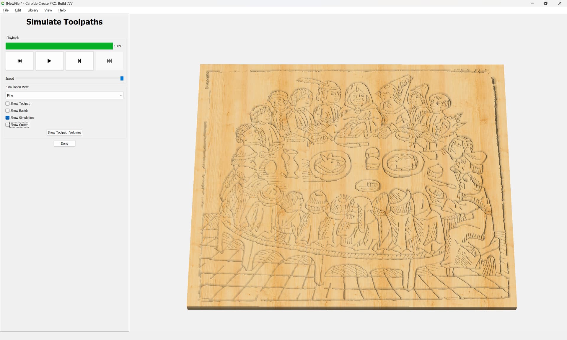

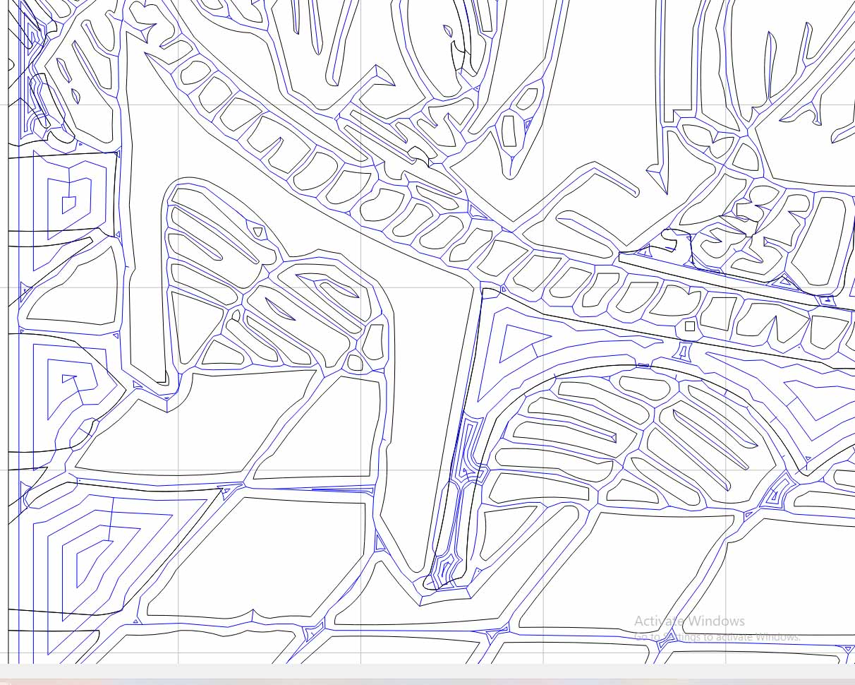

and a V carving toolpath applied:
which previews as:
Attached as a v7 file:
Caxton_Chaucer_pilgrims_meal.c2d (2.5 MB)
Most likely the difficulty is with the traced geometry which you have — many online tools have errors such as overlapping or self-intersection.
