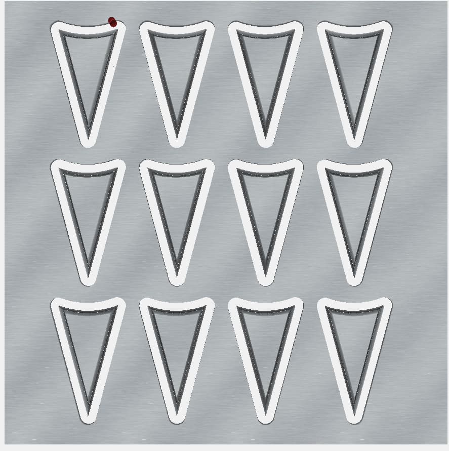

I found this picture from a while back at a store called Eclectic Home. I would like to try and reproduce something similar. I have the parts drawn up. My question is the center section has camphor around the edge of each piece. I drew up the part and did a vcarve with a 20 degree vee bit as a contour. Do you think this will work. The simulation is hard to tell.

This is early development. I agree that I can rearrange by flipping one row and getting a smaller material size. However my question is do you think the vcarve will get the profile on the edge of each piece. I do want the grain to be straight up and down on each piece and then they will go around like a clock face (12 slats).
Try running a test with some MDF and see how the chamfer comes out. A 20° VBit is pretty steep so you might not get the angled effect your looking for. I typically use a 90° and set the toolpath to no offset and then play with the DOC to get the chamfer where I want it to be.
