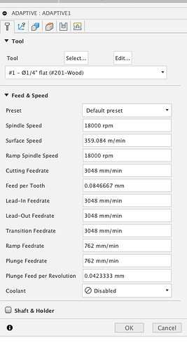

This is only my third project, but I’m wondering if anyone has any advice on improving my 3D relief flow. Fusion told me this would take about 6 hours and it took about 20! :). I assume part of that was I used a way too small min step size on my adaptive clearing path which carbide claimed which took 8-10 hours. But I also assume I have a bit of the wrong approach. I’m interested to know if these things just take this long or I need better settings/tools.

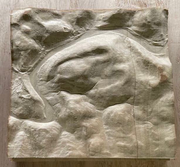

This is the final product (150mm x 150mm)

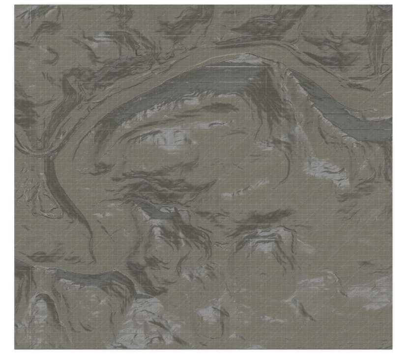

And this was the model:

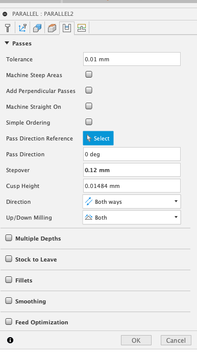

I used four passes setup in Fusion360:

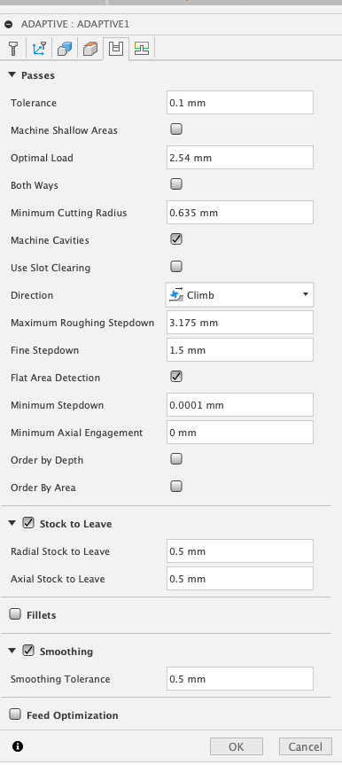

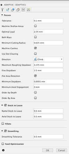

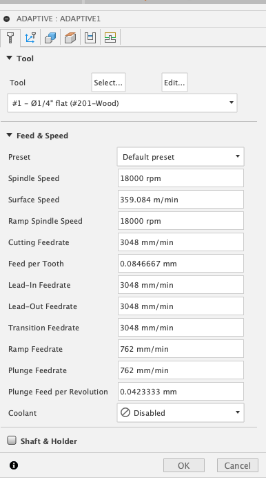

Adaptive clearing pass using 1/4" standard bit that came with the HDM.

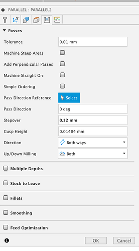

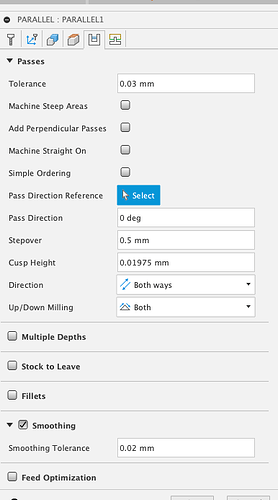

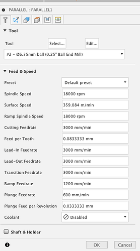

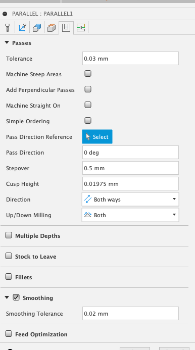

Parallel path using a 1/4" ball cutter, this was quick

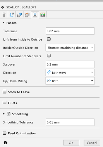

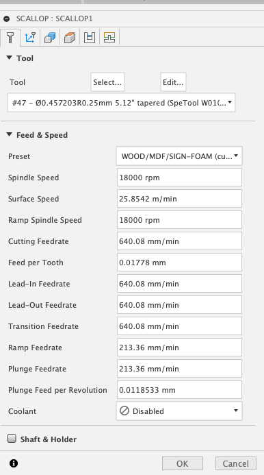

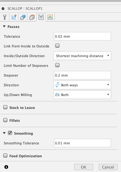

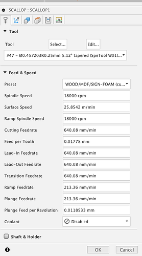

Scalloping pass with a 0.5MM Diameter tapered ball bit
Parallel pass with the same 0.5MM tapered ball bit

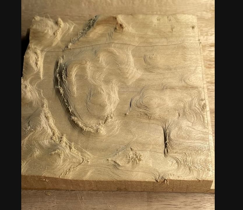

After the adaptive pass it looked like this, which is actually kind of cool looking itself.

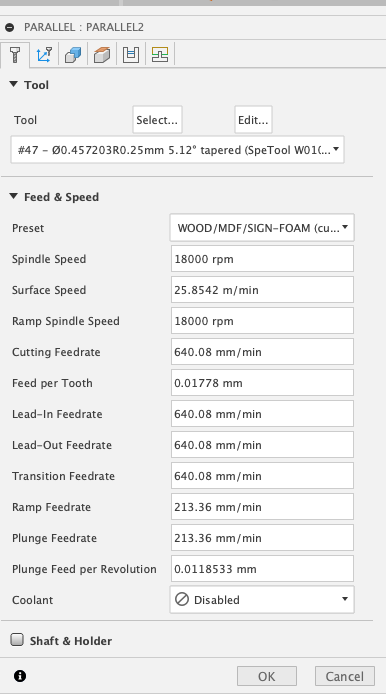

And finally these were my feeds for each:
Adaptive
Parallel
Scallop
Final Parallel
And that’s it. Thanks for any advice, I’m still pretty new to this.
What do you not like ?
I see the parallel lines in the finished product.
I would use the largest ball end mill you have for the last pass.
I used this bit with a 0.050 " stepover with good results.

I use a Pocket for roughing, turn off Flat area detection to get expected DOC.
Be careful of fine details for big DOC, you will get spikes that can break off especially with pine.
I leave .020 on the Pocket.
Second is a Scallop with the large ball end mill no stock to leave.

I found a 0.050" stepover using a 3/4 round bit creates a 0.002" cusp.
