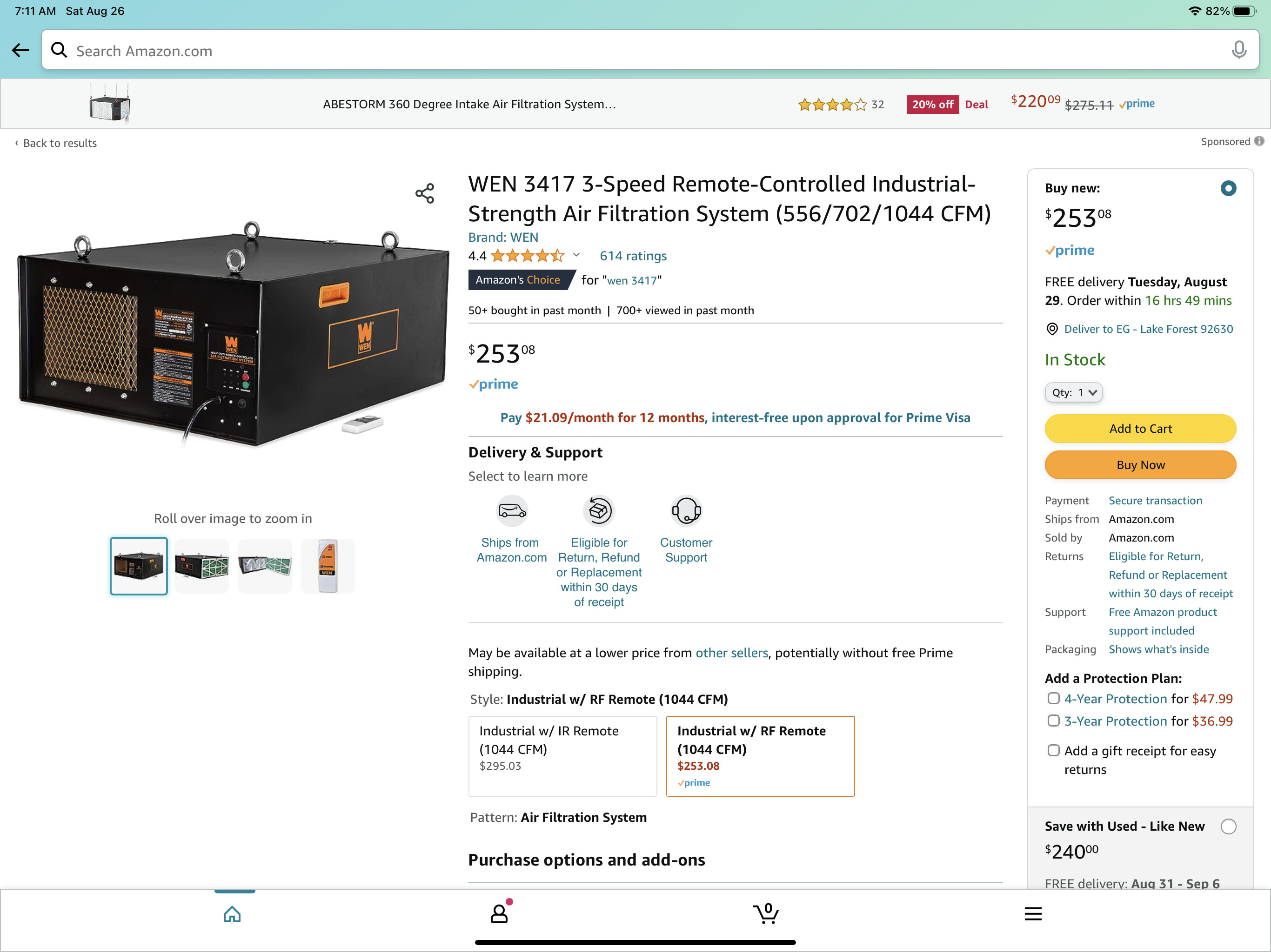

I have one of these
They also sell a lower air-volume version for less.
Amazon offers a boatload of choices.
The WEN 3410 works very well in my 320 square foot shop.

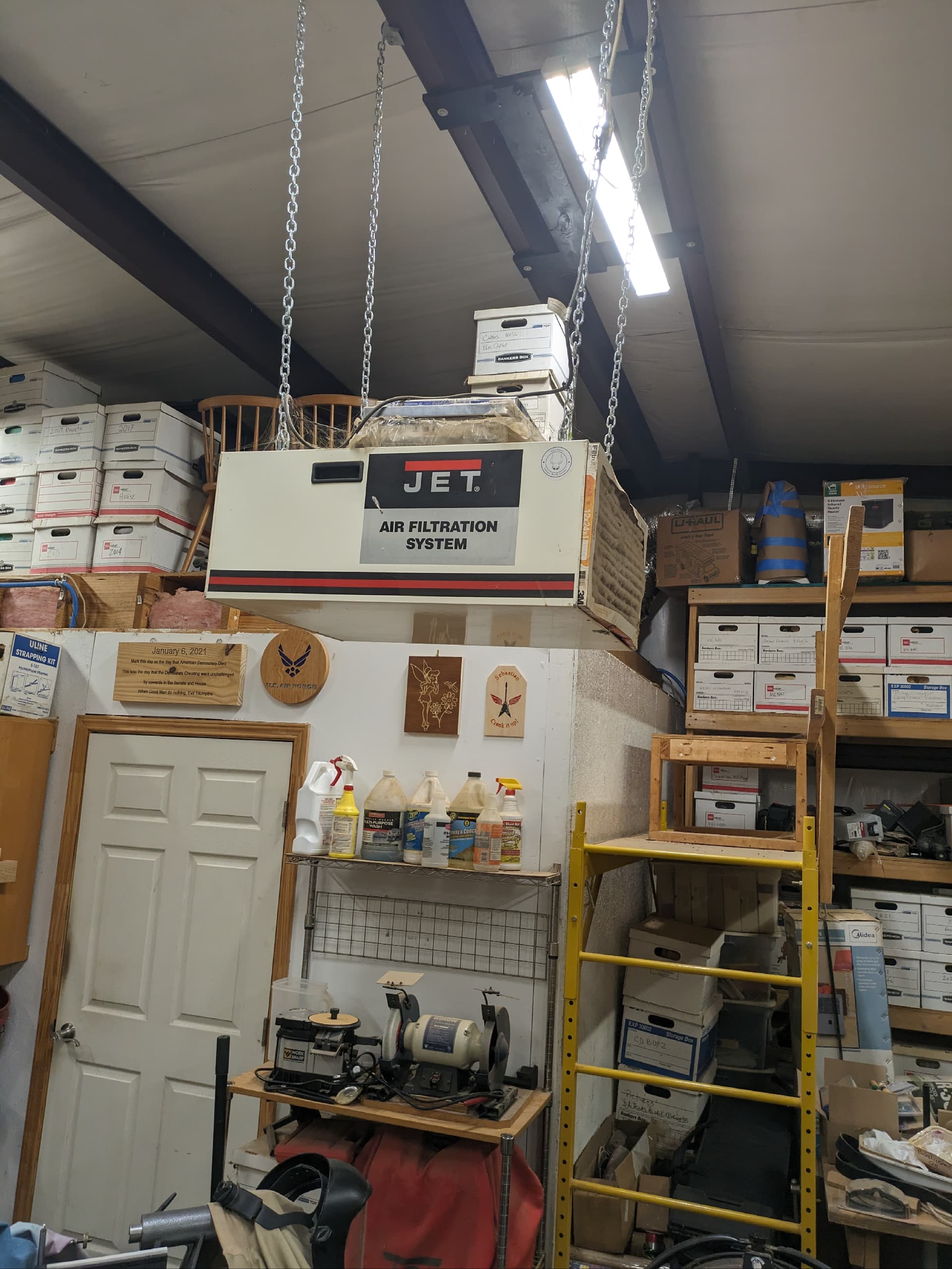

I have a Jet AFS-1000b. I have had it about 20 years. Works well and is suspended from the ceiling. There are others on the market now and WEN makes descent stuff for the low price market.

The Jet stuff is good quality built to last.
I have that same Jet unit @gdon_2003
It sometimes makes a low humming noise even when turned off like it is trying to turn on and the blower spins super slowly.
I tend to trip the breaker when I am not out there just to be safe. It does work really well other than that.
