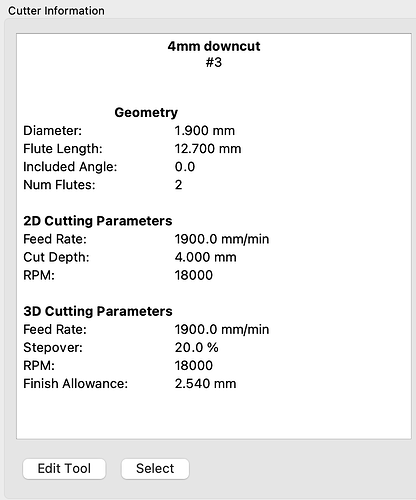

I’ve had my Shapeoko 5 pro machine around a year and no real issues until now. I mainly cut plywood and for some unknown reason it has started to cut all shapes wider than intended, by exactly half the diameter of the end mill.
For example - if i cut a 40mm x 40mm square with a 6mm end mill, it will cut it at 43mm 43mm.
This happens when using all offsets (left, right, no offset) and with all end mills (3mm, 4mm, 6mm)
Can anyone suggest what might be the issue?

Can you share the C2D file? and a picture of the tool parameters if using a custom tool?
Hi Todd, thanks for your help. The C2D file is too big to attach so I have included a link to access remotely. Screenshots of the parameters of the 2 tools used for this file are also attached.

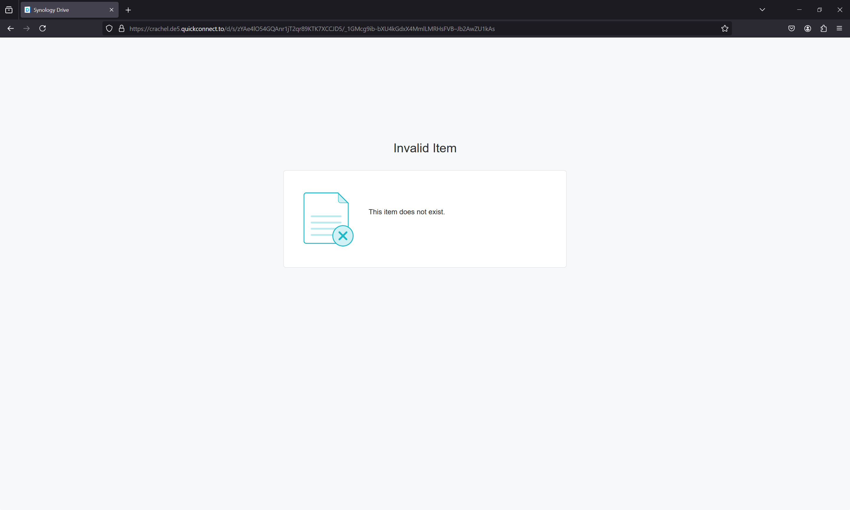

When I tried to download that I got:
Usually, if a part is the wrong size when there is a custom tooling definition, it’s caused by the tooling definition being wrong — post a screen-grab showing that?
if you cant access the fil
e with the above link please use this…
\http://Crachel.quickconnect.to/d/s/zYAe4lO54GQAnr1jT2qr89KTK7XCCJD5/_1GMcg9ib-bXU4kGdxX4MmlLMRHsFVB–Jb2AwZU1kAs

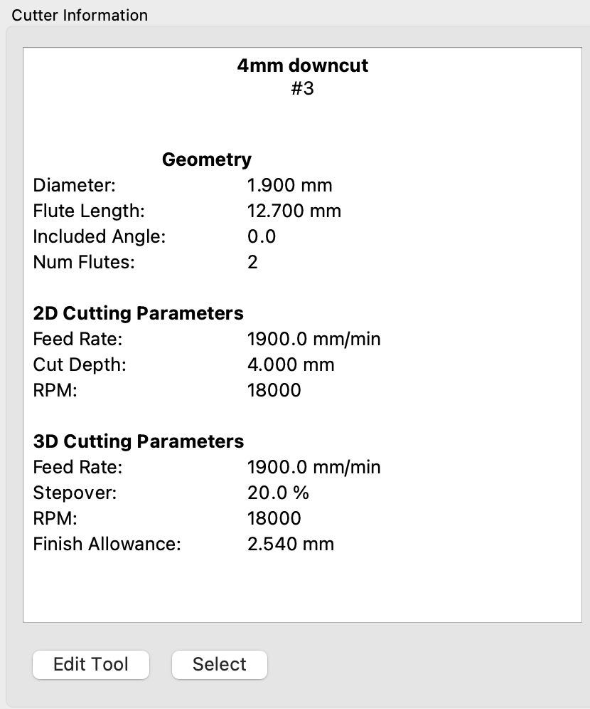

Your 4mm downcut bit has a diameter of 1.9mm. Your 6mm is 3.0mm? Looks like you inserted bit radius instead of diameter in your tool tool geometry field.

E-mail to support@carbide3d.com or post to a Google Drive?
That said, I’m pretty sure the problem is the tool definition, which isn’t easily accessed from the .c2d file — please post a screengrab of that and the specifics of the tool (ideally a link to a web page which has the specifications).

I’ll find the tool definations also
This was the problem, don’t know how I missed that!
Thanks for your help.
Thanks everyone, I appreciate the help. The incorrect diameter parameter was the issue.
