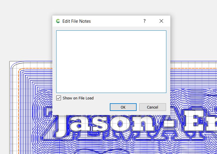

I will open notes, (P) enter my job info there. I have a few jobs that I move completed work around the screen. Notes help me remember what I am trying to do.
