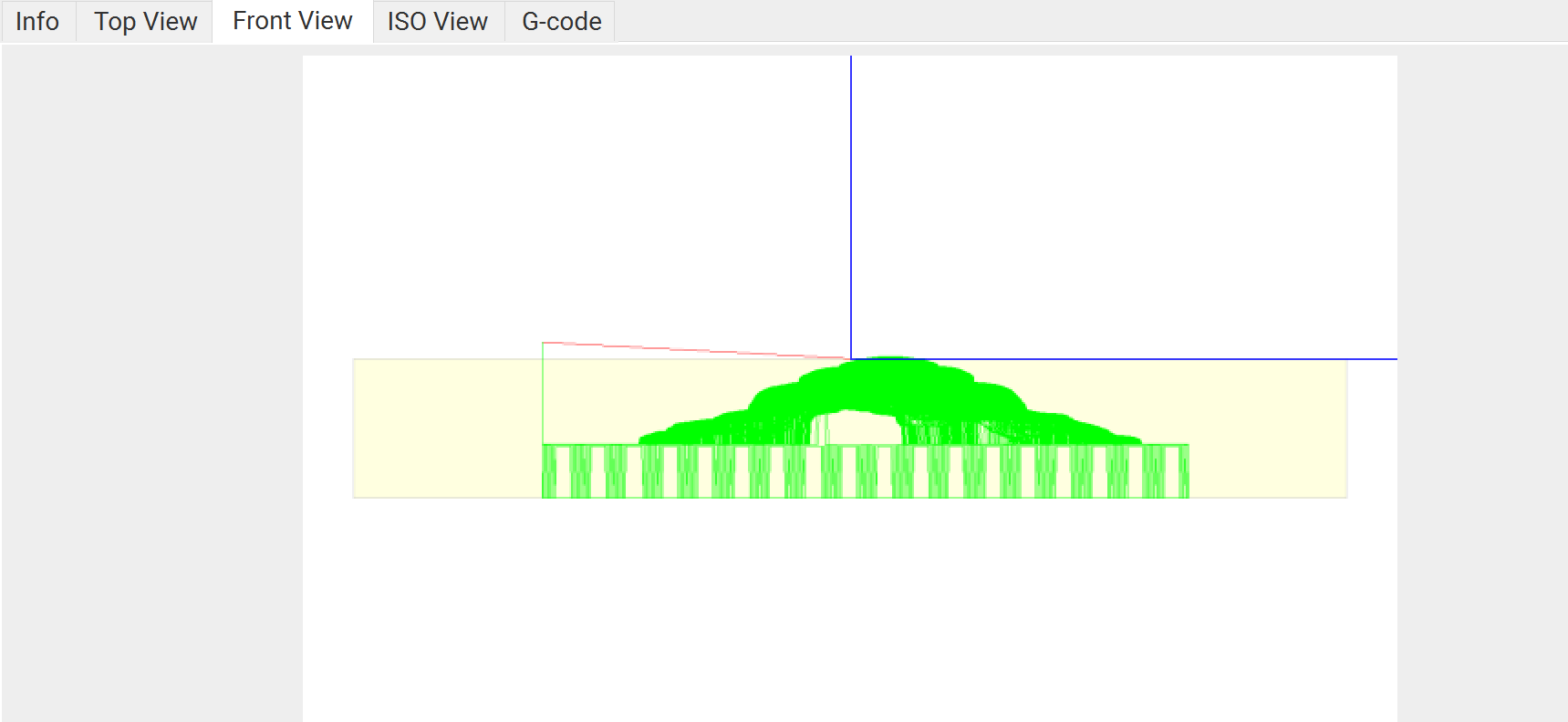

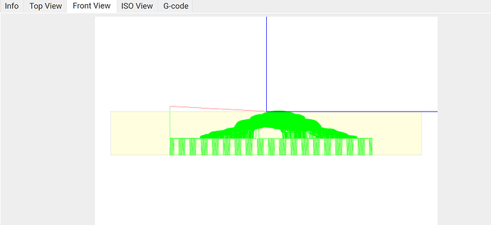

Since I had to reload the program due to the STOP, I did so and when I looked at the preview in CM, it was weird. The frontal view showed “line holes into the full depth of the board” that should not be there. Went back and checked the file and the preview in CCP, and it did not show any such holes into the board. Just in case, resaved the file and reset the XXL and reloaded the file into CM. Holes still showing up.
SOOO… I figured, I’d just see what would happen.
True to the CM preview, the very first thing the machine started doing was drilling into the board. Obviously , I stopped the machine.

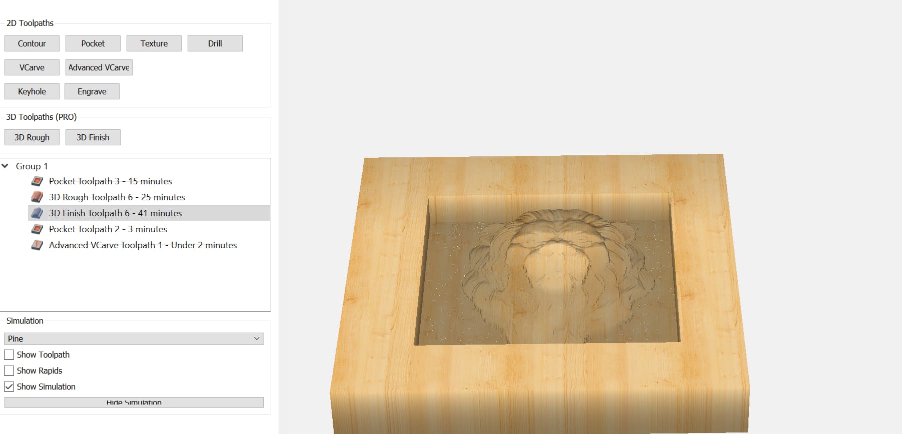

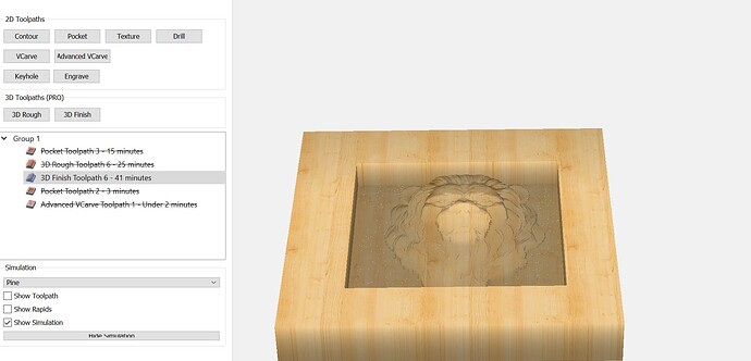

Here is a pic of the simu from CCP and one from CM.
Not sure what is going on nor what happened nor how to fix??

Moved the CCP file to another computer and it shows a “complete cut through” at the bottom of the inside frame. That explaines why the CM did what it did when I reloaded the file. (Not what caused it to go off track initally…which is still a question.)
Now the real bottom line is: Same file run right in a row for 5 times without any “cut through” happening (because it was not in the design), BUT when it went to the 6th time running the same file, somehow a full cut through the bottom of the board showed up??
The changed happens during the Finish cut after the Rough cut. That Finish file somehow changed without anything changing in the design. ???

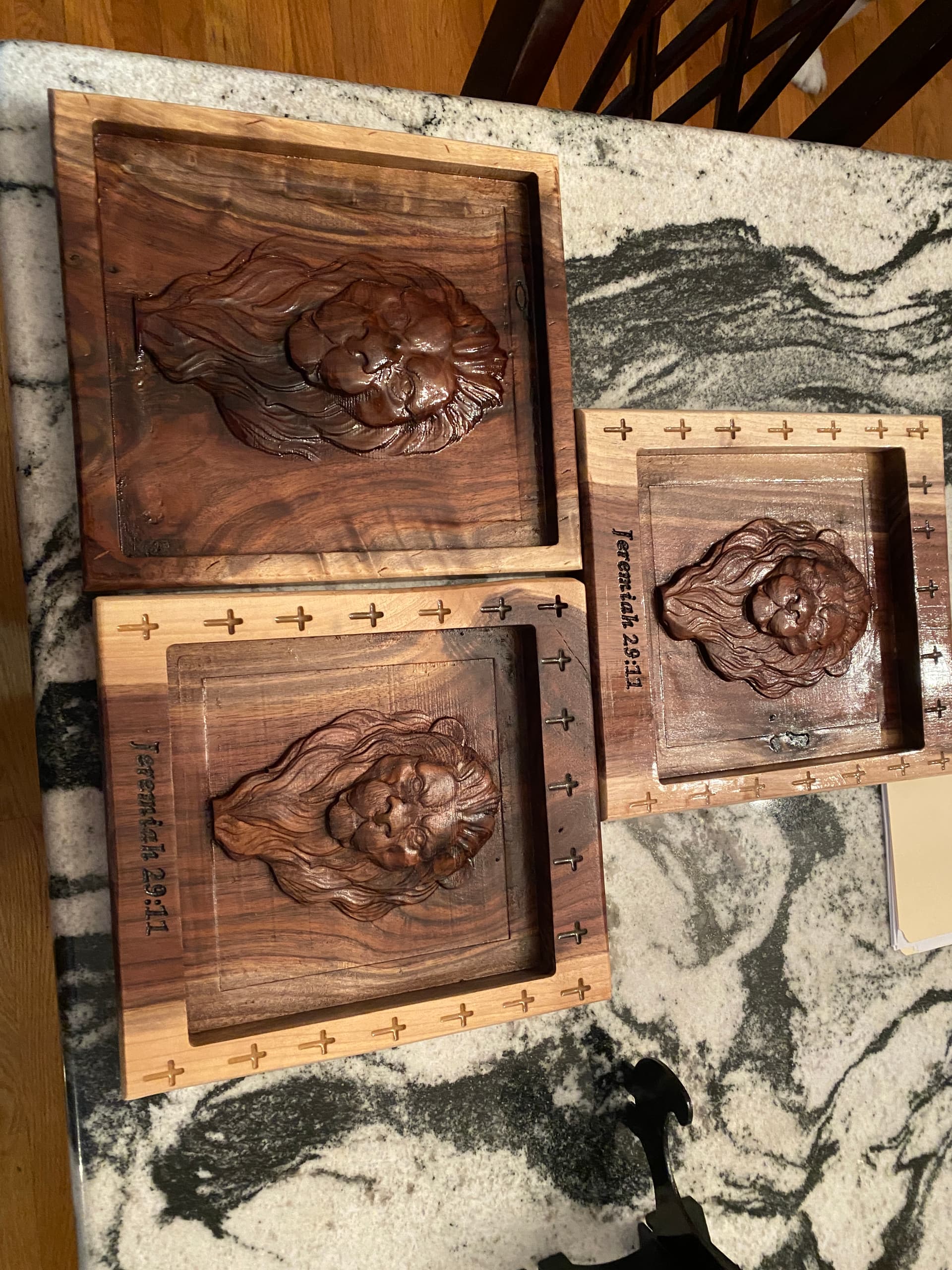

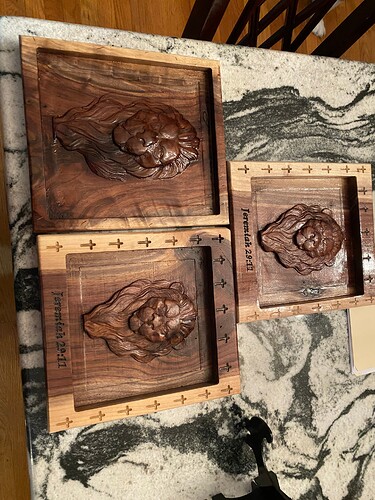

Just to show the previous cuts, here are 3 or the 5 that turned out great without issue. Why the change? and Why did the FINISH cut end up cutting through the board when the ROUGH cuts was finished with about 0.25" remained in the background??
