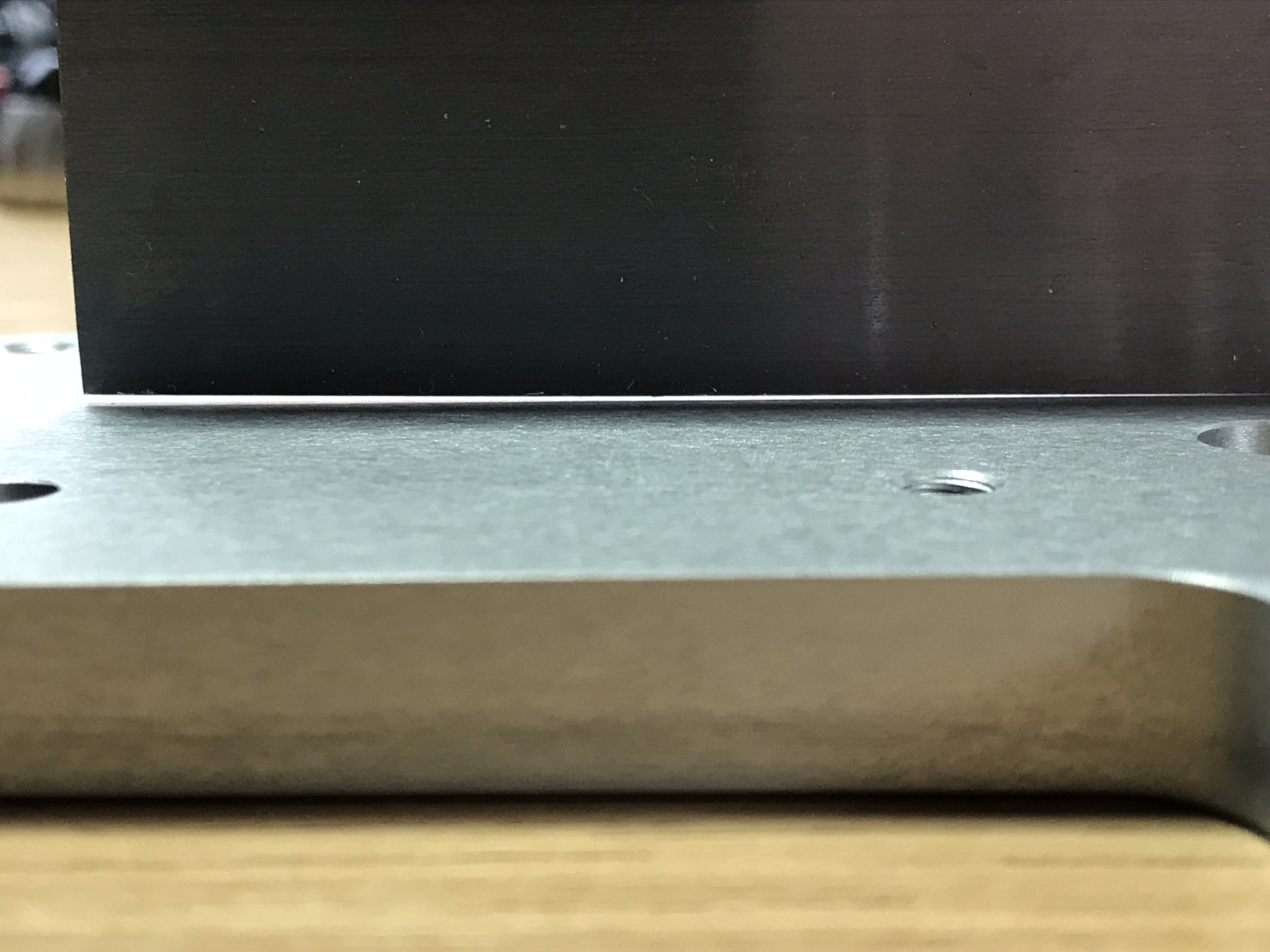

Aluminium question for the experts, how did this get bent?
I decided to have Xometry machine the main HDZ to linear rail adapter plate for my conversion so I could get an accurate, anodized part in 7075 aluminium whilst I would machine the smaller parts on my Shapeoko. I am now regretting this decision, 36 days after the order the part finally turned up and I’m confused as to how exactly it got the way it is, which is bent.
The thickness is accurate to within ±0.05mm all the way around, the counterbores are all within 0.03mm of target depth, the holes all seem to be in position and of the correct dimensions.
But, it is curved in both X and Y directions, a straight edge on the long dimension is 0.6mm clear by the end, the bow in the shorter direction seems to be of similar curvature.
As I’m probably going to have to give them a chance to supply a replacement I’m concerned as to how they managed this, clearly there wasn’t any QA, the box it arrived in was completely undamaged and unmarked (although obviously not it’s first use, remains of tape and other labels torn off), there’s no surface marking on the part to indicate any substantial force was applied after machining and anodizing, so the only things I can think of are;
a) They managed to clamp it down so hard in their work fixturing that it was “flat” whilst machined and sprang back to banana shape as soon as it was released
b) The alloy they used has changed shape since machining by this amount (at least 0.3mm over 200mm length)
If it was a then a replacement might be acceptable, if it was b then I really don’t want any part from them.
Thoughts from those with more metal maching experience please?
I should have just machined it on my Shapeoko like I was told…

Nope, so I tested against some other straight edges too, they agree and show the opposite curve on the other face. It even rocks when placed on a worktop and it’s visibly curved when you look along the length.

Ouch, that looks awful.
My experience with xometry is that their parts can be on the very edge of what’s within spec. Those 0.6 mm flatness deviation would be within tolerance class L (ISO 2768 T2), so if you specified even just class K (which I thought was their default?) they would need to send you a good part, no matter the reason.
For parts with required accuracy, I’ve switched to spanflug or Weerg. At spanflug in particular, the surcharge specifying extra accuracy on concentricity or flatness tends to be fair, but it all needs to be in the drawing.
As for the reason - 7075 plate is notorious for large internal stresses (which the T651 treatment is supposed to reduce), but those are unlikely to produce that much distortion in a plate this thin. Unless… xometry milled that one out of a much thicker plate.
