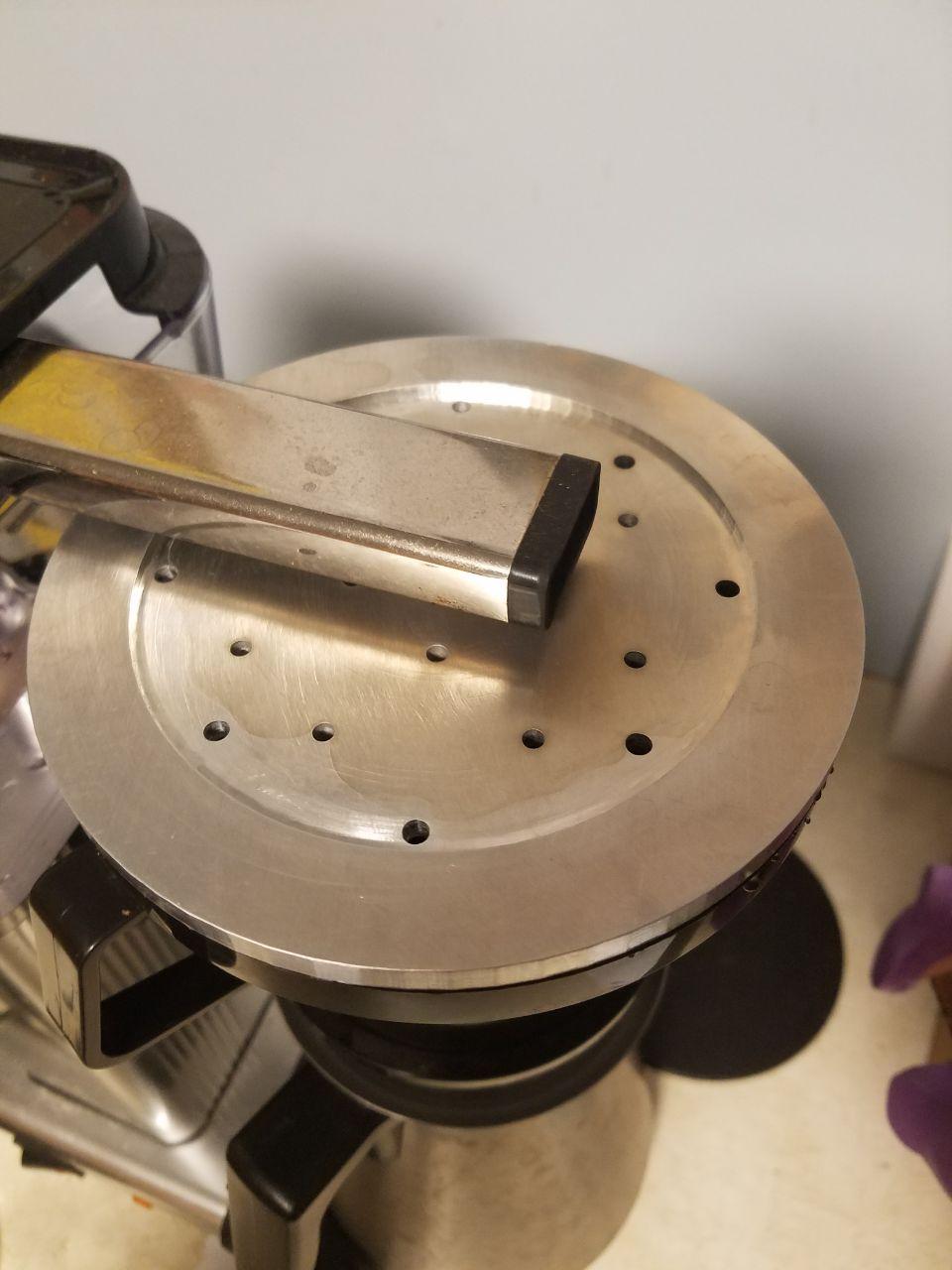

Thanks! I changed to the standard carbide3d 2 flute and hit it with wd40. Tiny chips, but not gummy anymore. Had to pause the job, hoping to finish tonight.
The wd40 made a big difference. After switching to the carbide3d 2 flute, it was still not breaking the chips. Hit with wd40, boom lots of tiny chips. This is on the list as a future addon.
Finished the piece with wd40 and the carbide3d two flute. Unfortunately, it doesn’t “shower” the water on my coffee the way that I had hoped.

The whole purpose here is to distribute the water over the grounds evenly. This does a slightly better job than the stock showerhead, but not as good as i was hoping. I’m considering countersinking some of the holes where it looks like it isn’t flowing because of the waters sticky properties.
