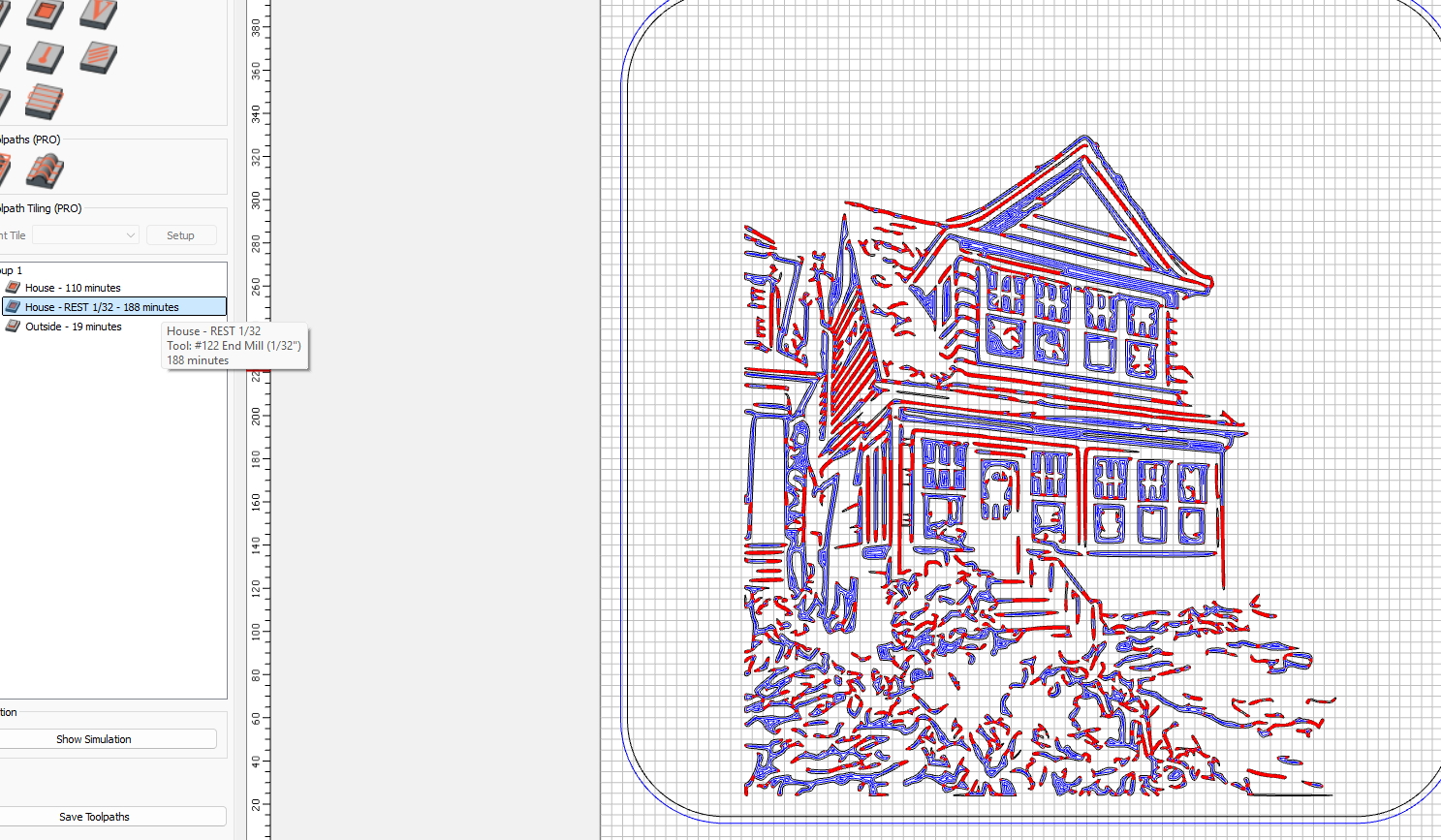

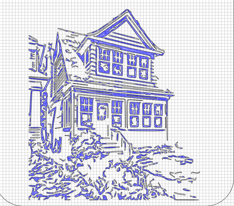

I have a house which I’ll use a 1/16 bit on:

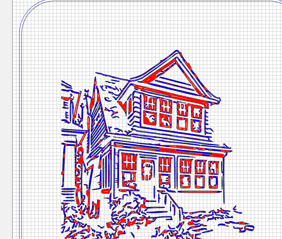

I want to refine some of the smaller areas with a 1/32 bit. I put in the following for rest machining:
I would expect there to be a lot less work to do as seen below. The 1/32 bit requires 645 mins vs the 192 mins for the initial 1/16th pass.
Am I doing something wrong or misunderstanding how rest machining works?

Looks to me like you are doing it correctly.
The image has a lot of detail. The 1/32 endmill is going to get to the places the 1/16 couln’t and that’s going to take a lot of time. Also your cut is 5mm deep which is a lot for small endmills.

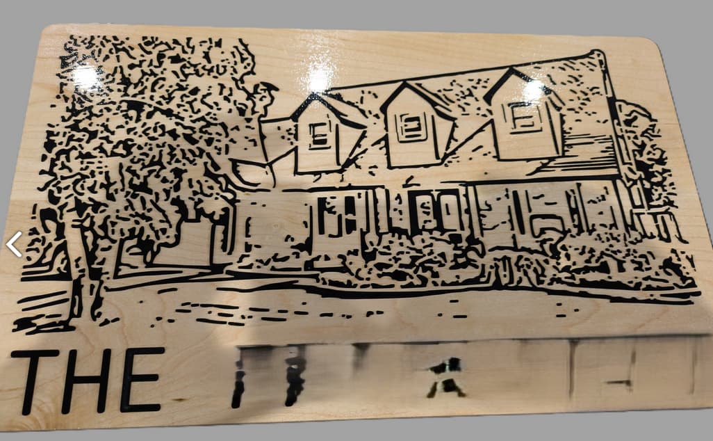

Without risking a perma ban, I generally try a contrasting epoxy (urgh I know lol), which is why I like the 5mm. Helps with any warping for flattening etc.I’ve had times where a high spot with a 2-3 mm pocket starts to wear, this is likely the result of me wanting the piece too perfect…
After some google / AI help I did notice that I can tweak some settings to help, step over and plung rate. Would be nice for it not to repeat as much though.
I haven’t tried epoxy yet… but after seeing the first pic I get it now. All the “noise” actually looks good when it’s filled in. I like to use shallow outlines on the signs I made recently to breakup the different colors of paint I used on the images. If you zoom in on the eagle in the link below you can see them. [What did you cut on your Shapeoko/ Nomad today? - #5301 by Jeffish]

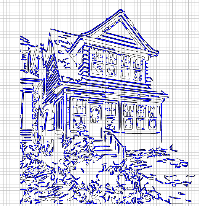

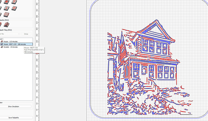

If you are seeing that your smaller bit is going over areas that have already been done by the larger bit, you may be running into this bug:
As a work-around, try this:
Instead of entering the the actual size of the previous bit, try entering (previous size - current size). In this case, since you are going from 1/16 to 1/32, change the previous size from 1/16 to 1/32 (i.e, half of what you have now).
Yep, that worked. Thank you so much. My search for rest machining didn’t pick up that previous thread unfortunately.
Looks way better now.
