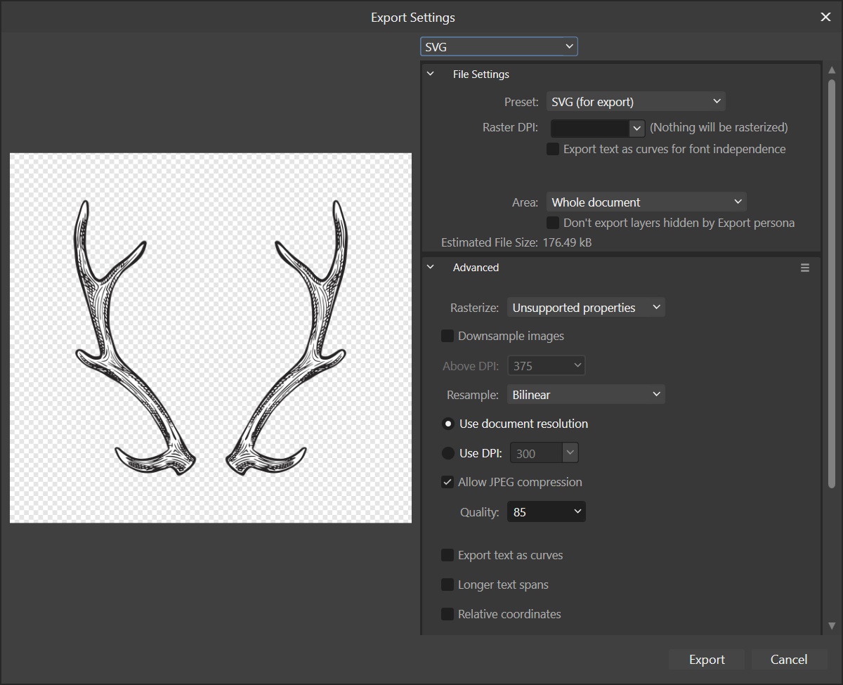

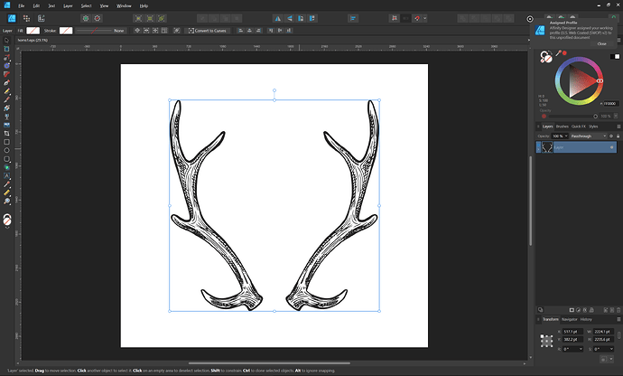

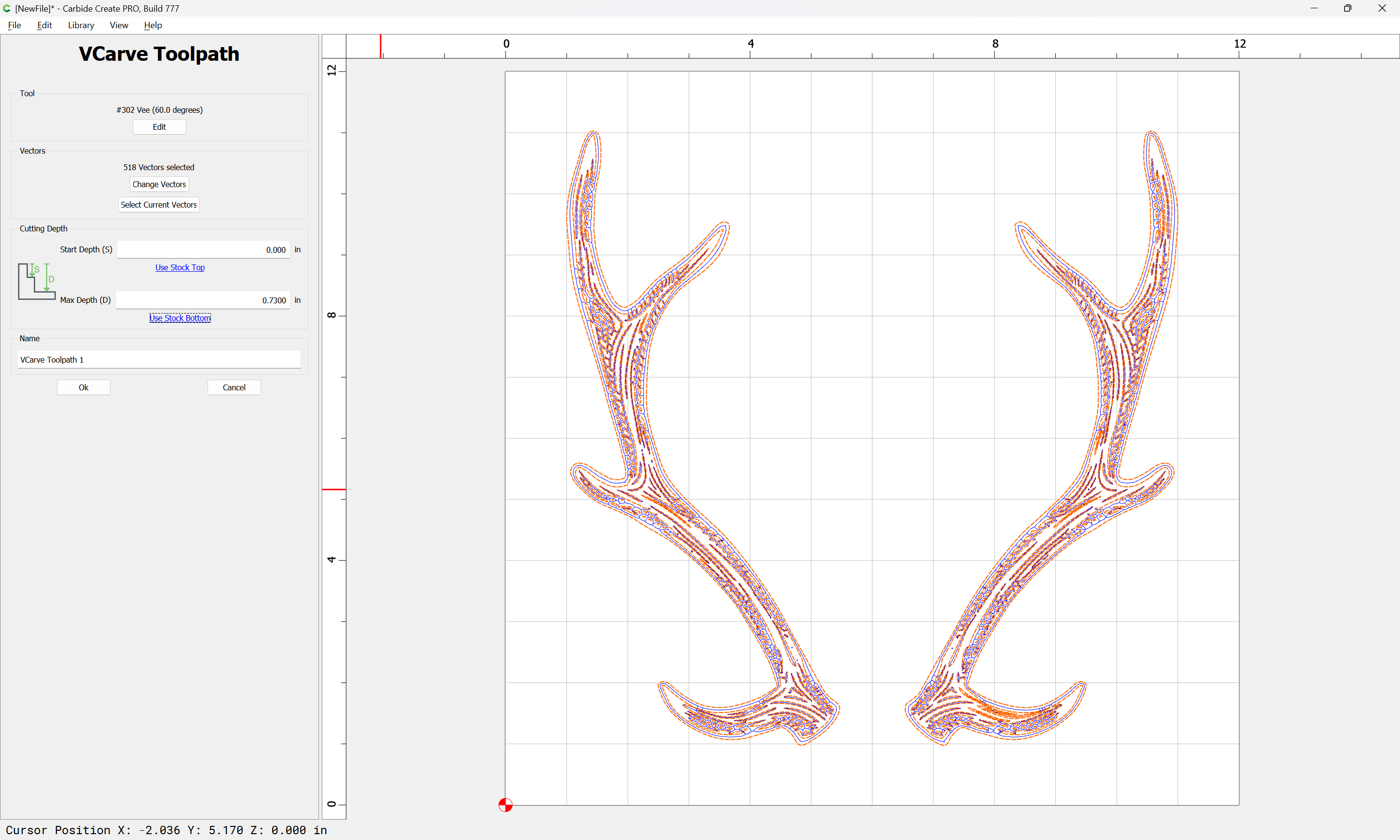

Opening it in a vector editor:
export as an SVG:

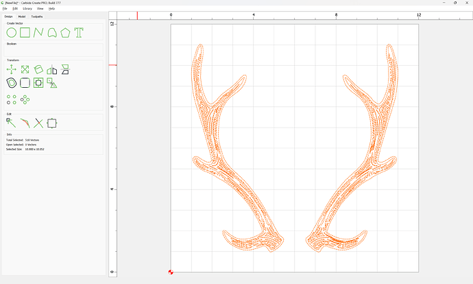

which then imports and can set to the desired size:

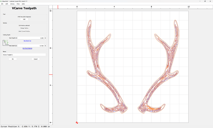

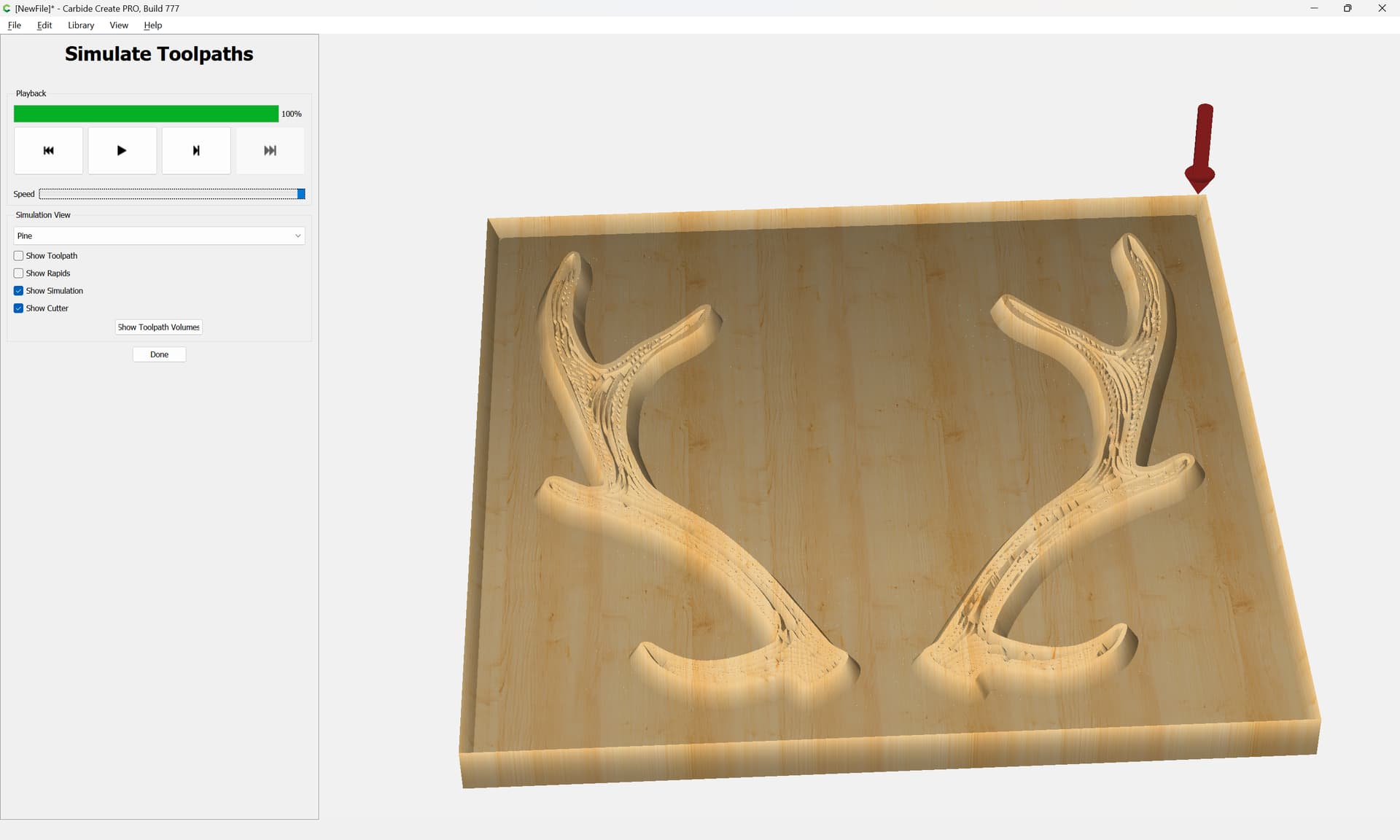

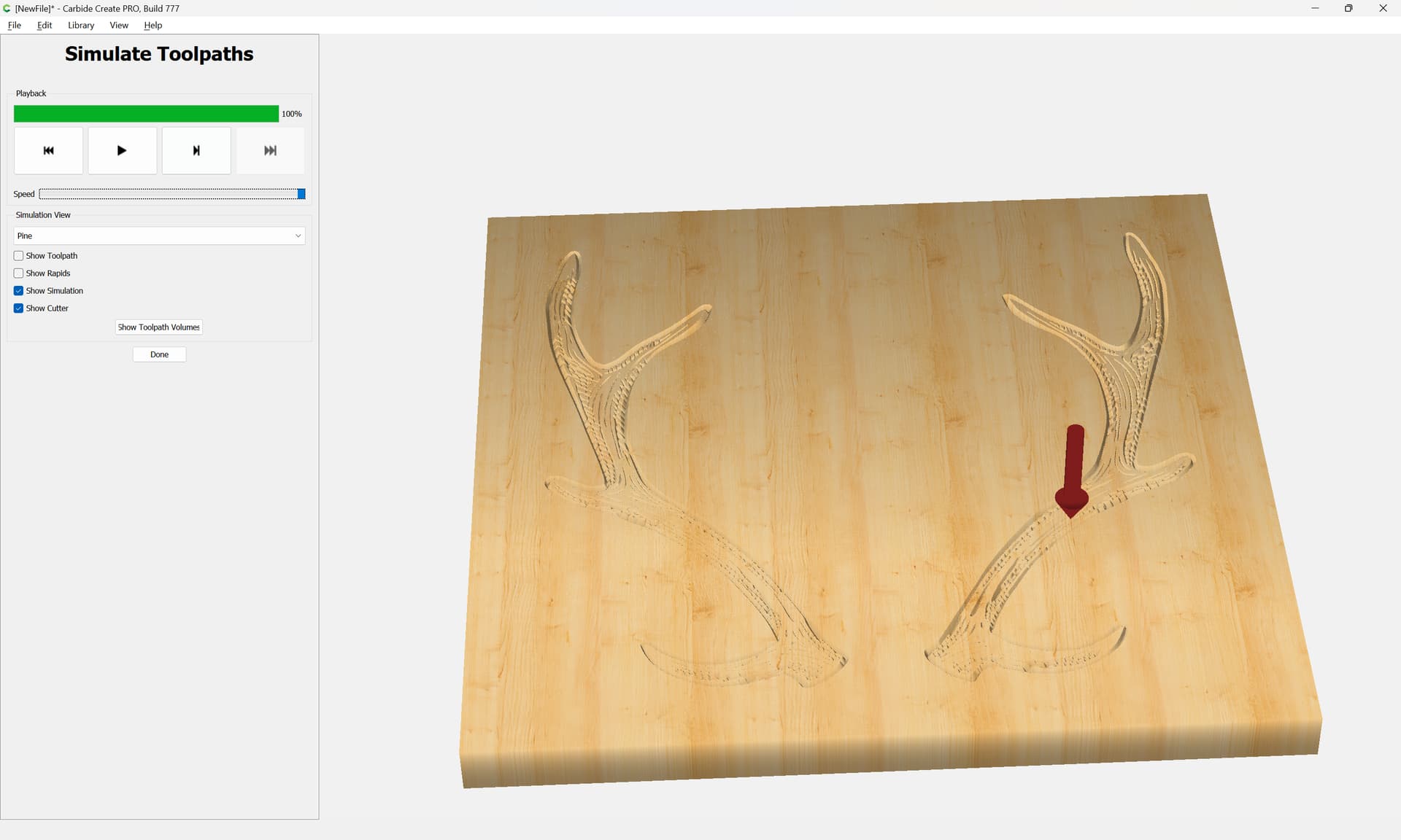

A V carving is straight-forward:

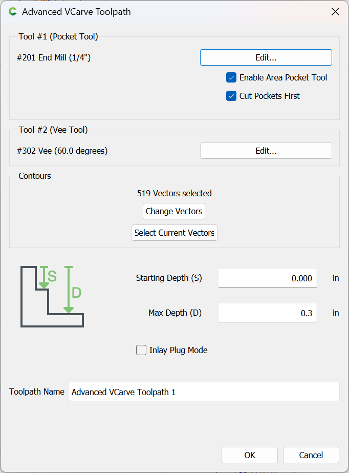

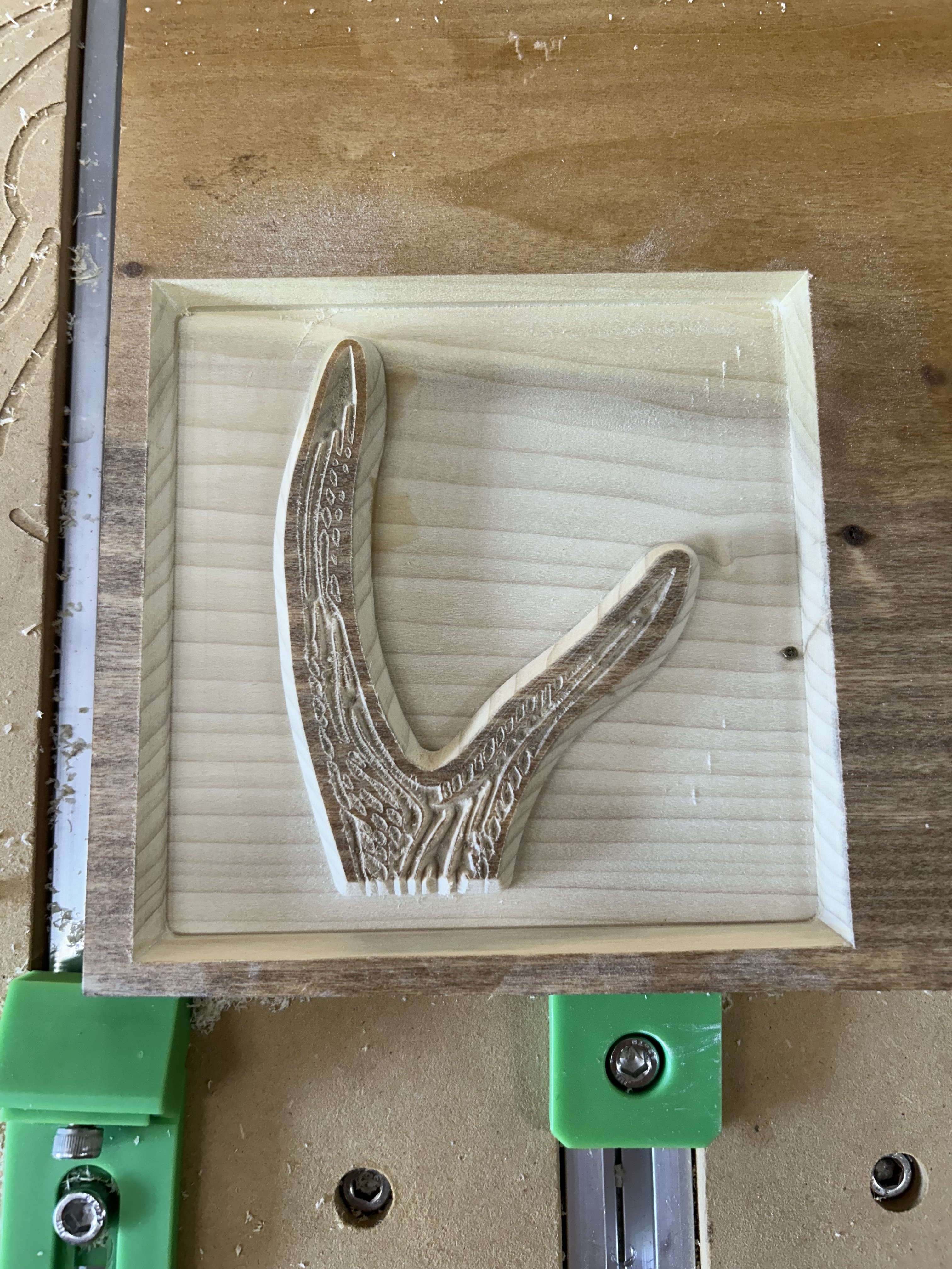

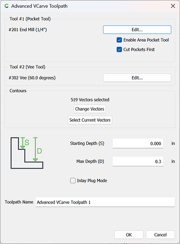

Alternately, one can turn this around:
horns1_v7.c2d (892 KB)
You are the best Will. Can’t wait to try this out!!! I will keep you posted.
