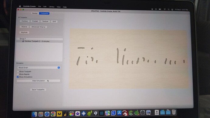

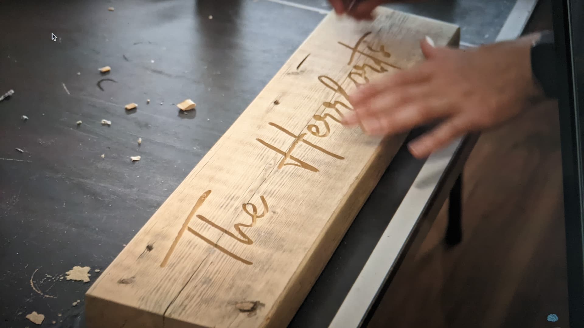

I’m currently trying to make a sign in which I plan to add some wired led rope. I found video in which a fellow maker made one but used an hand router to carve out the name.
I figure our CNC machines would be able to achieve that. Well, I was wrong.

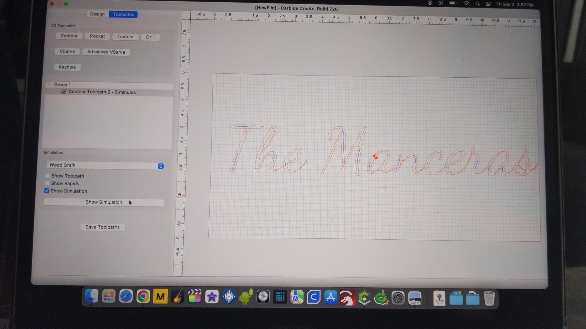

I laid out the words that i want. I then went through the process of welding the letter by creating an offset at 0.01 and then deleting the original text.
I then select the text and move to issuing a tool path. I picked contour using my#102 Endmill 1/8 (The maker used a straight 1/8 bit)

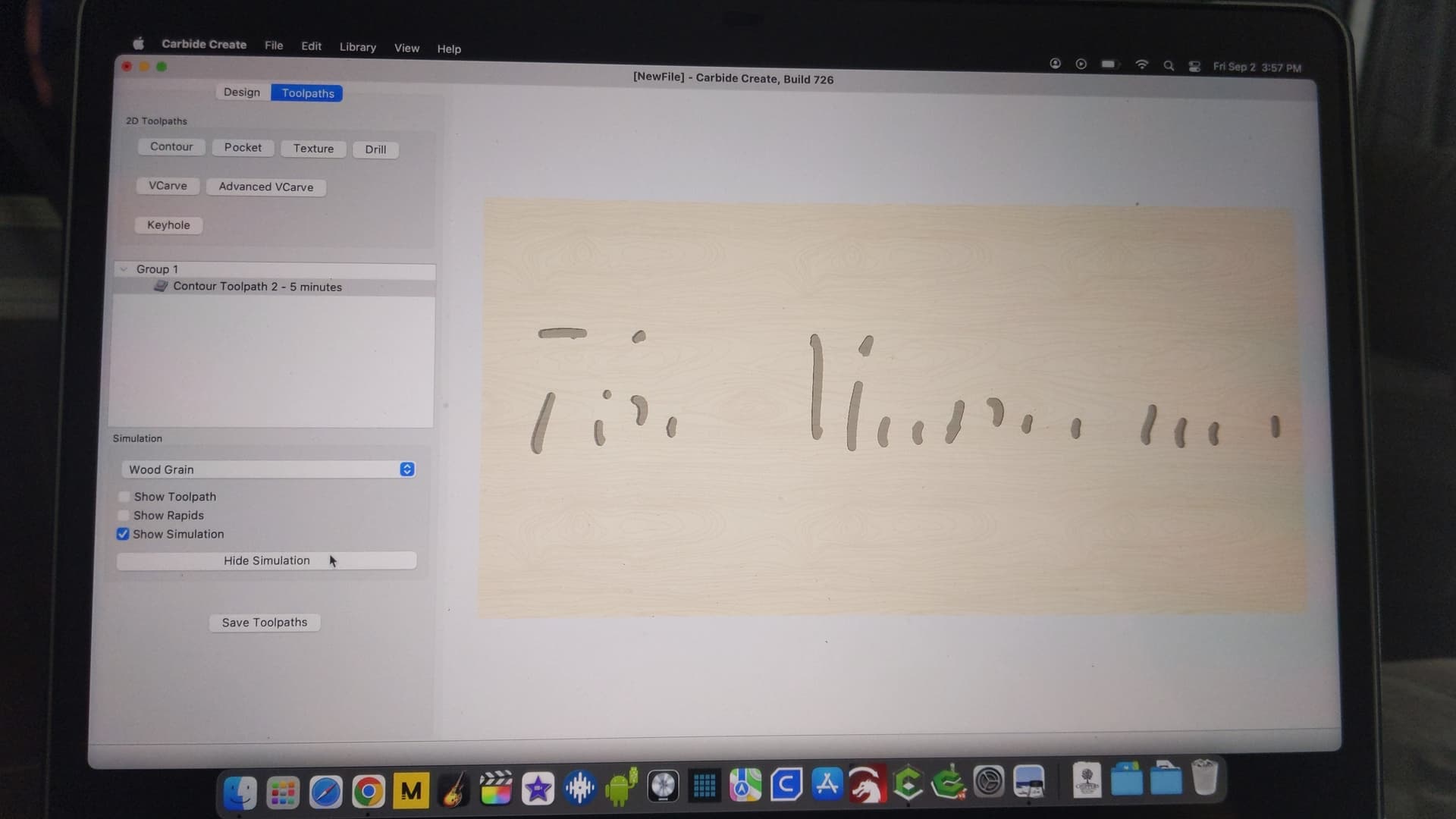

Here is where I’m having issues. Once I click to preview the simulation it looks a hot mess. Most of the wording doesn’t appear.
(picture provided) .
Any idea what I need to do to enable the CNC to cut out exactly what I typed?

Typically this is a case of the bit you’re using being too big to fit in the missing areas of your design.
The effect would be a little different but the V-carve toolpath is an ideal way to handle designs like that that have a range of thicker and thinner elements.
is there something smaller then the #102?
One suggestion is to use a 1/16 or a 1/32 bit to do your tool paths but use a .25 EM in the machine when you actually do the cut.
The problem you are having is the vector is too thin for a 1/8 bit to pocket out the areas.
Another thing you could try it to do a Vcarve then go back over the vector with a contour cut on the line. That will pocket out the vector then you go back over it with the EM to clean up the edges.
The picture you posted of your sample is V Cut.
