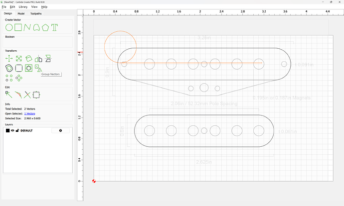

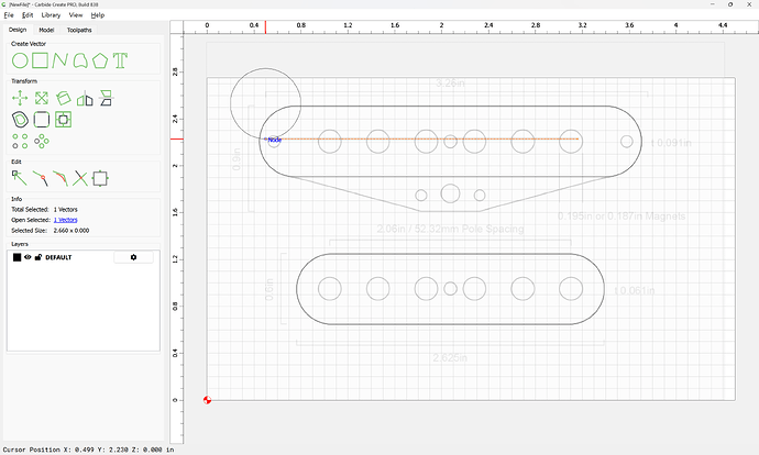

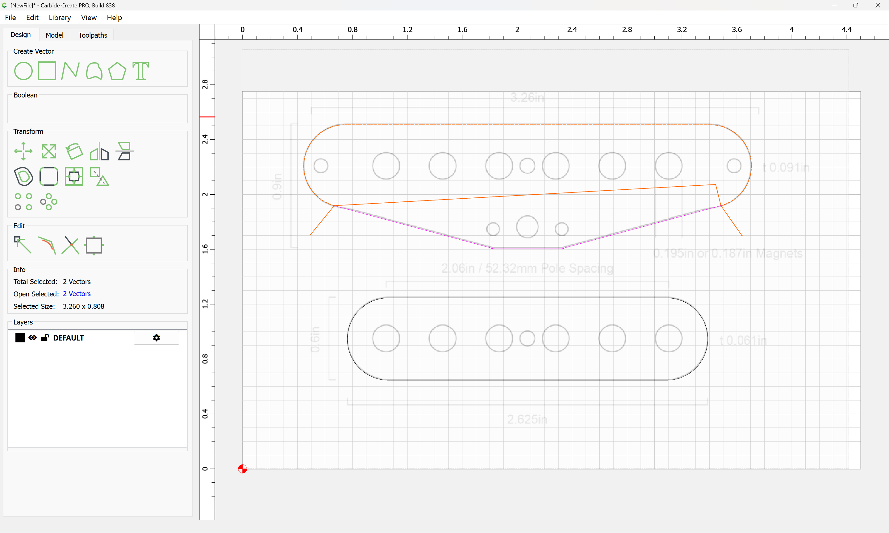

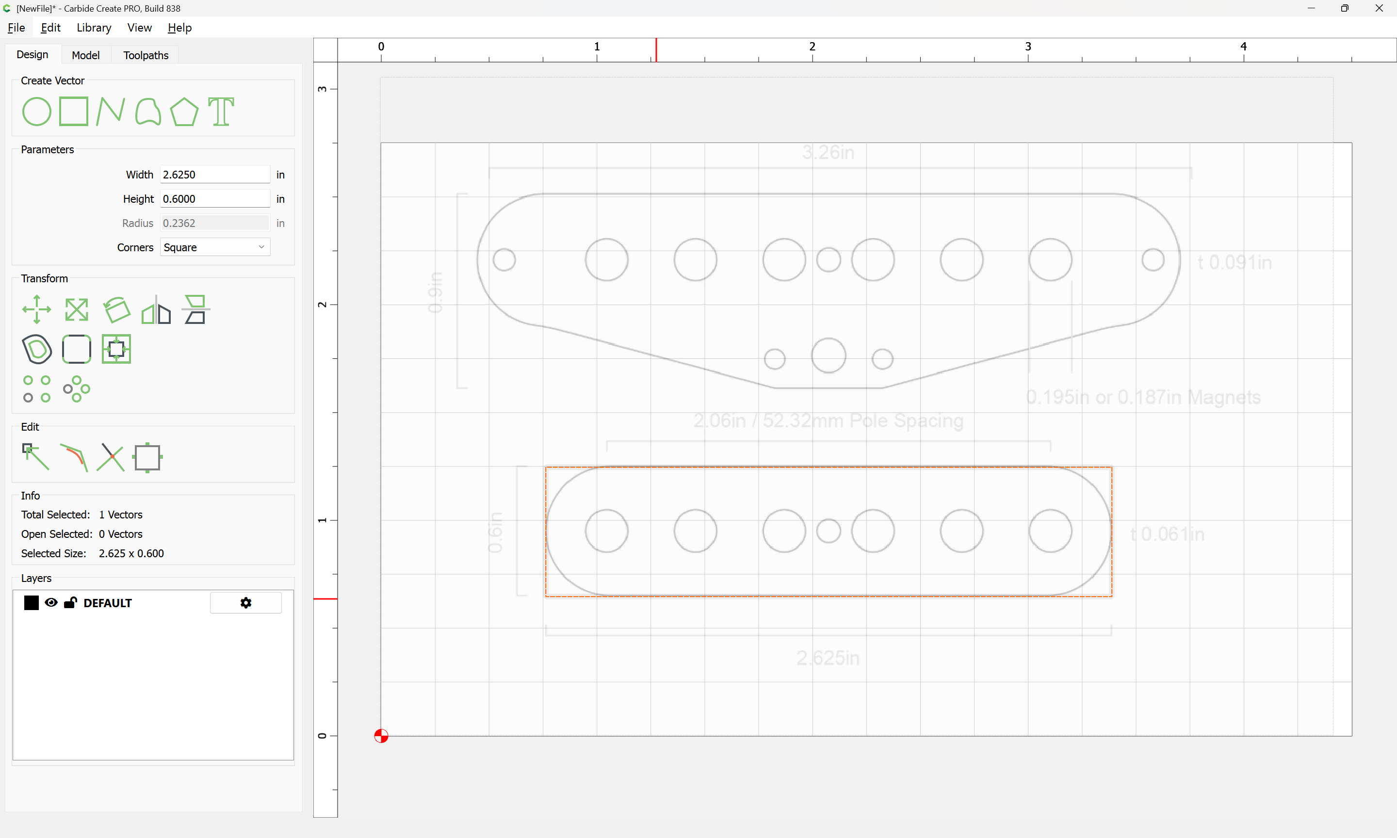

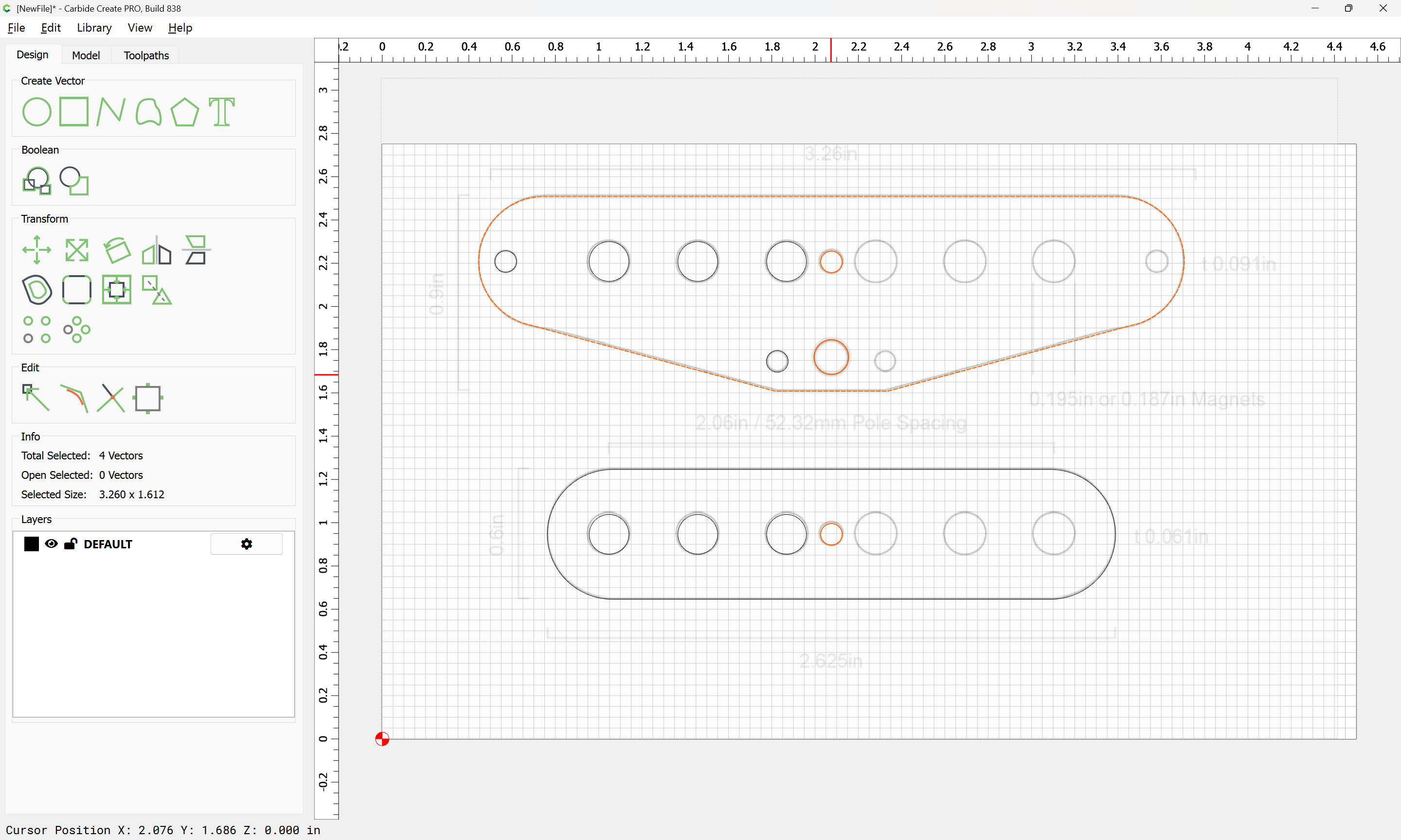

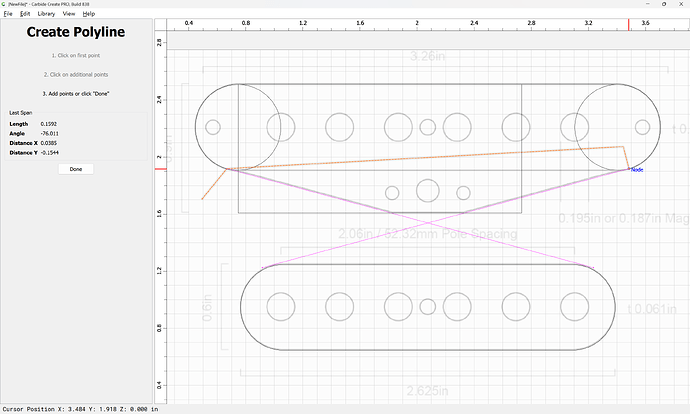

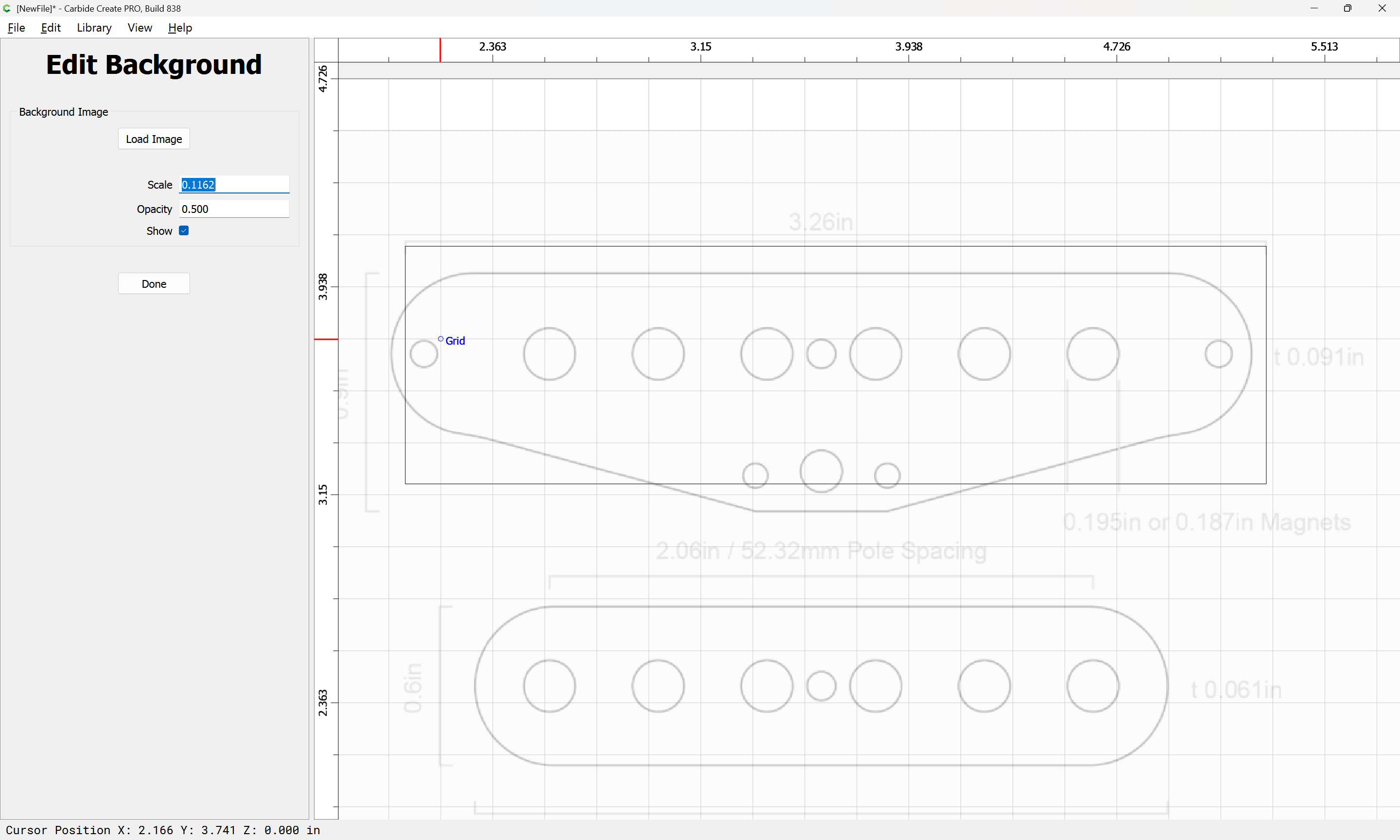

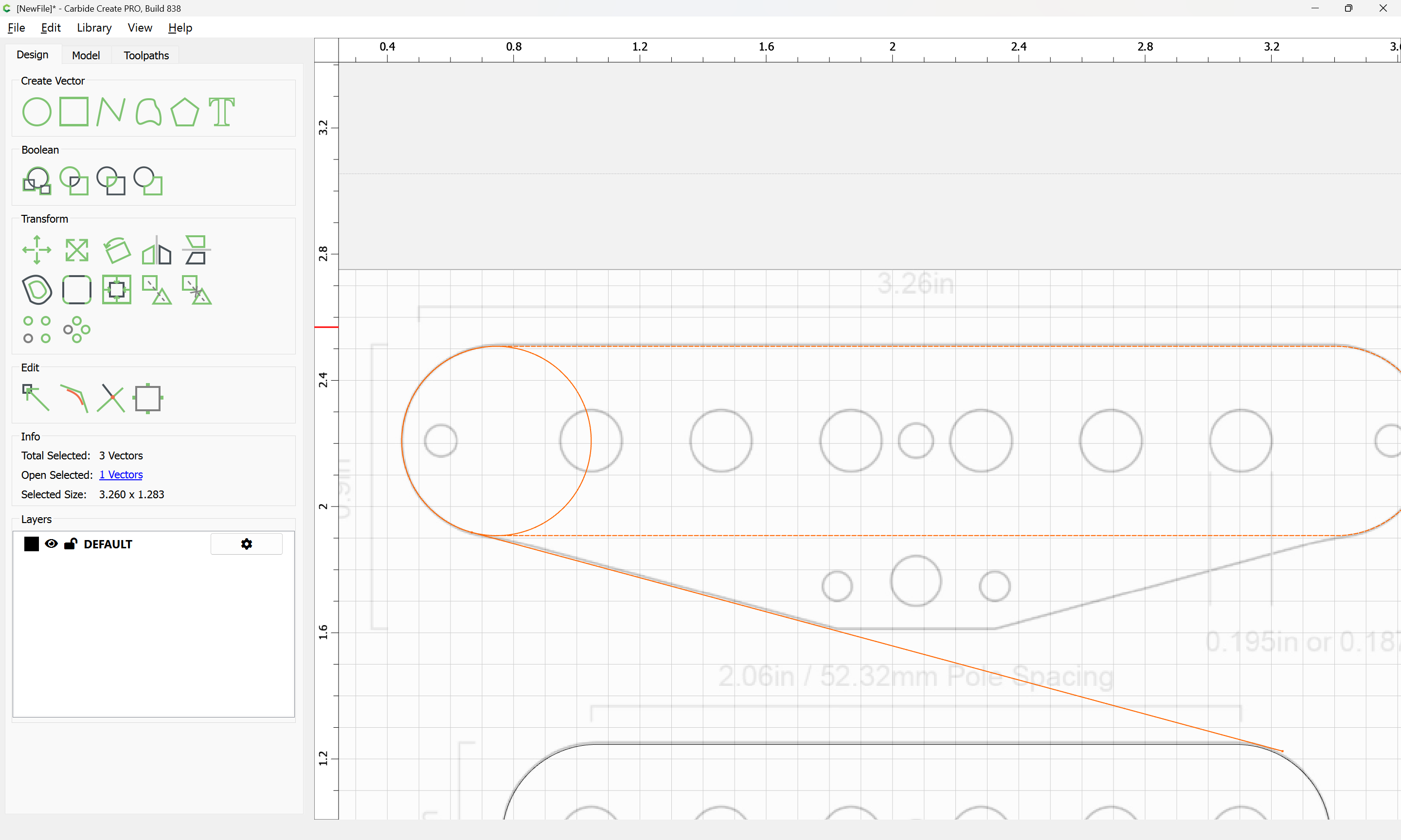

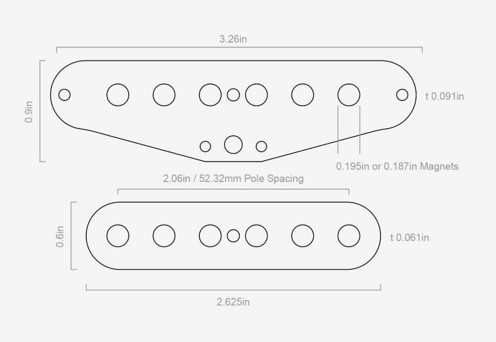

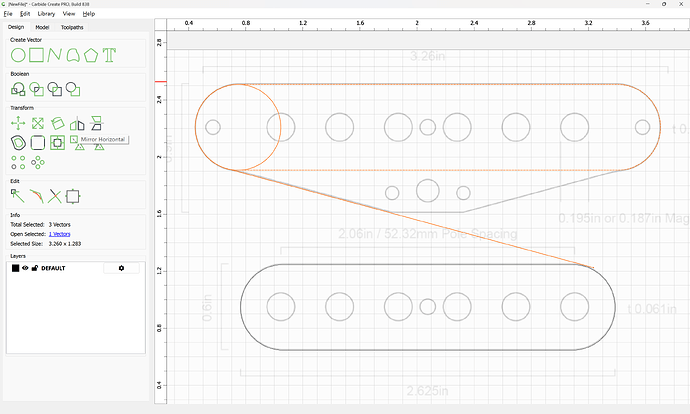

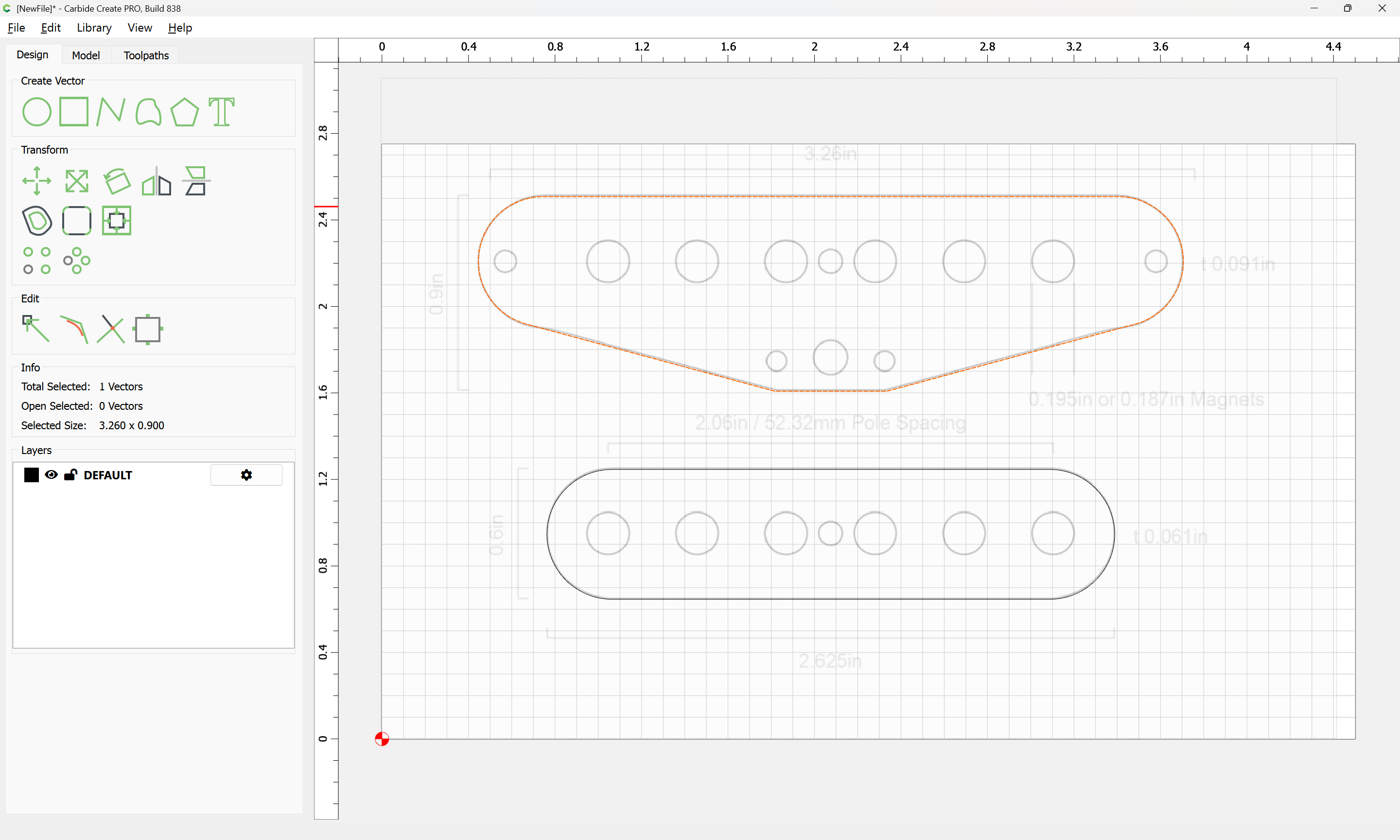

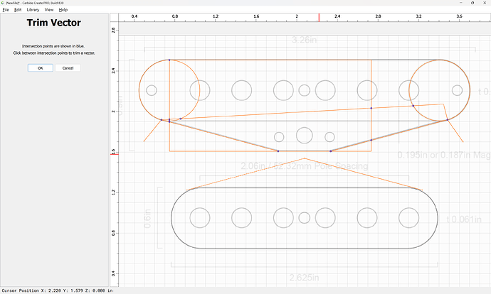

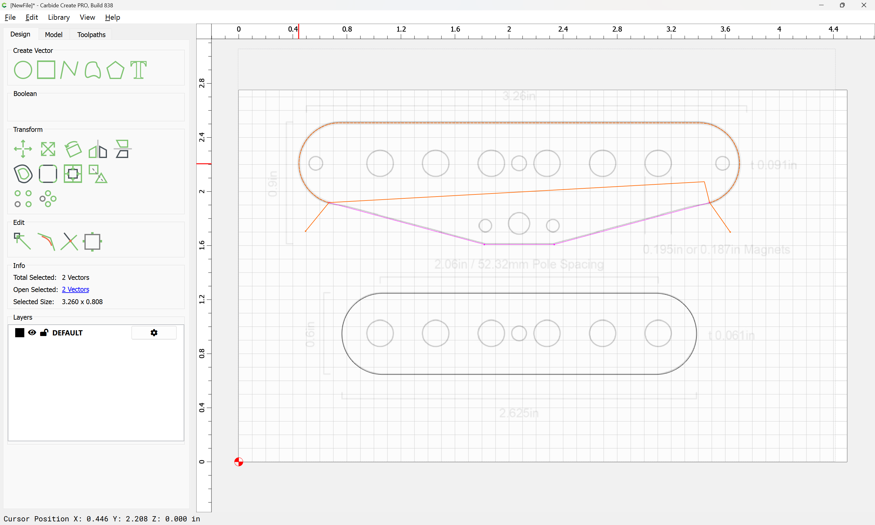

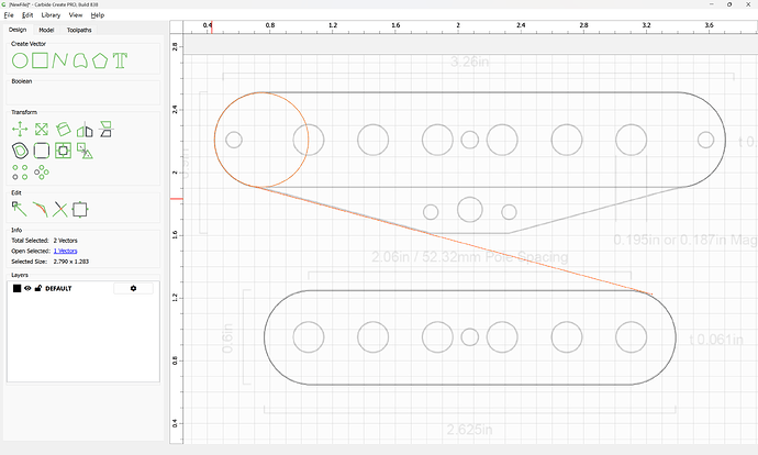

For simplicity’s sake here is a screen grab for a some guitar pickup dimensions. I’m planning on making some holding jigs, and also cut out pieces like this for my own use. It’s not hard to just draw this out in CC, but it just seems like there is probably a faster way to just get it into the program. One picture is a screen grab, the

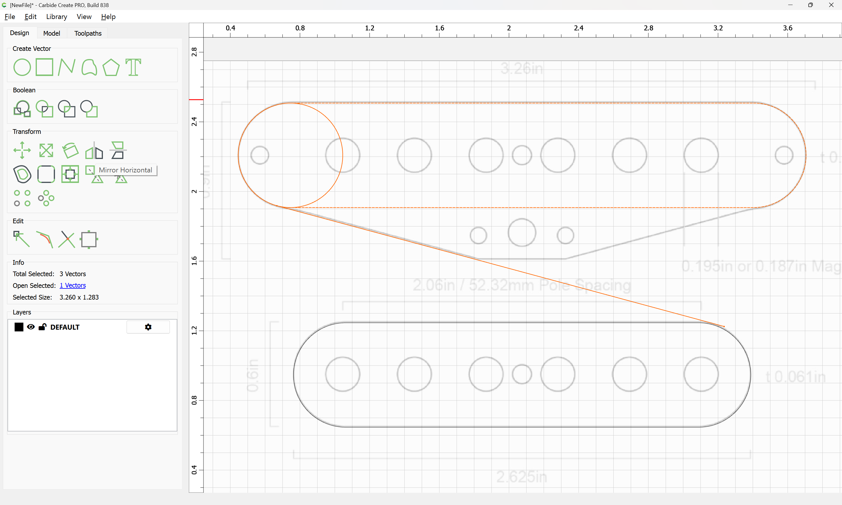

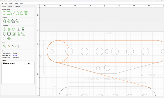

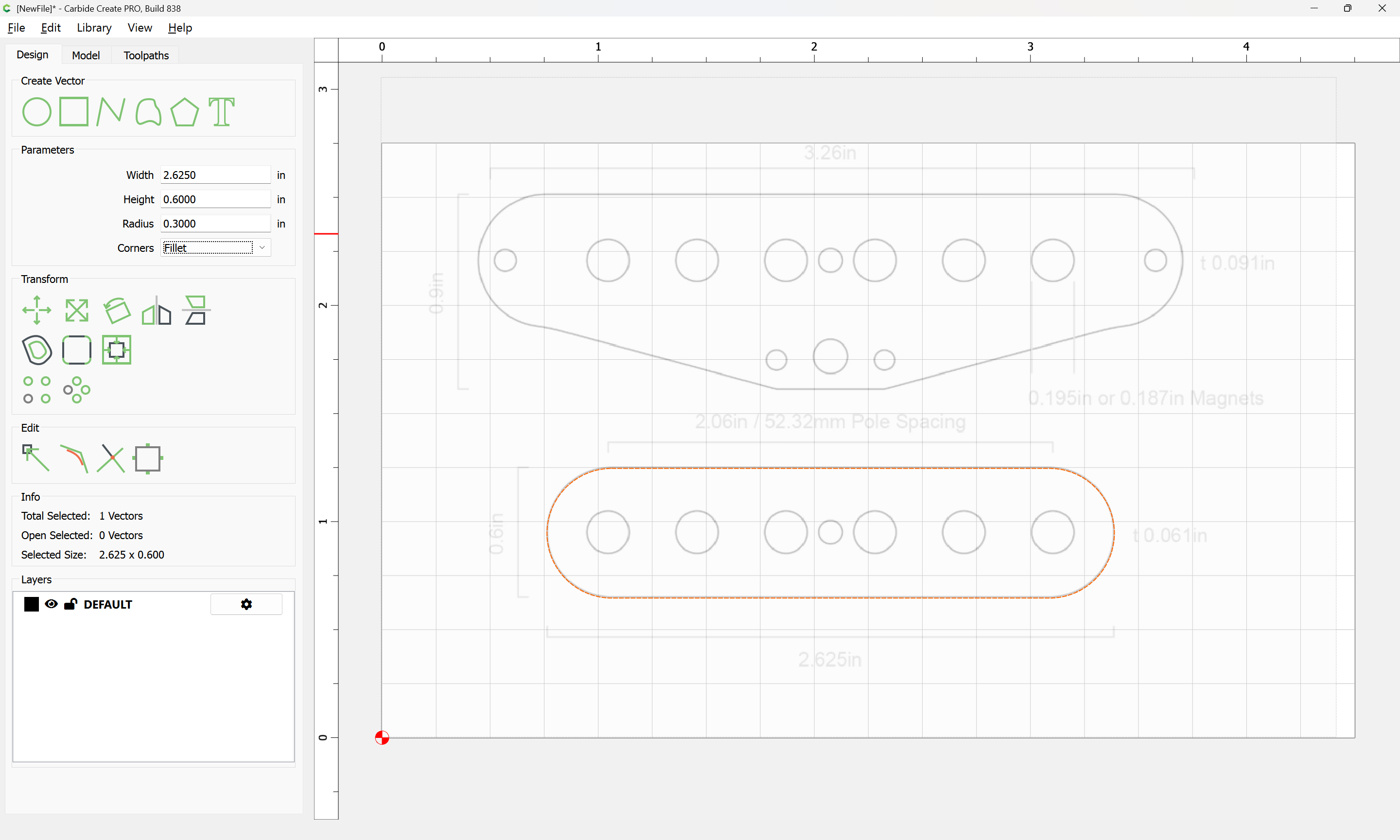

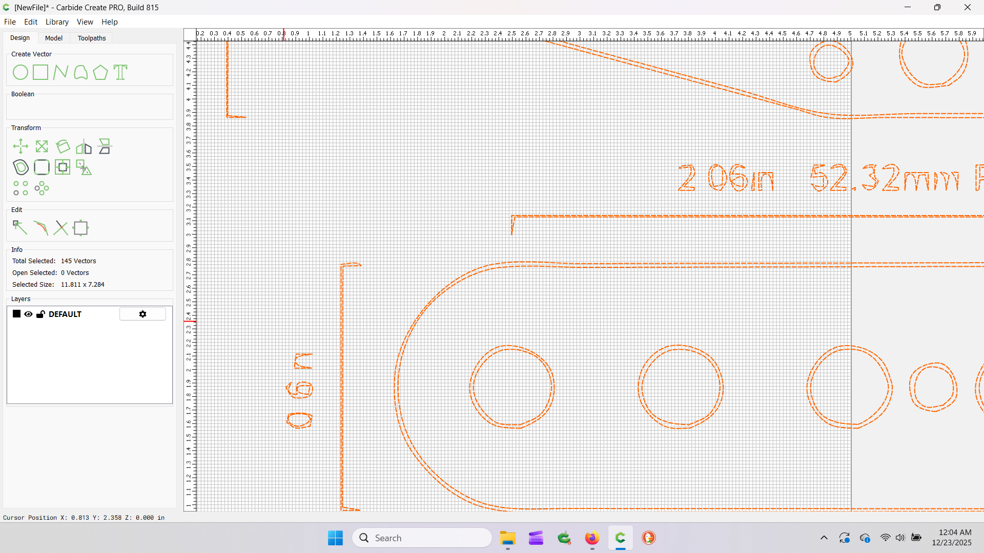

next is zoomed in on what CC does when I trace. You can see how the circles are all messed up. I understand the concept of it being a tracing, inside and outside lines of the original drawing, I’m wondering if there is a way for the tracing function to do this cleaner?

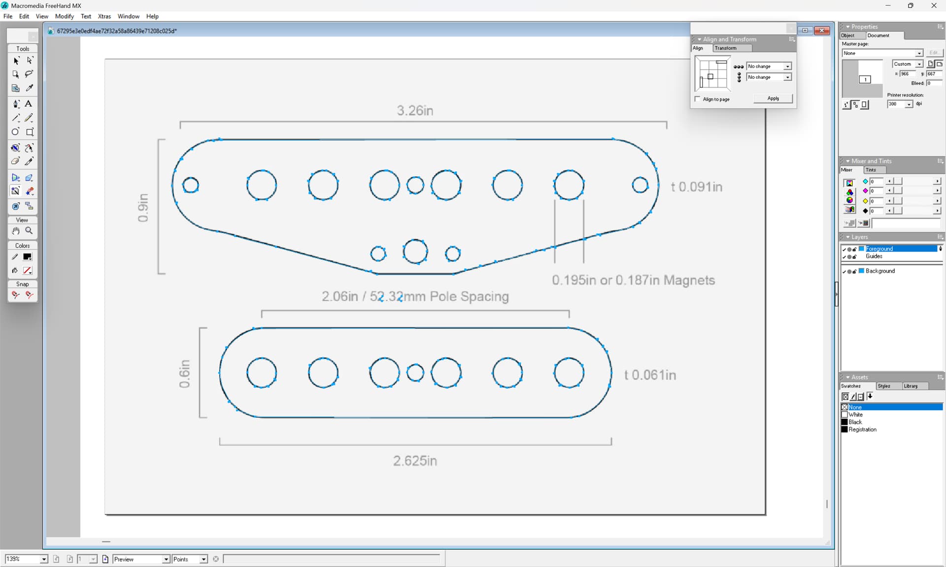

In order for that to work, you need a Centerline tracing functionality, which Carbide Create doesn’t have.

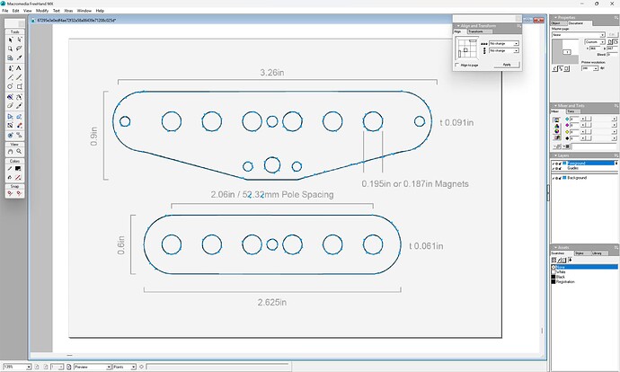

Using a tool which does have that feature one gets something like:
which will probably take longer to clean up, than it will to just re-draw.

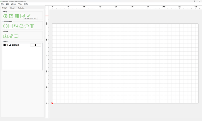

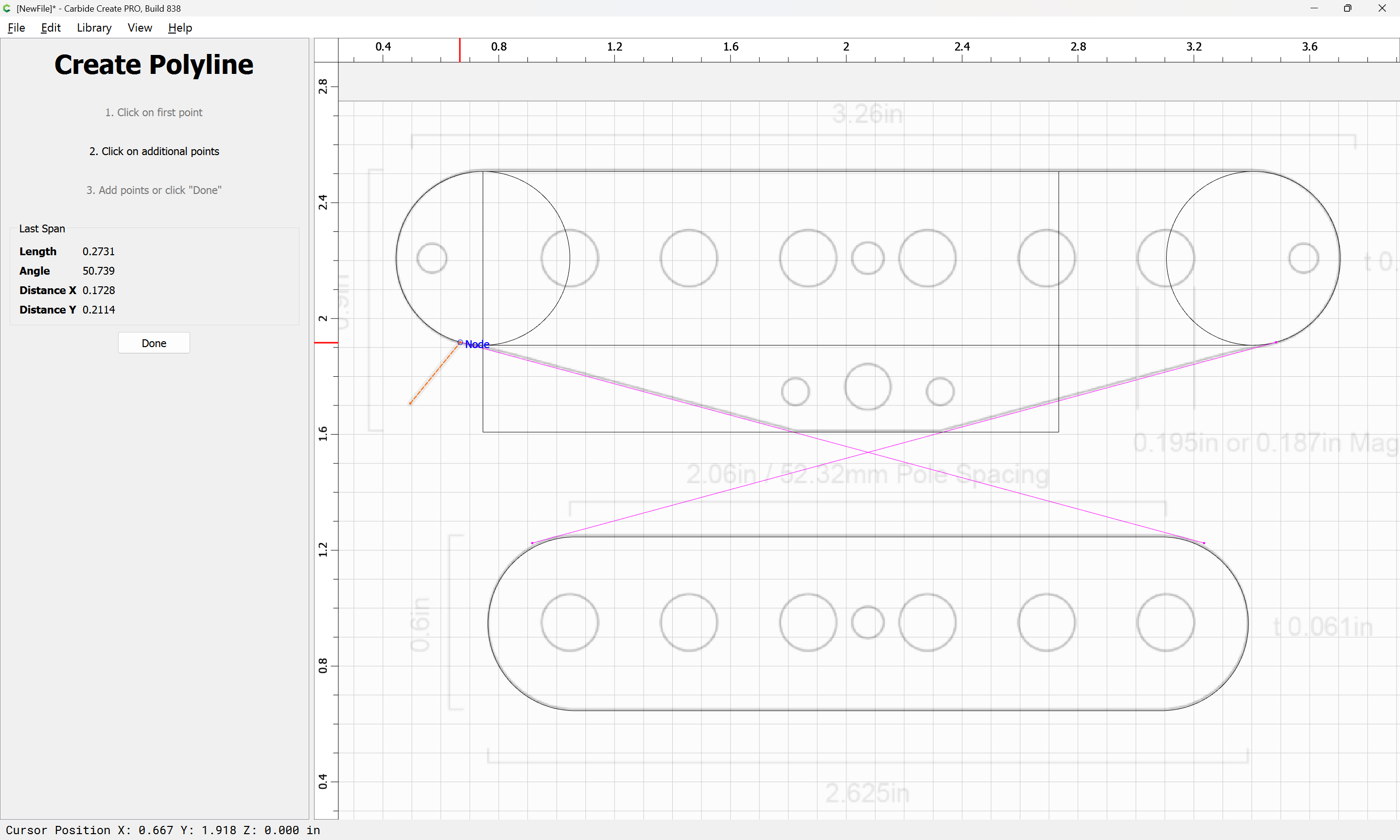

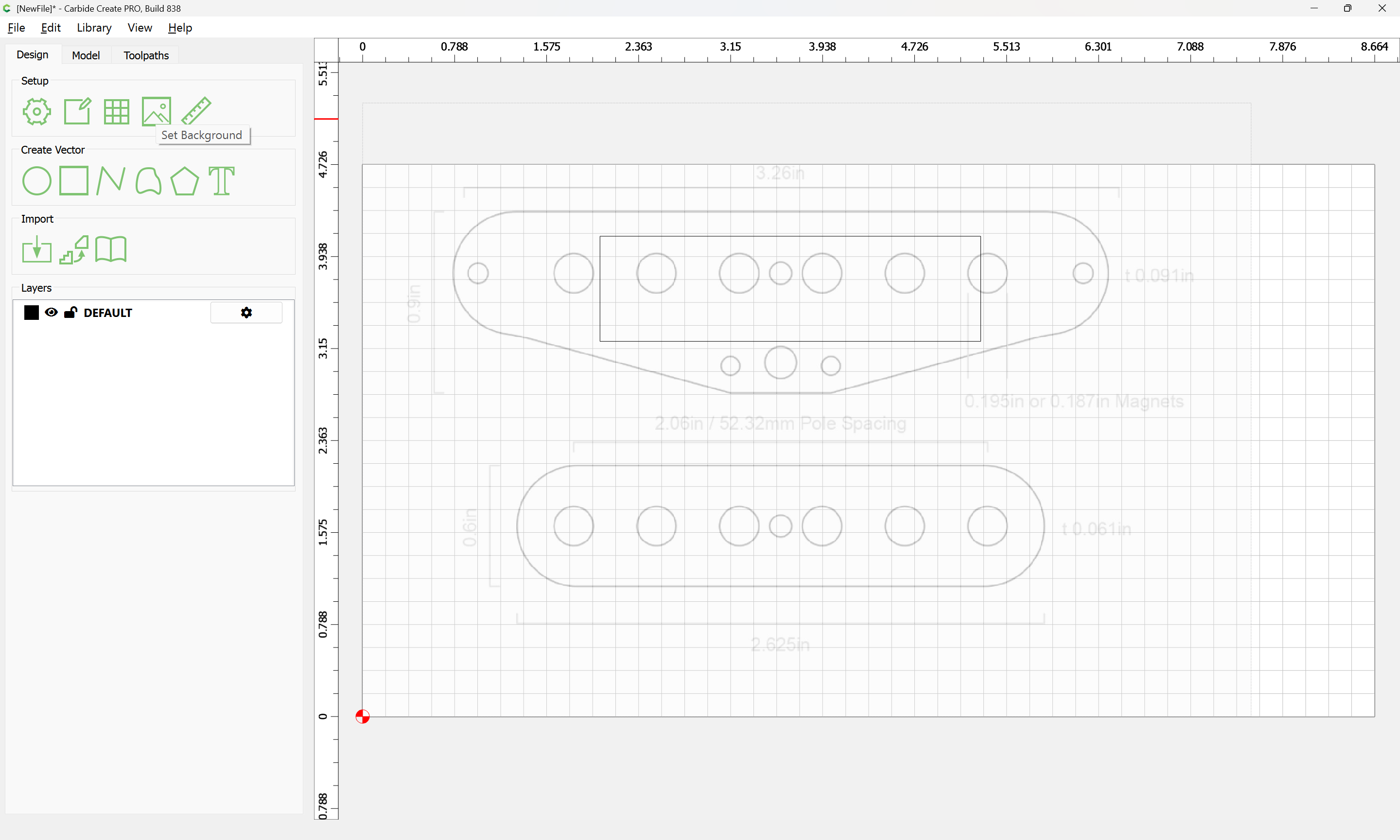

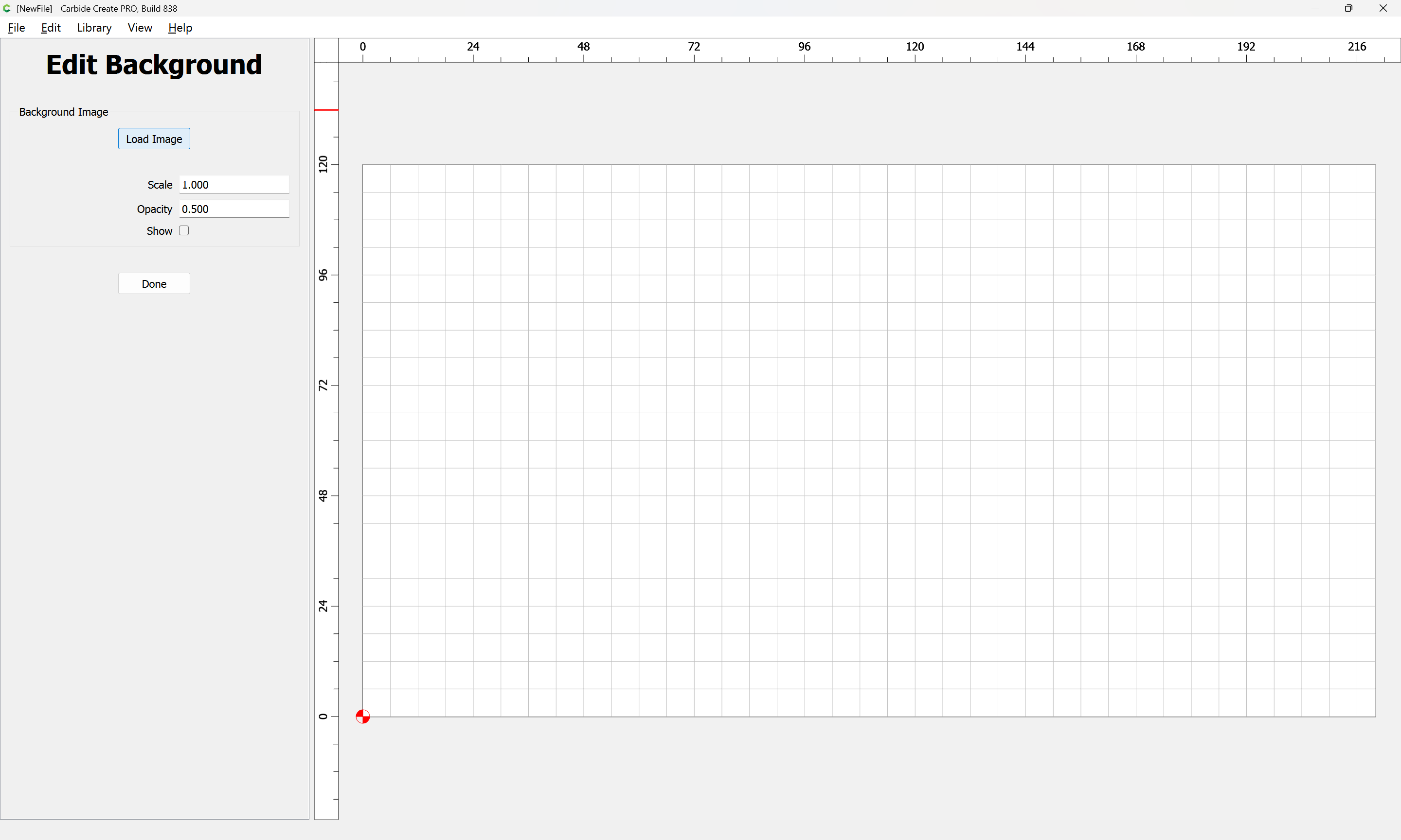

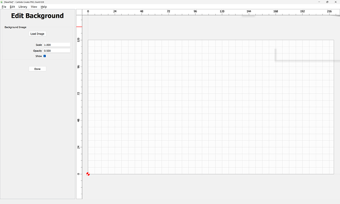

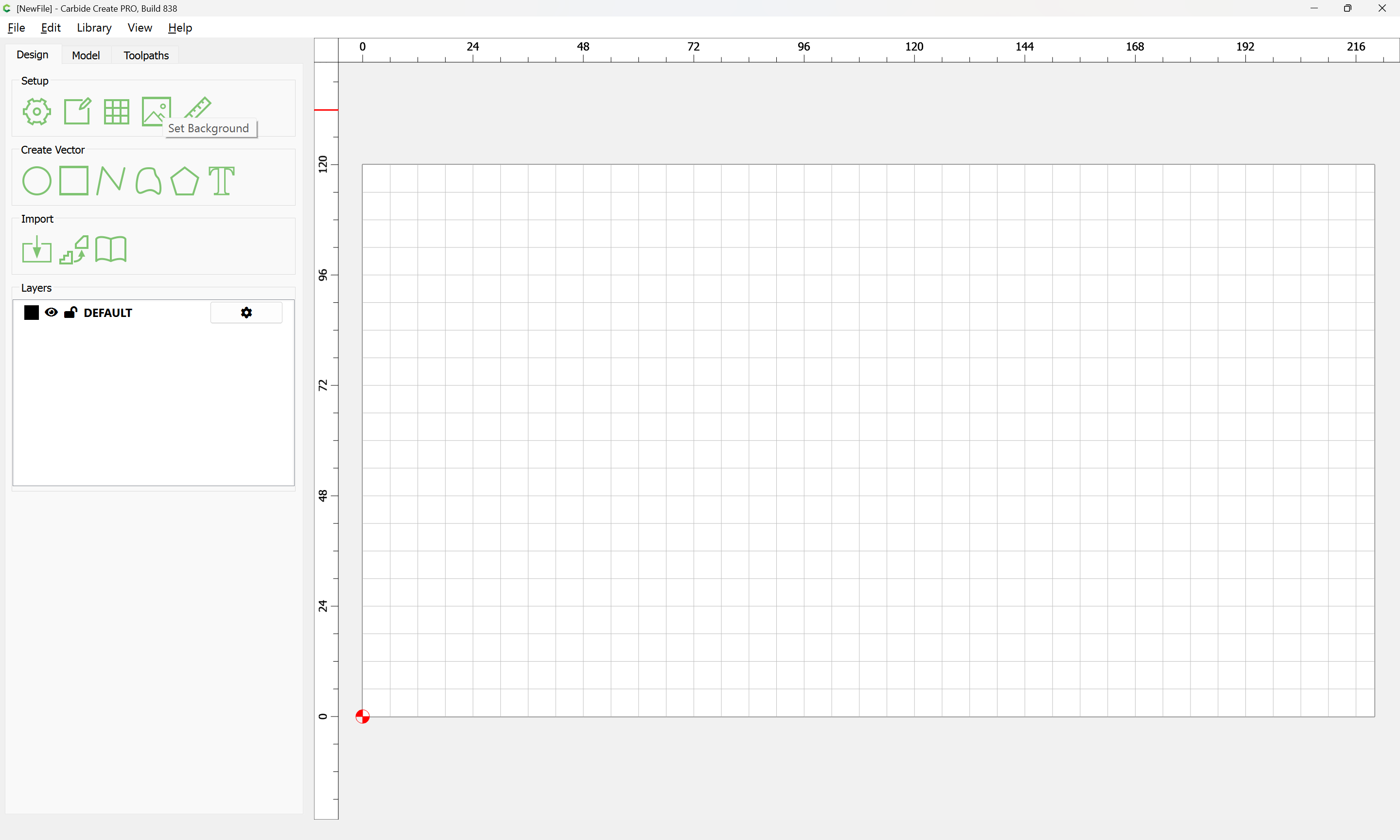

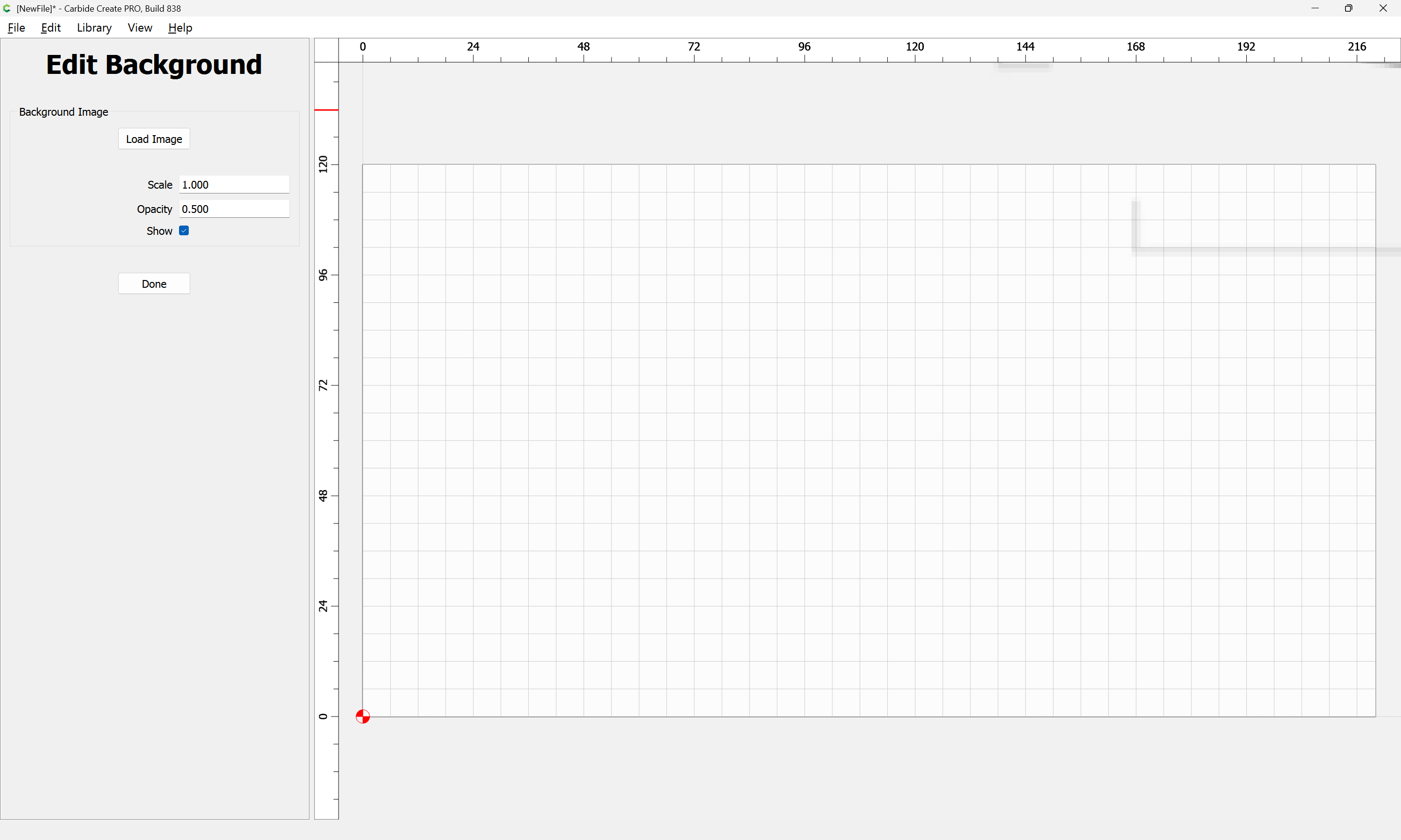

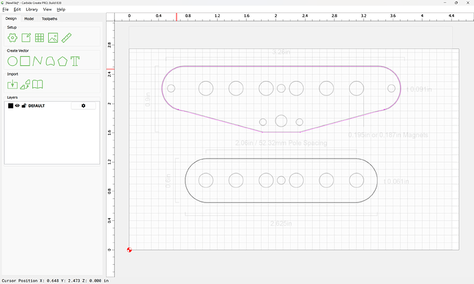

Launch Carbide Create:
Set Background

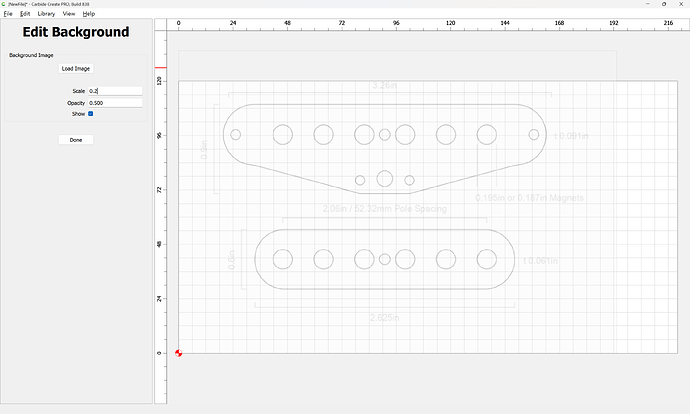

Load Image

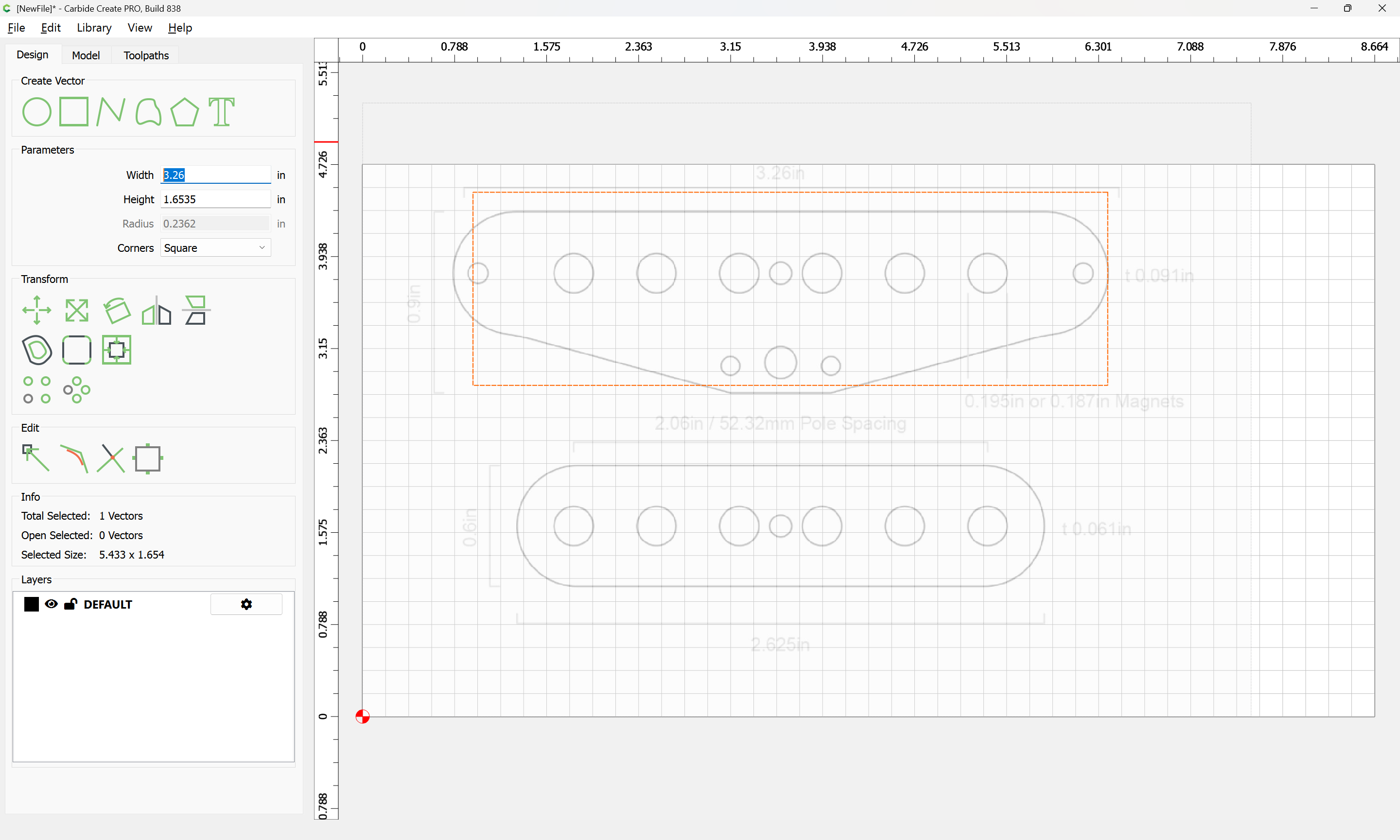

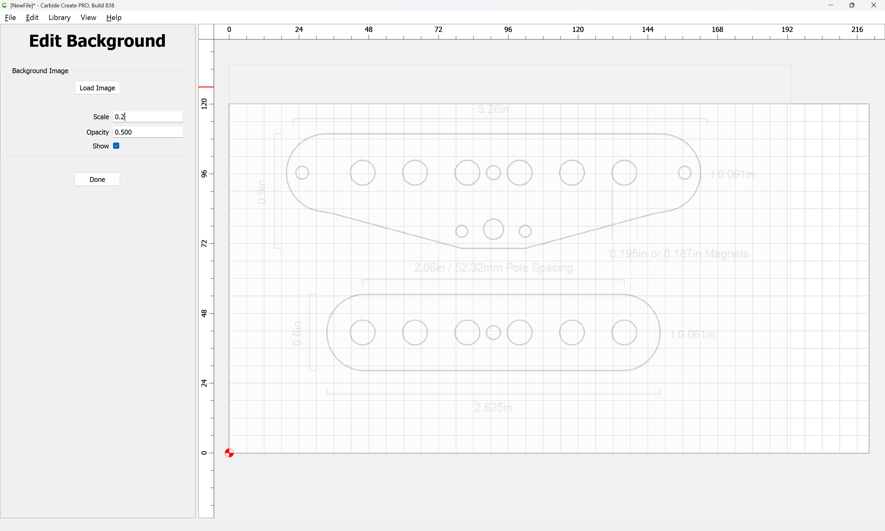

Scale down until everything can be seen:

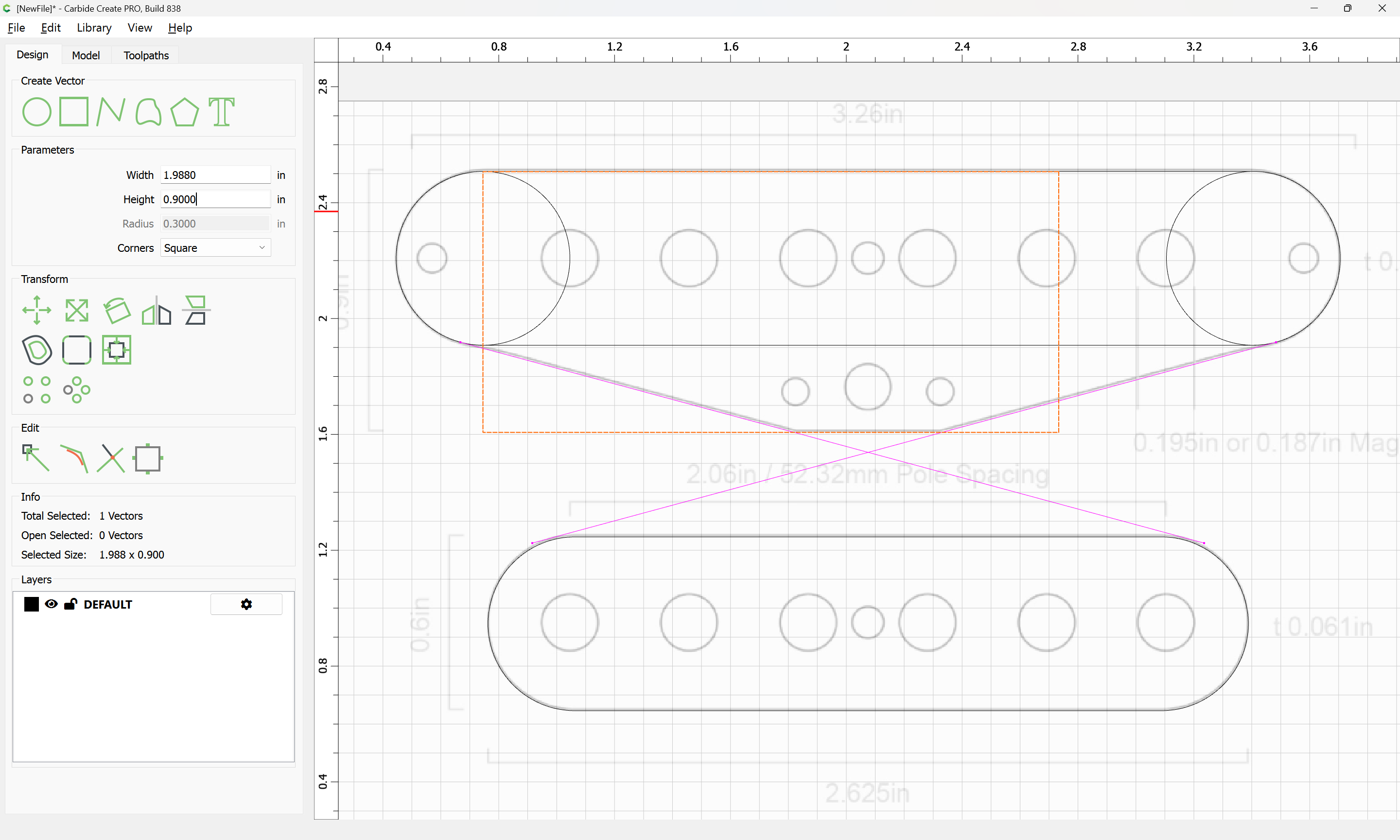

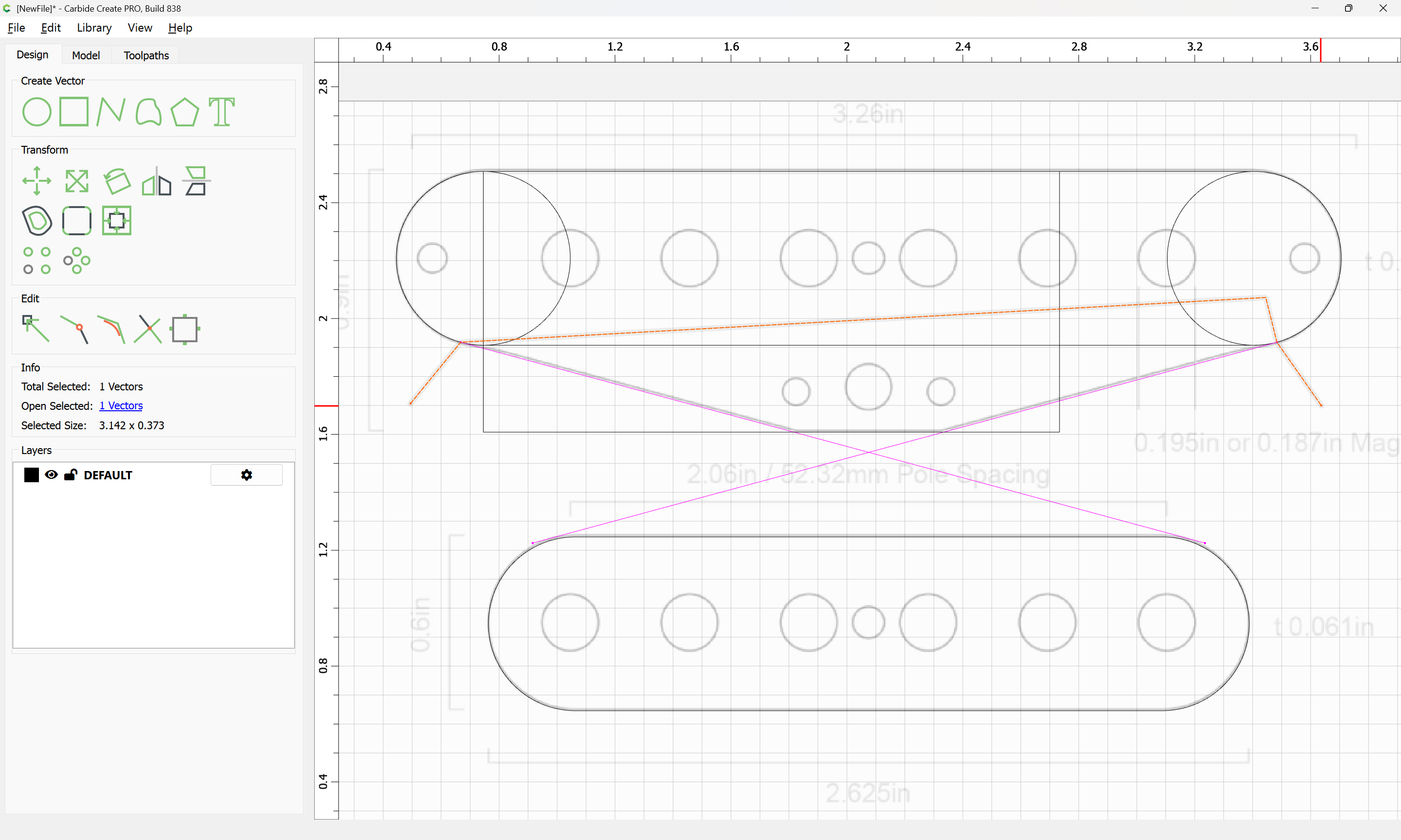

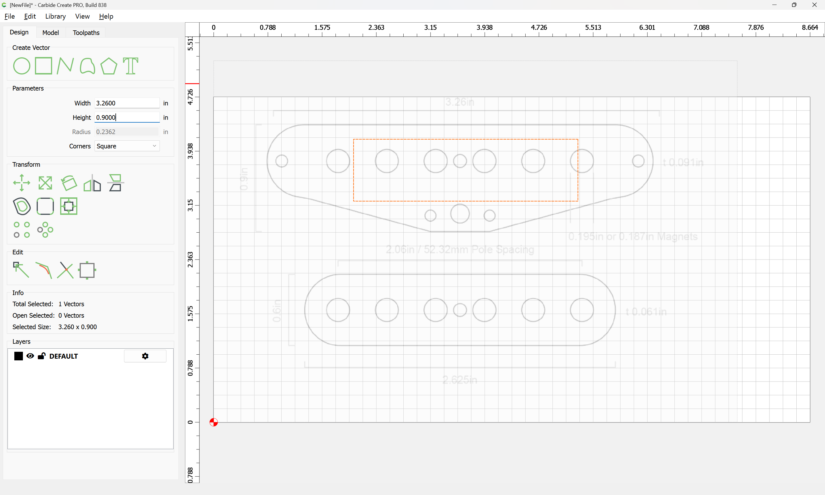

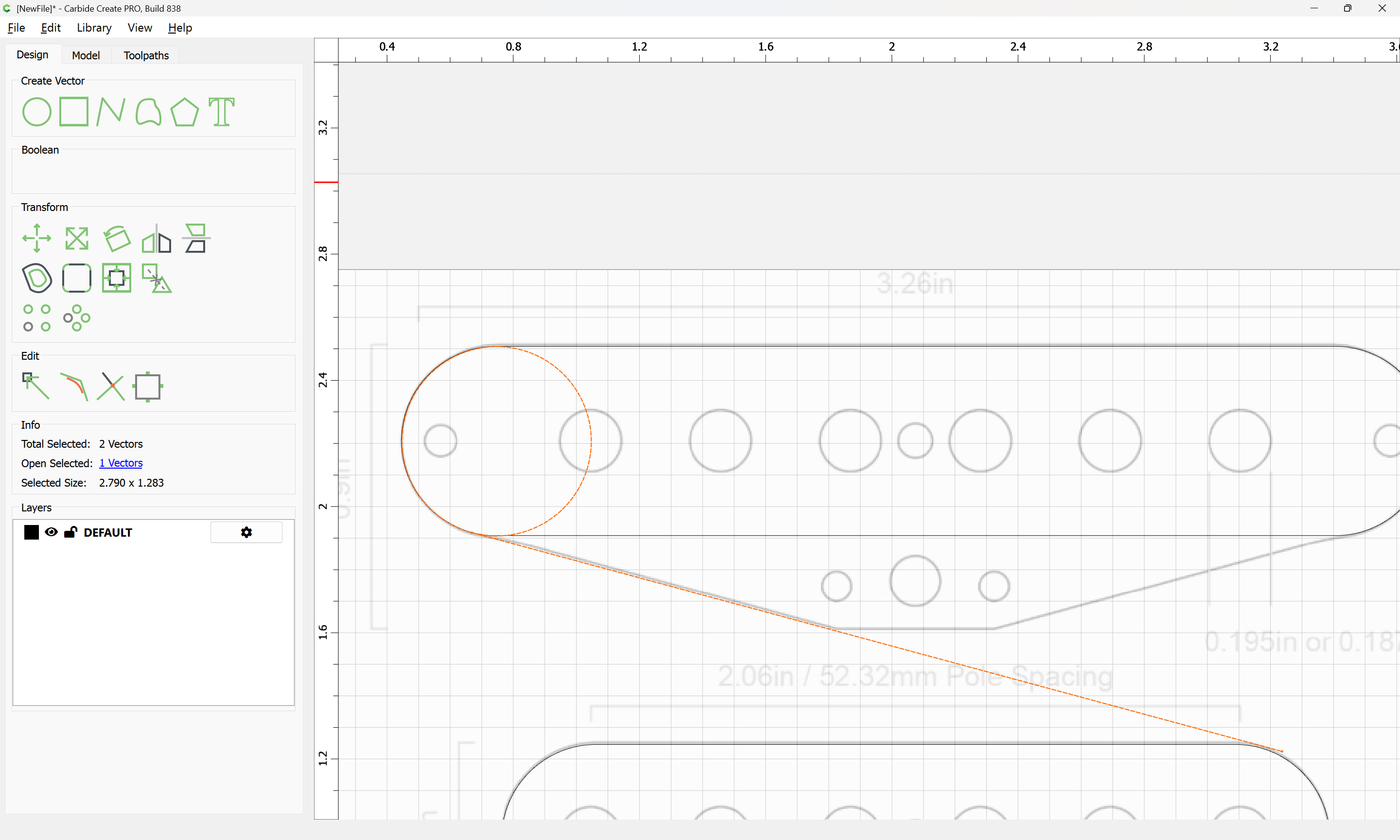

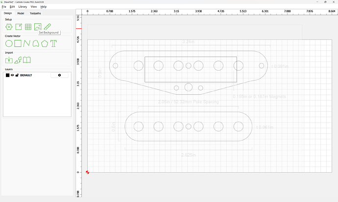

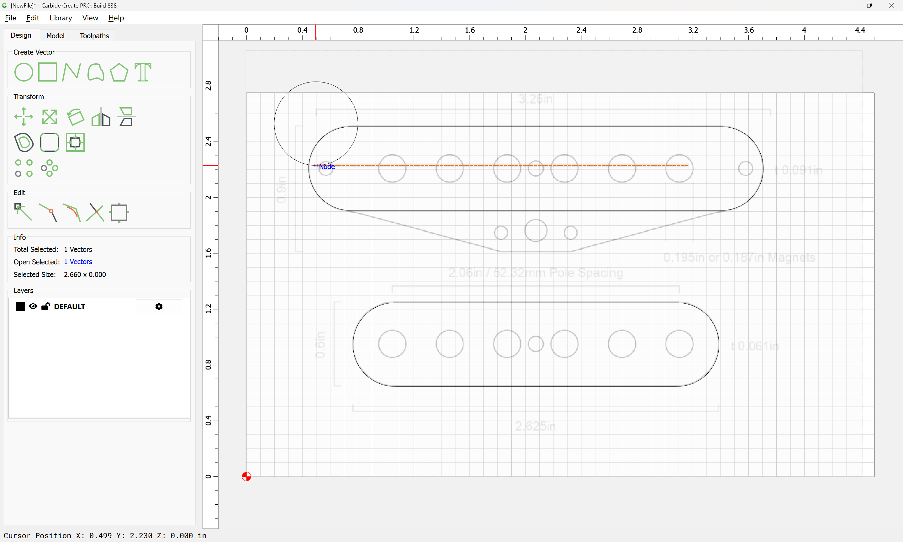

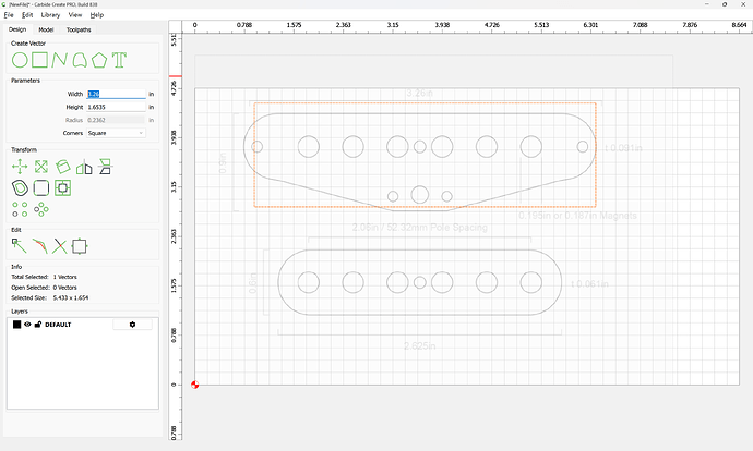

Draw a rectangle of the largest dimensions:
Scale the image until it matches that size:

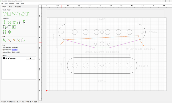

Draw.

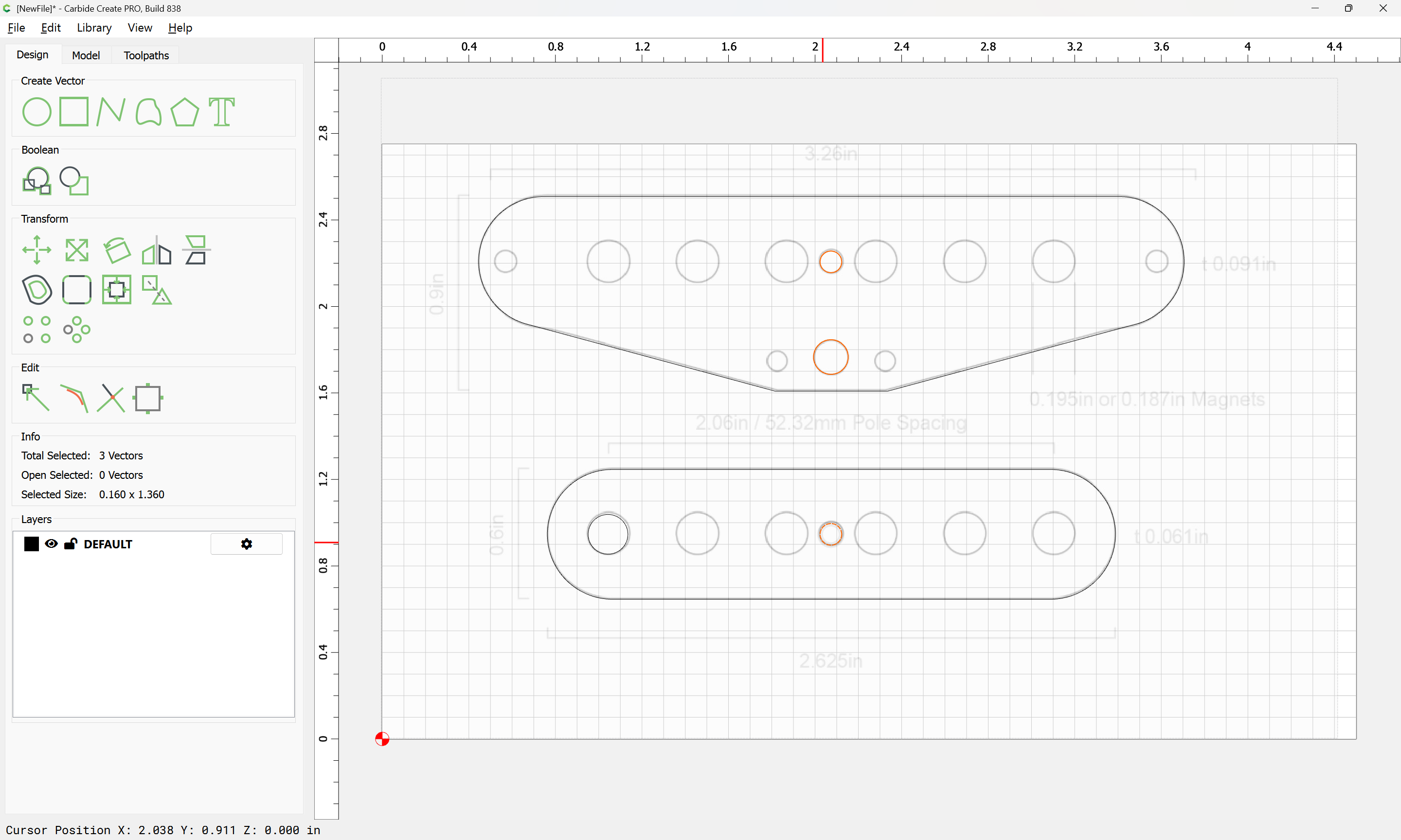

adding features as necessary:

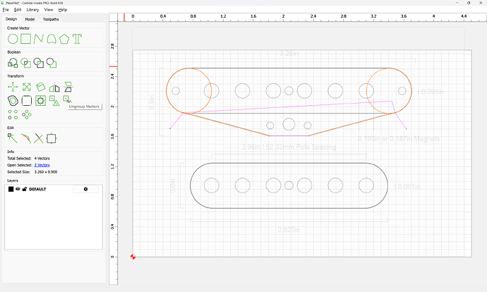

Duplicating similar elements where appropriate:

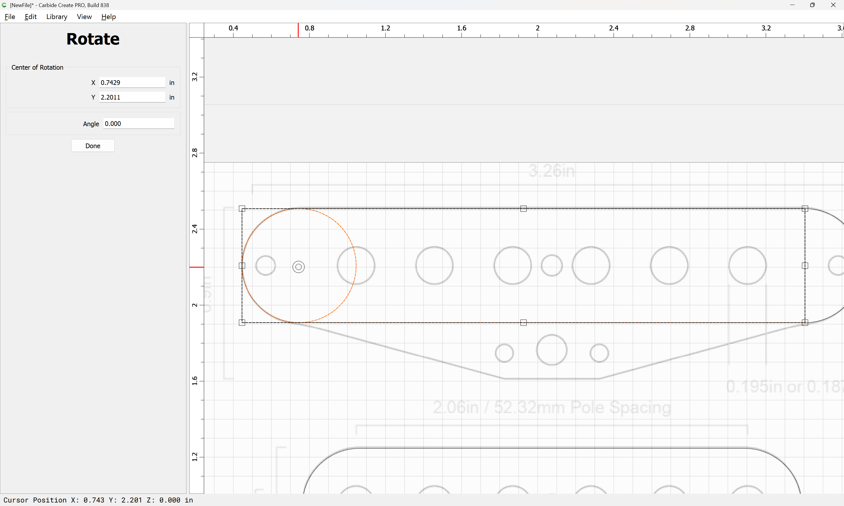

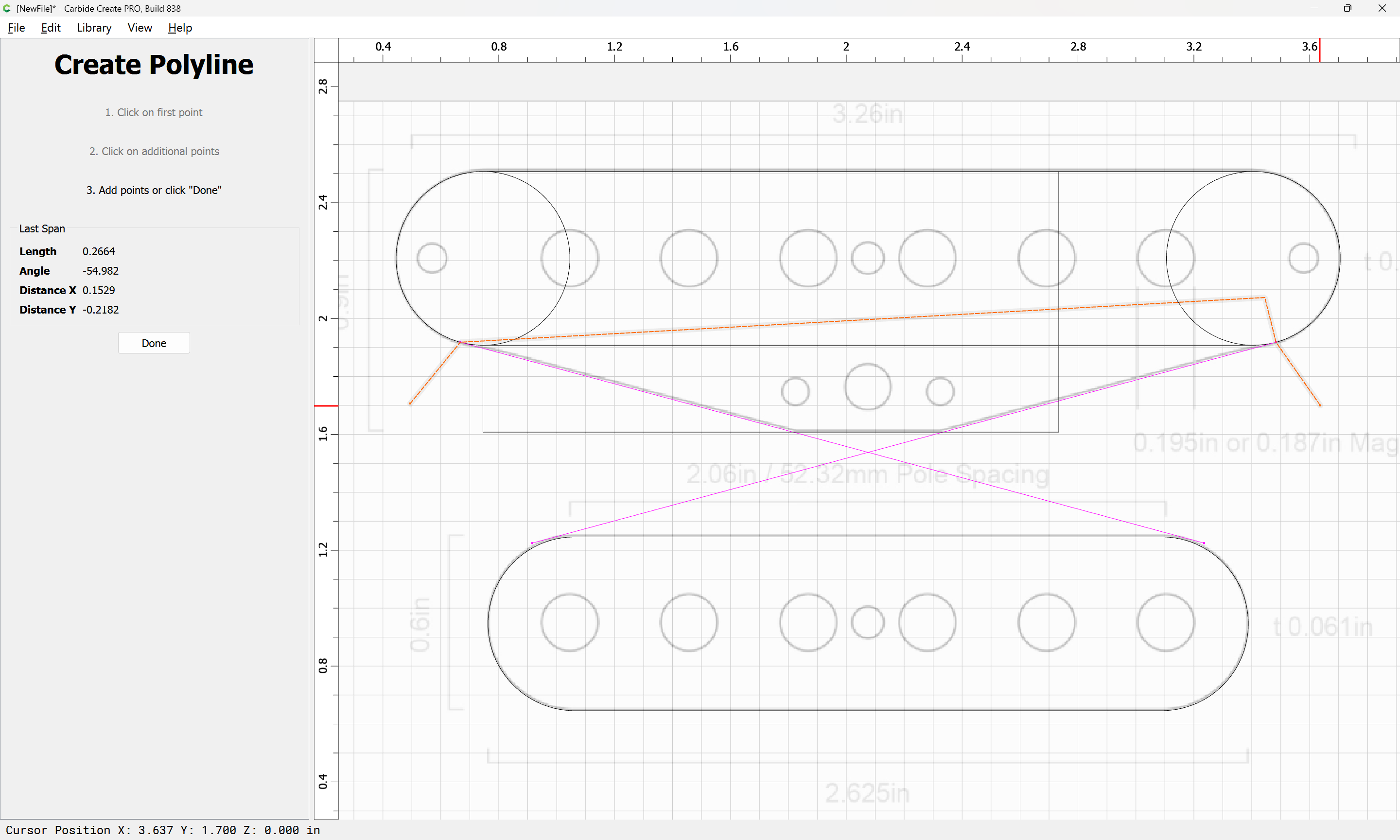

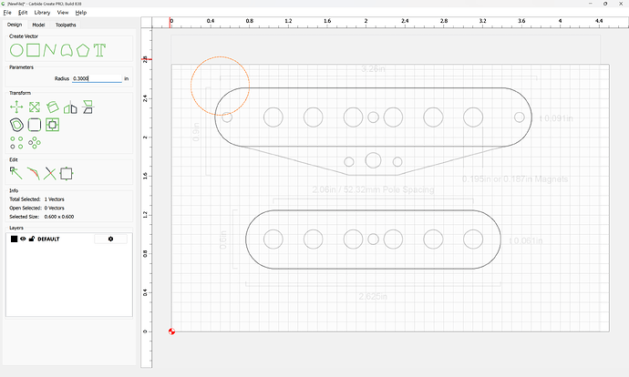

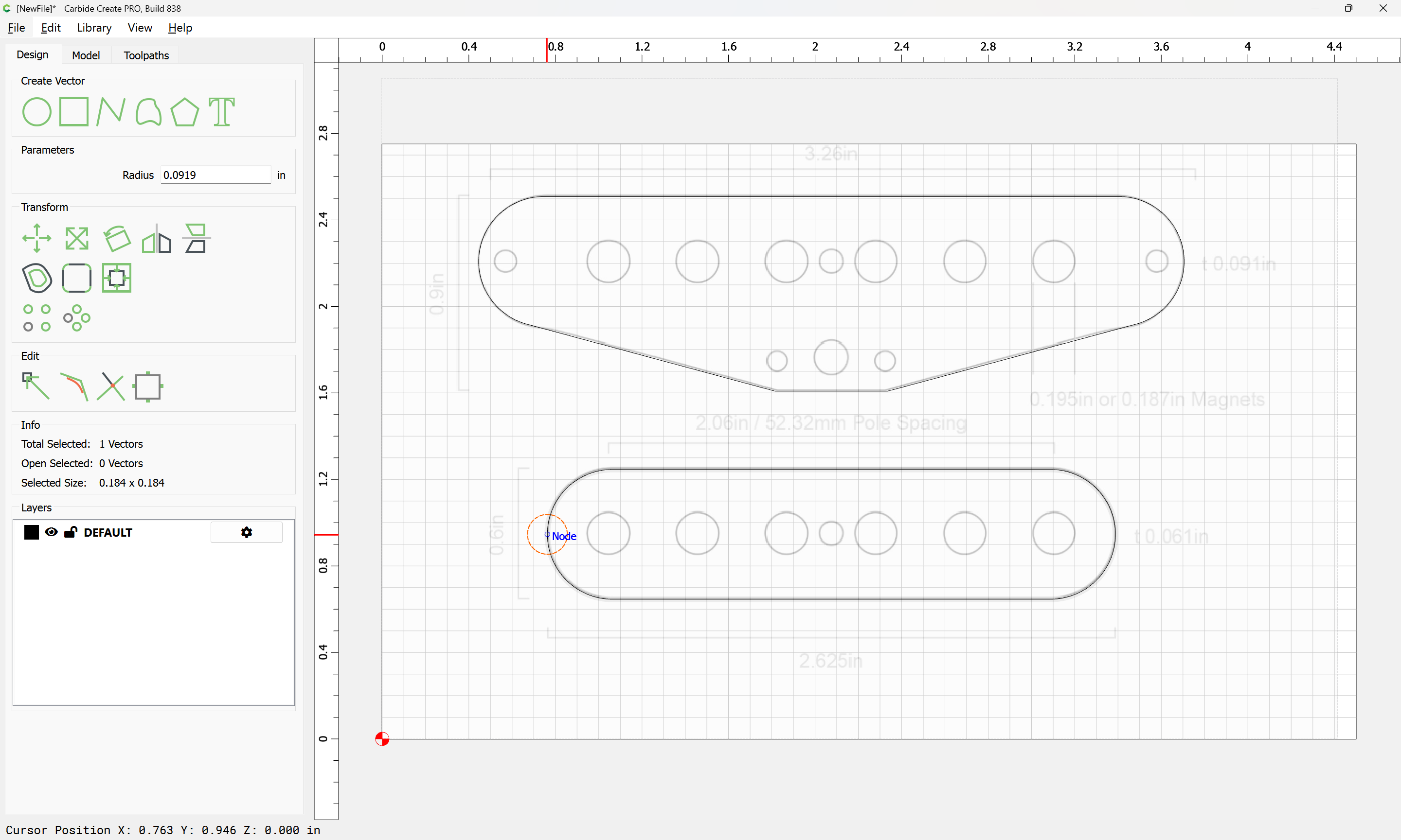

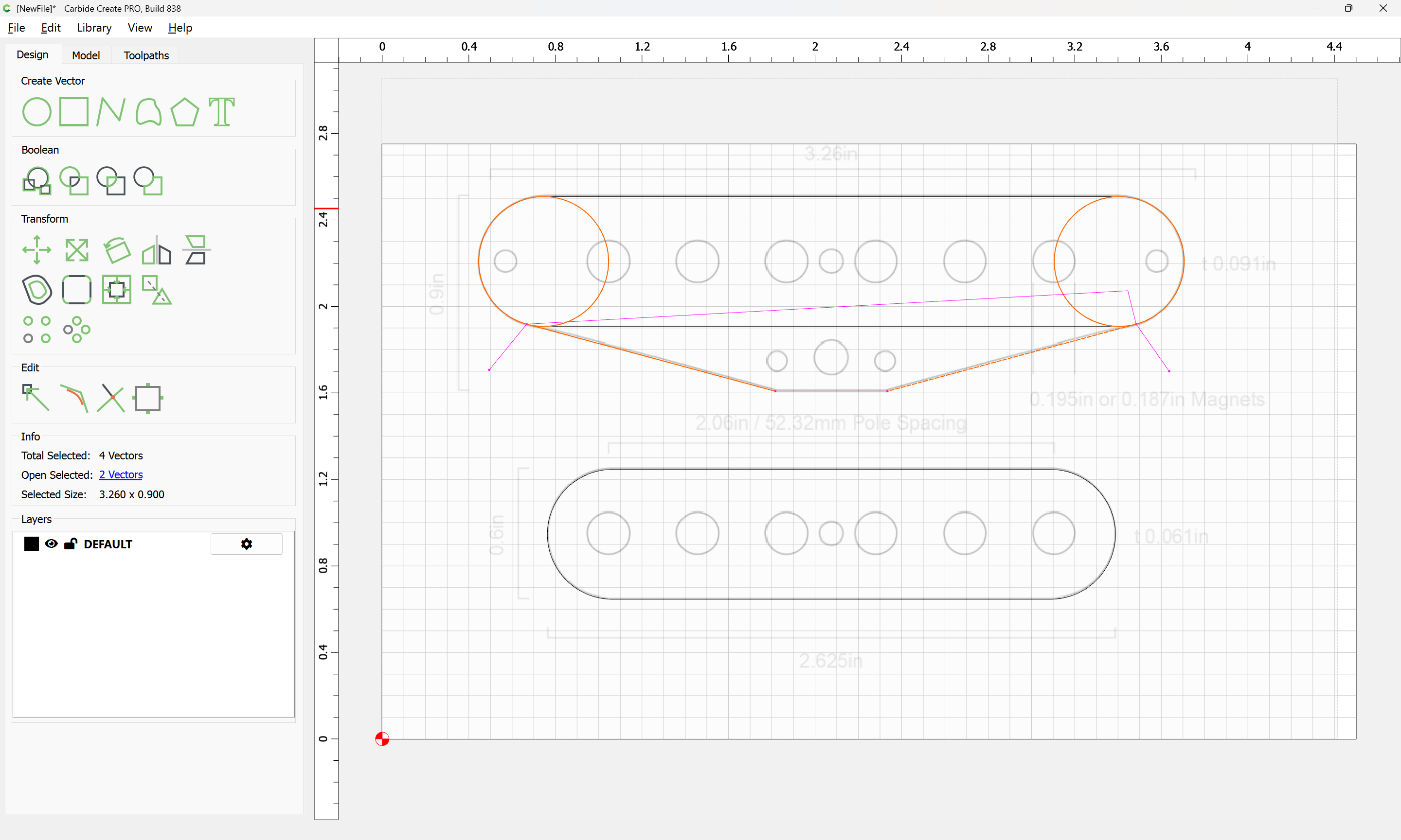

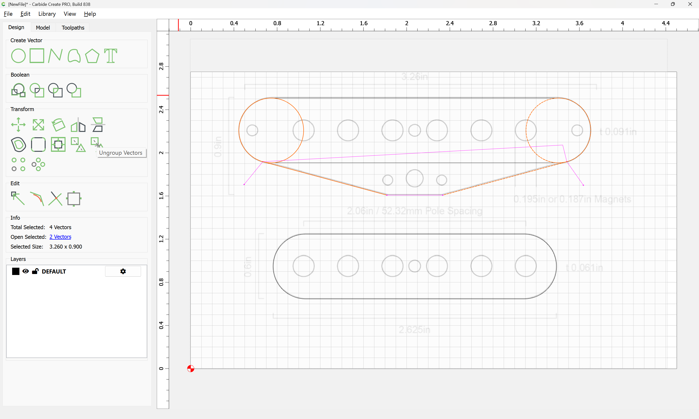

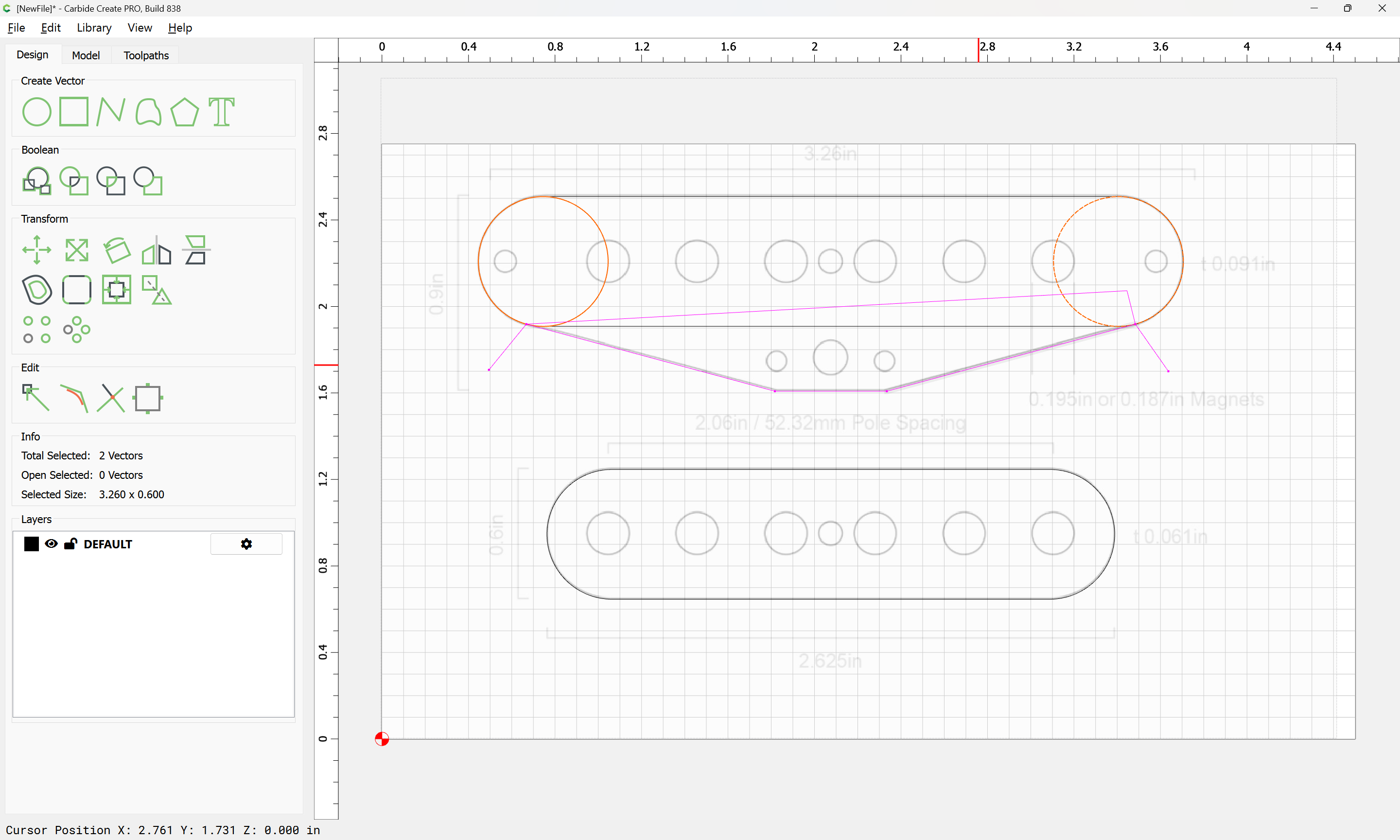

Where one needs a tangent from a rounded feature, draw a circle:

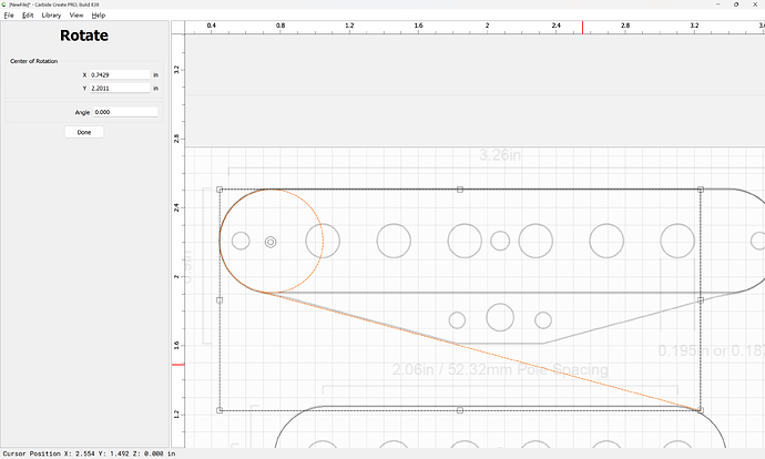

attach a straight line:

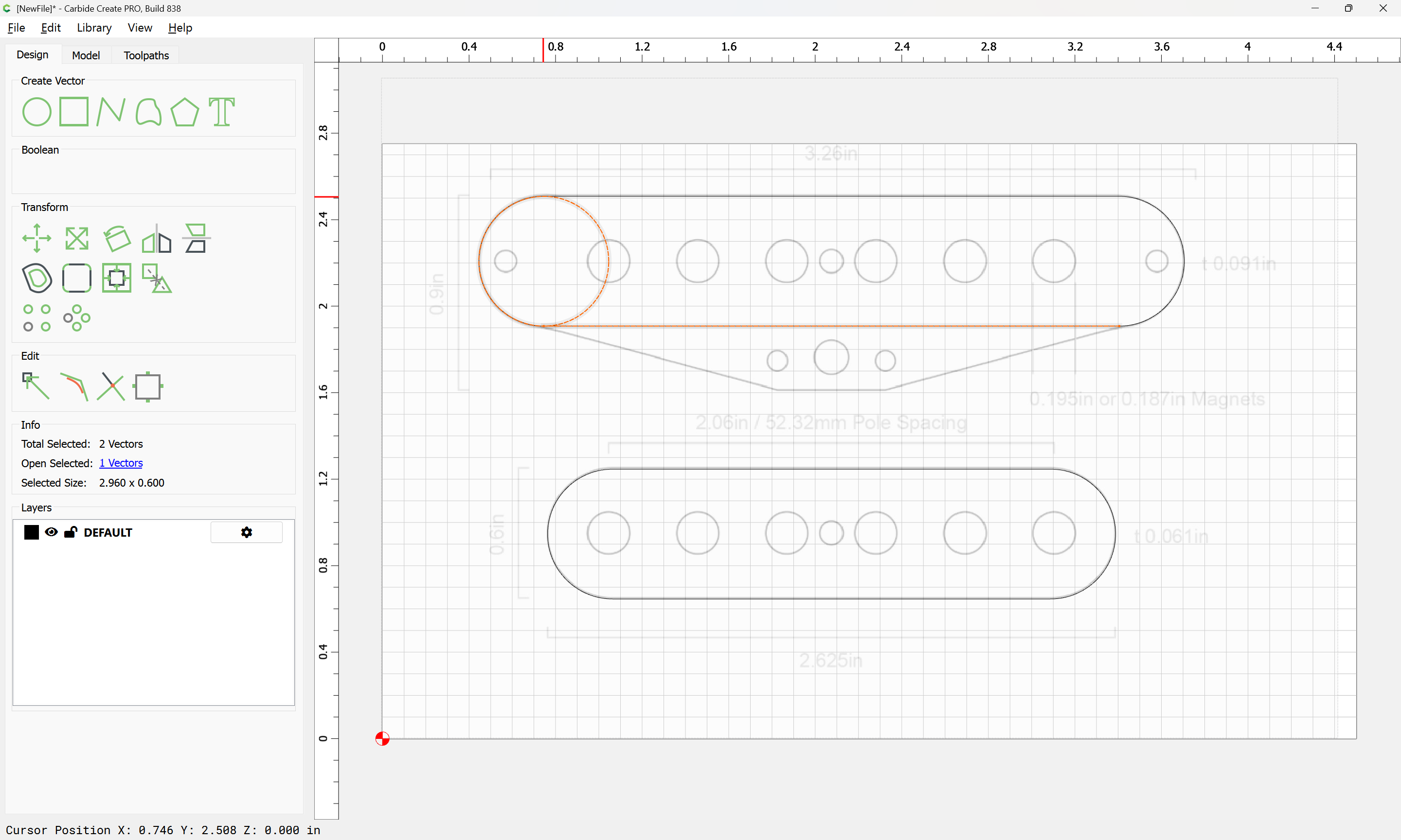

select the twain and group:

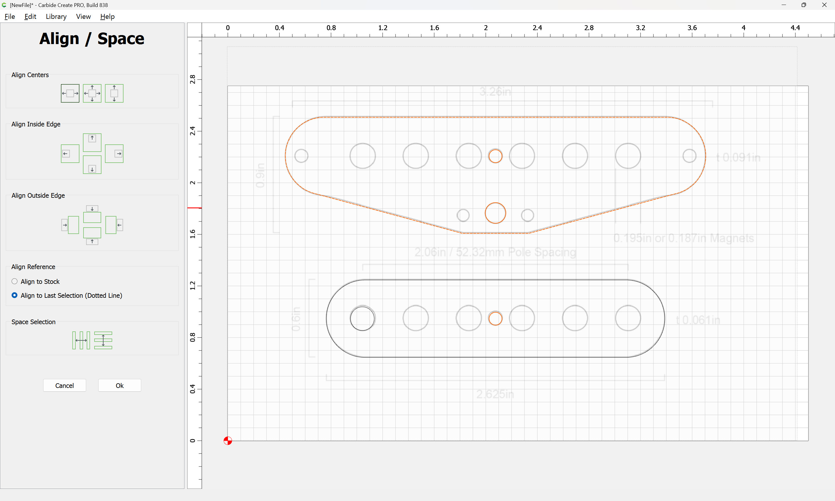

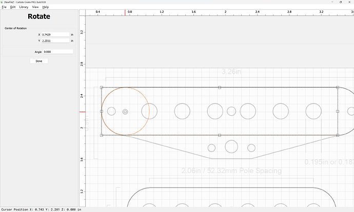

Drag into alignment:

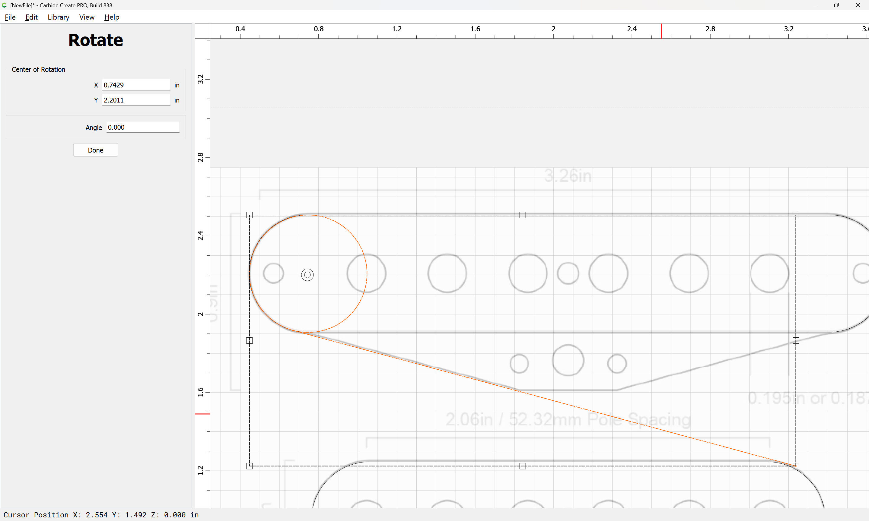

and rotate:
Done

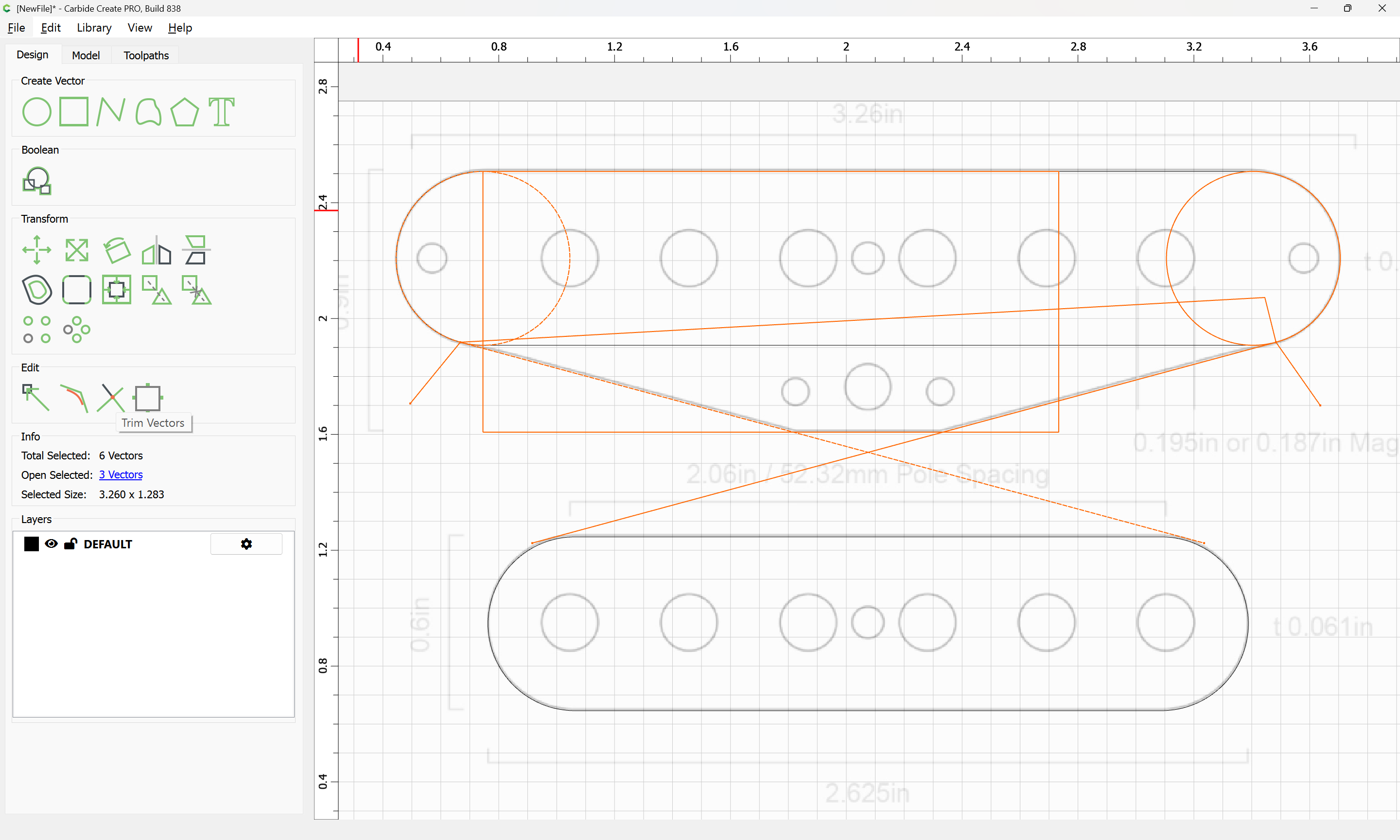

If necessary, re-align:

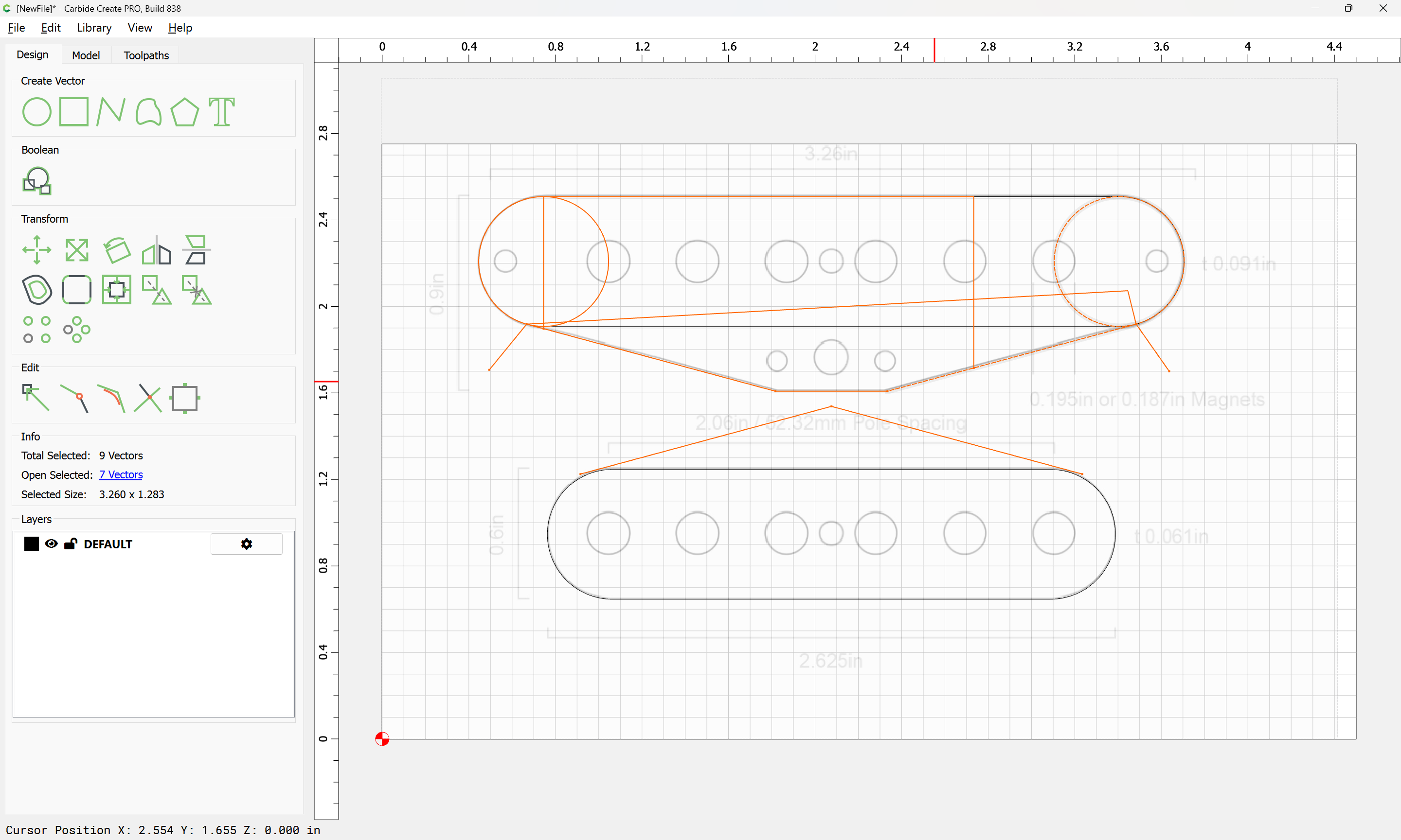

Then duplicate:

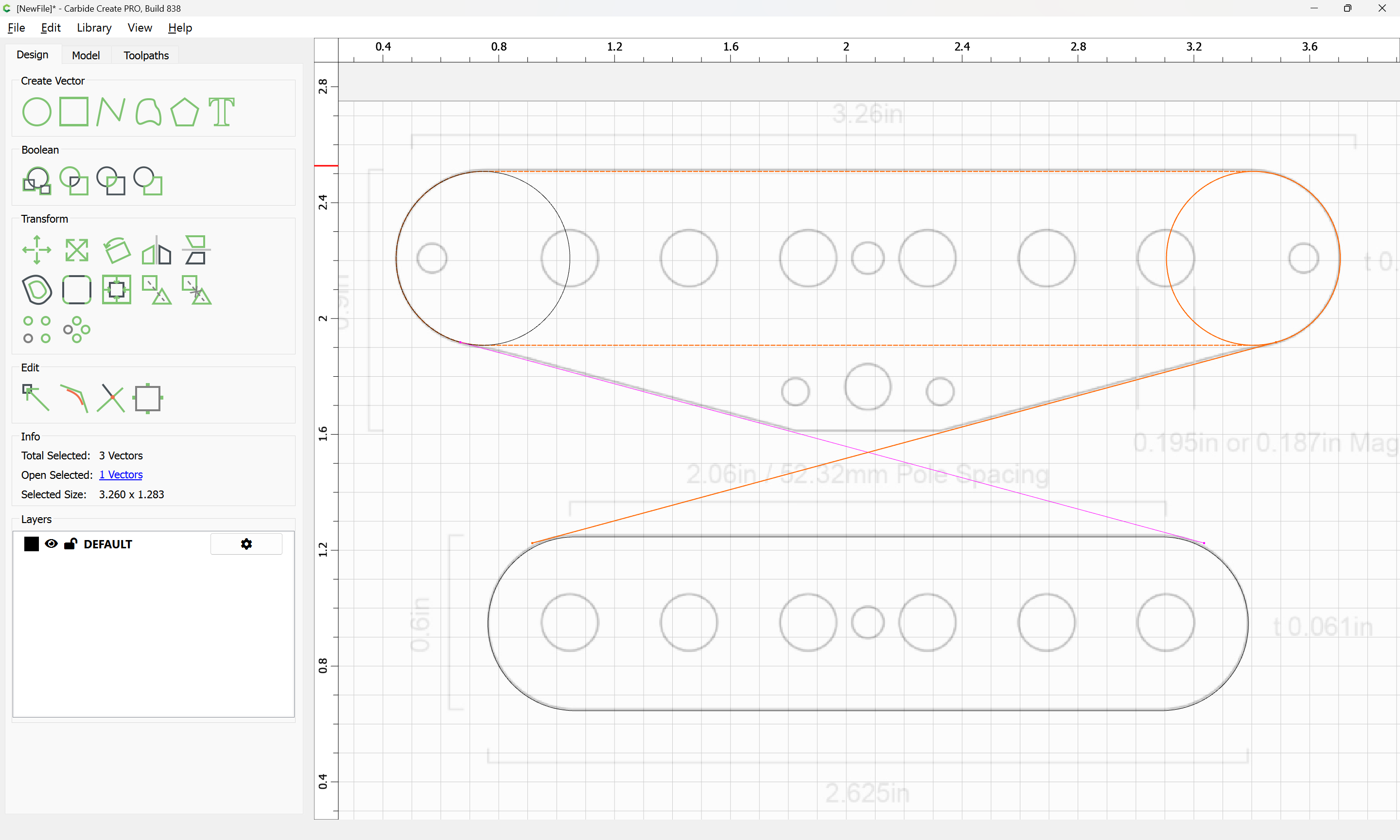

and shift-click on the larger element to add it to the selection:
and Mirror Horizontal:

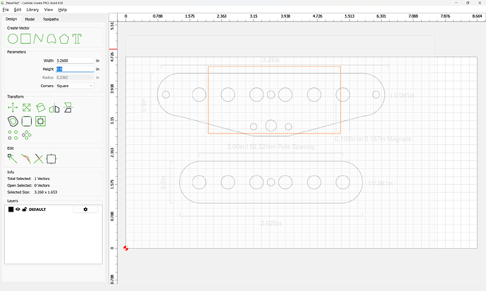

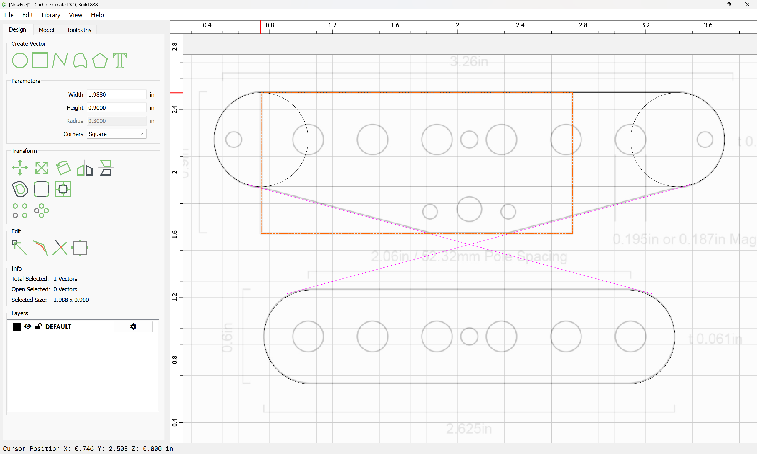

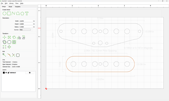

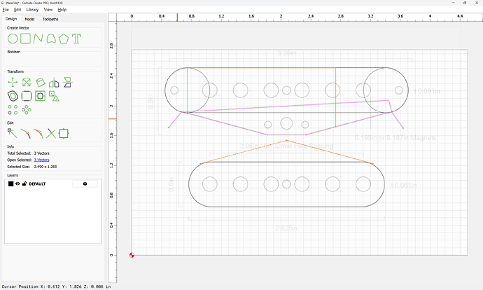

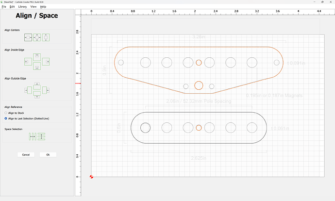

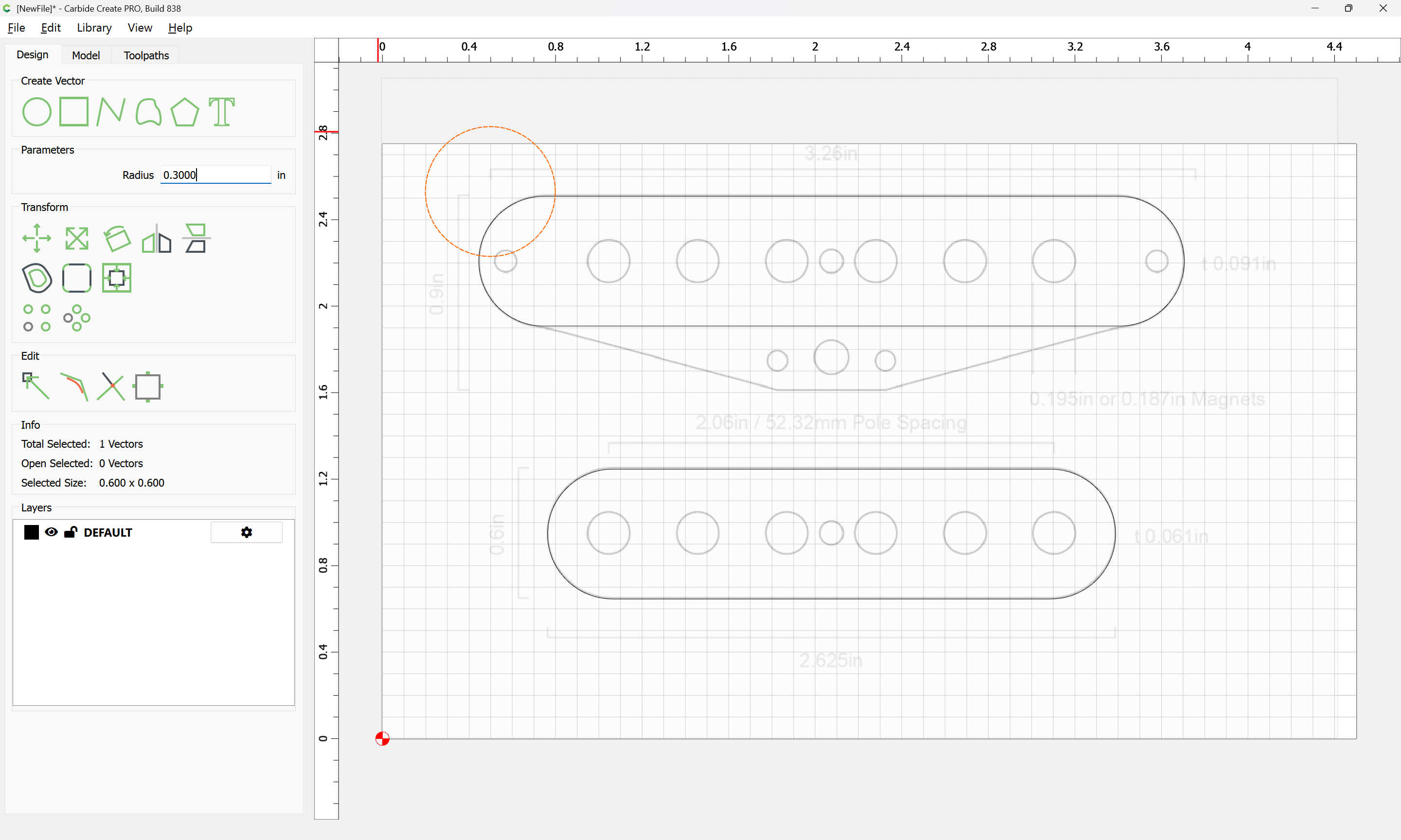

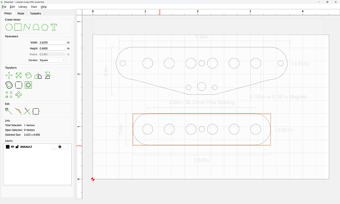

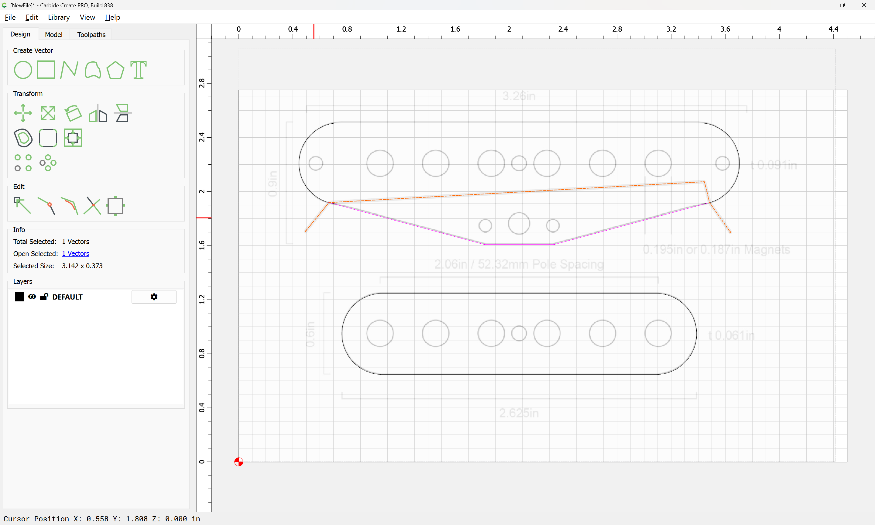

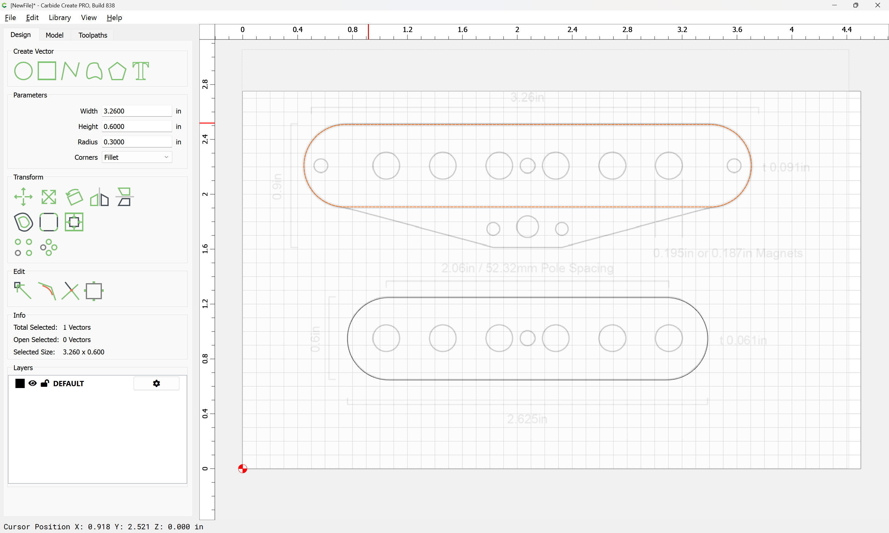

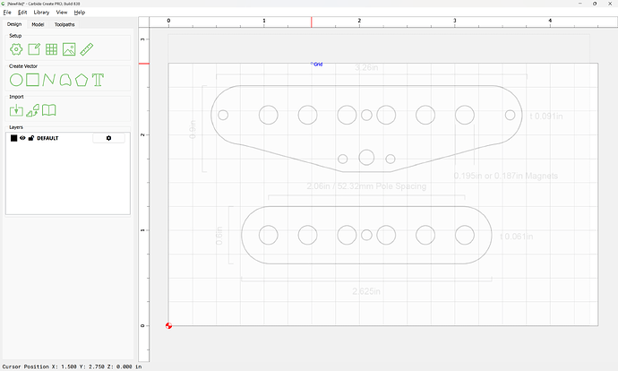

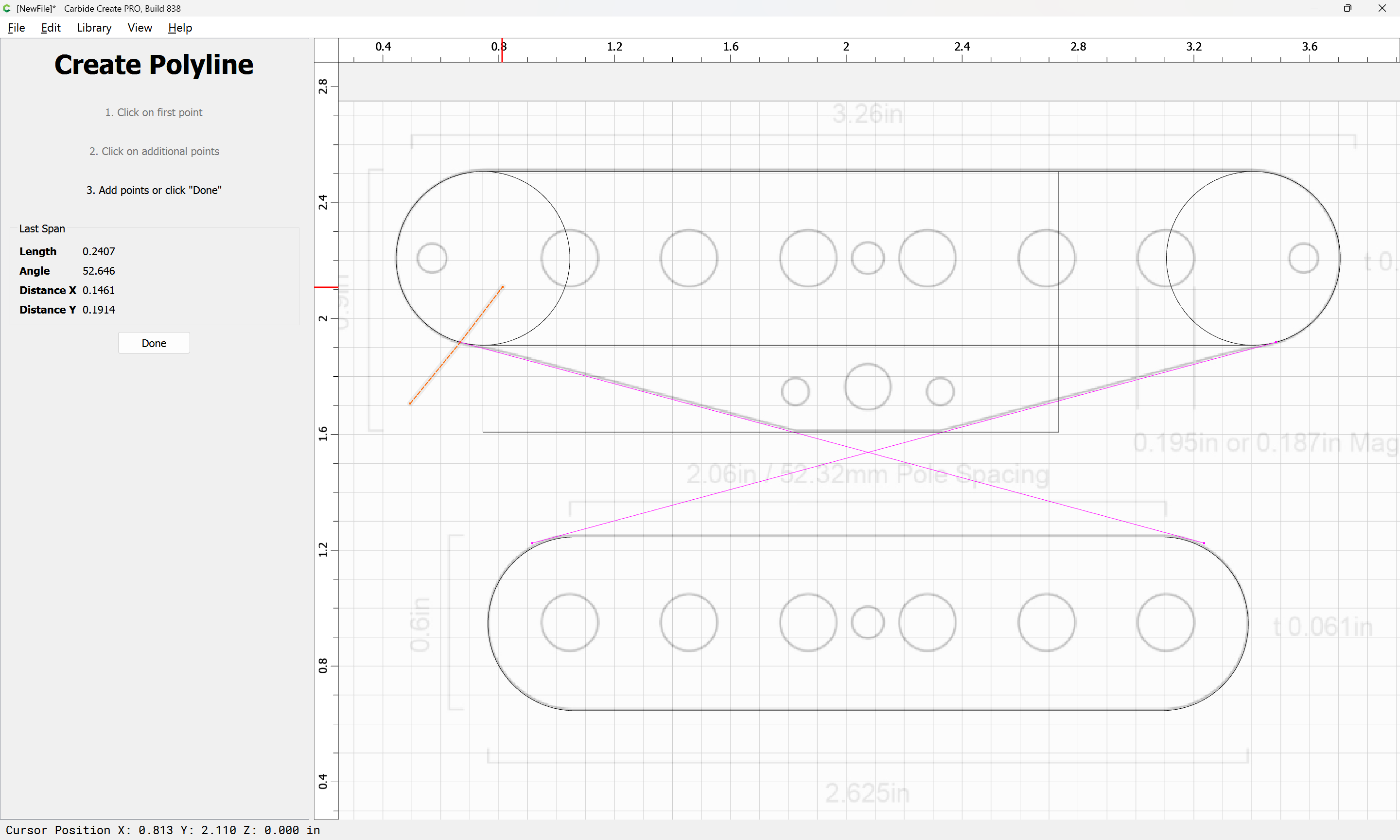

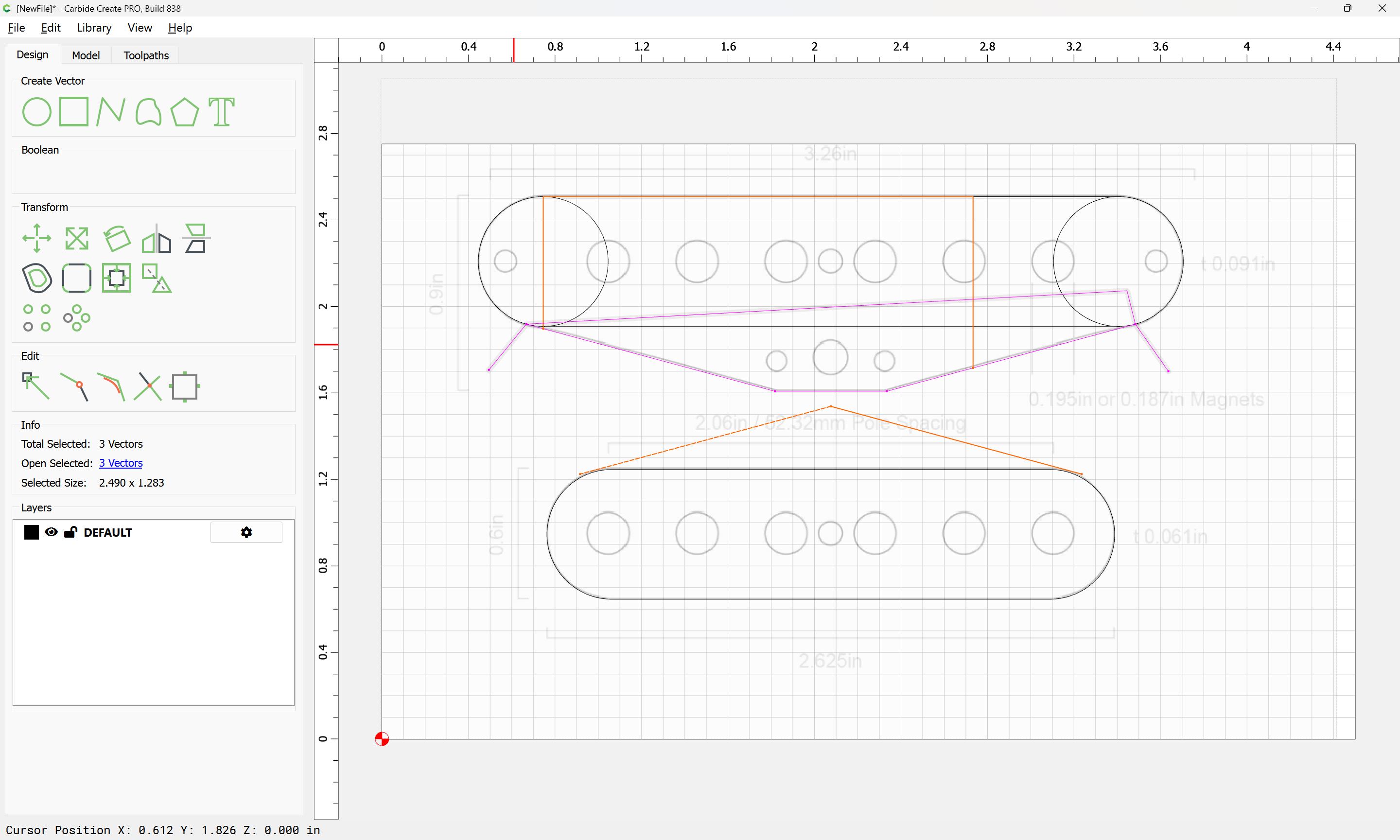

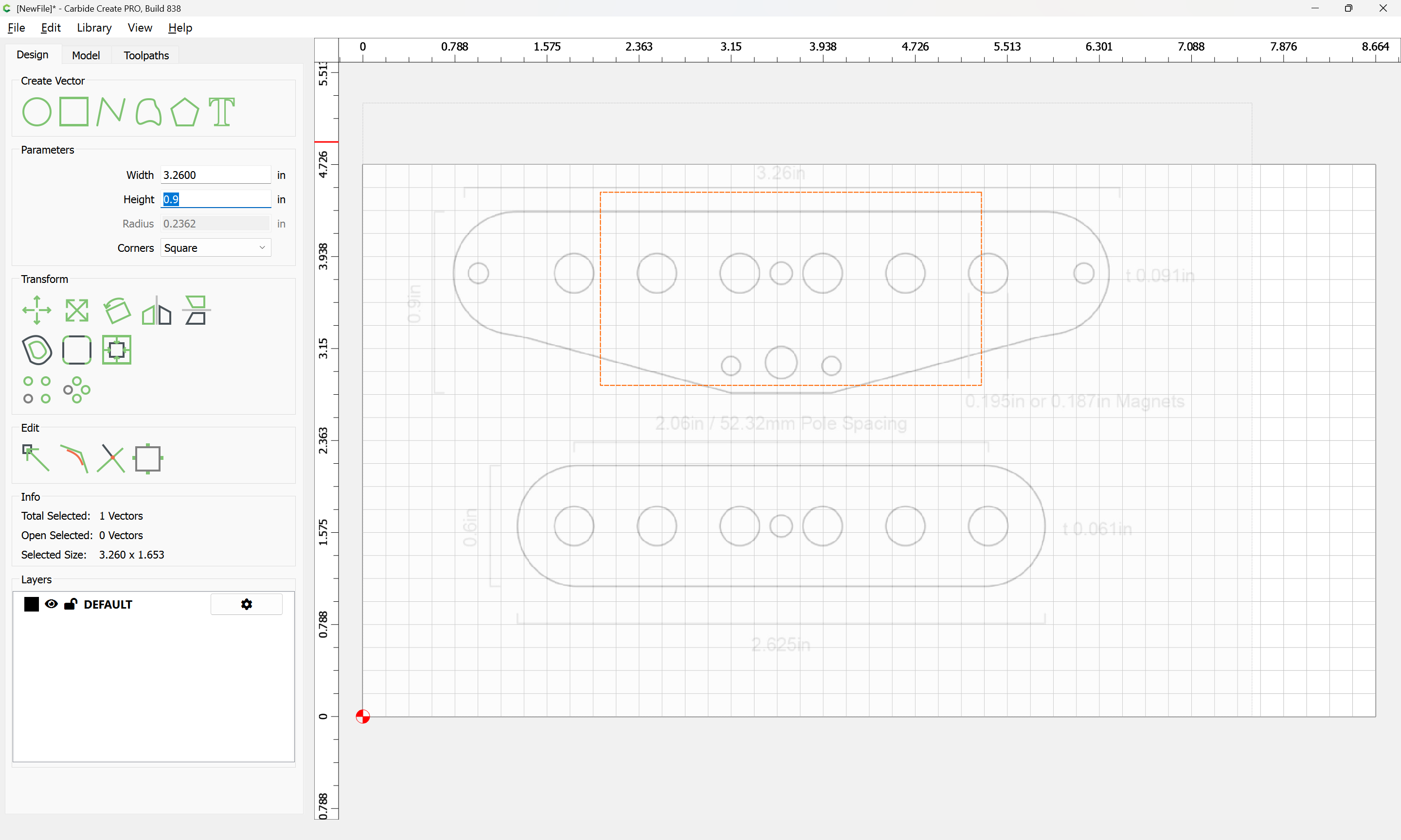

Draw a rectangle of the desired size:
and align it:

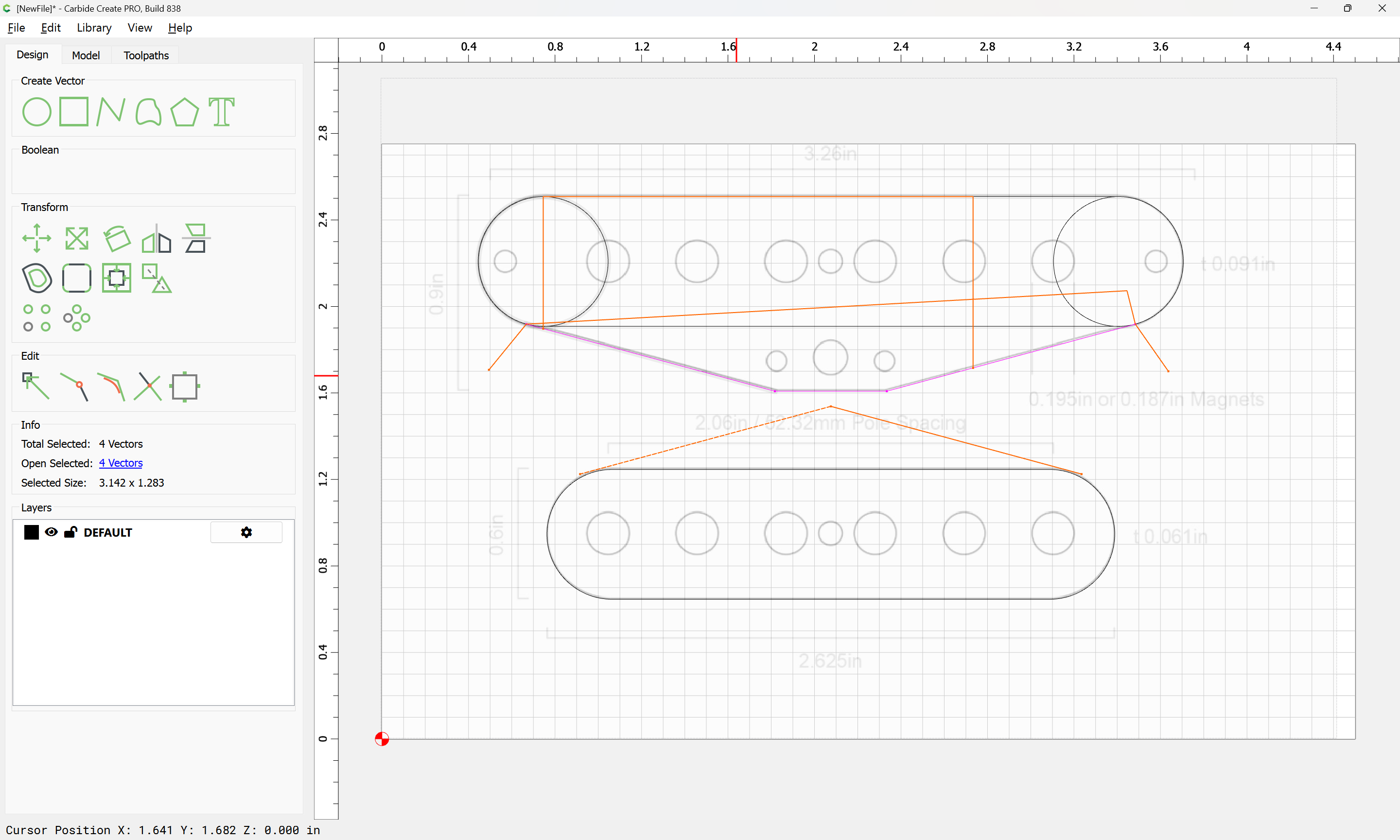

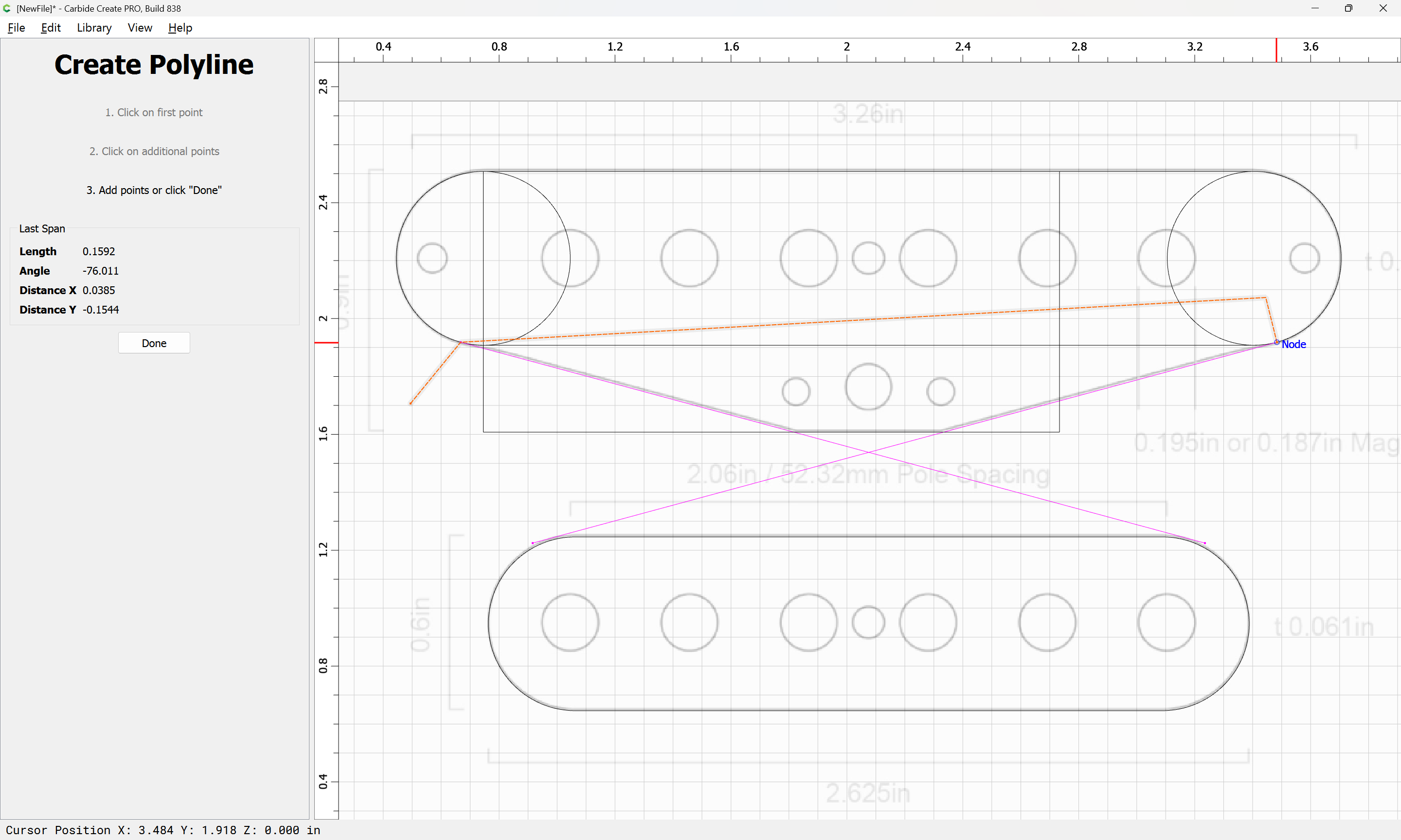

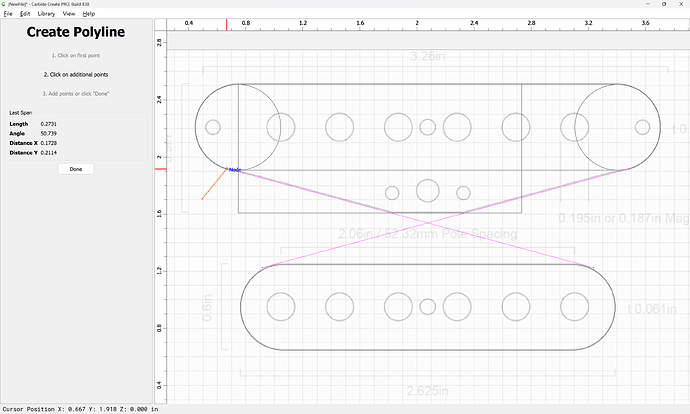

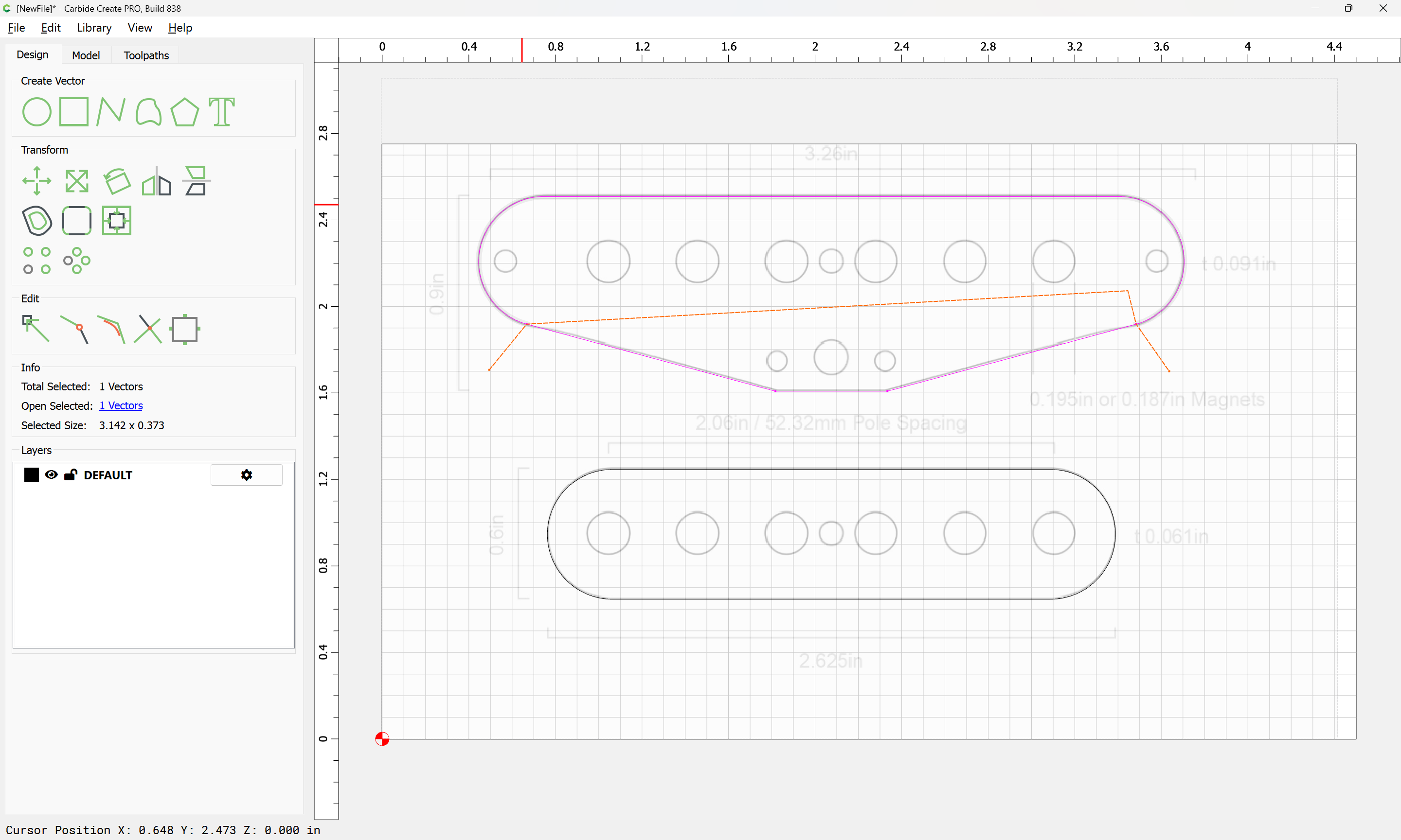

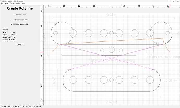

Then draw in geometry to define the tangents:
Done

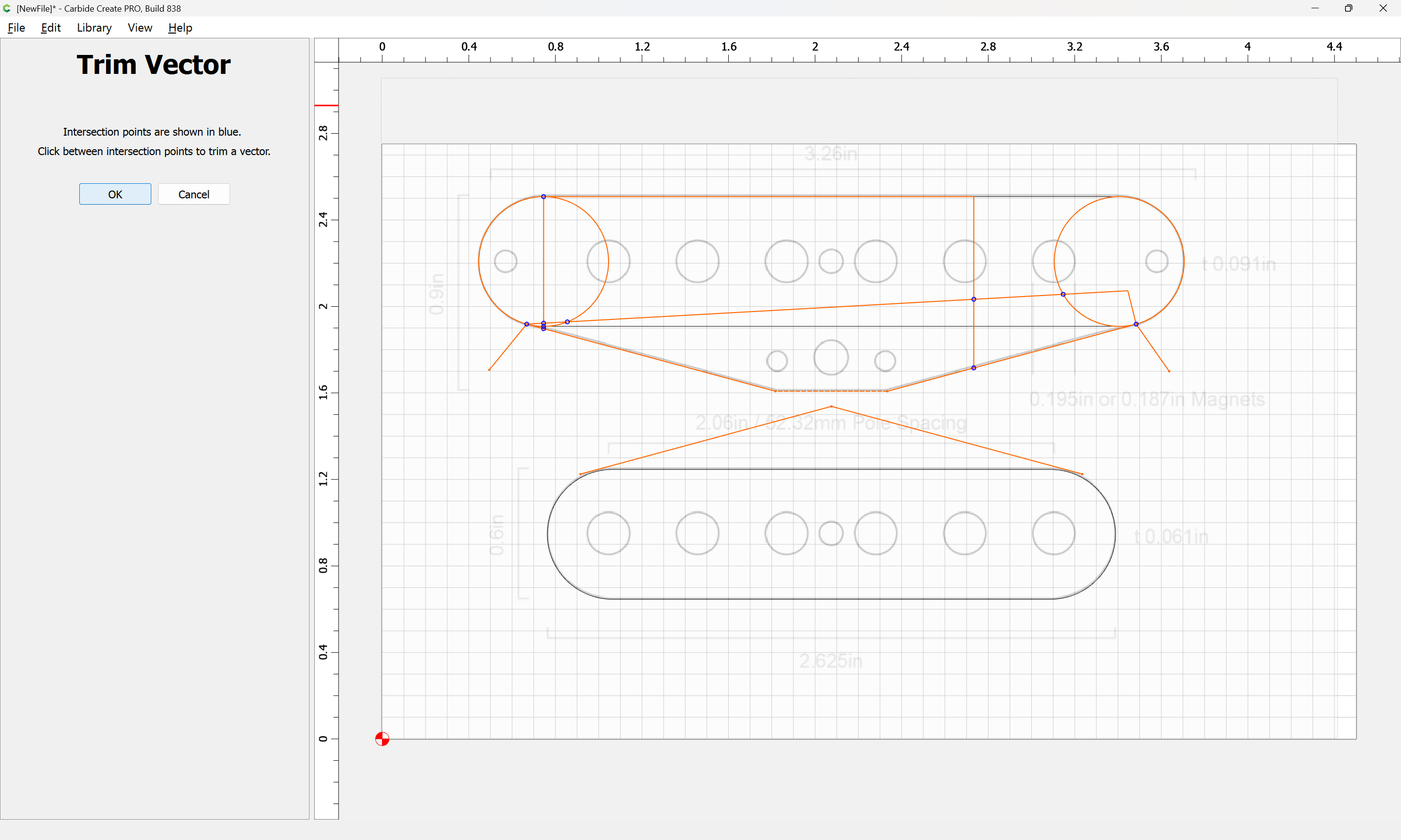

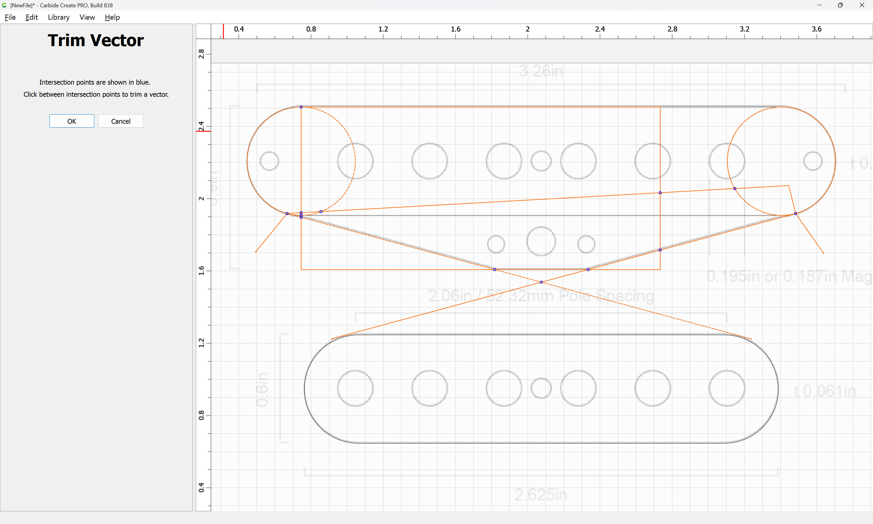

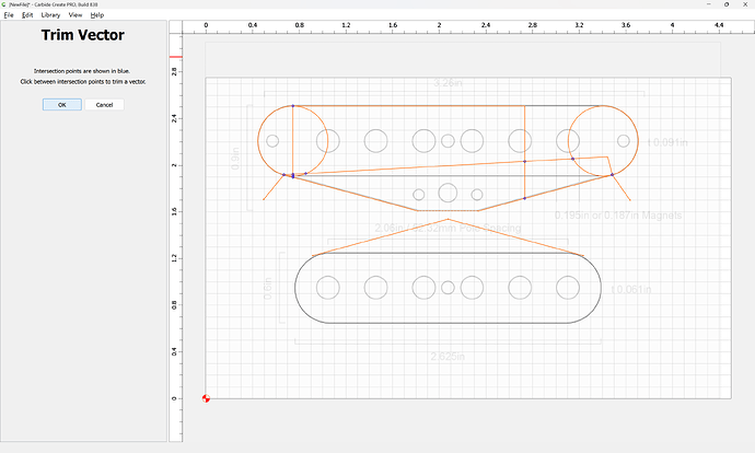

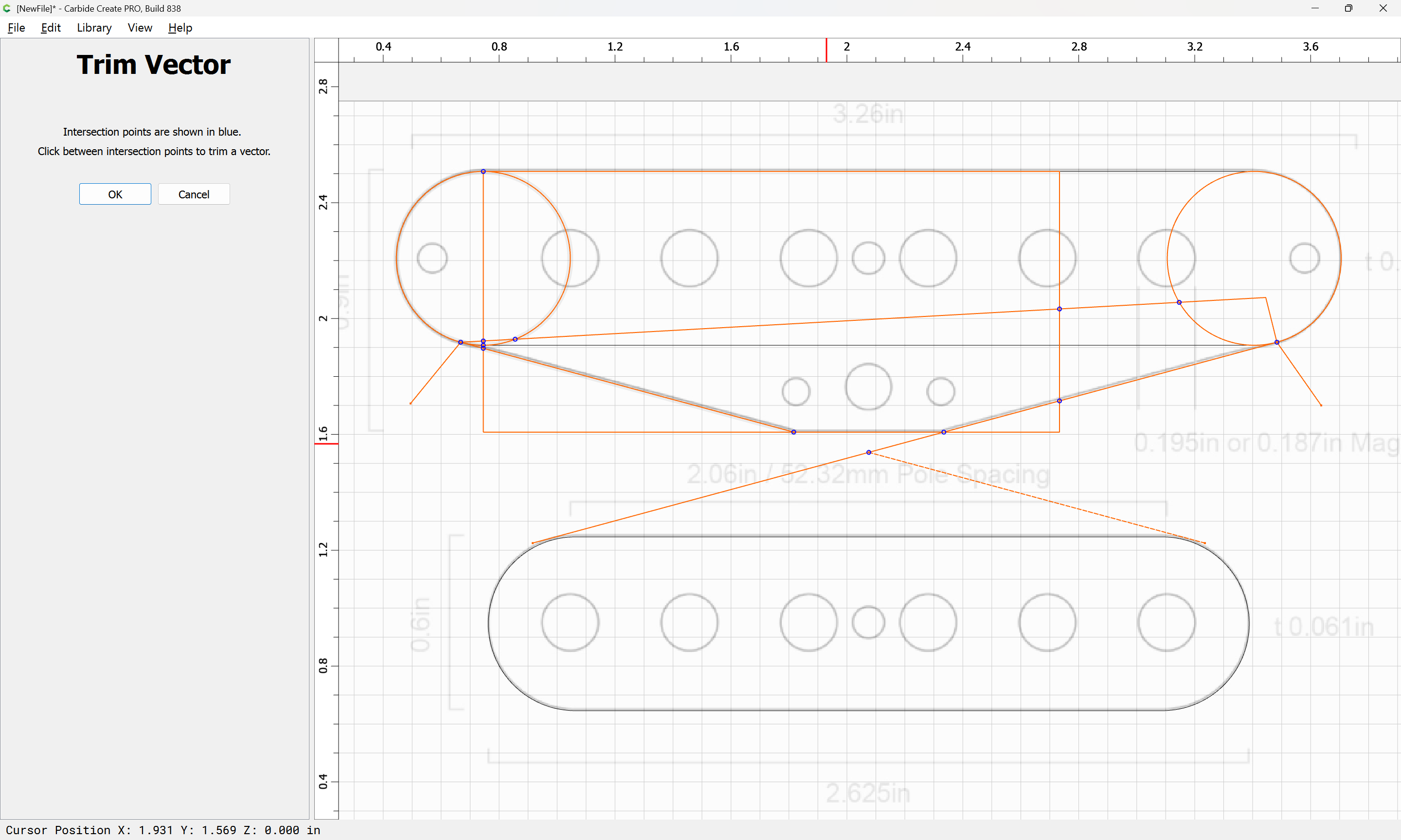

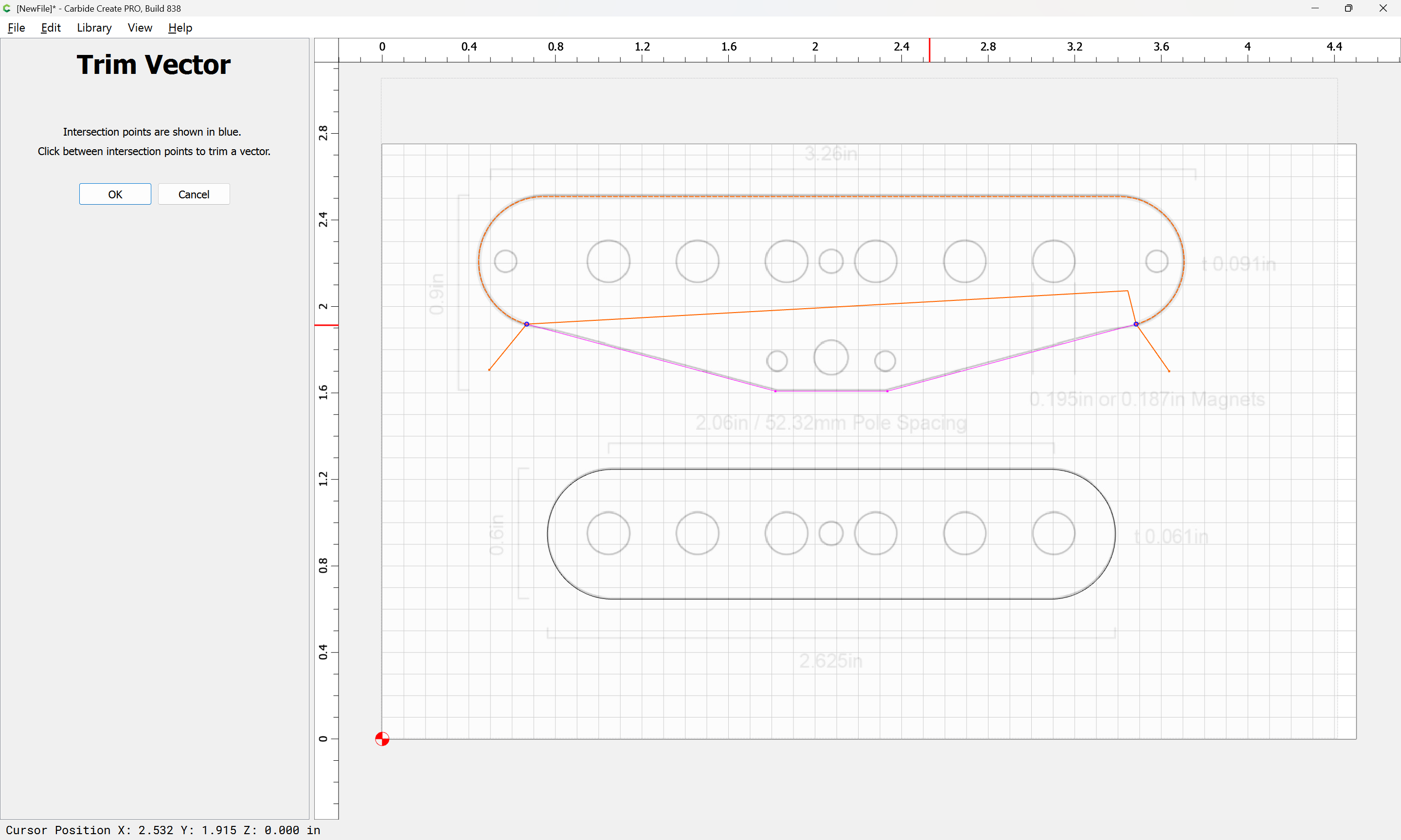

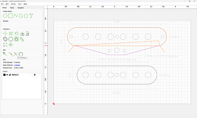

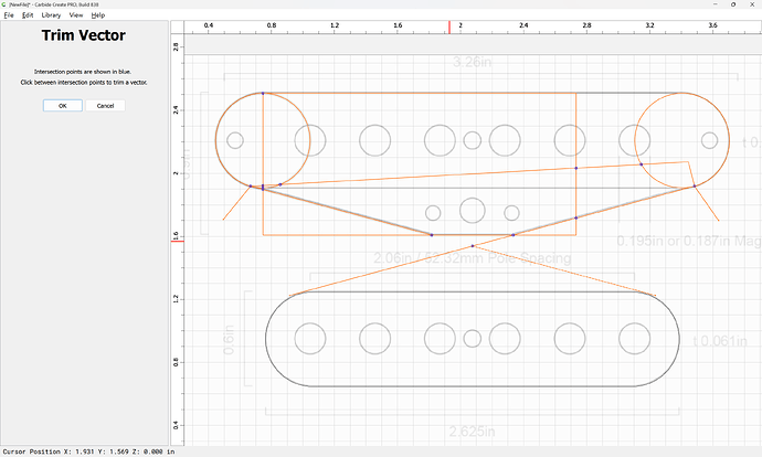

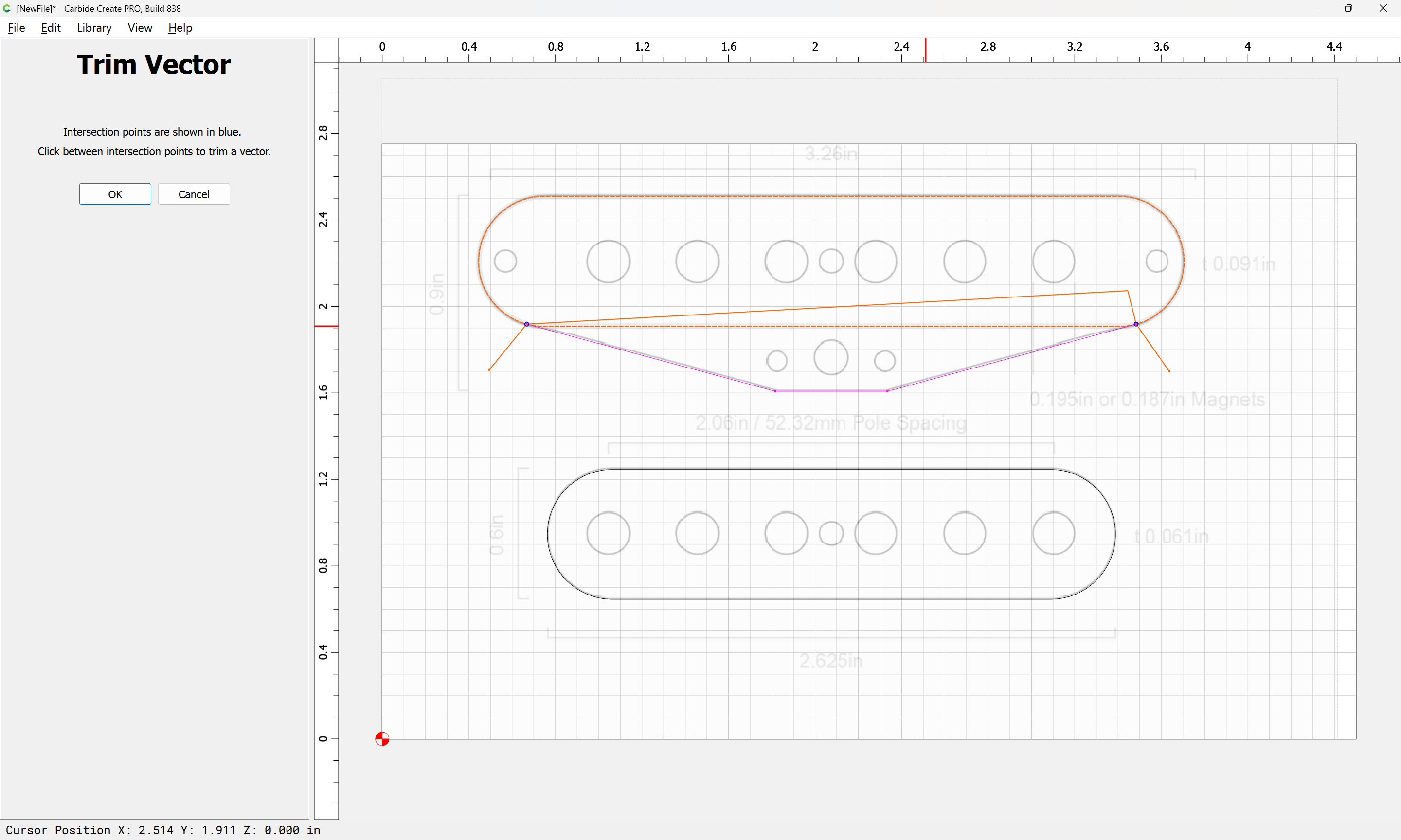

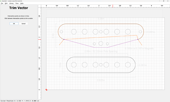

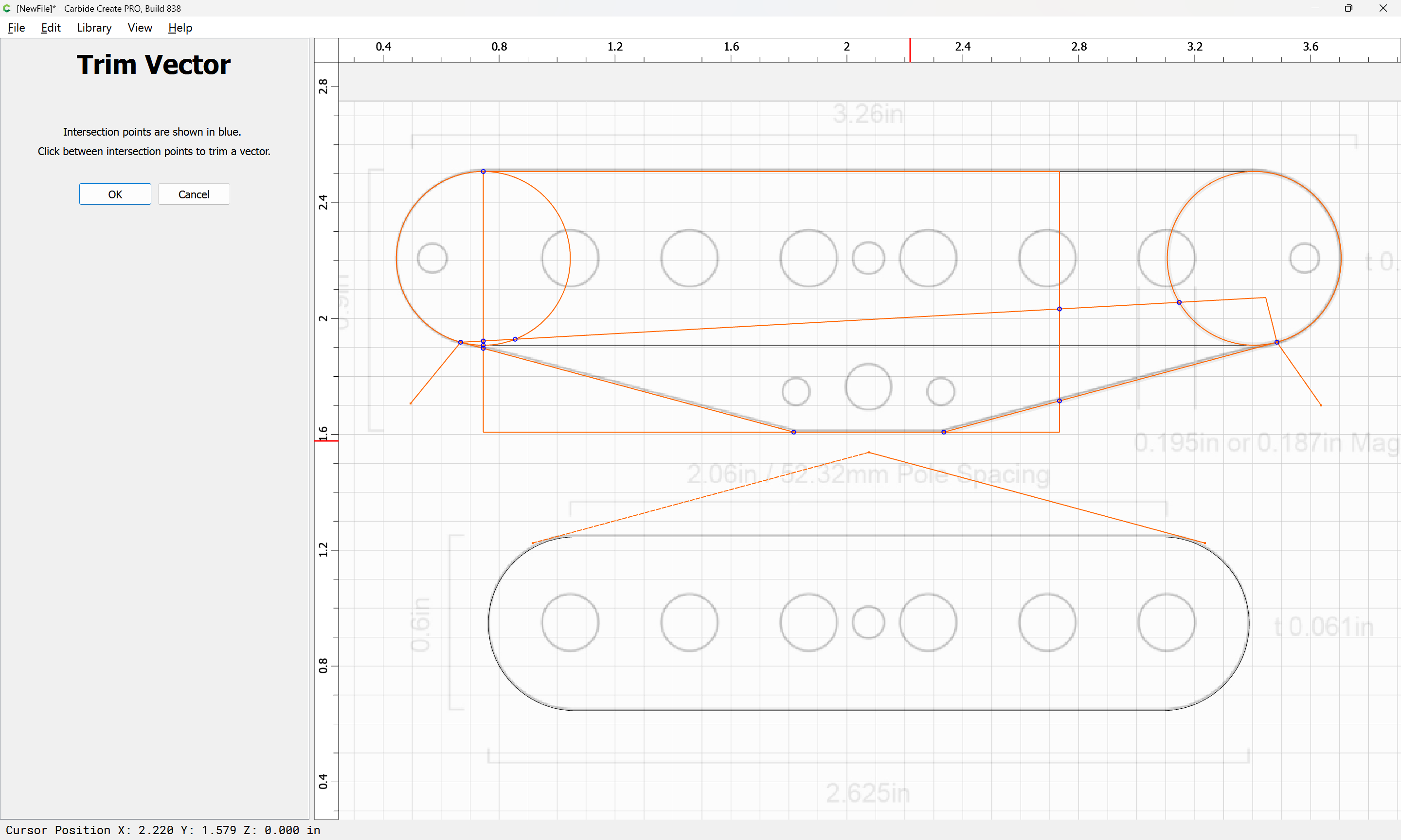

Select all the elements which will make up the bottom, or define its intersections:
and use Trim Vectors to define what is wanted:
OK

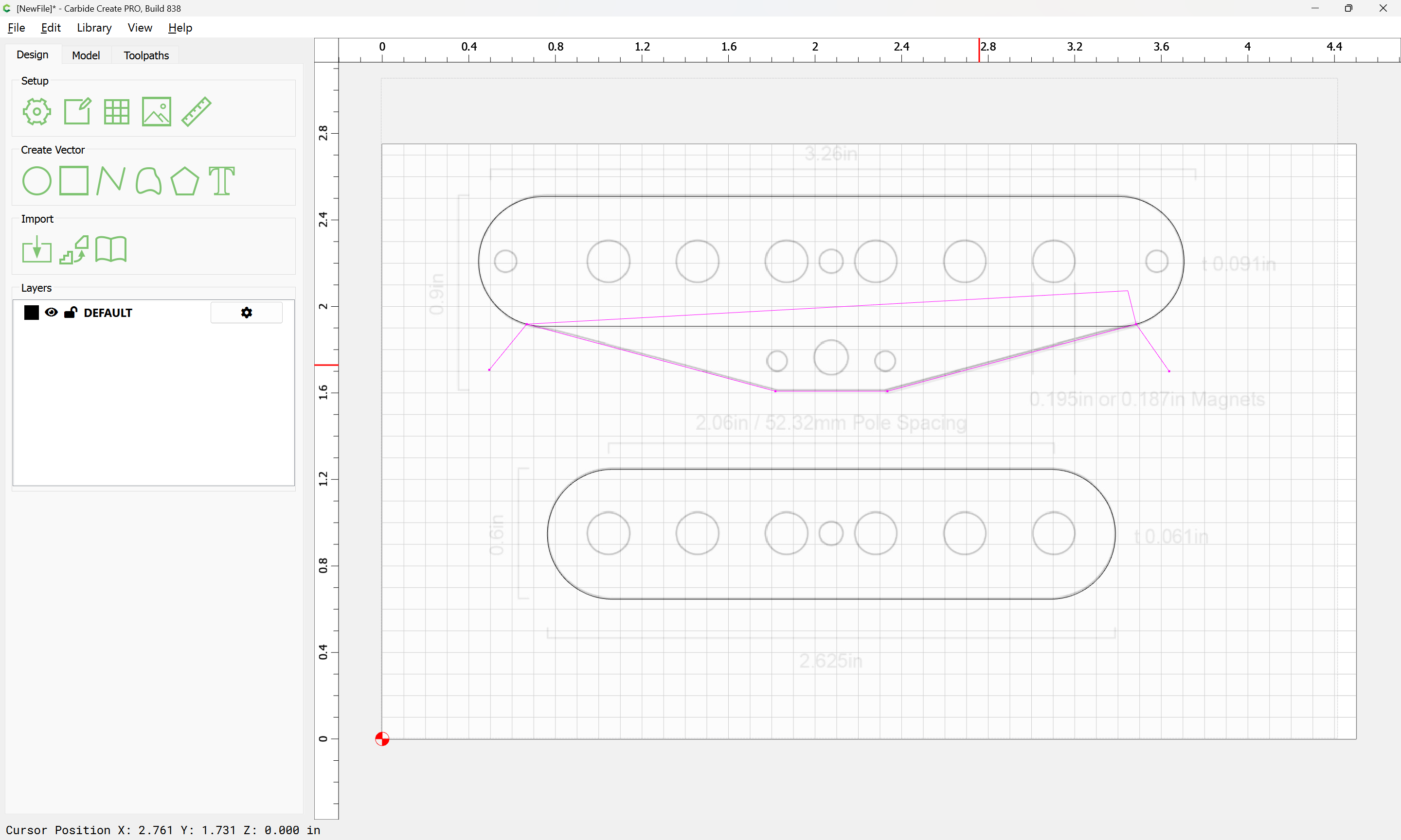

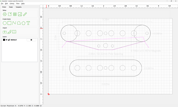

Deselect what one wishes to keep:
and what will need to be used again:
by shift-clicking, then delete:
If need be select and ungroup:
and repeat:

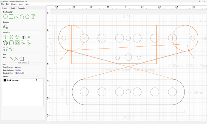

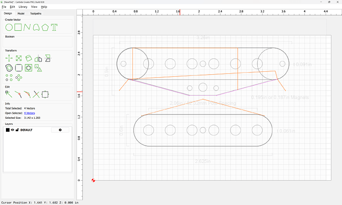

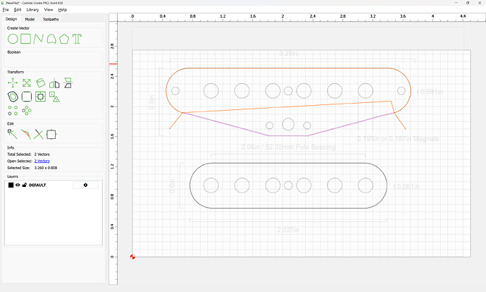

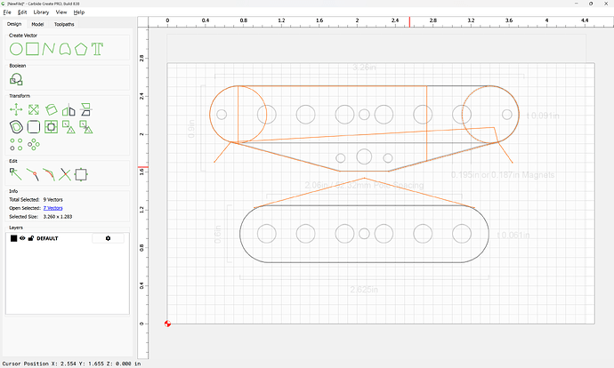

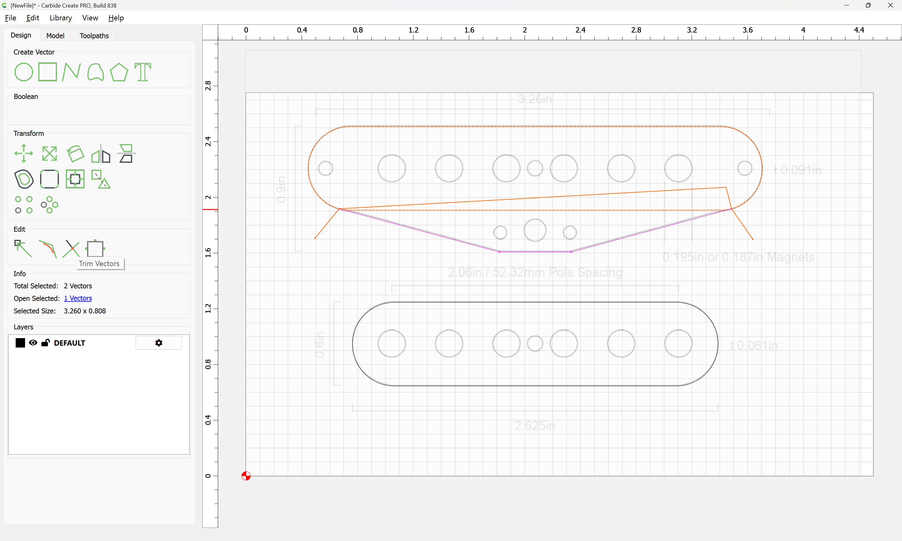

Select the drawn in trimming geometry:
and the original:
and remove the bottom section:
OK

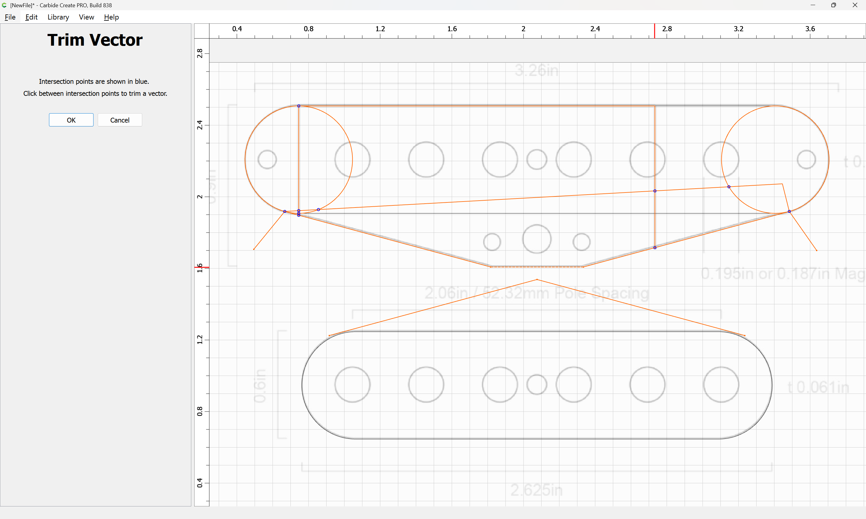

OK
again, shift-click on what is to be kept:
and delete:

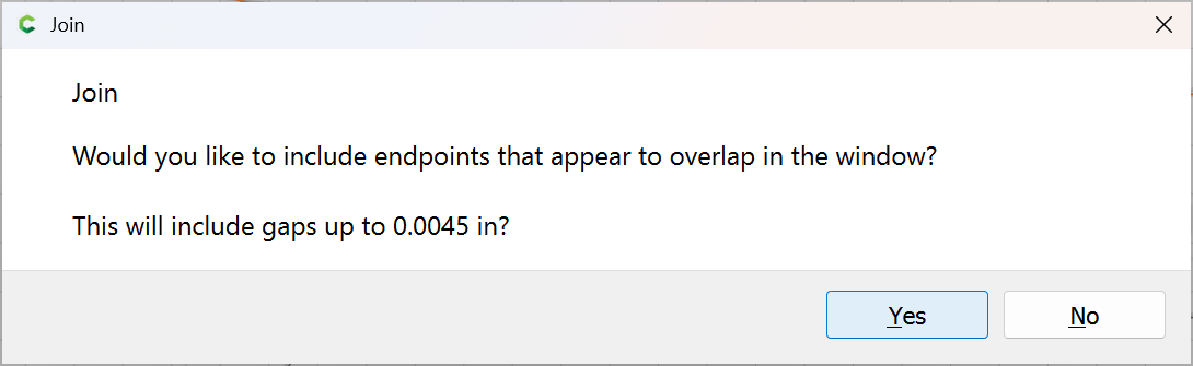

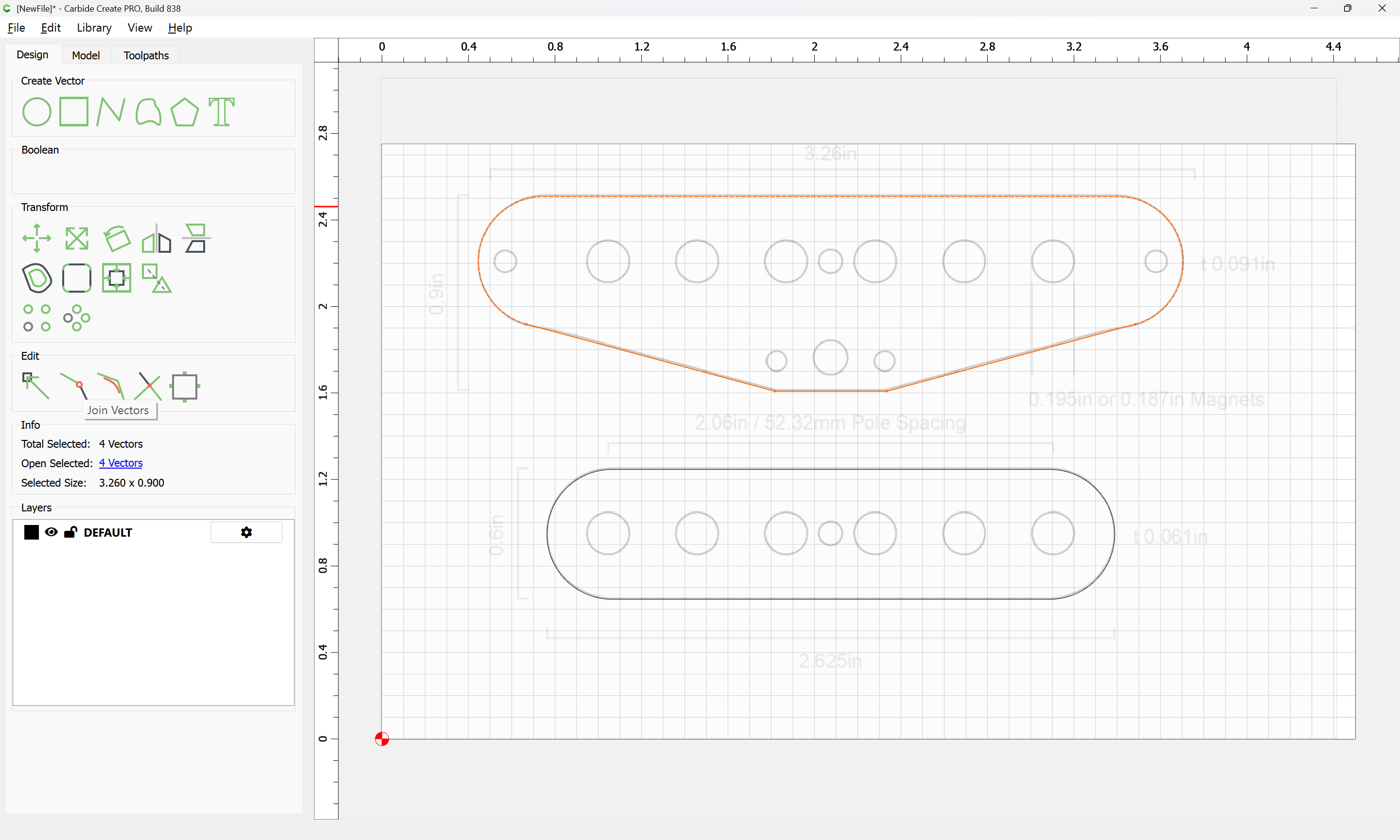

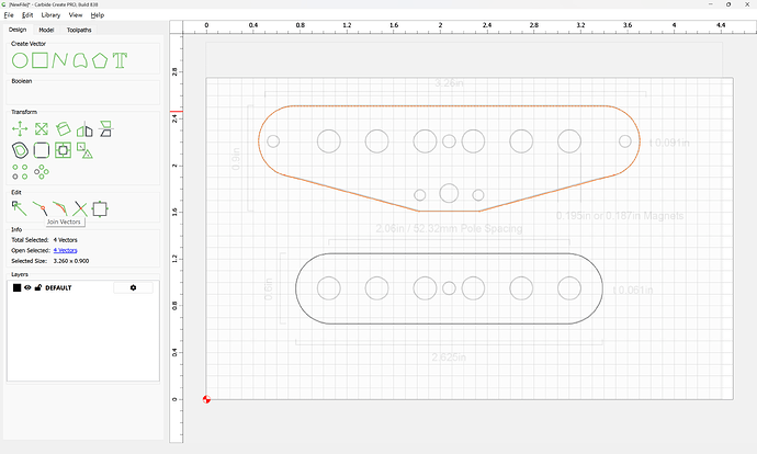

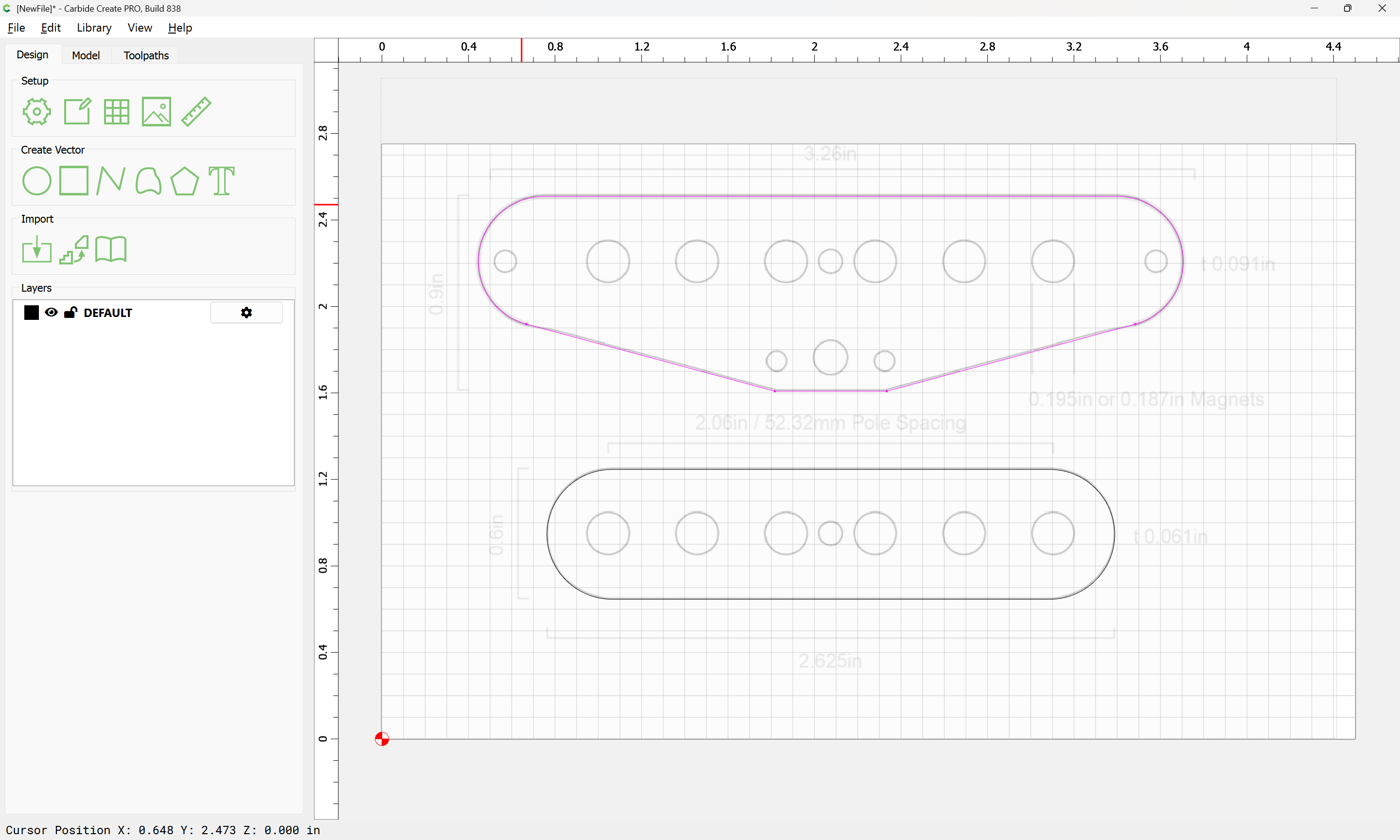

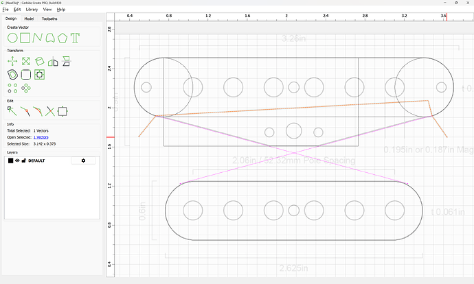

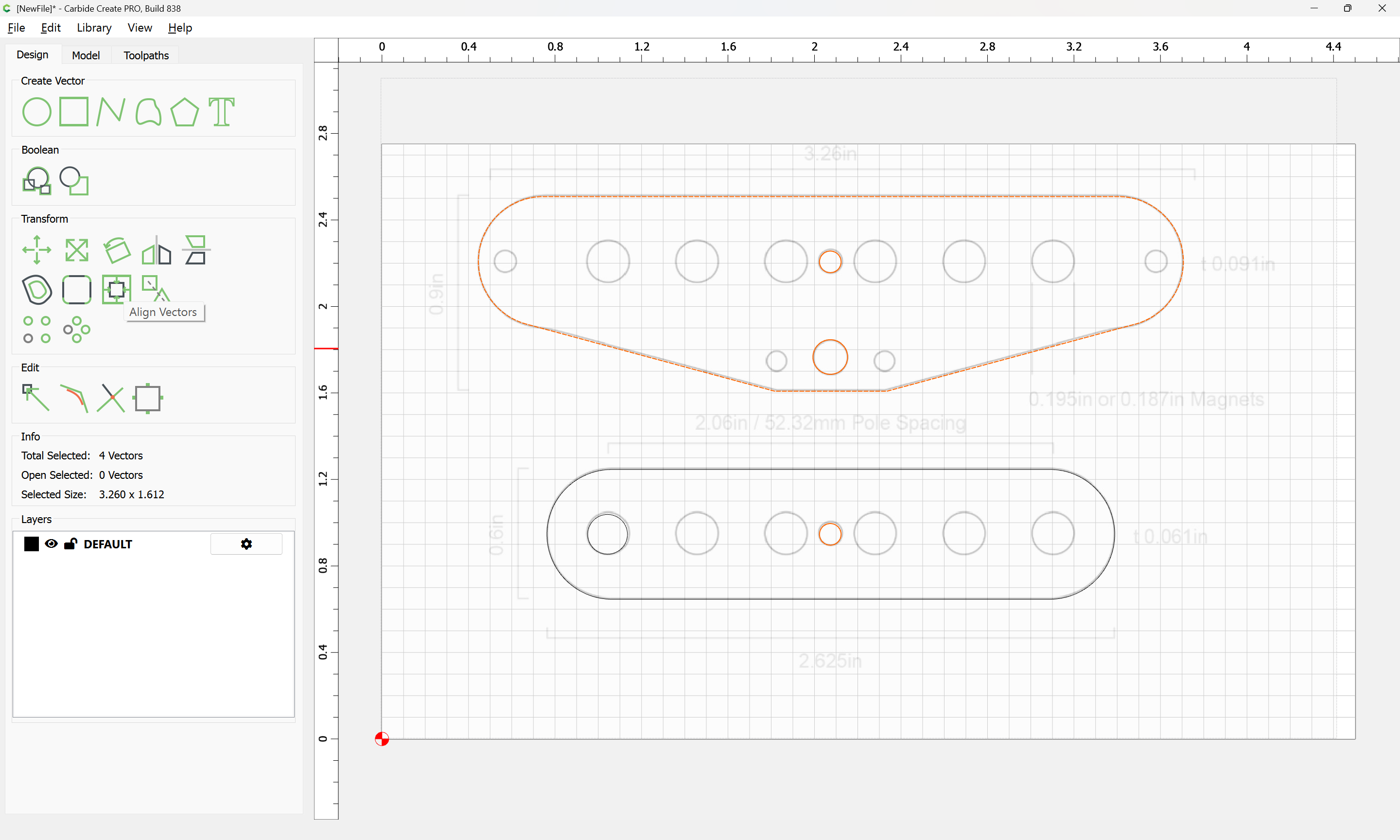

Select all the open elements:
and Join Vectors:
Yes

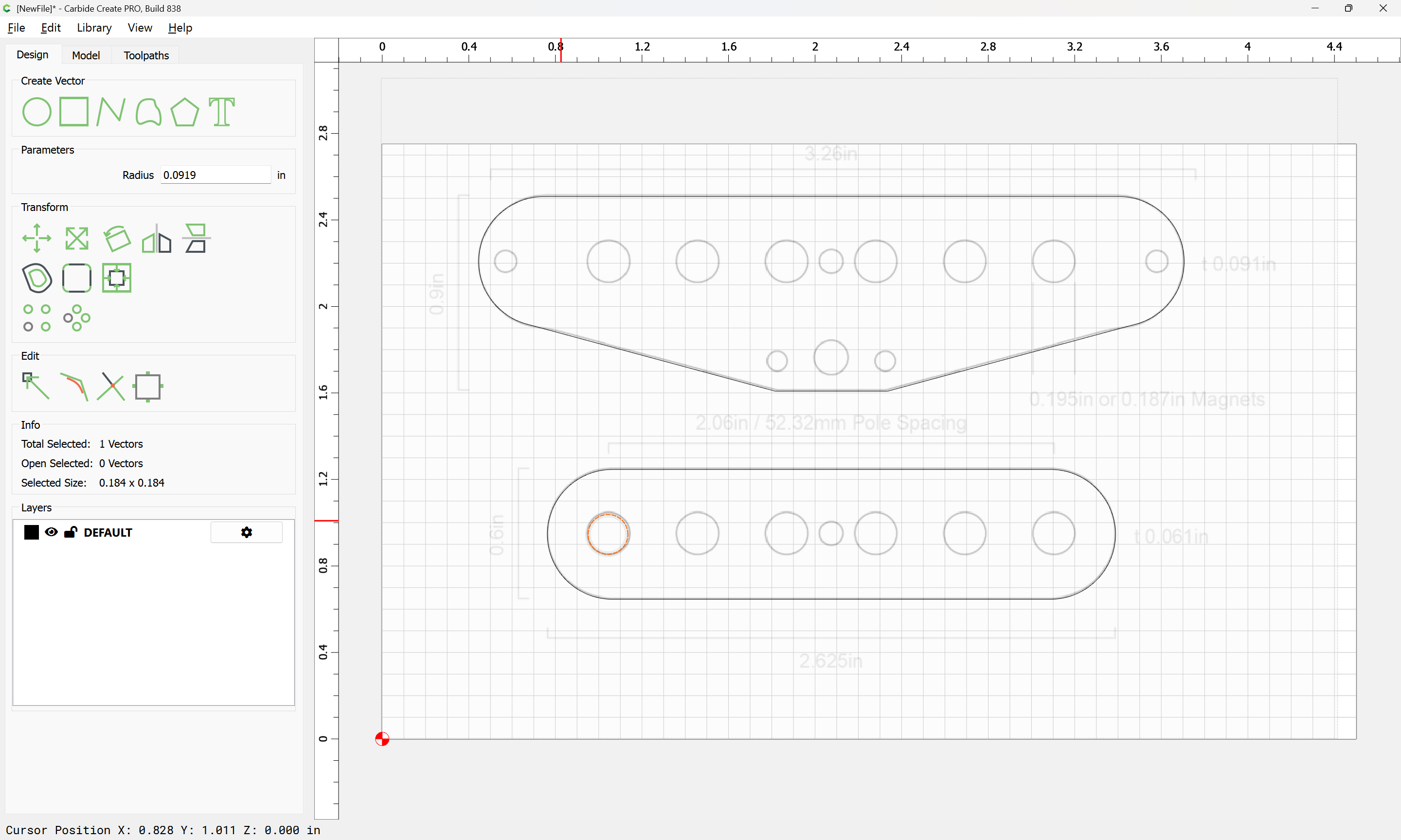

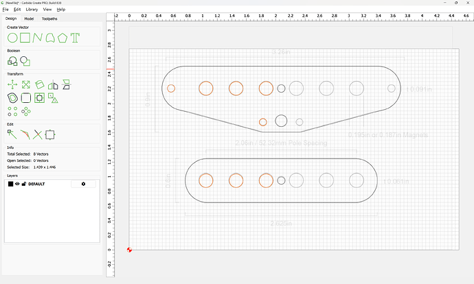

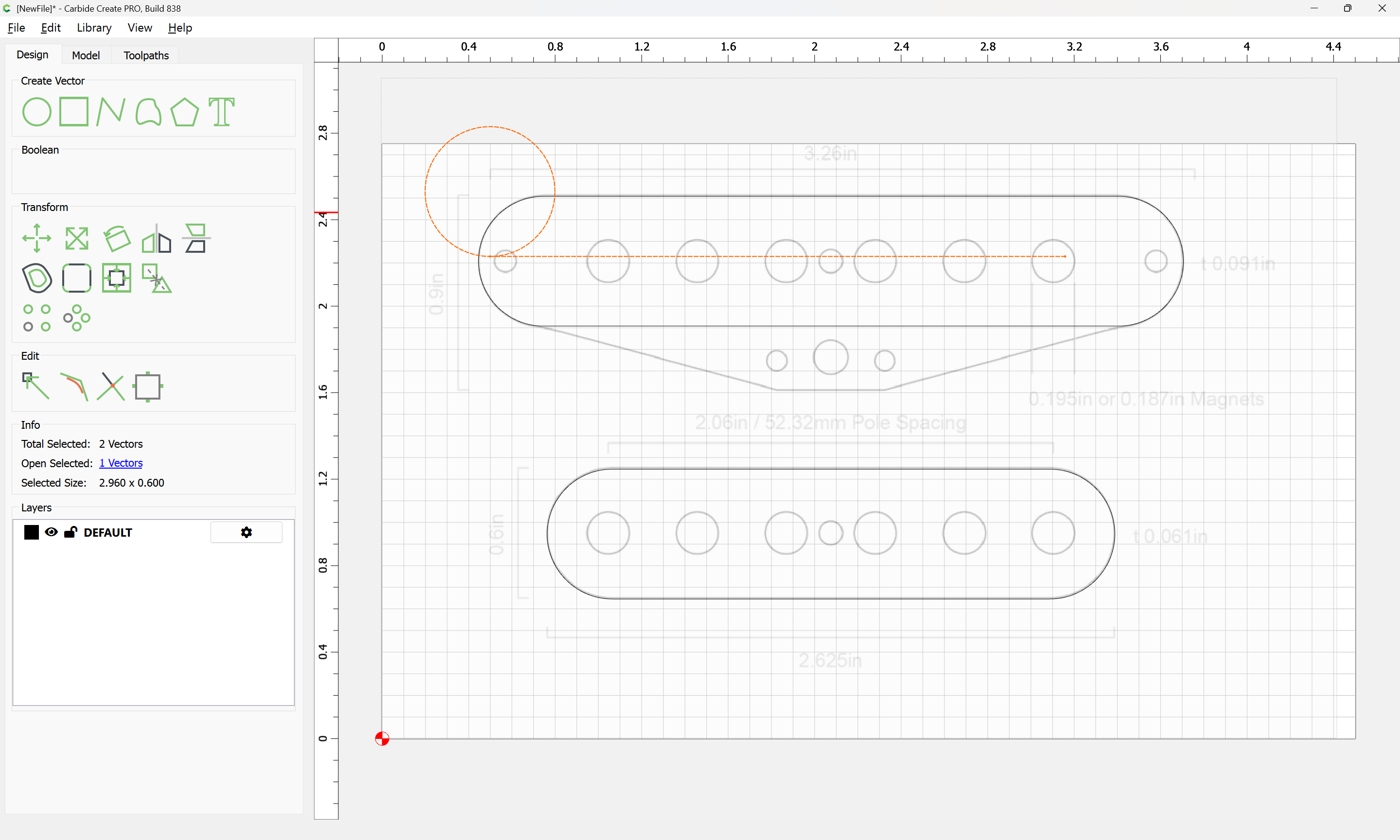

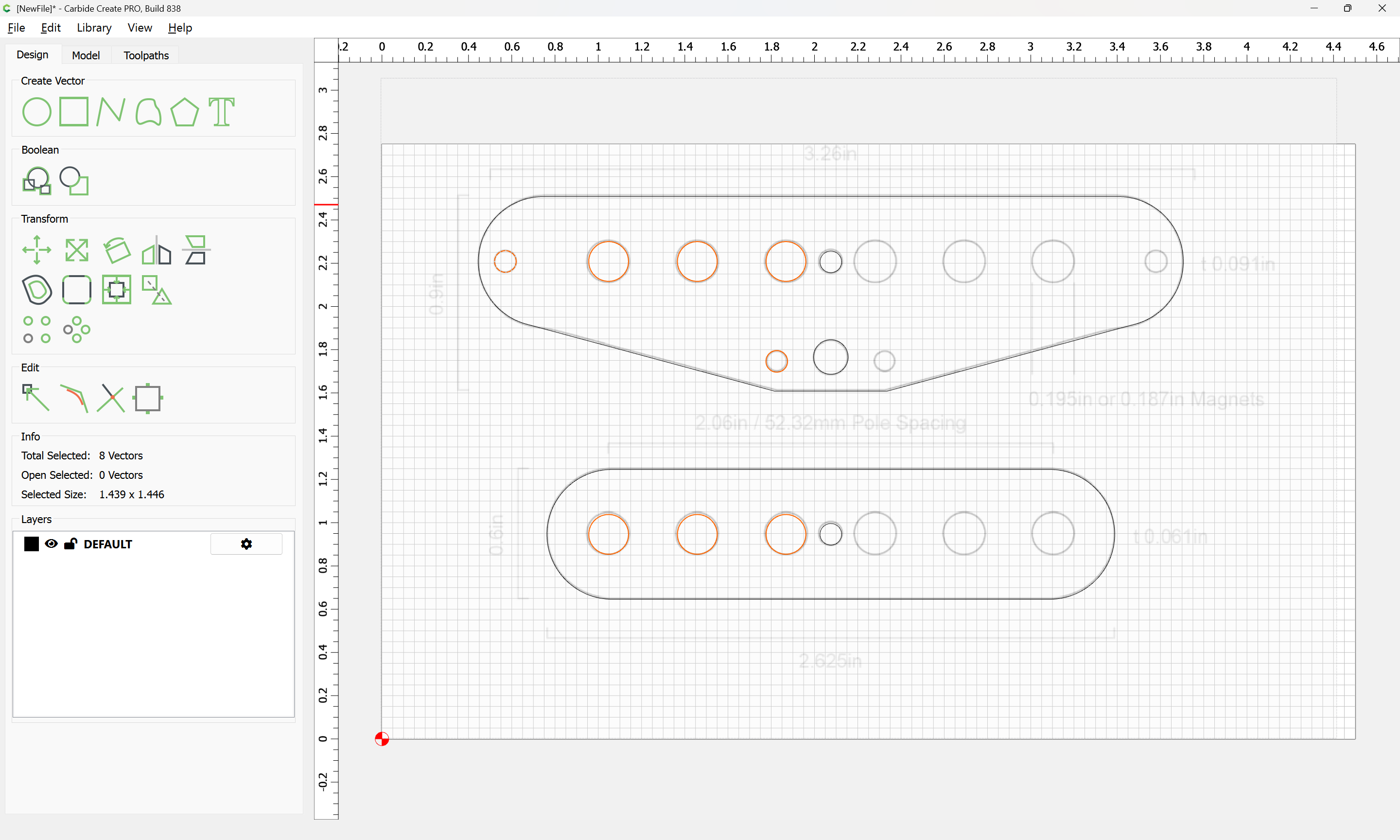

Presumably, there is some standard spacing/sizing for the hole dimensions since it is not documented here — draw in half of them:
using the end nodes as origin points
then position by jogging with the arrow keys (note that shift will reduce the movement by 1/10th)
copy-pasting as desired until one has a full complement — the three along the central axis:
should be centered against a larger element:
OK

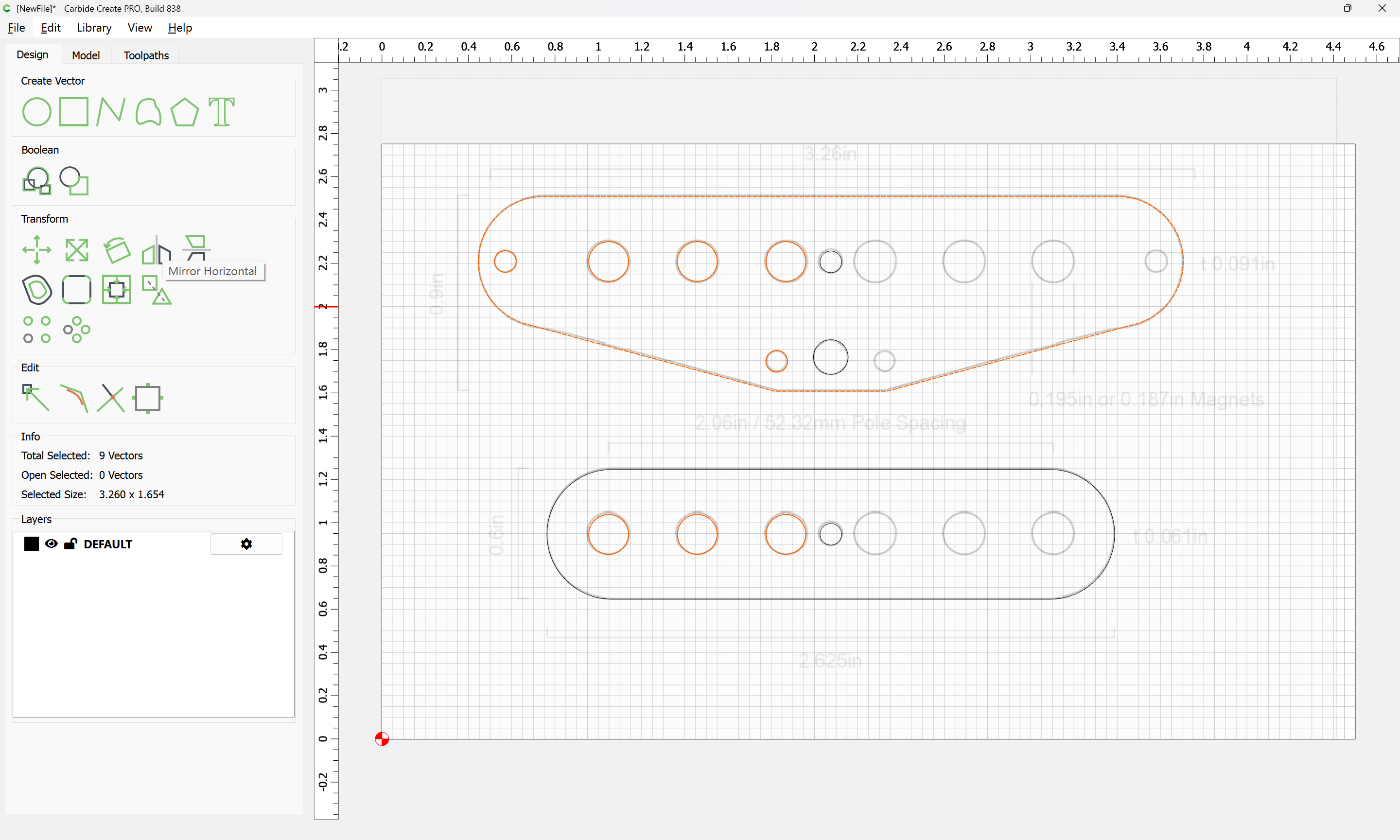

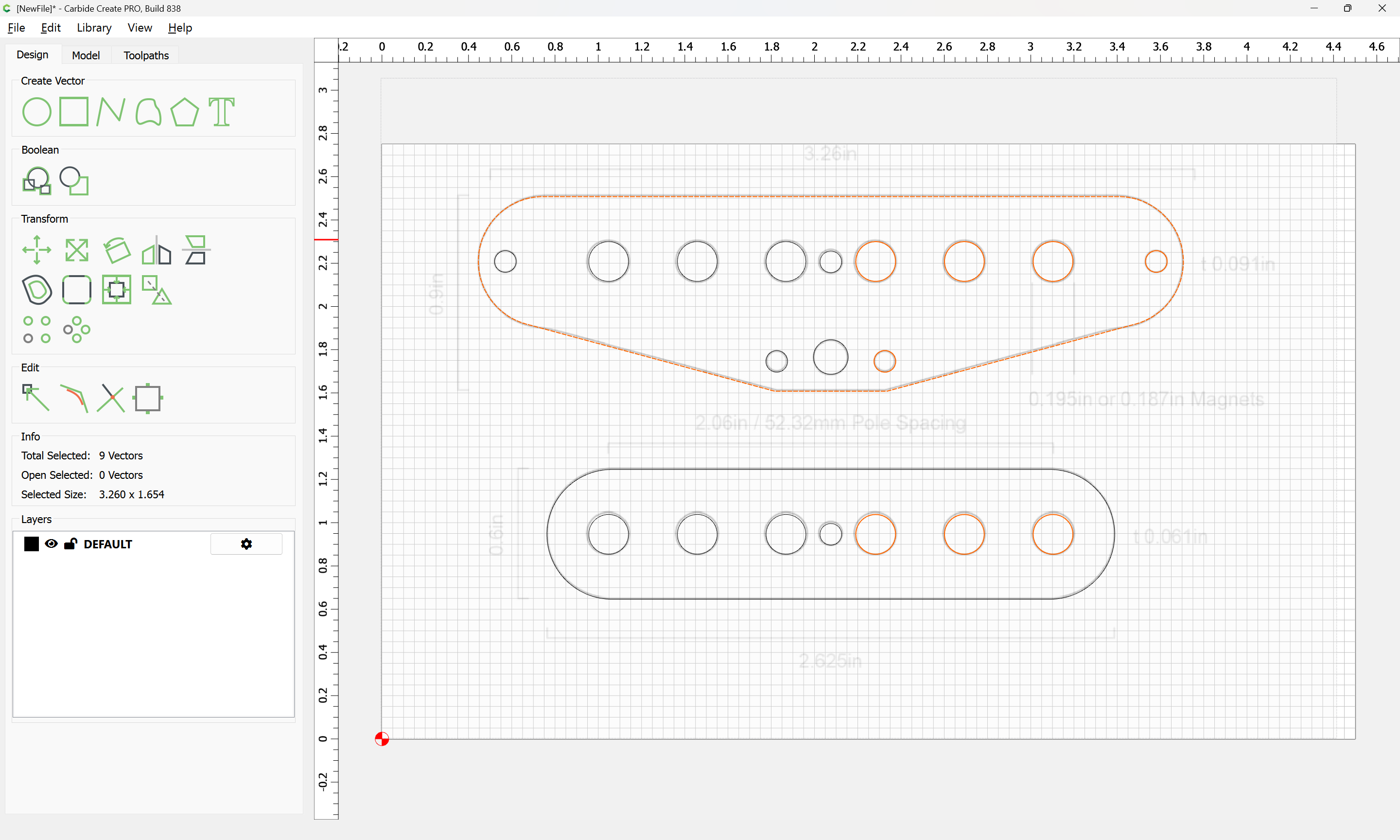

Then, once one has drawn in one-half of the holes:
duplicate them and shift-click on a larger/surrounding element (which is symmetrical) to add it to the selection:
Adjust as need be.

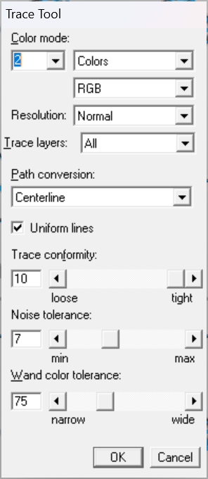

For tracing clean images to DXF I use an old Windows program called WinTopo. It is still on the web, and the free version is pretty useful. I’m an ancient paid user, but my license is locked to a PC that I haven’t had for 8 years and I haven’t gotten around to trying to get it updated. The paid version has more pre-trace raster editing, and also more configurability for the tracing itself.
